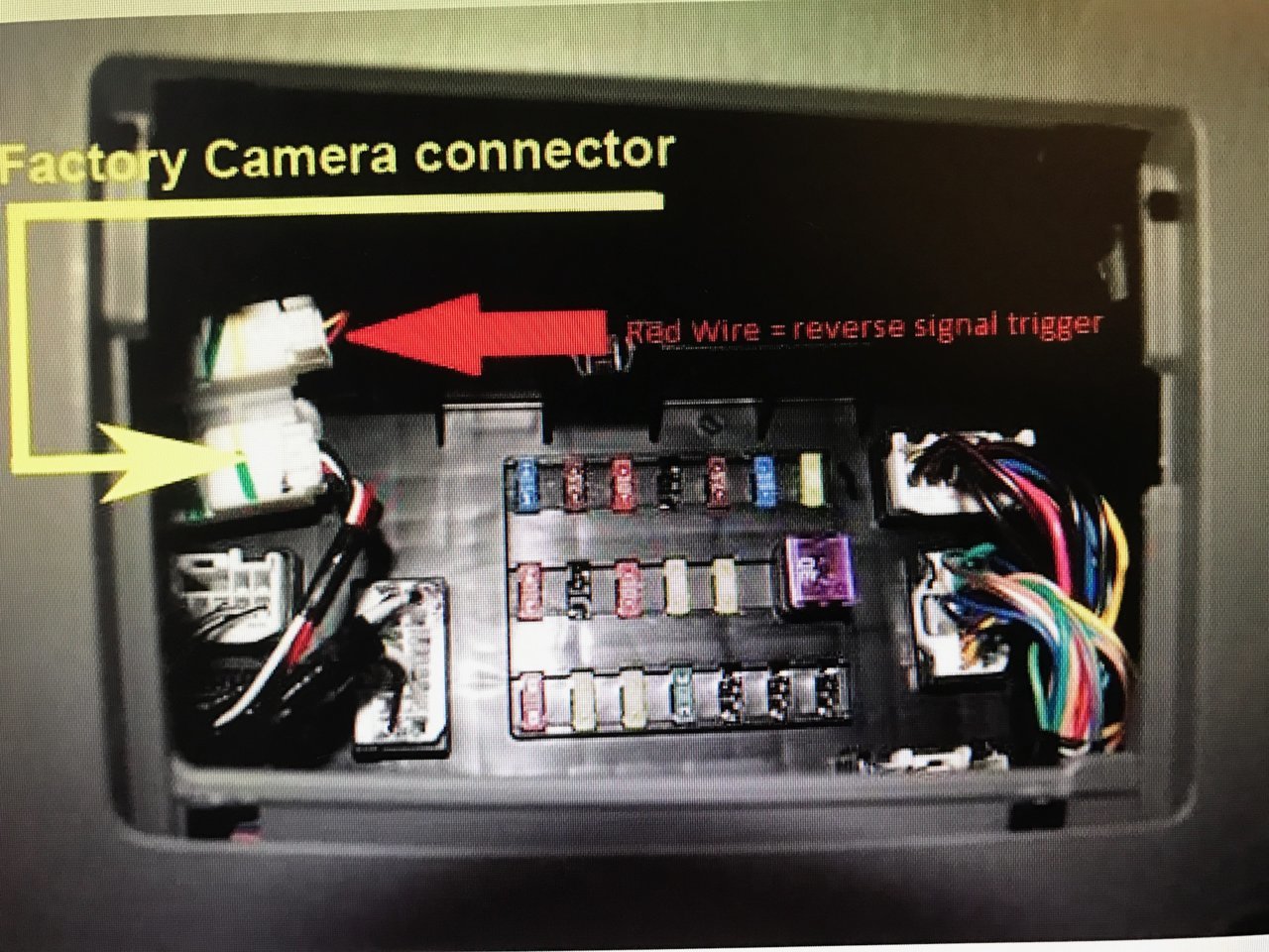

    So I'm trying to get the pinout for the factory reverse camera harness that plugs into the factory radio. I want to know what the 4 wires are. According to this guy in the video here is what I was able to extract.
    Red Wire - Camera Positive
    Black Wire - Camera Ground
    Bare Wire - Camera Ground
    White Wire - Voltage Positive for Camera
    I'm pretty sure that's not right. I know there are the following wires, I just don't know which color is which.
    -Camera 12v Power
    -Camera Ground
    -Video (+)
    -Video (-)
    Who can help me?

    I followed this diagram from someone on here. Can’t remember who... Just spliced right in. Keeps the camera in the rear view mirror, but you get some horizontal distortion. Not terrible, especially for how long you actually use it at once.
    I also use an android head unit, OBDII with the Torque App and use an Apple CarPlay adapter.
