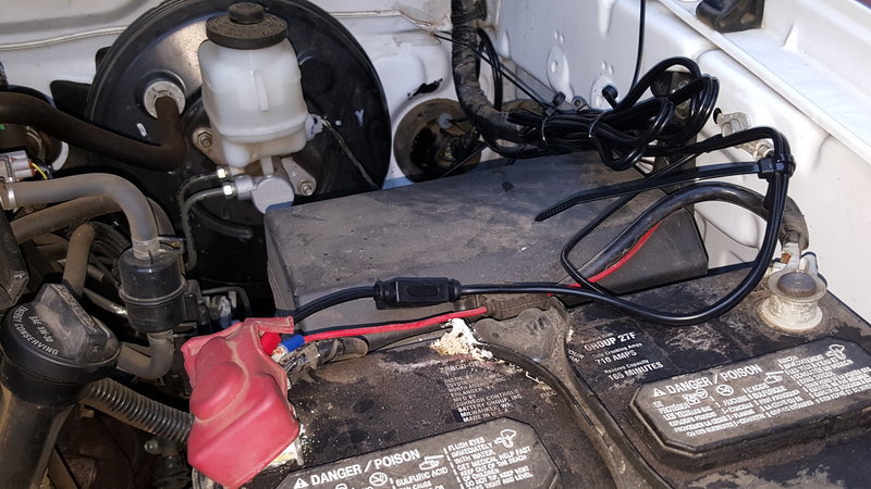

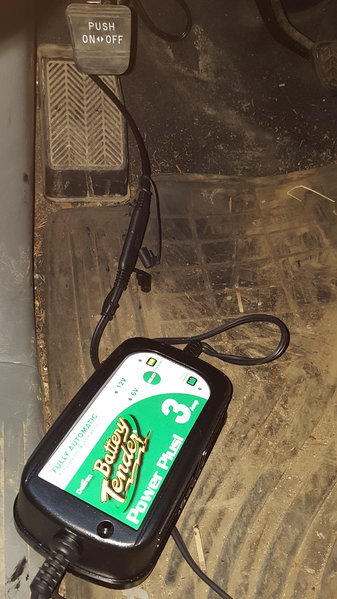

    Cut paste from my build:
    According to my ultragauge short trips have been running my battery down. Hardwired a battery tender then used an extension to run the connex into the truck so I don't have to pop the hood every time I hook up the charger. Cut the grommet and pushed the extension thru, and applied plenty of rtv silicon after to prevent water egress. Getting under the hood and seeing a few acorns reminded me I need to do the rat screen mod at some point before they set up shop on my cabin filter.
    [​IMG][​IMG]
    Dalandser[OP] likes this.
