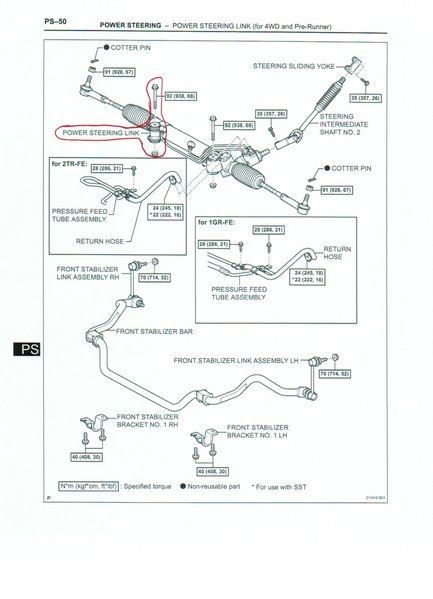

    Well I installed My new intermediate steering column and it didn't fix anything. Waisted $222 buying the piece. Oh well. Hope I can sell the one I just took out because it's just fine.
    What I did find is there is a power steering link holding the steering box that the intermediate shaft hooks into and that power steering link has a bolt to hold the steering rack and I had my 6 year old daughter turn my wheel from left to right and watched it jump. I tightened the bolt and it has stopped the clunking and tightened up the steering.
    I hope to do a better road test tomorrow but the small road test showed me that it is now fixed.
    I have attached the picture of the part outlined in red.

    Why would you buy a part especially one that expensive if you where not 100% certain that was the problem? I was a mechanic in the Air Force ground support equipment one of the very first things we learned was trouble shooting it is a very sound process. Im not trying to be rude Im just saying you spent all that money and time for nothing.
  19. Dec 16, 2015 at 8:42 PM
    #39
    Jonas111
    Jonas111 Well-Known Member
    Nov 4, 2015
    #168624
    111
    Kelowna, BC, Canada
    You make a good point but I was forced too. I will explain.
    I bought a vehicle that is not from my province (IN Canada) and I need to get an out of province inspection done to make sure vehicle is safe for the road. When I got the inspection they test drove the vehicle, inspected it and said the Intermediate Steering Column had too much movement and needed to be replaced. I now have to replace that part to pass the inspection. So I did.
    I explained to the garage that it was highly unlikely to be the intermediate steering column but they told me I needed to do it. I replaced it and fixed the steering myself by tightening up the power steering link.
    Sounds a little silly to me, but I am not going to argue with the garage I have to take my truck back to for the final inspection. It could have been much worse.
    Hope that makes sense.
