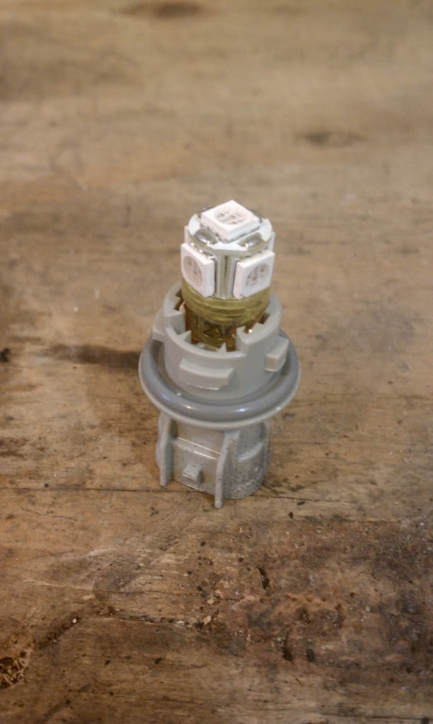

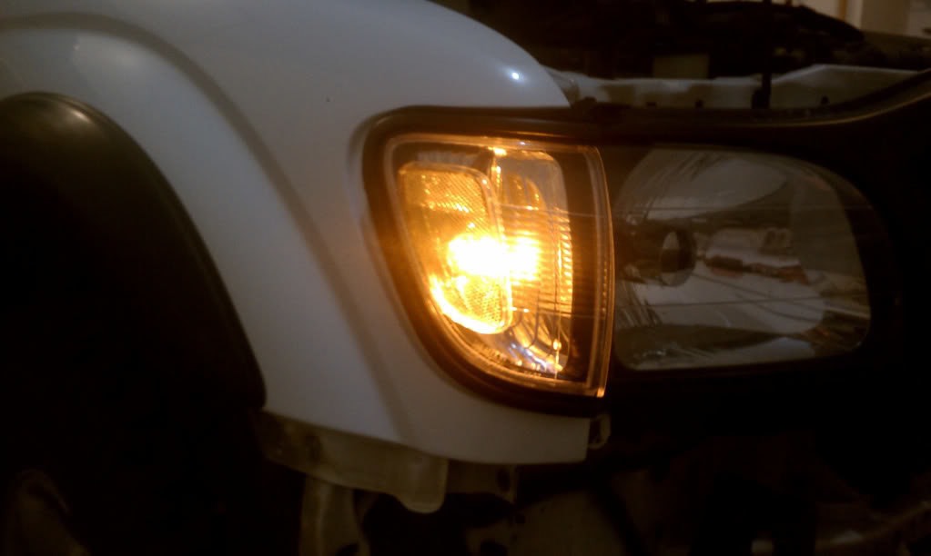

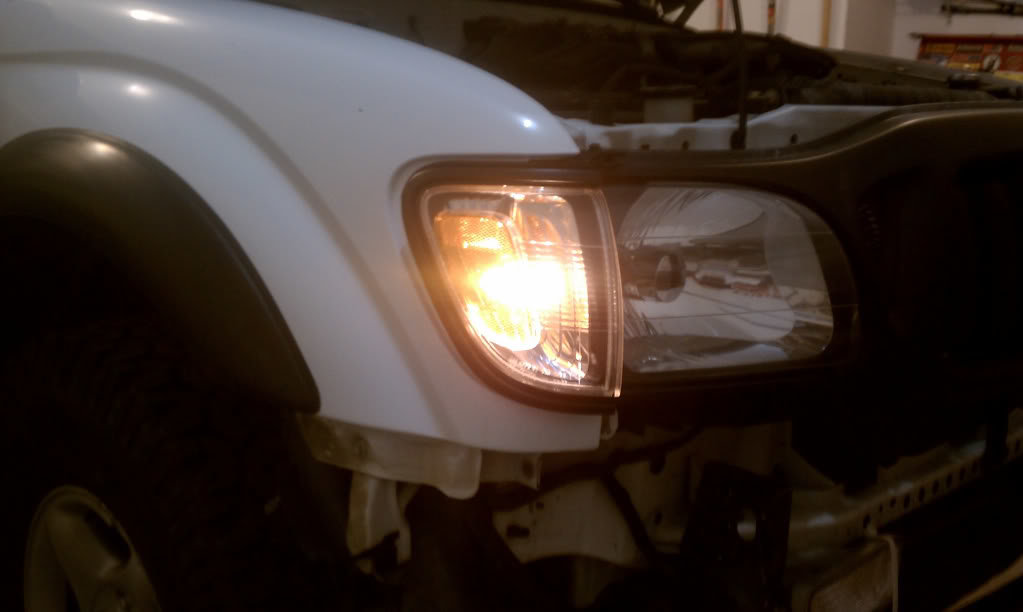

    I apologize in advance. These pics don't do this light justice. I bought the amber LED and it is a very brilliant amber, almost orange. I really like the color.
    TOP pic is factory bulbs, BOTTOM is the LED.
    NOTE: The parking lights weren't mounted in this pic, I just had them hanging in there.

    look bright, mine should be here saturday if not earlier

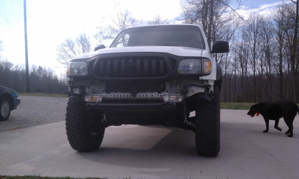

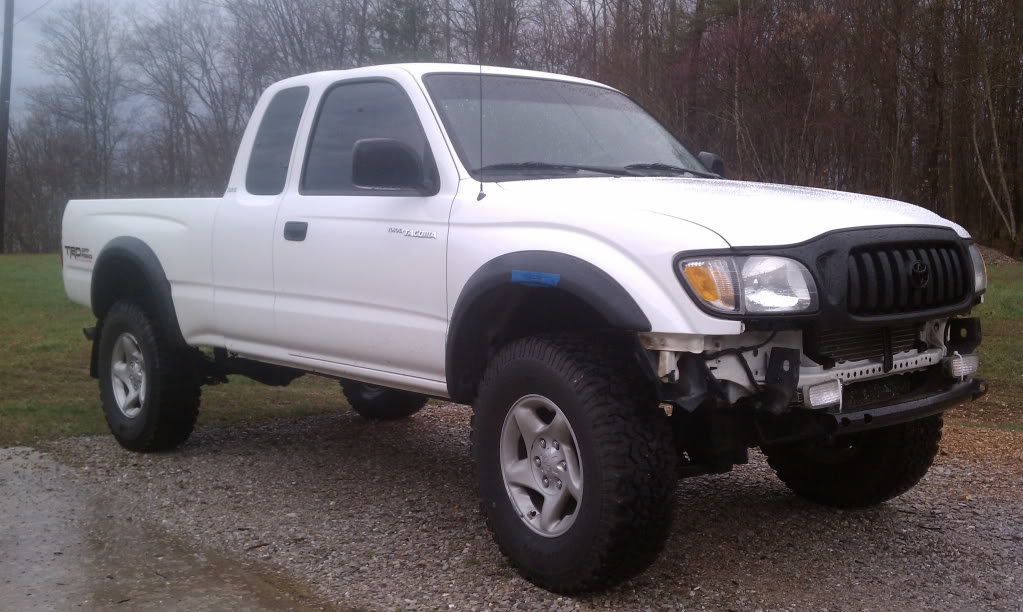

    Update:
    -Toytec front lift on
    -Wheelers Off-road 1.5" AAL on
    -Bilstein 5100's on the rear
    -Magnaflow catback installed

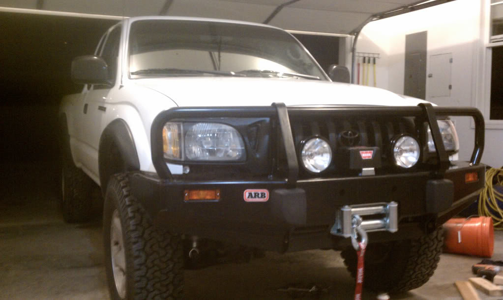

    I'll post some lessons learned and final pics tomorrow, but for now, here it is:

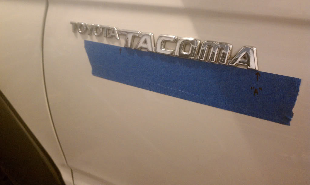

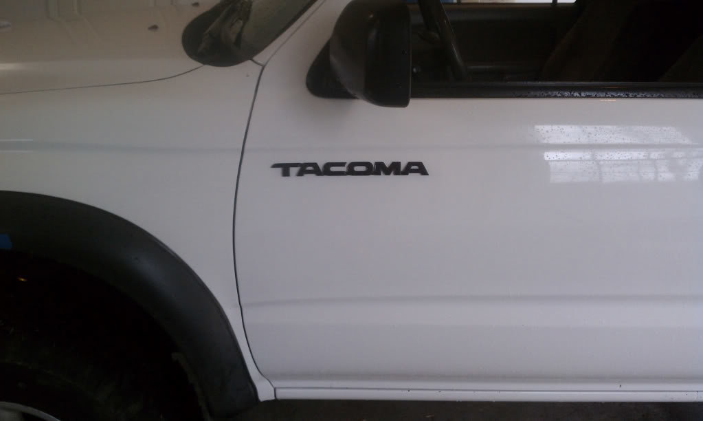

    Also, here's my updated badge setup:
    Before:
    After:
  15. Mar 17, 2012 at 8:56 PM
    #35
    senor taco
    senor taco ROLLIN ON RUST
    Jan 7, 2009
    #12330
    2,328
    Steve
    Monterey Bay, Ca
    O7 Tacoma PreRunner SR5
    17in fj cruiser wheels satoshi grille with devil horns emblem Single in double out 50 series flowmaster with stainless tips Kenwod ddx512 double din touch screen DVD reciver with a single Rockford fosgate 12 in sub with an alpine amp tinted tail and third break light silverstar head and fog lights k&n drop in Billy 5100's on all 4 corners with a 2"AAL
    Looks good.

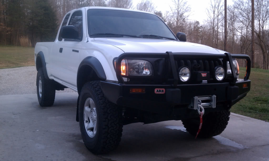

    Gave it a wash today and finished all of the small remaining items.
    I still have to buy a new receiver hitch, build my rear bumper, and get the bed Line-X'd.

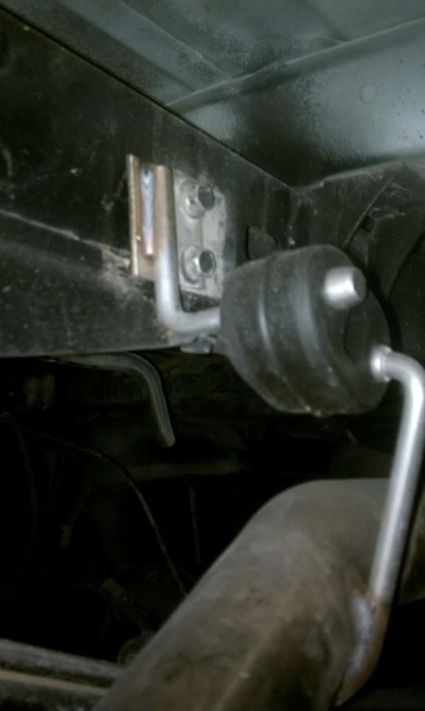

    3) Magnaflow Catback Exhaust (P/N: 15811)
    Why: Stock exhaust sucks.
    Install Time: 1 hour. This includes removal of the original exhaust.
    Tools: Sawzall, Normal wrenches, sockets, ratchets, WD40, 4” angle grinder with cut-off wheel and grinding wheel.
    Lessons Learned:
    1) When removing the factory exhaust, the bolts that bolt the catalytic converter to the intermediate pipe was so rusted that I had to cut and grind them off.
    2) Realizing that I didn’t want to risk exhaust leaks, I pre-ordered the catalytic to intermediate pipe gasket as well as the post-catalytic converter Oxygen sensor gasket. I also bought two new cat to intermediate pipe bolts.
    3) To make removal of the exhaust easier, I used a sawzall with a bi-metal blade to cut the exhaust in half (around the shock area).
    4) To make removal and installation easier, spray all of the rubber exhaust connector linkages with WD40…it makes a huge difference.
    5) The Magnaflow instructions were fairly accurate.
    6) One issue that I experienced was that when I pulled the tailpipe (with tip) out of the box, there was a dent in the tip. I used a ball peen hammer and a hatchet (because of the flat side) wrapped in a sweatshirt to fix the ding. It actually came out perfect.
    7) The other issue was that the rear bracket (which is replaced – provided in the kit), when bolted to the frame hit the weld for the rear mount of the leaf pack. Does it matter? Probably not, but I still hate stuff like that

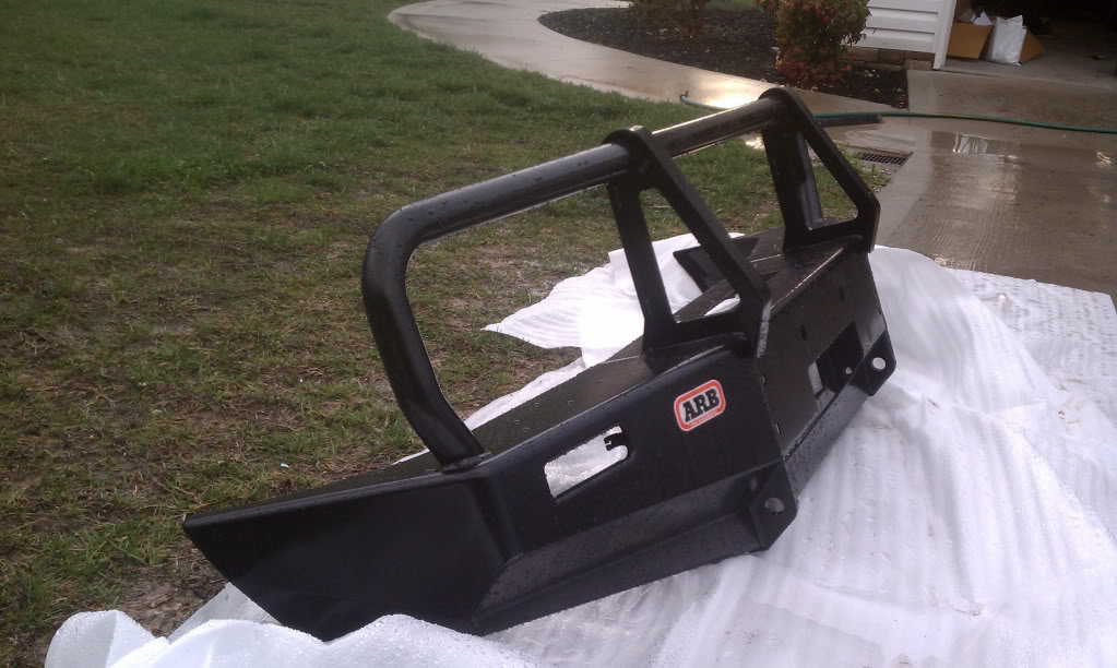

    4) ARB Bull Bar (P/N: 3423020) and Warn M8000 Winch
    Why: I had a brushguard before the wreck, truthfully, I hated it. It wasn’t robust and it decreases the truck’s approach angle. I though the ARB Bull Bar looked robust and it seems to be. I also wanted a winch forever.
    Install Time: Too damn long. Seriously about 6 hours.
    Tools: Sockets, ratches, and wrenches. Electric drill that accepts ½” drill. Allen wrenches. Wire strippers and crimpers.
    Lessons Learned:
    1) The ARB instructions suck. Plain and simple. It lacked enough pictures, detail, and the directions were written in Australian slang…great mate.
    2) I do have to give props to the ARB instructions for directing me to rotate the winch gearbox 4 bolt holes so that when the winch is installed, it makes for easy access to the winch directional selector switch.
    3) Make sure you have another person to help. It takes two guys to install this bumper if you don’t have a gantry or overhead lift, it would be tough to hoist a 200+ pound bumper gently into place without dinging your fenders.
    4) The hardware with the kit was somewhat confusing. The directions didn’t clearly state how to complete a step. Most things were worded like: “Install indicators.” Heck, I even had some of the hardware not fit and some of it was missing.
    Summary: All in all, I think the ARB is a great looking, well-built bumper but the product stops there. The instructions, hardware, etc pissed me off. I wouldn’t recommend buying or not buying it. To me it seems that a great welder and engineer got together and built this bumper. It then seems they gave the responsibility of writing the instructions and assembling the hardware to 3 illegals and a cleaning lady.
    The Warn winch went together easily and straightforward. No problems there.
