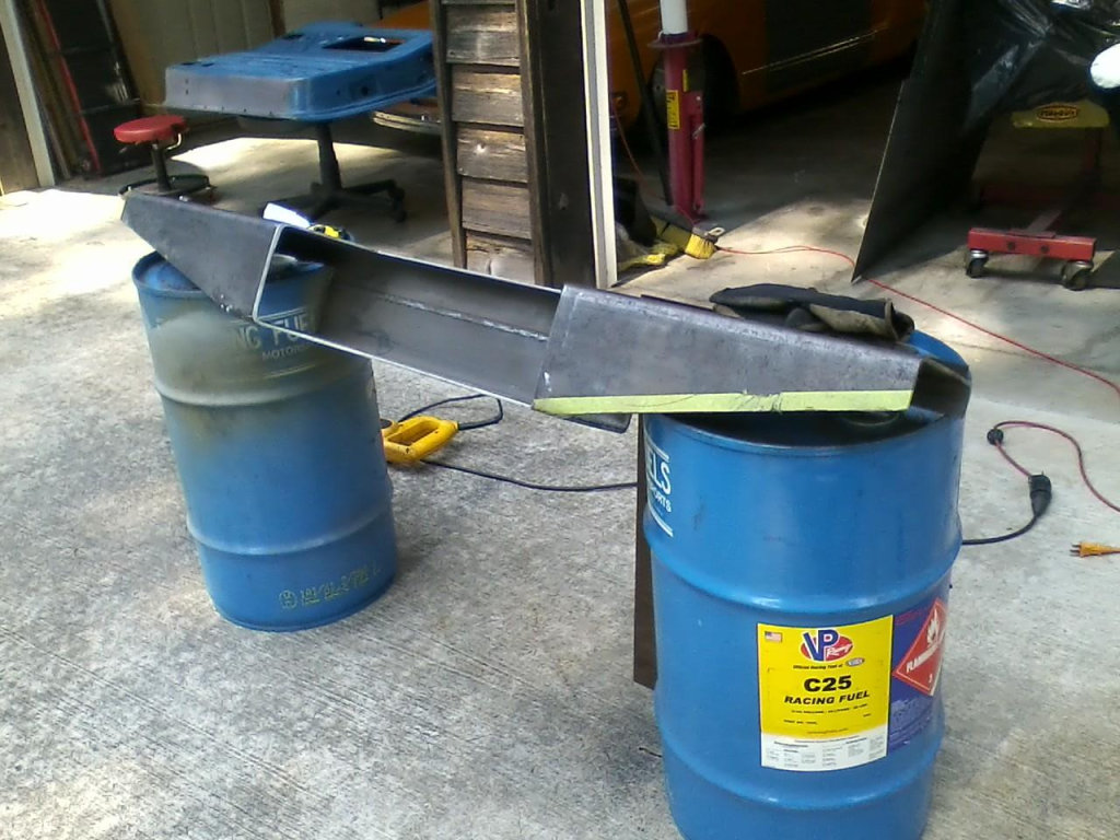

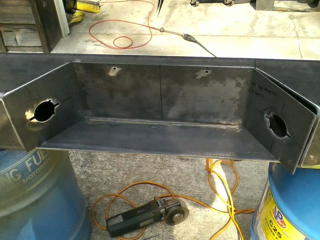

    A few details about the rear bumper:
    1) I'm starting with a 6" x 6" x 0.1875 wall hot rolled tube.
    2) I bought an 8' stick and after all of the damage was done, the tube cost $260.
    3) I decided to go with a tube because I'm only making one bumper and building fixtures for one bumper would have increased my cost and build time substantially. By starting with already square tubing, I'm a step or two ahead. We are being strategic on what we cut out, to prevent any rolling or warping as we remove material.
    4) I like the look of the Relentless bumpers. The multi-faceted look has a certain appeal to me. My bumper is going to be similar, but different. I definitely wanted a full depth step at the license plate. I also wanted to be able to reuse the factory license plate lights.
    5) When finished with fabbing, the plan is to have it powder coated to match the same texture and finish as my ARB.
    I guess that's all for now.

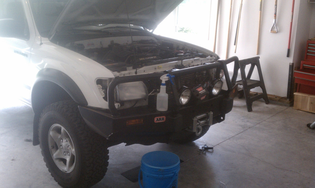

    Because of the wreck, my brush guard was pushed back into my driver's side headlight ever so slightly. However, it was enough to break one of the little plastic adjustment clips. Believe it or not, Toyota only sells the entire assembly. No way was I going to pay $150 for a stupid clip.

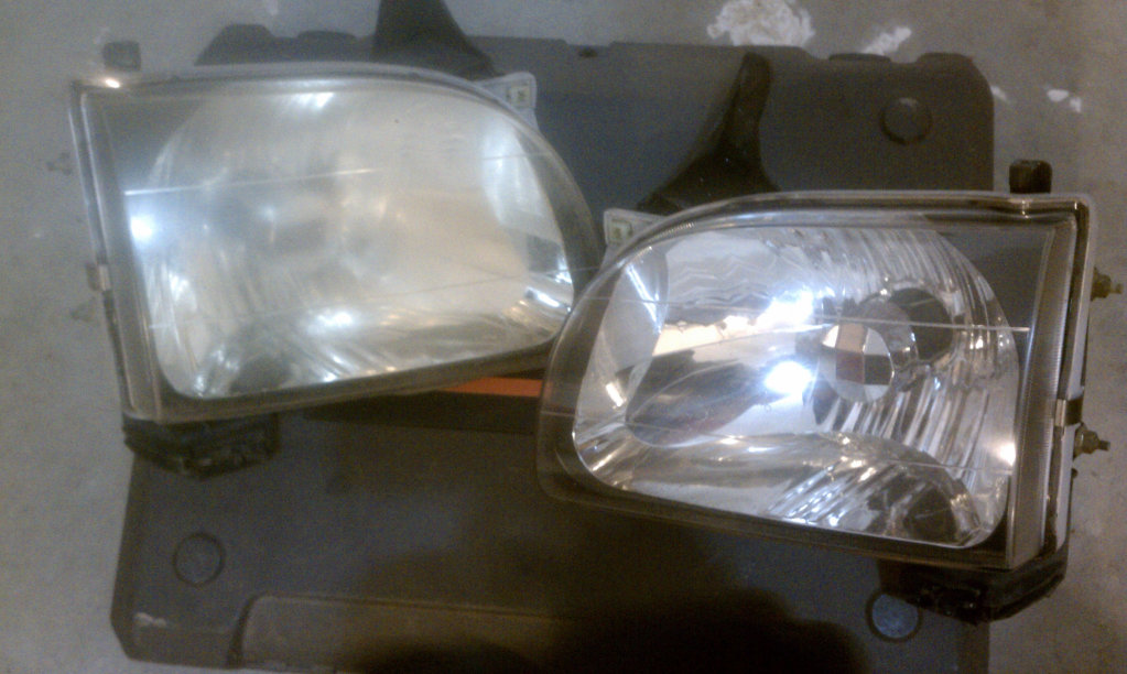

    I bought another set of lights off of a TW member. His had some fade on the lights, so I buffed out the driver's side light and was ready to put it in.
    Oh, nothing is ever simple. Of course the grill has to come out to install the headlight. I was hoping there was enough gap between the grill and my ARB to slip the grill out without having to unbolt and slide the ARB out. Yeah, not so lucky.
    While the grill was out, I changed the light and buffed the passenger side light.

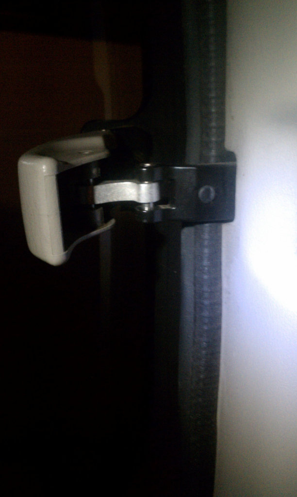

    Tonight I decided to install the extended cab hinge clips. Took about 5 minutes per side.
    How to video: http://www.youtube.com/watch?v=80KBuGY9Qs4
    Link to buy: http://dasherdeals.ecrater.com/
    He also has an eBay page.

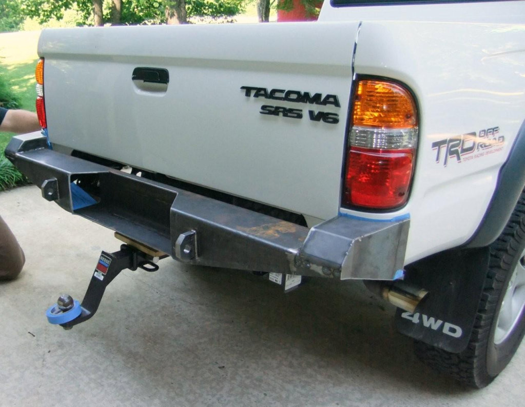

    Bumper still progressing. Left to do:
    1) Round off corners on outside of bumper
    2) Add bottom plates
    3) Add mounting plates
    4) Add in license plate well
    5) Finish welding/grinding
    6) Get powder coated
