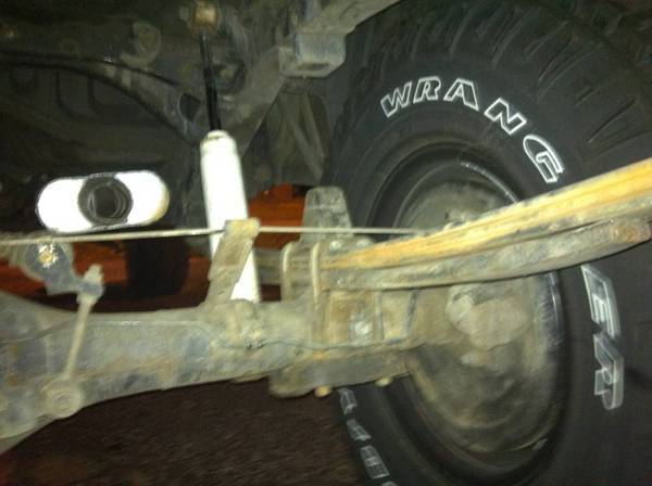

    Noob question, you've been warned:
    What's with the flipped/reversed overload?

    ^^ Its actually the AAL some family friends have a shop and they took it out for me awhile back and when they did i never got the overload back, so then i put the AAL back in, kinda a pain i wanna buy a new leaf pack but im broke

    thats not an AAL... thats the overload leaf

    this was on the truck when i bought it plus the overload under that so idk

    That's what I was thinking. AAL should be the same thickness as the existing leafs.
    Anyways, might be a cheap way to gain some lift? Gotta be one hell of a harsh ride though...

    Yeah that is a overload leaf flipped so you must of had 2 :eek: how's the ride a little stiff?

    Yeah haha its pretty stiff, i couldn't handle the insane bro lean anymore and it was off the truck so i just put it in. hopefully i can get my all-pro pack in soon

    Hey colter or colten if you guys have any free time today or one day this week i could really use that jack, i really wanna find out what happened
    Thanks

    ok so i went out with my little post jack to try to unload the struts, but i only could get it lifted about an inch so it was sitting level, when i took the jack back out it just went back to leaning over, im gonna look around tomorrow for some wood i can put under the jack and try to get it off the ground
