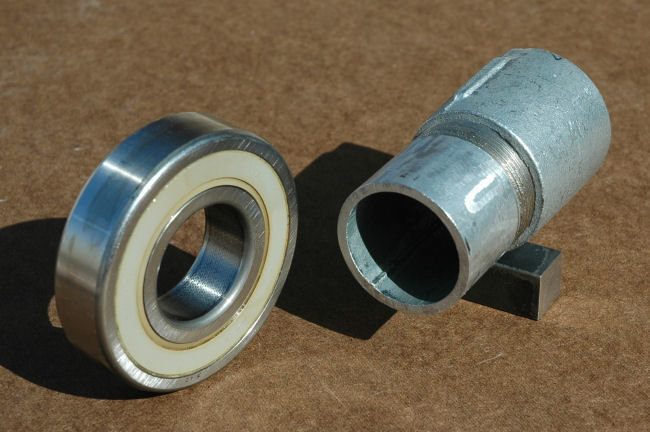

    To install the bearing the pipe (hammer or press) needs to fit against the inner race or damage to the bearing could result.
    From post #16 of the link in post #5
    https://www.tacomaworld.com/threads/proper-way-to-press-in-new-rear-wheel-bearing.274582/
    1-1/2" plumbing pipe , 1-1/2" coupler, screwed together tight, ends squared off
    This is a close fit to the shaft. I had to take a half round file to the weld seam inside the pipe.
