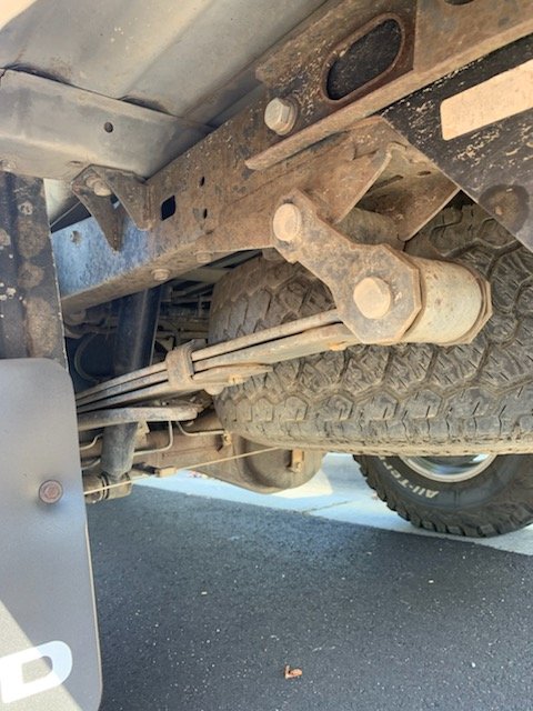

    looking to buy a used taco and the seller sent me these pics, can't tell if it's surface rust. Buy or walk away?

    Doesnt look too bad at all. Could use some cleaning up and a nice coating to protect it.

    It’s not bad, but it will be if not taken care of correctly. Don’t just cover it up with black stuff.

    Northeast - Totally normal. Actually looks good

    Take a hammer and listen for thin spots. Looks normal though.

    Not bad at all for a 2004, I had a 2003 Ram that had a ton more rust on it.

    Pressure wash,wirebrush,degrease,rustoleum spray paint

    Looks similar to my old tundra....hit it with fluid film every year and you'll be fine.

    Looks ok, but not certain it's good until you hit every spot on the frame with a hammer.

    Seriously, dont just cover it up with rustoleum. I help run a huge corrosion program and you can clean it up and either go fluid film or add zinc powder to paint....zinc self sacrifices for metals. Don't add aluminum direct either (like a bumper) without a gasket. Steel will self sacrifice for aluminum. Pm me if you want detailed advice.

    So just wire brush and fluid flm and don't do anything else to it?

    That would work but wouldnt last as long. You would have to do that (depending on where u live, salt use, humidity, etc..) every year if not more. Do a good wire brush cleaning and mix zinc powder into a paint (nothing like por15 at this point) and paint it. DO NOT use the miracle make rust dissappear sprays or anything like that.

    Google up noble metals chart.....and you will better understand what metals sacrifice for others. Never-mind....I'll post a chart tomorrow and try to better explain.

    That frame looks great for a 16 year old truck! I'd buy it no problem.

    Hammer and hope you don't see this afterwards:
