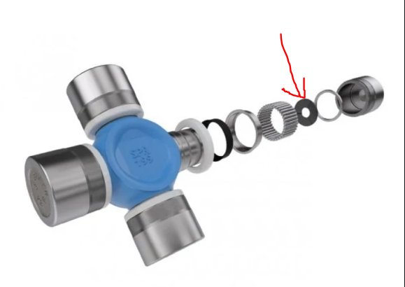

    Figure I give everyone an update:
    I took my truck to "Driveshaft Pro" - in GG today and the techs were able to make my truck 100% vibration FREE!!!
    A few things that was wrong with the rear driveshaft was:
    1. The front ujoint that was replaced was missing the two black plastic pieces that go inside the cap of the ujoint.
    2. The front ujoint also had a half broken bearing inside
    3. DS was completely unbalanced and the tech had to take everything apart and rebuild/re-grease. He was able to reuse 2/3 joints I had originally put on but had to get a new one from them on the front. (near the TC).
    The picture below with the red arrow shows what I'm referring to on point #1
