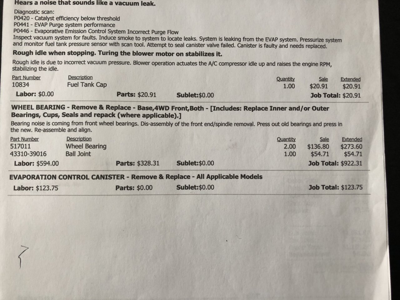

    Here's the part of the invoice of the completed work done 10,000 miles ago that has the bearings billed:
    So yes, I'm sure that the bearings were replaced in the past.

    Interesting they went from showing you play in the wheel to wheel bearings to replacing a ball joint. Wonder where the play really was? I can tell you this it is a serious pain to just replace bearings when for close to the same price you can replace the entire assembly in 1/10 the time. Even cheap bearings will last more than any 10K. The bearing assembly is actually two bearings in one housing opposing each other. Did they show you the old parts?

    The above photo was from 10,000 miles ago when I replaced them the first time, not from this tire shop.

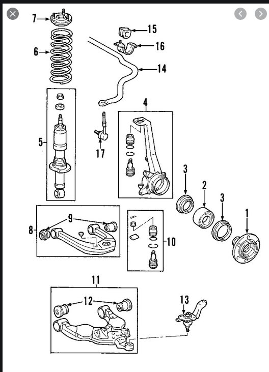

    Here's the diagram of what mine looks like:
  15. Jun 30, 2020 at 11:25 AM
    maineah
    maineah Well-Known Member
    Mar 24, 2011
    #53641
    5,251
    Tim
    Maine
    4X4 SR5 V6 6spd
    Ok thats an earlier one I kind of remember doing them with a slide hammer even easier.
