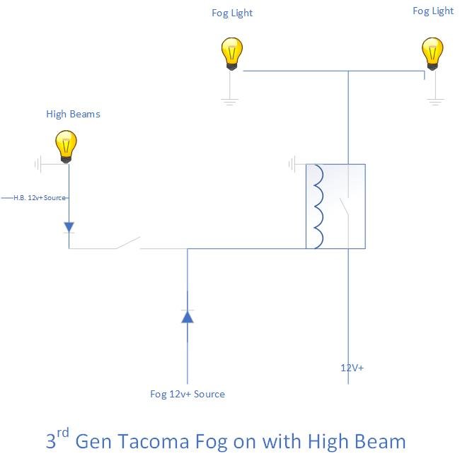

    I plan on getting the squadron fog lights to replace the XB fog lights that I have, but I was wondering if there is any way to use the fog lights while the high beams were on?
    It would be nice to be able to use them at the same time since I upgraded the high beams and use them all the time when off-roading

    Correct! But I read that didn’t work on 3rd gen something to do with the fog lights being controlled by the ECU.
    I was thinking of wiring the fog lights like an auxiliary light (with a switch and relay) so that I can turn them on whenever I want. Just wanted to know if anyone has done it this way or if there any other way to do it

    If you're comfortable with wiring, you could easily add a relay that is triggered by both your fog power and a new dash switch.

    That's probably more complicated than it needs to be. But it would work.

    Try this. It'll give you the option to flip a switch in your cab to allow for the fogs to turn on with the High Beams. You'll still control the fogs through your normal OEM controls.
    Again, I'm sure there is an easier way. But this will work.
    The fogs are controlled through the ECU. It's not as simple as the 2nd gen mod.

    Love your diagrams man!
