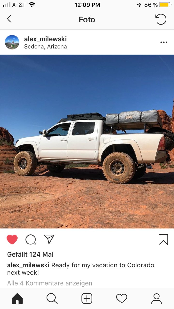

    I would assume that a 2” kit would have less sway, and less body roll. I can’t speak from experience though, as I’ve never ridden in a truck with any 2” kit though.

    One friend of mine has a 2” LT kit, and an archive garage SUA kit, pretty matched performance, and he goes around with a tent on the bed, slow and fast. Probably 12-13” travel all around?
    But I believe he takes it off for more dedicated high speed whoops and stuff like that.

    That's basically what I'm looking for. Probably gonna go +2 in the front with a 63 spring swap in the back over time.

    12-13” isn’t going to happen up front with a +2. Still probably a great improvement all the same.

    Just buy once/ cry once. I would do a +3.5 kit and a DMZ SUA kit for the rear. I am not sure why everyone is afraid of fiberglass. If you take your time with the install, it will turn out awesome. Usually people with +2 kits murder their fenders anyway in order to fit 35's. Have a low profile bed cage made so you can still pack camping stuff/ sheets of plywood/ washers & Dryers in the bed.
    I made a tent rack that bolts to my bed cage and also to the bed. I don't trust supporting the tent by my glass bedsides.
    I use my truck for all sorts of stuff. It is pretty versatile. Its not a full rock crawler, or pre runner. Its a nice blend of both. I am waiting on some pics of Steel bender from this past weekend at rock therapy. For this thing only having 33's and 4:56 gears, it is a tractor. Even though it squats down a lot, it has so much articulation that I can usually find my way up obstacles.
