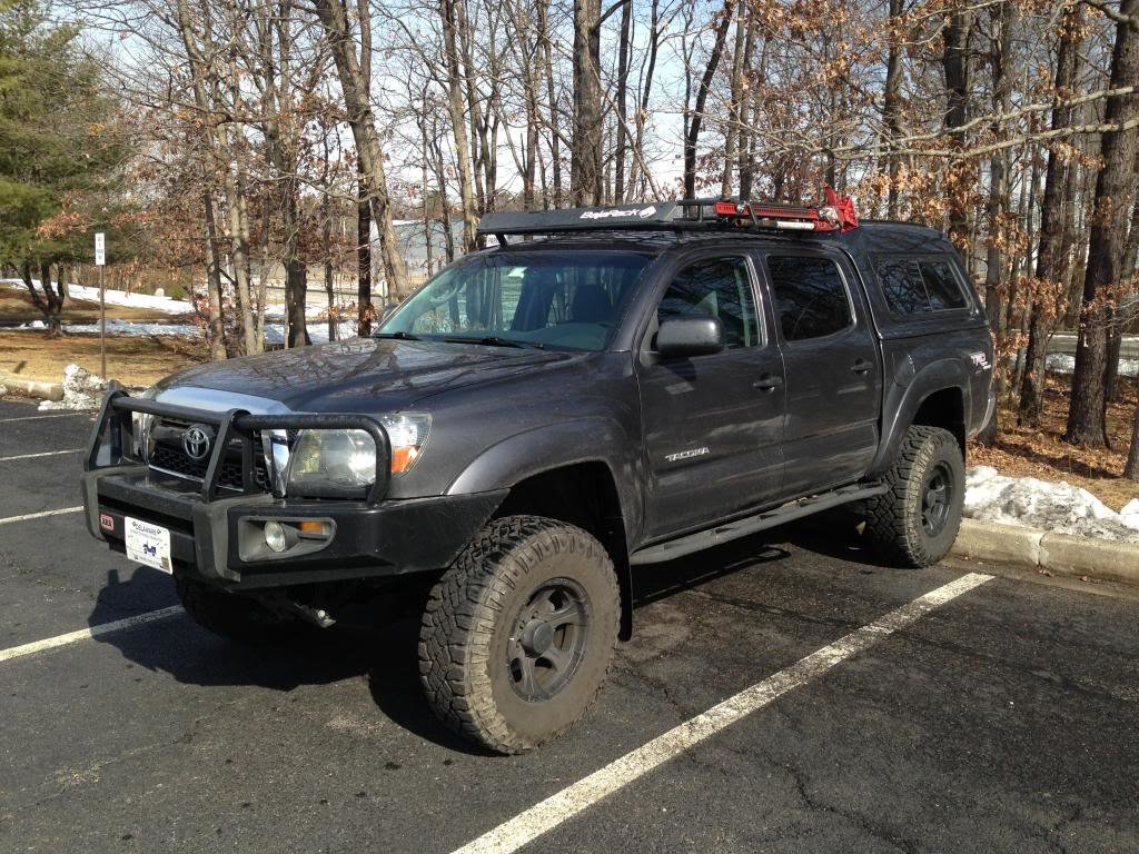

    I picked up a BajaRack about a month ago and am quite pleased with it. I had the ok but somewhat weak factory system and decided to pull it to go for the BajaRack that mounted to the roof due to higher capacity. I also added the Hi-Lift and shovel mounts for the sides.
    Installation was pretty smooth once I realized I needed new weather strips on top, and also had the problem drilling through the center due to the metal strips. But, we have had a ton of snow and rain and no leaks. Be sure to use RTV to seal up the holes and align the weather striping as best you can.
    There is some noise around 50MPG but nothing obnoxious. I haven't seen gas mileage drop and I track every tank.
    But it is made very strong, the finish is excellent, and I can hold a ton of crap up there now. I also picked up one of the soft cargo carriers that matches the basket size but usually just carry cargo boxes up there. I am considering adding another on top of the cap for even more storage or a second RTT mount (I have a trailer tent as well).
