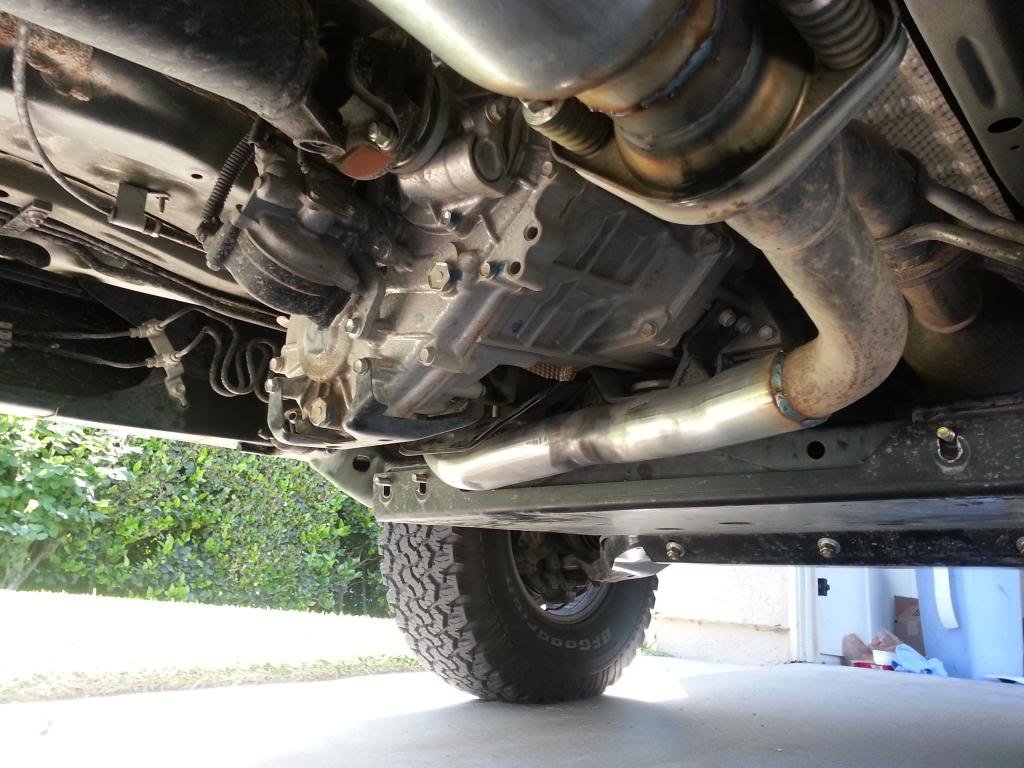

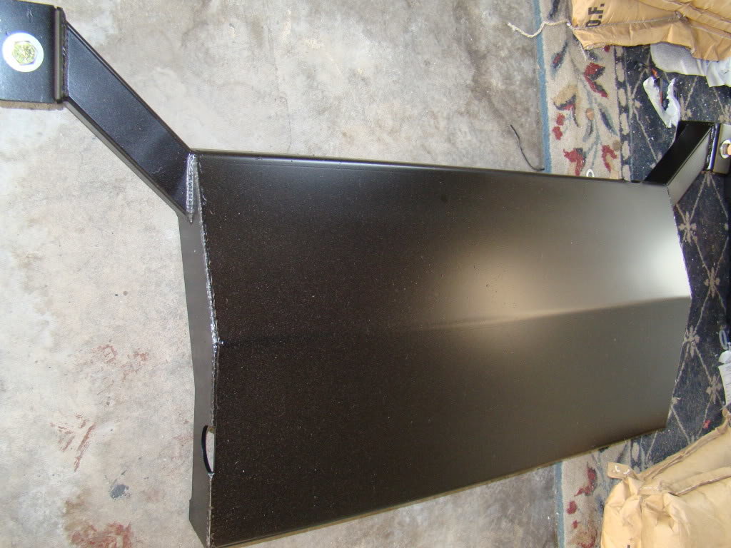

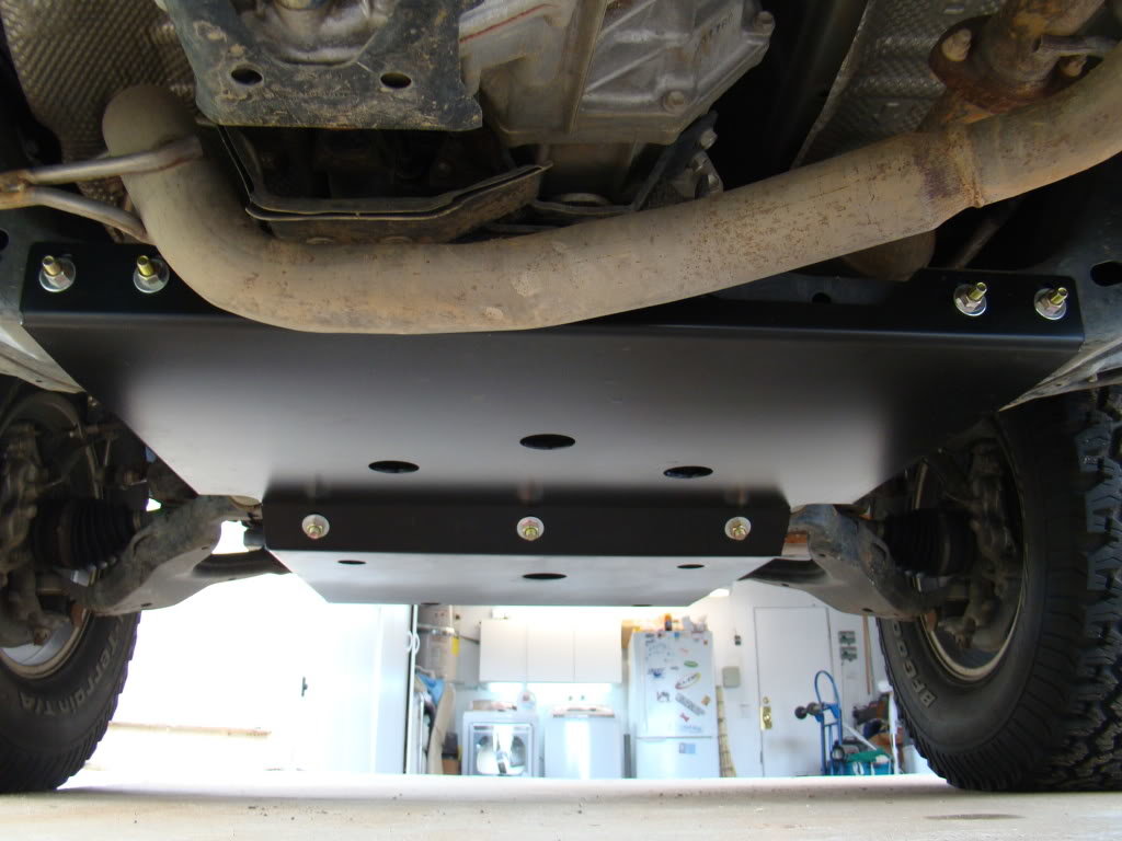

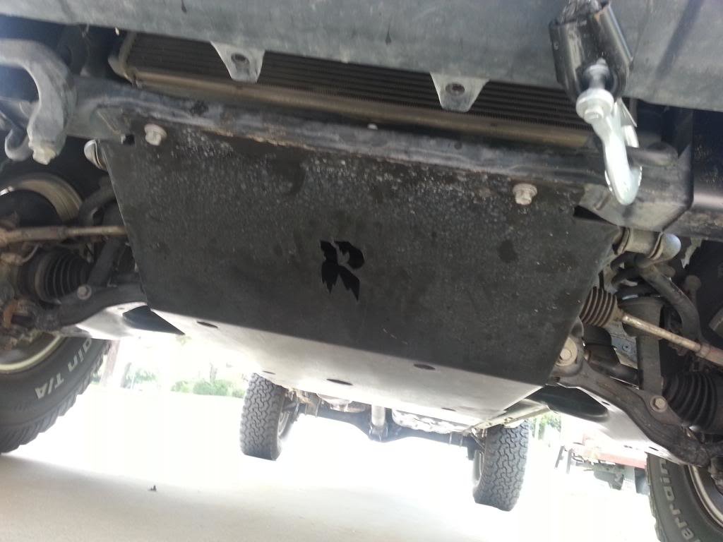

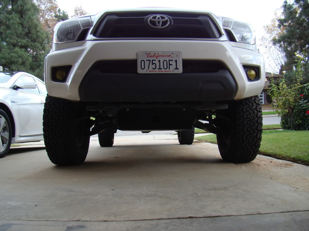

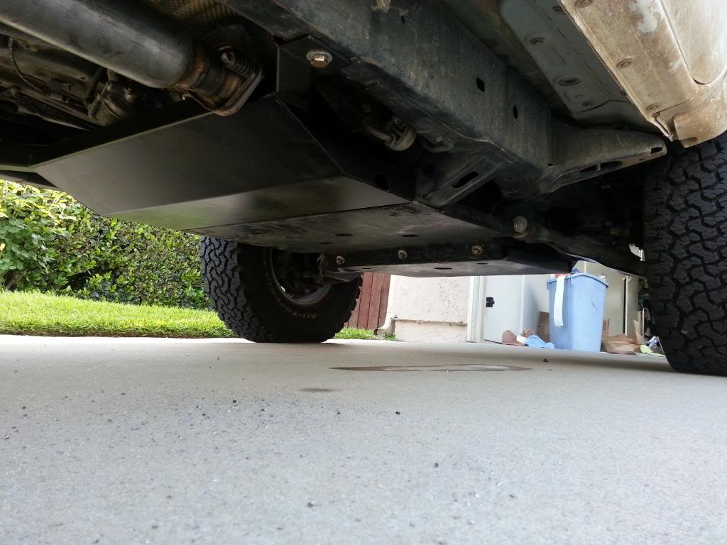

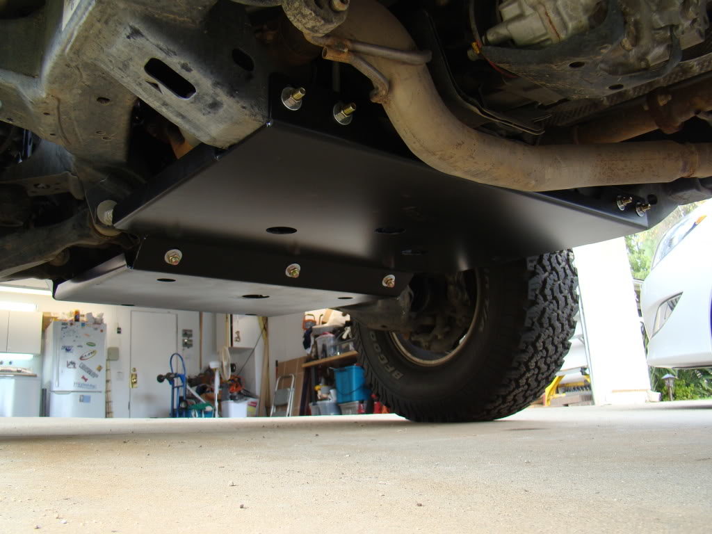

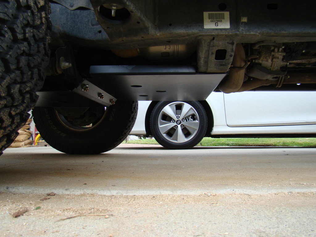

    Two of the three Relentless Fabrication skids are on!!! Floor jack made it easy to hold them up in place so I could move around to install the hardware. These things are stout, I feel much better knowing the front diff, oil pan and transmission are protected. Now I just need to get the crossover exhaust pipe modified so I can install the T-case skid plate. Thanks for building a great product Eric, and for the fast delivery!!!
    Front skid plate:
    Transmission skid plate:
    The crossover pipe I need my exhaust shop to raise up......
    .......so I can install this, the T-case skid plate.

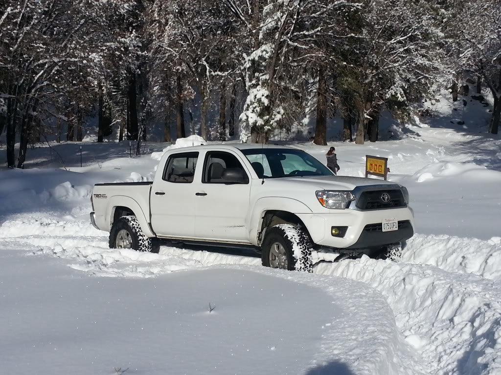

    Went up to Big Bear today to play in the snow. Forgot the SD card for my camera, so I only got a few pics.

    That is BEAUTIFUL! Any issues in the snow... What drive modes did you use (H4, L4, A-TRAC and/or Locker)?

    Not really any issues on the trails, other than some slipping on icy sections. I ran mostly in 4H on the light areas and 4L in the deep areas. ATRAC never kicked in and I didn't need to engage the locker. BFG A/T's on the street in areas that had packed snow cover was a little sketch, making me consider Dura Tracs for my next tire. On the trail the A/T's gave me great traction.

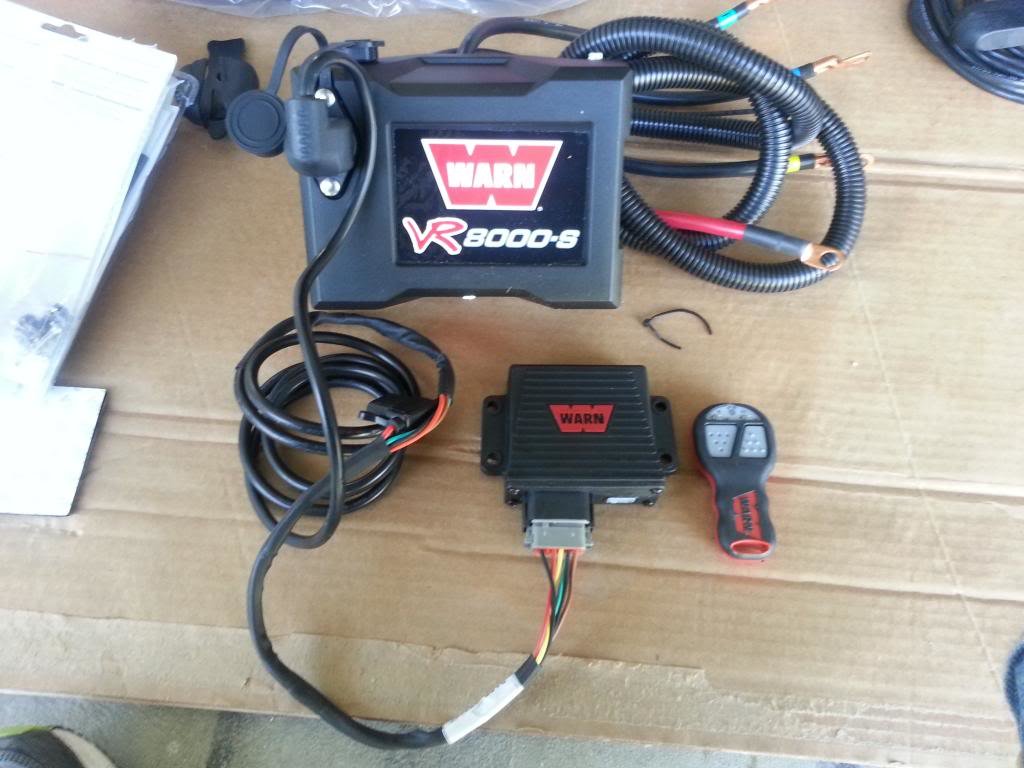

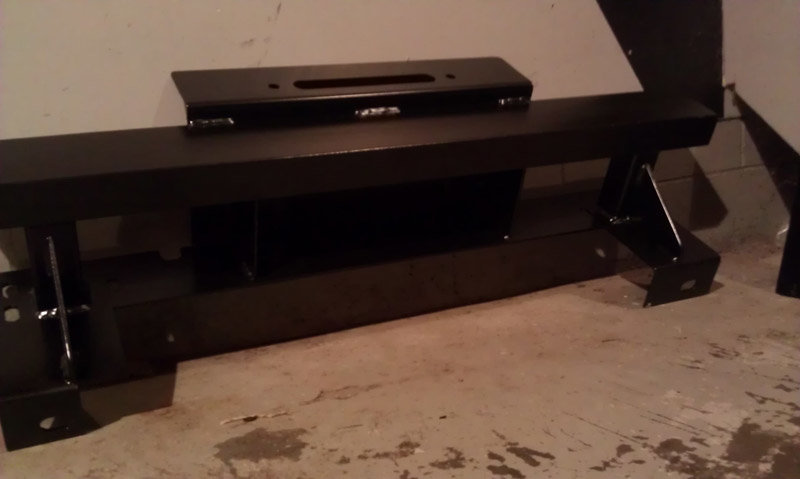

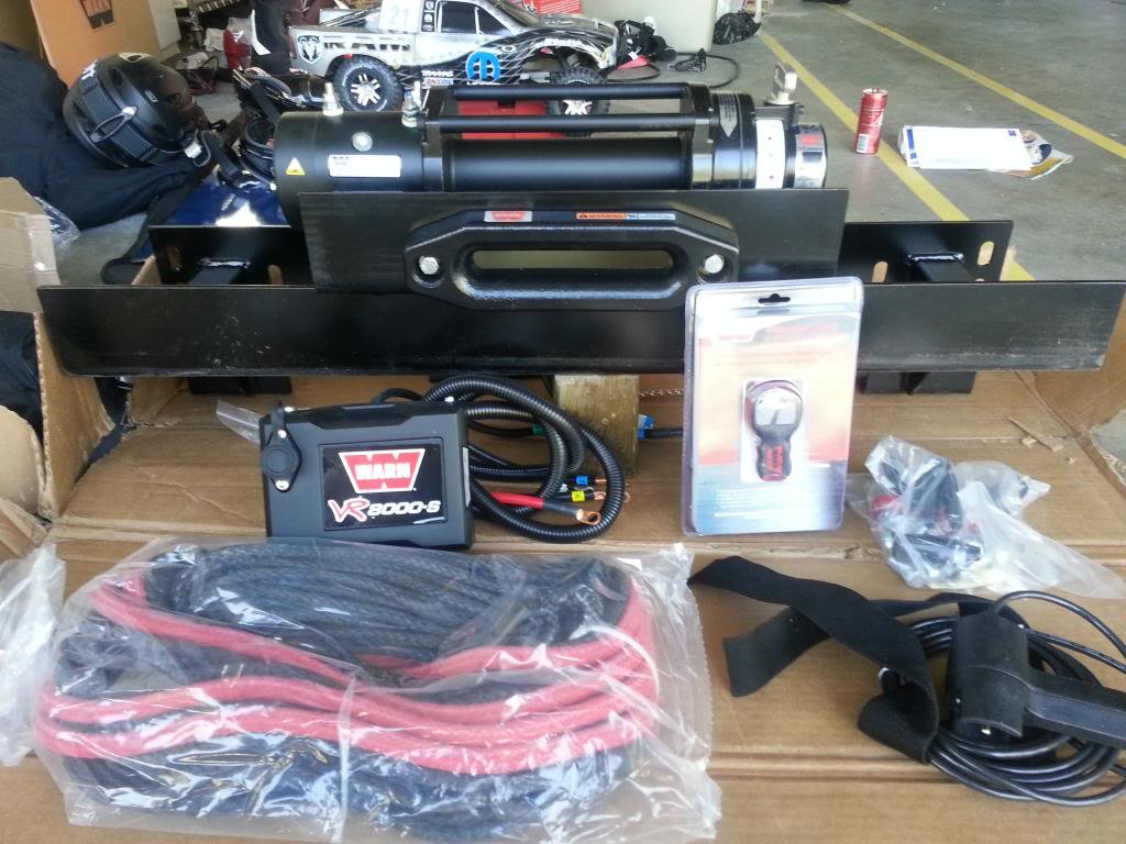

    These (4.56 front&rear)
    plus this (Warn VR8000S)
    Plus this (Undercover Hidden Winch Mount)
    are all coming this friday:yay:

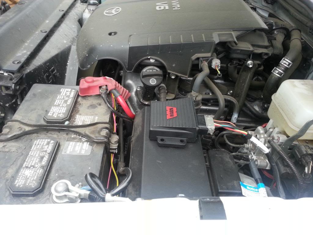

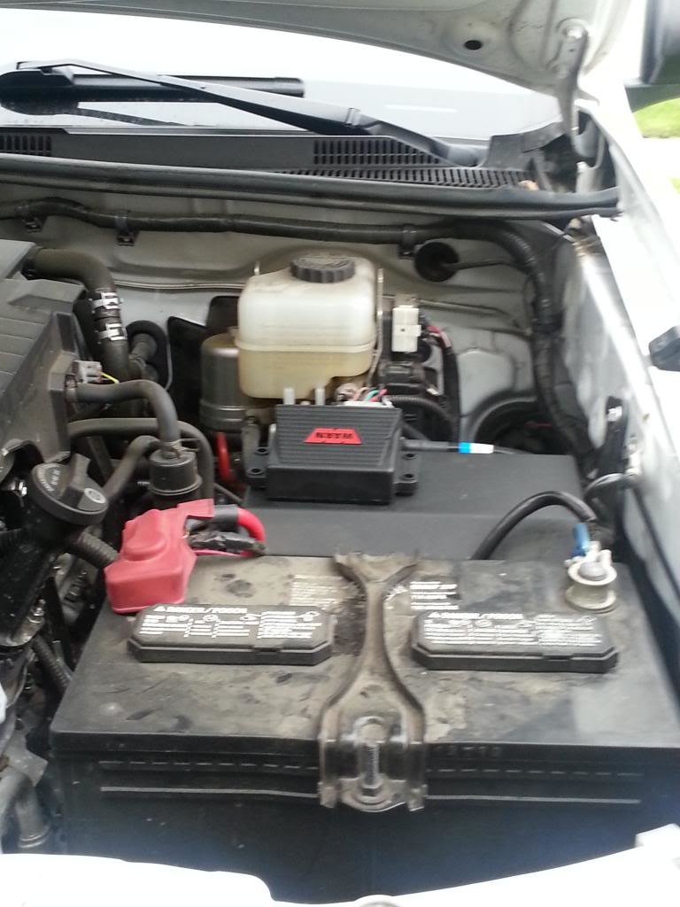

    Mounted the fairlead and pulled the winch out and all the electrical. Winch is just sitting on the mount until I mount it this Saturday. Still waiting for my Viking safety thimble to show up, guess I'll be using the hook till it gets delivered. If anyone wants to help me out with the install feel free to chime in.:hungry:
    This is going to save me from having to scrape my hands to plug in the remote.
    Solenoid is ready with the wireless system hooked up.
    Can't wait till Saturday!:goingcrazy:

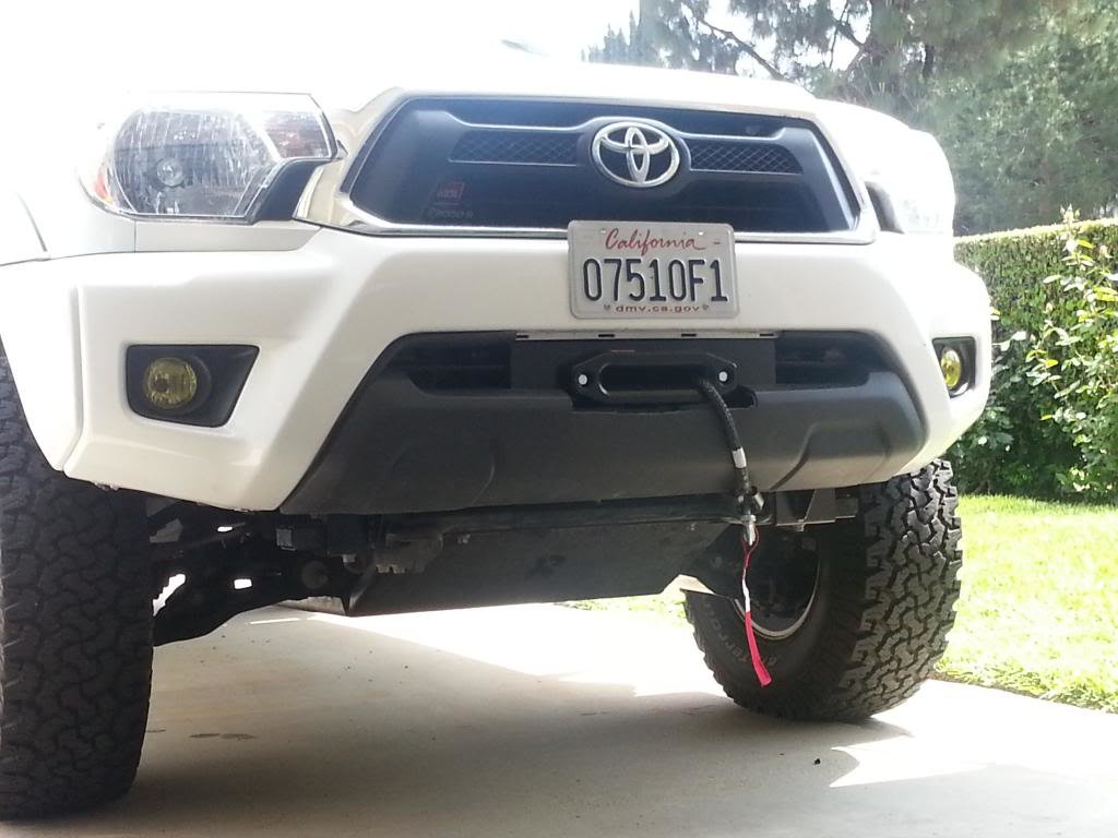

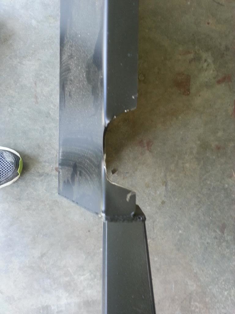

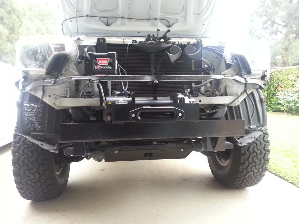

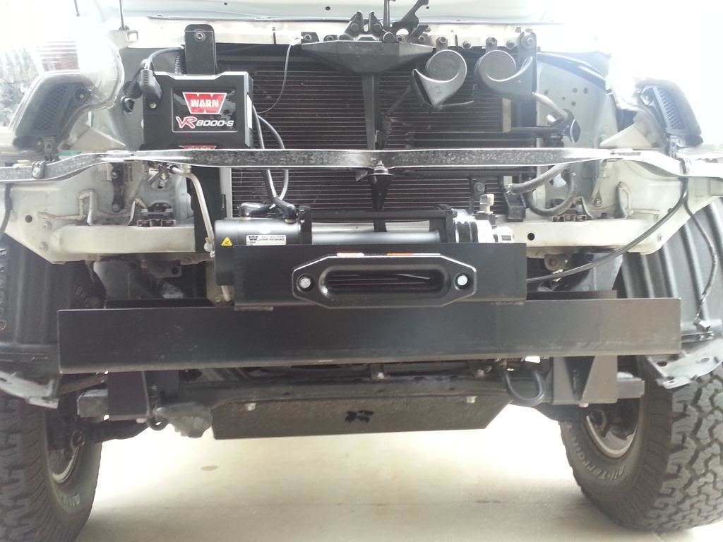

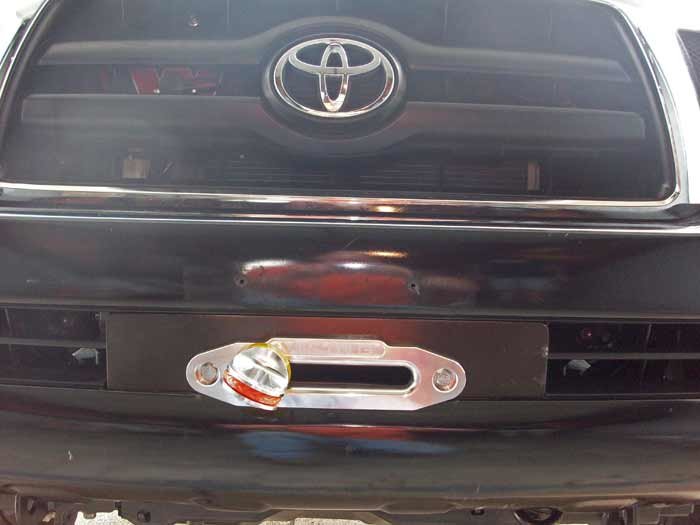

    Got the winch and winch mount installed. It's a strong platform, but I'm not thrilled with the amount of hacking I had to do on the bumper skin. The Viking fairlead I want would fit better with what I had to cut, so I'm replacing this one with the Viking. All around I'm happy with it. Still need to install the Viking thimble. I'll get around to that this week.
    Winchmount012_zps1b0d218e_c681ce8d32ca700a06fa3fc9760074993d22b485.jpg[/URL]
    This is the antenna for the wireless remote.
    And done....... for now. Need to trim a tad more and need to clean up the ruff spots. Going to get a sheet of aluminum to cover the trimmed area and the bumper, to protect the bumper from the winch line. Eventually when my bumper gets tore up, I'll replace it with a plate bumper.

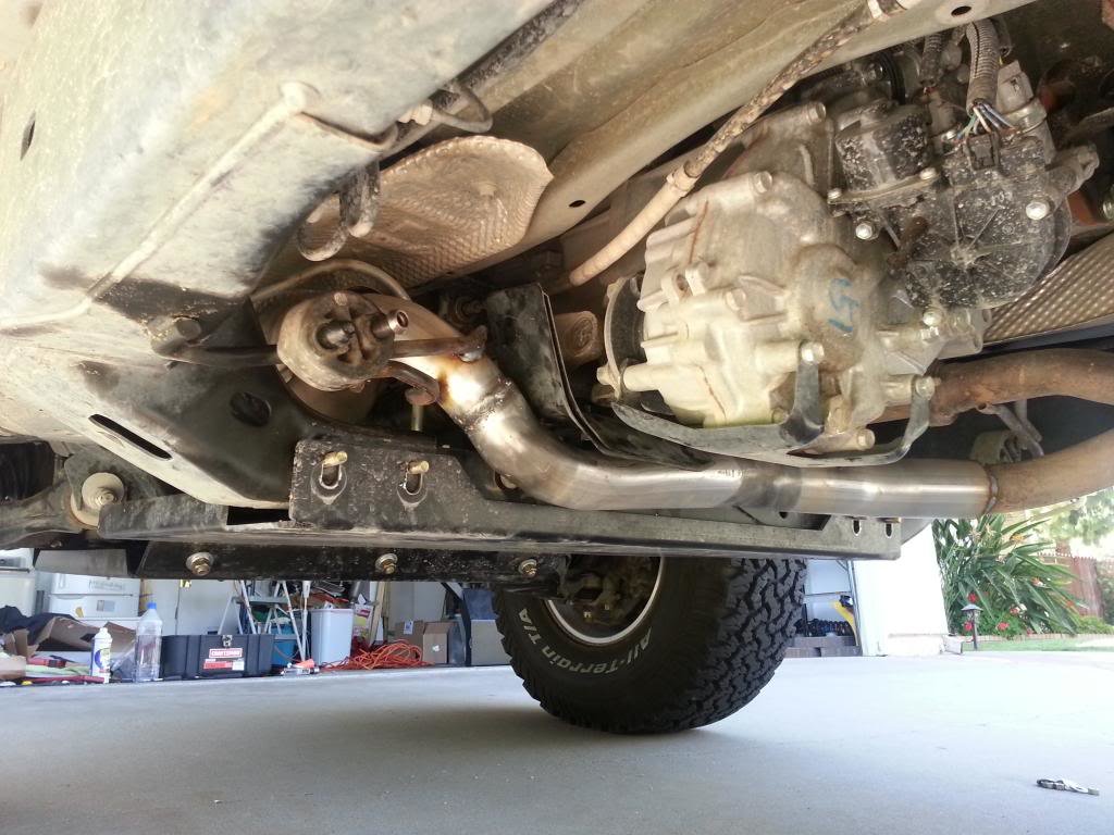

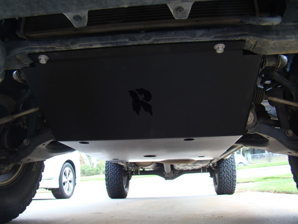

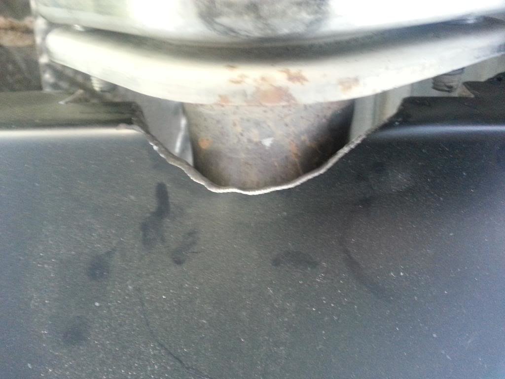

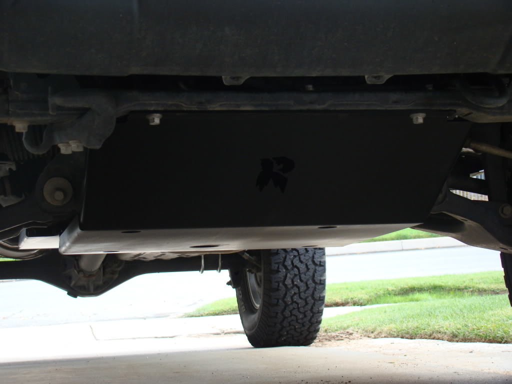

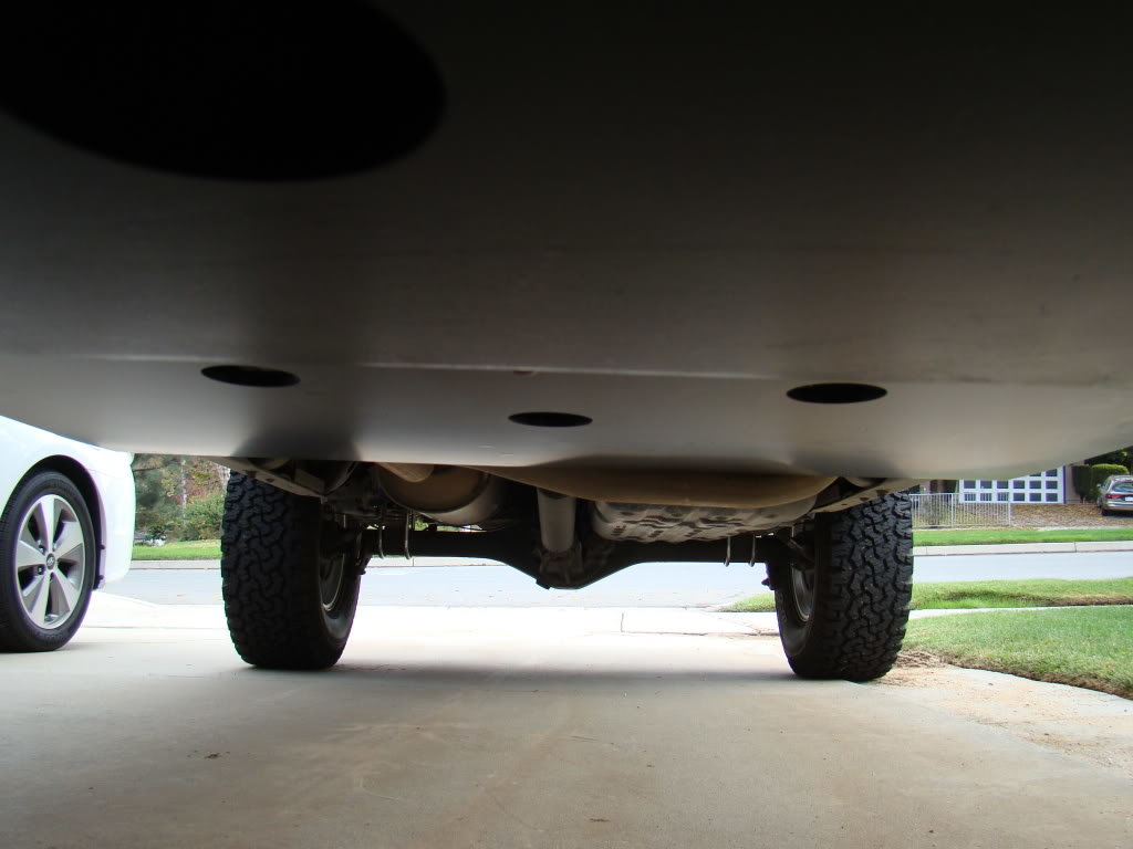

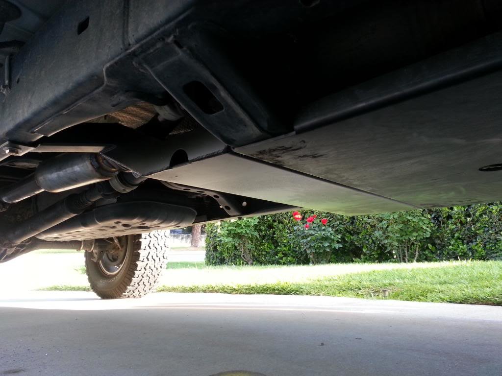

    Finally got my crossover pipe modified and got the transfer skid installed. Also got a resonator installed on my Magnaflow catback system. Made a difference and the exhaust tone sounds cleaner.
    This is the modified Y pipe, it's not pretty, but it gets the job done. Muffler shop made a bracket to raise the exhaust shield so the Y pipe could be tucked up higher. I have a 1/4 inch gap between the Y pipe and the skid.
    For those of you with 2012's and wanting Relentless fab skids, this is the modification you will have to do to make the T case skid fit without any contact with the exhaust.
    Now I just need my Relentless Fab sliders to arrive.
