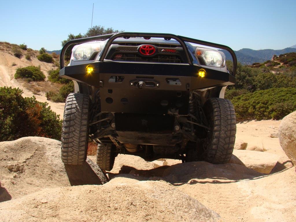

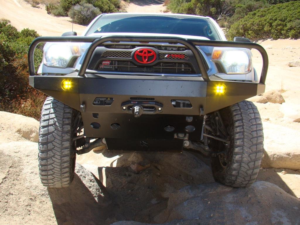

    I love this bumper!!!! Negotiating what lights I want to mount on it now.

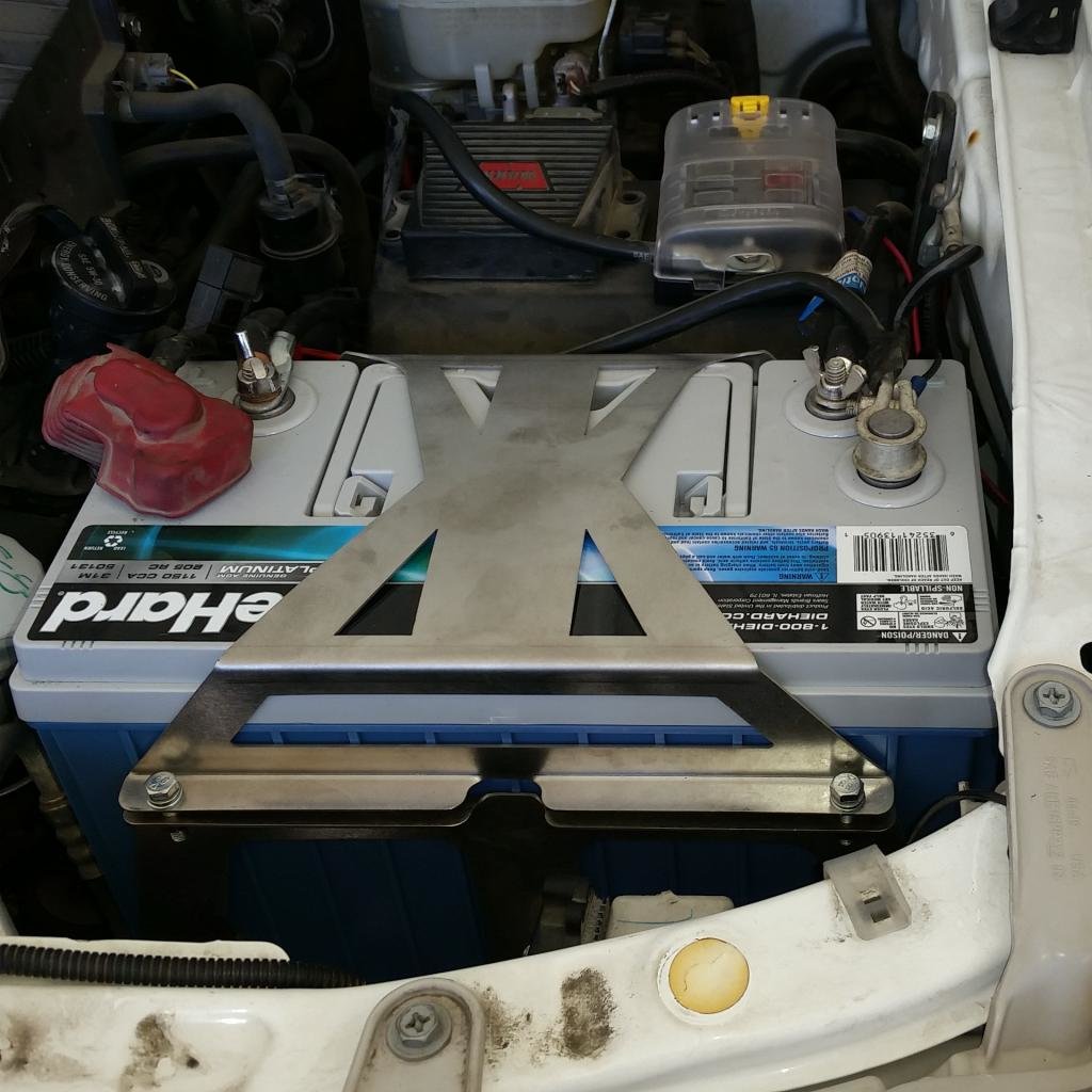

    Installed my new Diehard 31M battery and Pelfreybilt Offroad battery cage. The other option to a dual battery setup. Built out of stainless steel and mounts in the OEM location with heavy duty stainless J hooks. This thing is solid!!

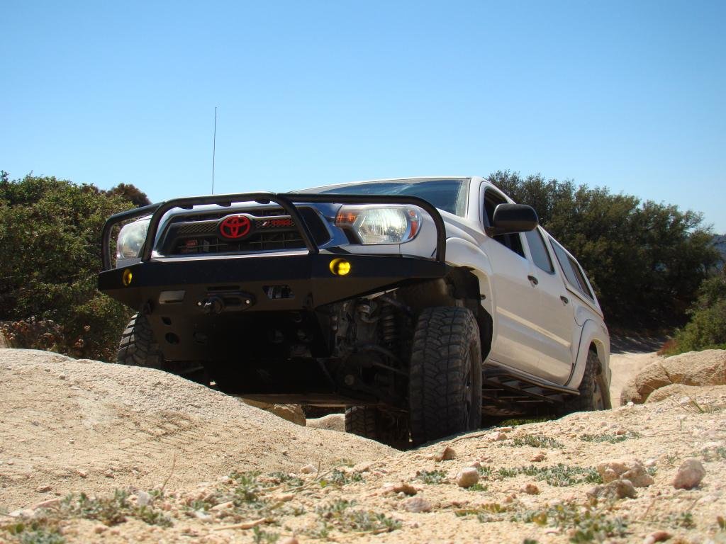

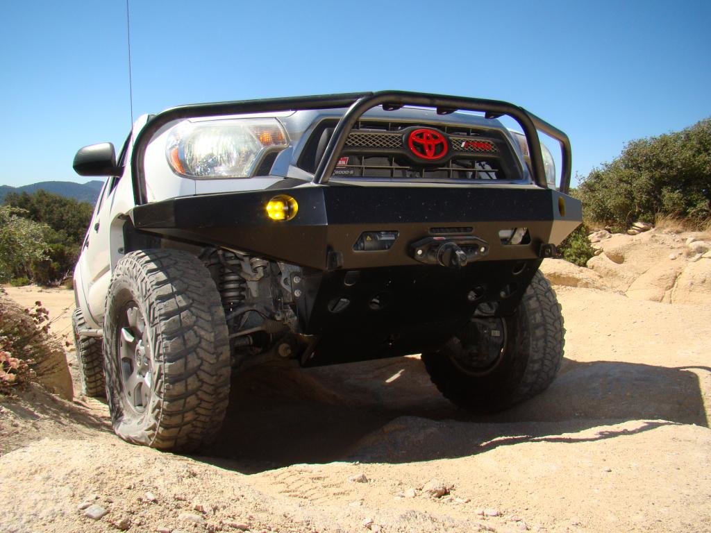

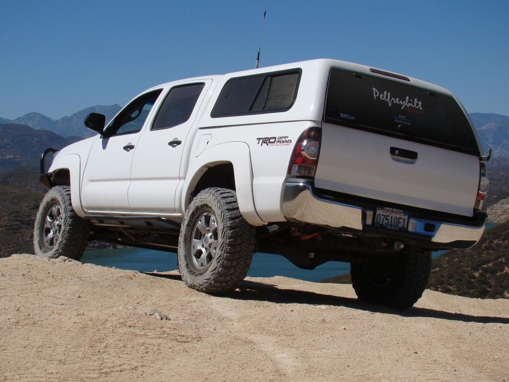

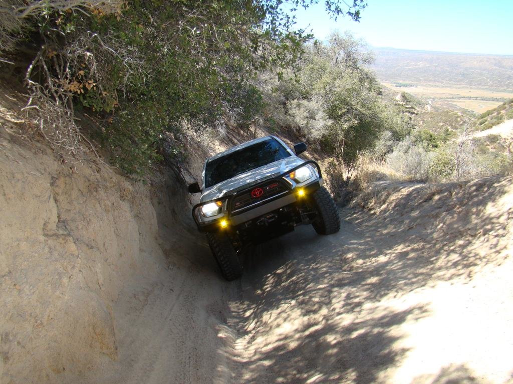

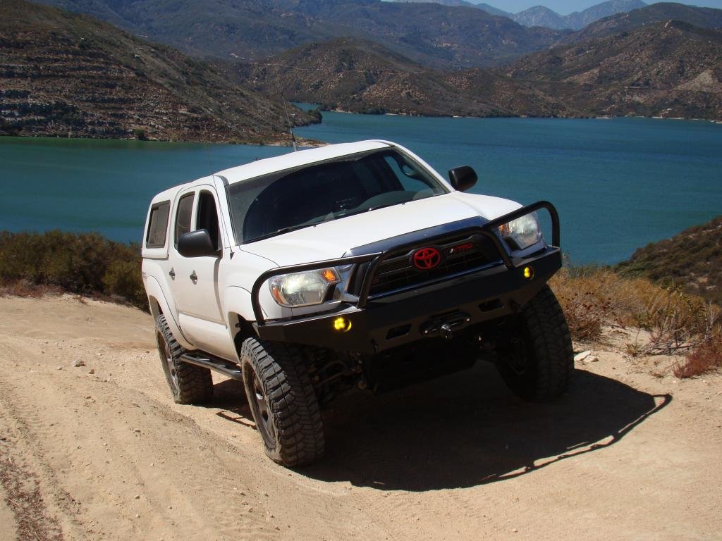

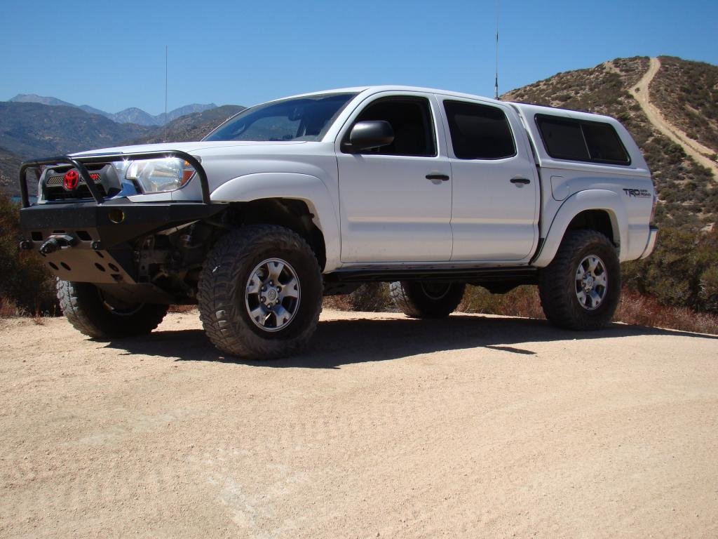

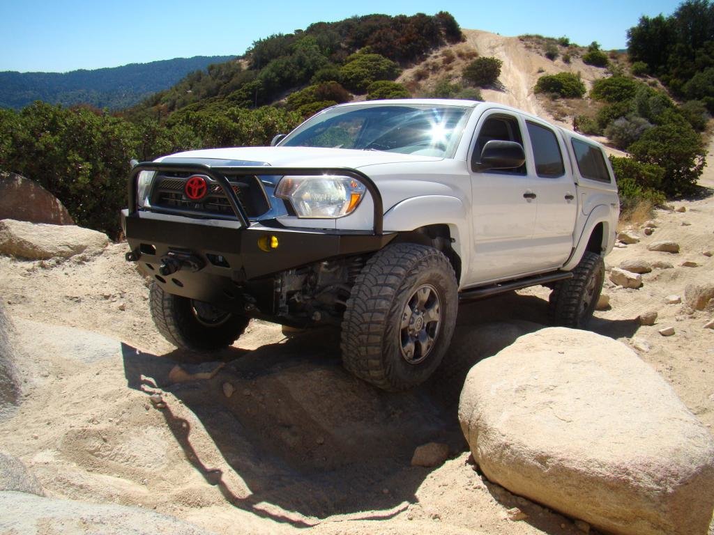

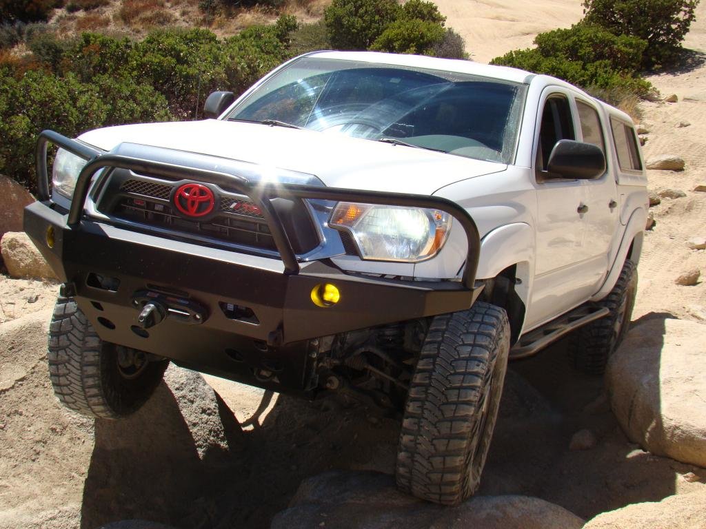

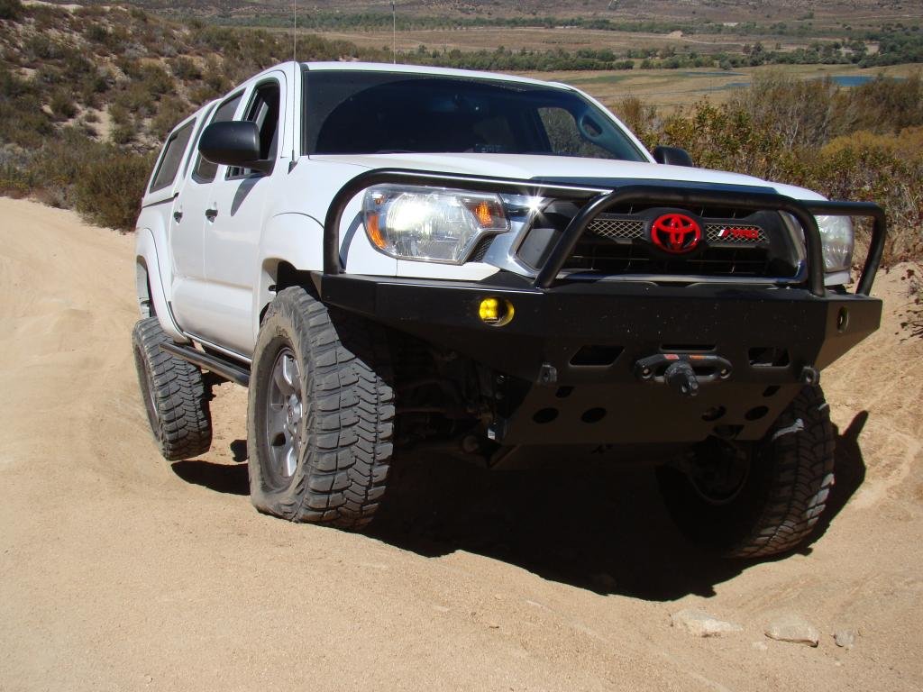

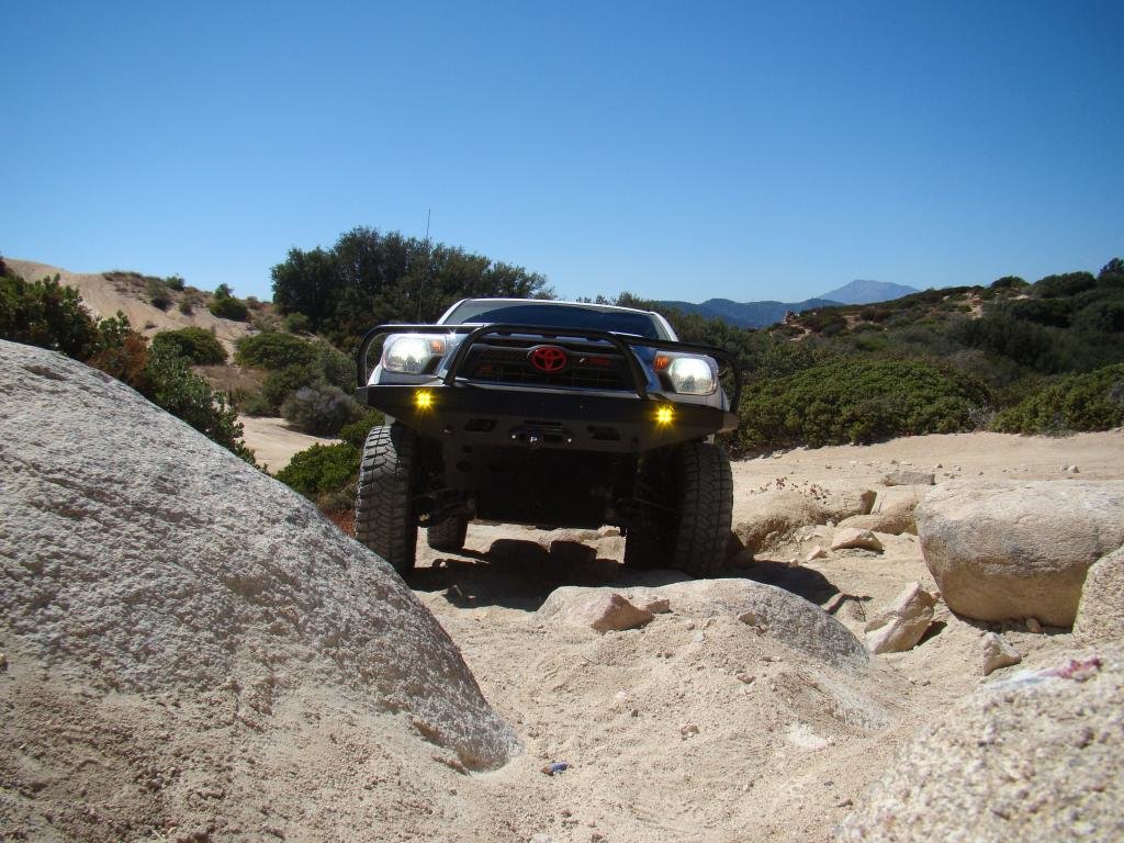

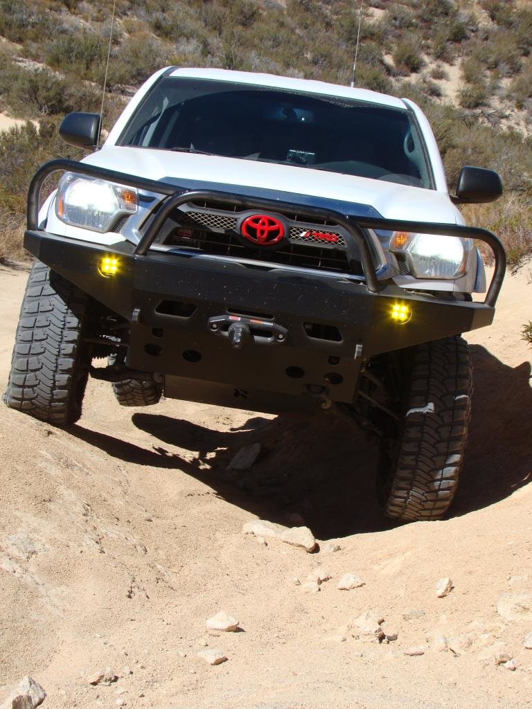

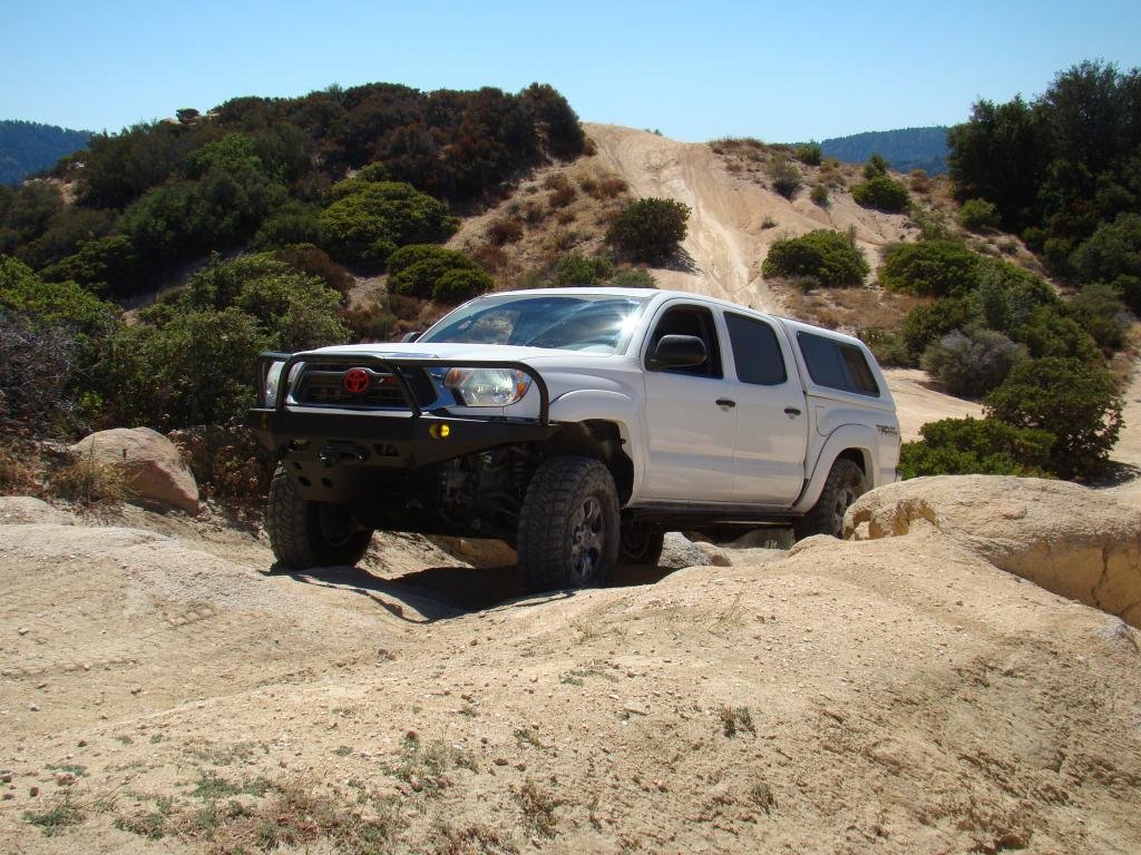

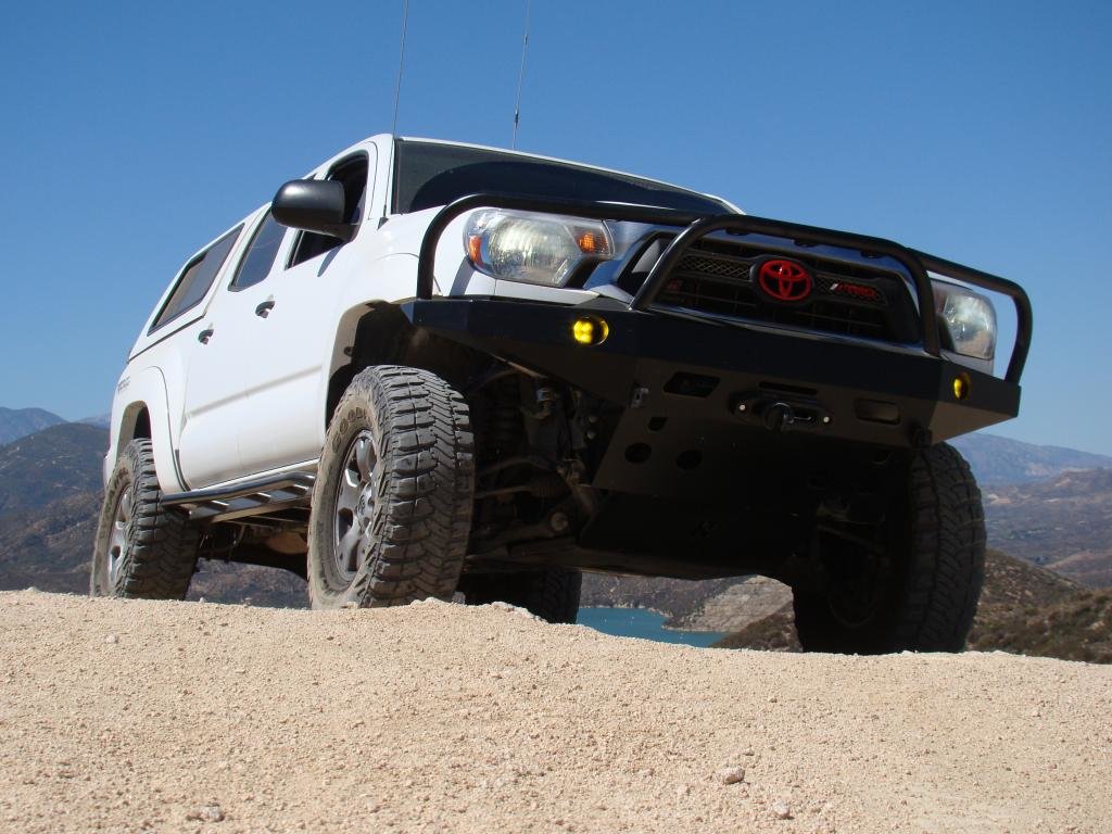

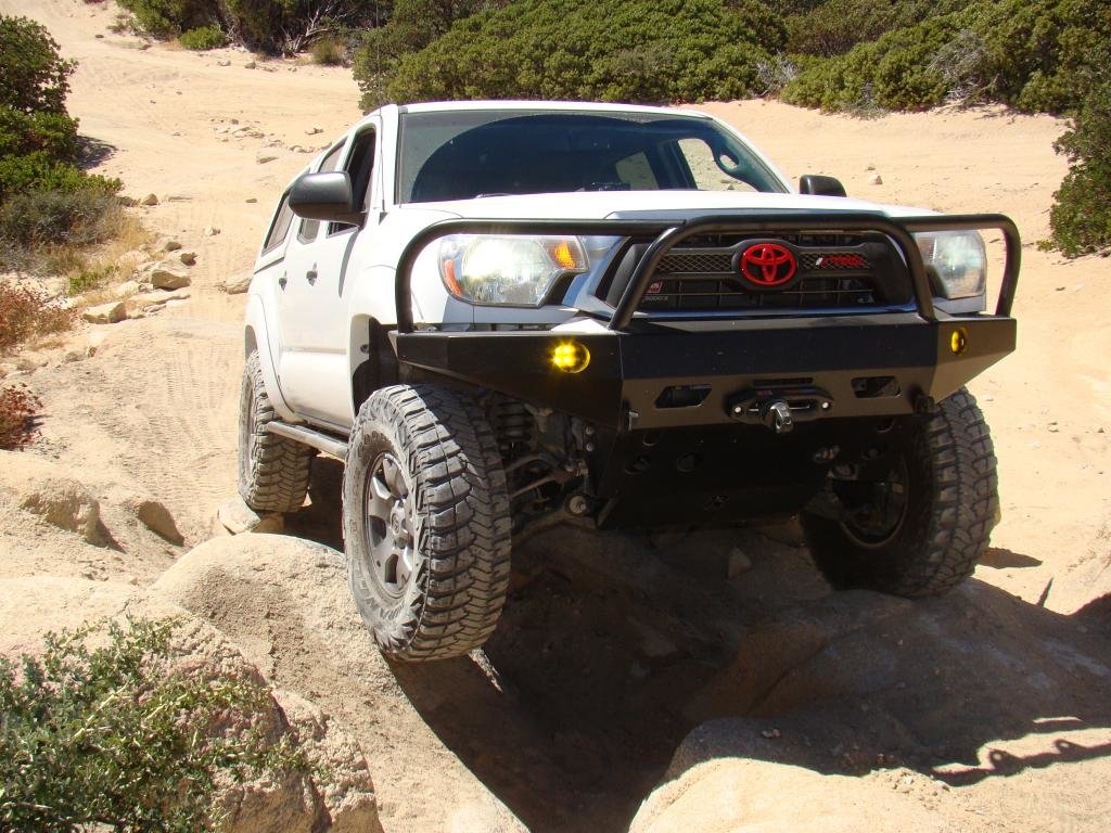

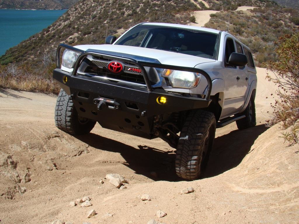

    Been a while since I've done an update. New pics of how my truck sits to date.

    Looks fun! The bumper :cool:

    Had a blast! I love the new bumper.:D

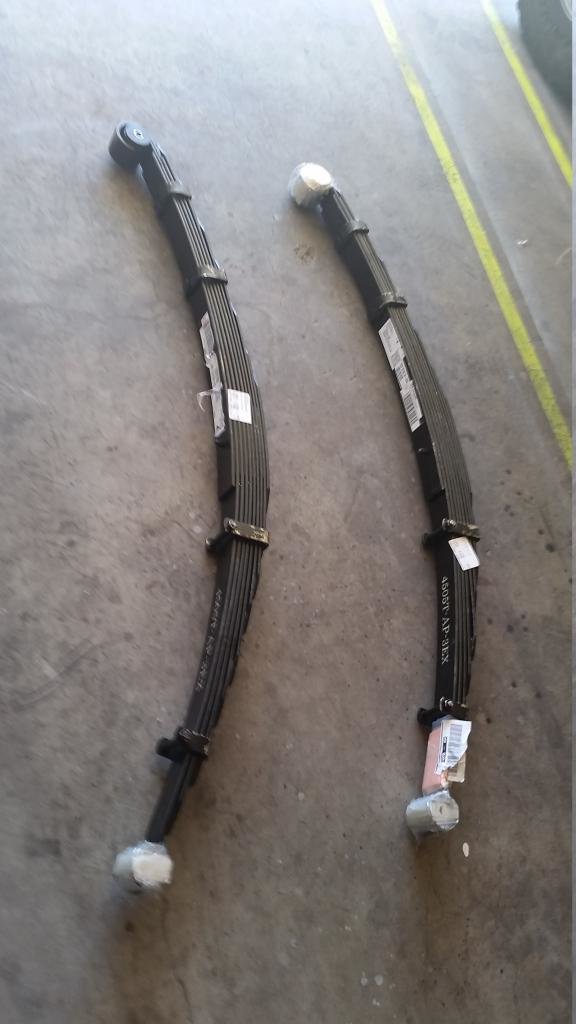

    UPS dropped off my Expo's just now!!!
    Hope to get these installed this weekend! Any one local who wants to help feel free to drop by!:wave::yay:
