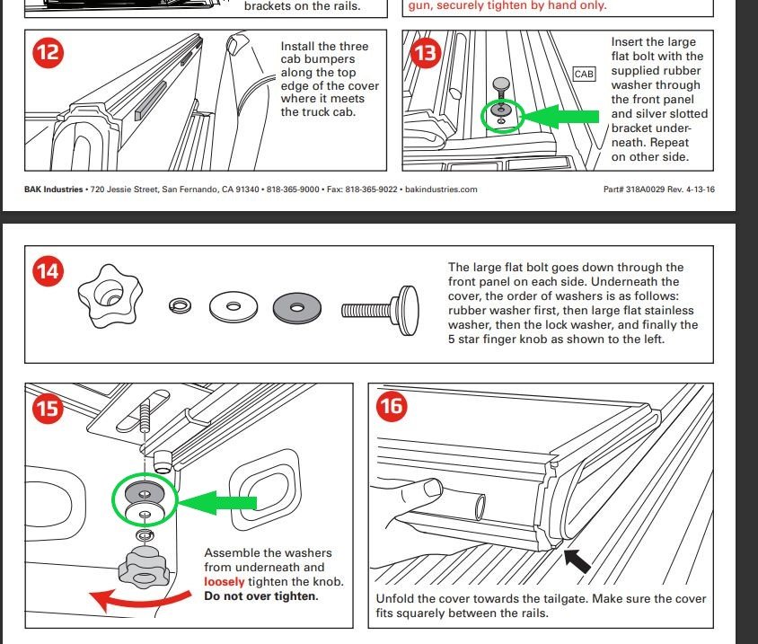

    I just installed the cover and there are 2 large rubber gaskets left over. There is no mention of them in the instructions. Could they be for the outside under the large studs ?

    If you look closely at the install instructions for the MX4, you will see that two rubber washers are used on the elevator bolts on the front of the cover. One washer goes under the head of the elevator bolt and on the topside of the cover, and the other washer goes on the elevator bolt on the underside.
    Now with all that said, I just ordered a replacement elevator bolt kit for my MX4 and it only came with 2 rubber washers.

    Correct, but as OP alluded to, the newer covers are coming with extra rubber washers (at least mine did), I had 6 in total.

    Just checked my instructions again and there is no picture or instructions that mention the second rubber washer. What year are your instructions from ? Strange

    Yep, same here on my new one for the 20, the older models had an additional rubber washer as mentioned / pictured (those are 2016 instructions) and the diameter was bigger to accomodate the bolts up front, instructions have since removed this and the rubber washer is different / won't accomodate the bolt. There has been incremental changes to hardware / design over the years on these, like I said have had one on my 17, 19 and 20 each time there was something slightly different when installing.
