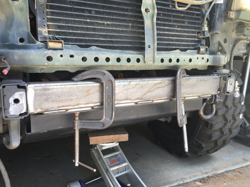

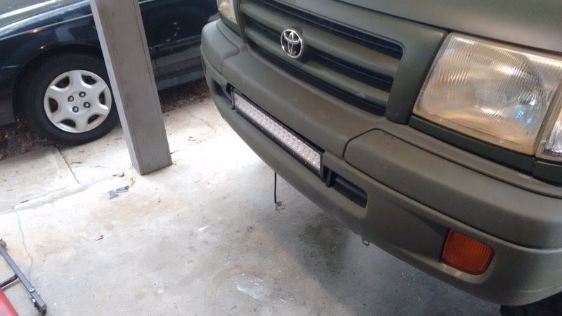

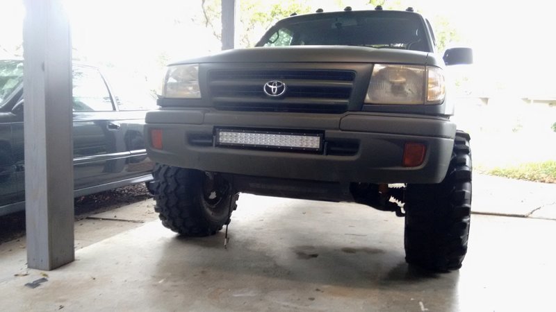

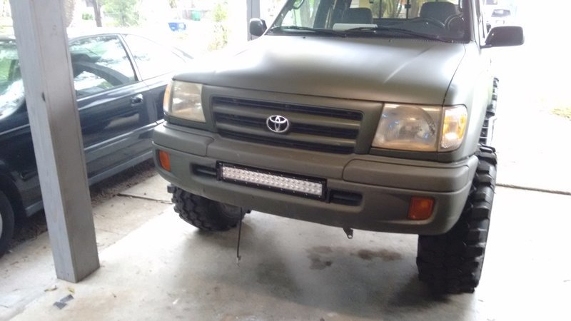

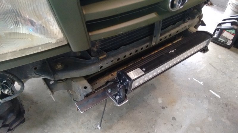

    So this is what I did today...
    [​IMG] [​IMG] [​IMG] [​IMG] [​IMG]
    I took it all back apart after the pictures, cleaned up the cutouts in the bumper and painted everything. Tomorrow I get to start fabbing the mount for the fuse block and relays. Then the real fun begins...:frusty:
  5. Apr 14, 2016 at 5:28 PM
    #245
    SpruceTaco
    SpruceTaco トヨタ
    May 18, 2012
    #79082
    12,271
    Clearwater, FL
    2012 Spruce Mica TRD Sport
    Tinted windows 5%, sill protectors, TRD stubby antenna, weathertech in channel rain guards, wheathertech floor mats, BHLM, Truxedo low pro qt, DTRL deleted, anytime backup camera, bed storage locks, fog lights on anytime, tailgate theft deterrent, painted engine cover, relocated horns, l.e.d bed lights, l.e.d engine bay lights, l.e.d lights above cup holders, in glove box, rear cup holder, in console storage & cubby next to steering wheel, Grillcraft grill, 17x8.5 SCS Ray10's, 35x12.50 Nitto Ridge Grapplers, Borla cat back exhaust, map & dome l.e.d's, TEQ badge on grill, Redline tuning hood struts, Maxtrac spindles, SPC Light Racing UCA's, Bilstein 5100's front set at 0 with OME 885's & extended length Bilstein 5100's in the rear, All Pro expedition leaf springs & 2" blocks, extended brake lines front & rear, 1.5" 4crawler drive shaft spacer, Beefed Taco carrier bearing drop, 1.25" spidertrax wheel spacers on rear, Kenwood DNX570 touchscreen with navigation, 30" led light bar in lower bumper opening, 1/4" top plate spacer drivers side, Bullet Proof Fabricating skid plate, Cali Raised ditch lights & Rago f Fabrication brackets, Amp Research power steps, smoked l.e.d 3rd brake light, Wet Okole seat covers, under cab LED'S tied to dome circuit
    Turned out good!

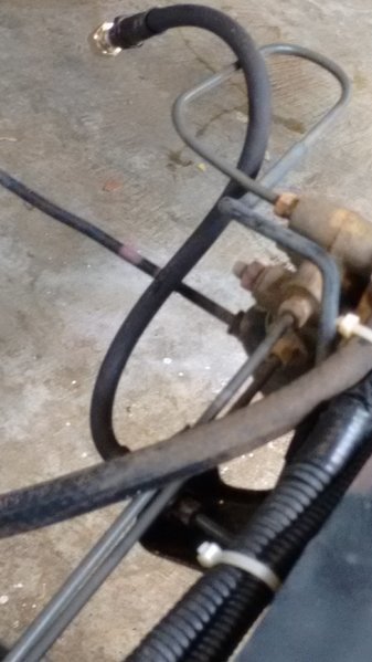

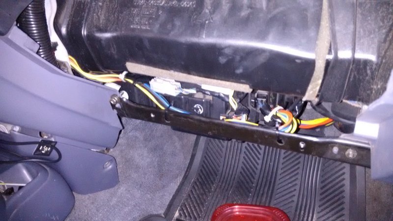

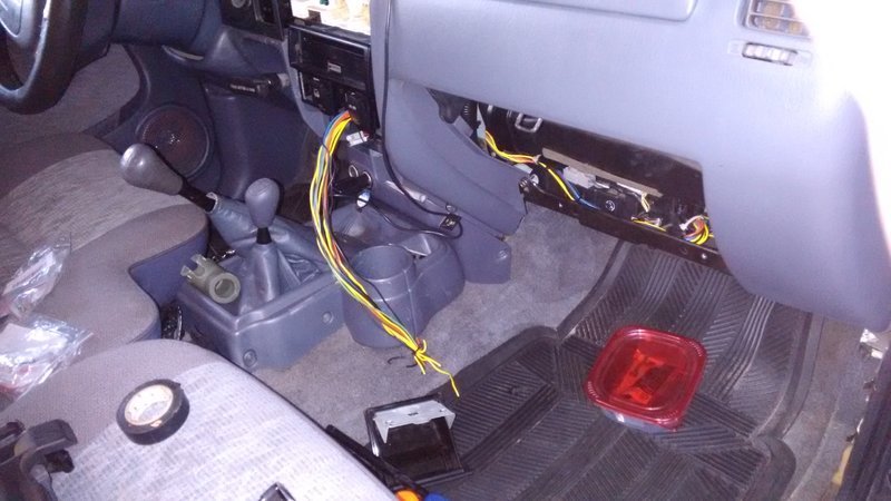

    After several days of screwing around, I'm pleased to say that the under-hood portion of my aux fuse panel/accessory switches & relays project is complete...for now. :yay: It didn't come out as clean (especially in that back corner) as some folks can achieve around here, but considering I hate wiring, I can live with it. o_O
    (sorry for the crappy pics, I can never get the stupid phone to get clear ones for some reason)
    IMG_20160420_195211676.jpg IMG_20160420_195234548.jpg IMG_20160420_195251862.jpg

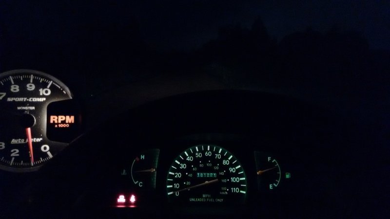

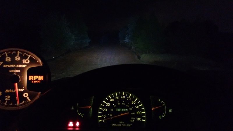

    I tested my light bar out this morning at about 0300. Conditions were damn near optimal. The roads were wet from rain we just had so they absorbed light more than reflected it. At first, on the access road behind my house, I didn't think I was going to be terribly impressed. Yes, the light bar lit things up better than my headlights, but it didn't really wow me.
    But then...then I drove over to this retention pond complex over by the Rec Center and pulled up to the entrance used by maintenance crews when they bush hog the area. It was amazing. With just my headlights, I could see almost nothing, especially since I was parked at the top of a short incline (5-8 ft drop I'm guessing). I could see a small yellow line of light from my headlights on the trees that lined the berm between the ponds that I was pointed along. Then I turned the light bar on...Wow! Now I could see the entire berm, the trees, from top to bottom, and everything. My headlights were a joke in comparison.
    A Rigid light bar would probably be a thousand times better. It probably would have set the trees on fire with the intensity of the light beam it put out, but this cheapo light bar is definitely not useless and I'm happy with it...for now (which is good considering the effort It was to get all that wiring installed). :thumbsup: Now it's just a question of whether it will stand up to off-road abuse--mud, water, bouncing over washboard trails...
    The pictures actually tell the story better than I thought they would, but they don't really do justice to how much was lit up...
    With just my headlights:
    With the light bar:

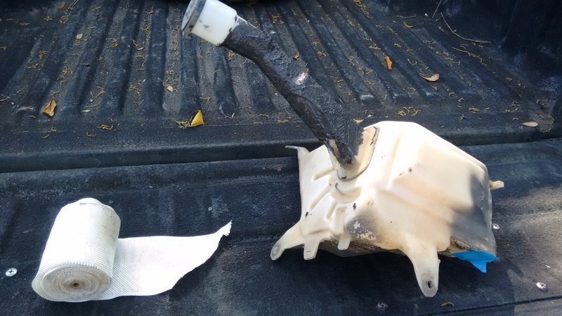

    So some time during the Annual Citrus meet, my anemic windshield washer pump gave up the ghost...I think. Anyway, since I was doing some trouble shooting on it anyway, I figured I'd pull the reservoir out and do a much overdo repair on the filler neck which has the typical dry rot and cracking going on. The PO tried to fix it with electrical tape which worked about as well as expected. o_O
    I removed the tape, flushed out the tank with a water hose and blew it dry with an air compressor. I then cleaned the cracked area with denatured alcohol (I would have used acetone if I had any, but the alcohol worked about as well). I then cut a few pieces of fiberglass cloth to cover the large hole and the cracked areas. Once that was done I smeared a layer of silicone RTV over the repair area. I then placed the glass cloth on the repair area and carefully smeared that with a layer of silicone one piece at a time until I was satisfied the cracks were covered.
    The glass cloth serves two functions: it sealed the large hole that had cracked out, and it reinforced the remaining plastic to prevent future cracking.
    Admittedly, I didn't make it look terribly pretty, but it's in an area that nobody will see unless they are looking for it, so I didn't get all anal about how good it looked. Anyway, here's the finished result along with the roll of glass cloth I used...
    BTW, a new reservoir costs about $115 bucks; this repair cost me nothing since I had the glass cloth and a tube of RTV that was about to go bad in my toolbox. :cool:

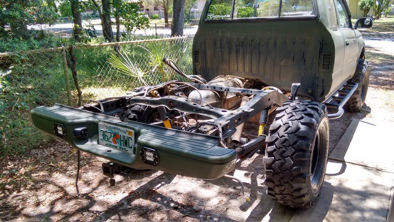

    [​IMG] [​IMG]
    Getting ready to head over to @allenfab 's to get some goodies welded on (CBI frame reinforcements, new longer spring perches, new shock mounts, and a new front crossmember).
    Thanks a bunch to @SpruceTaco @Hugopreston and @Scoobarooo for the assist! You guys rock! :hattip:

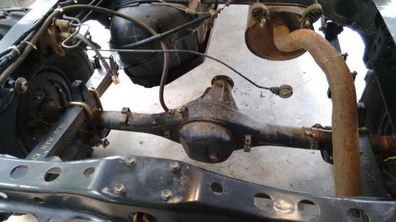

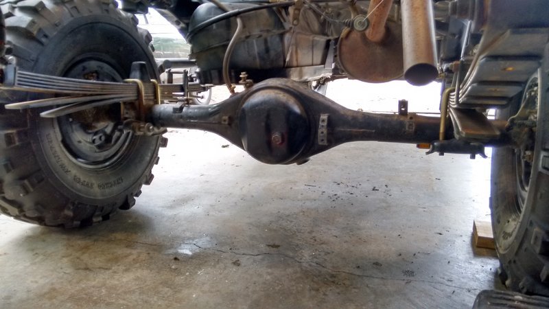

    Getting ready for some upgrades...
    IMG_20160517_093315389_HDR.jpg IMG_20160517_093324331.jpg IMG_20160517_093420398.jpg

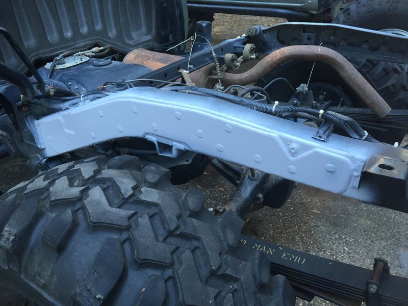

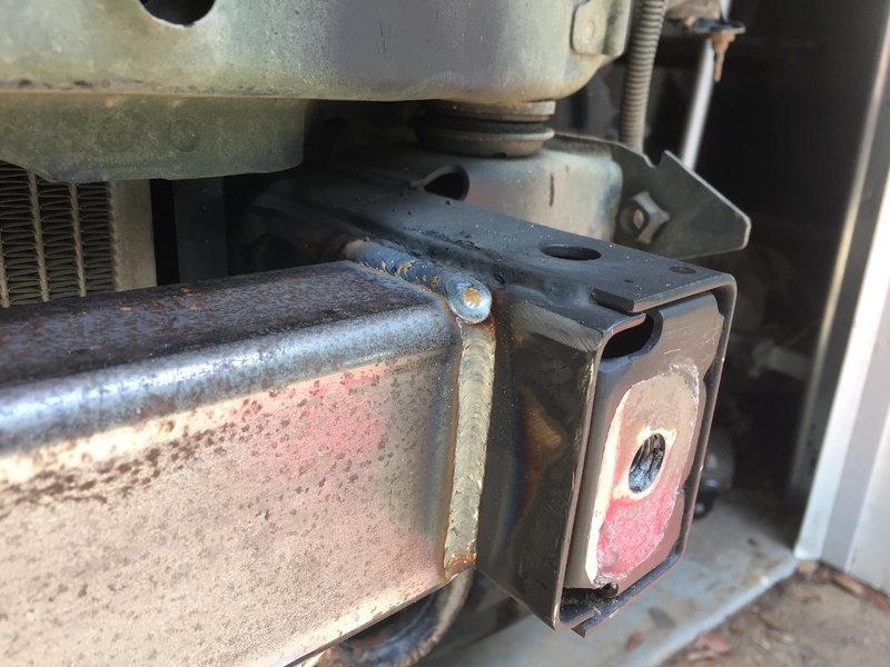

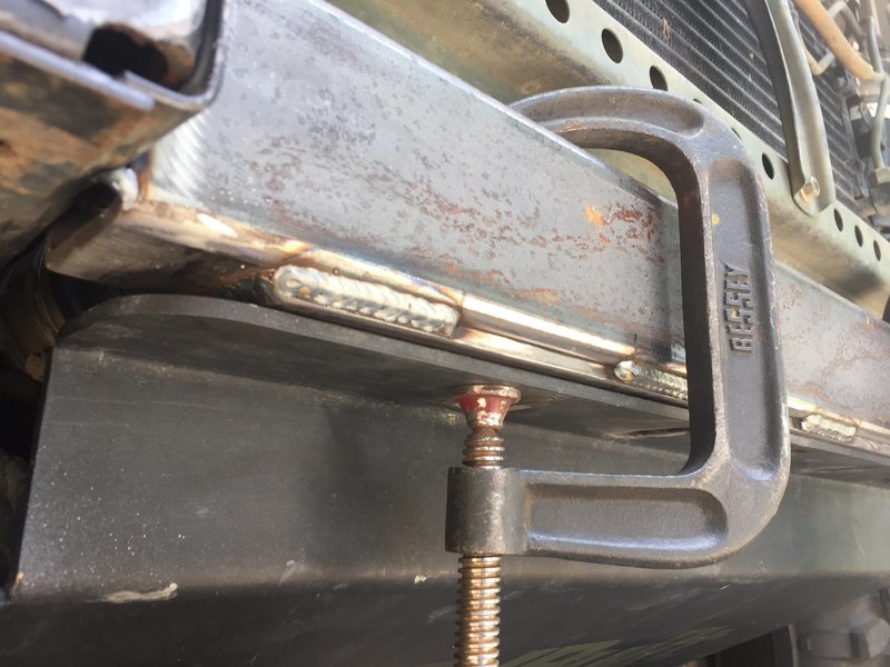

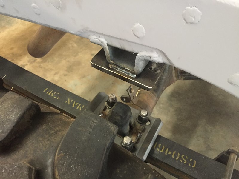

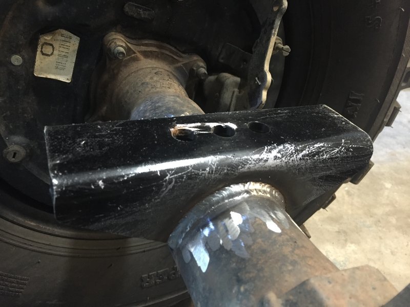

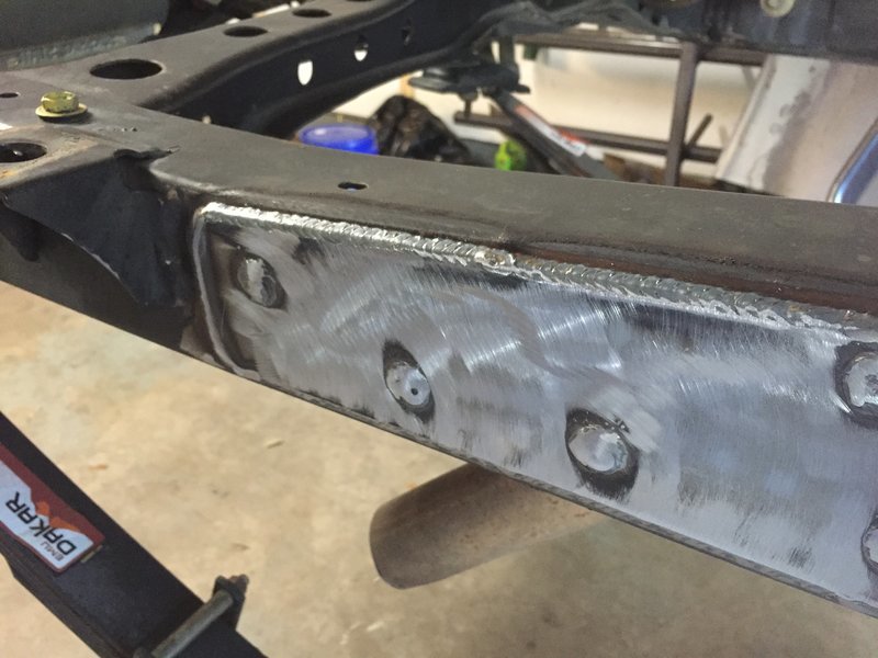

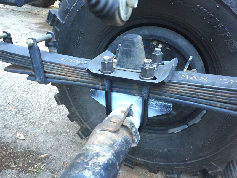

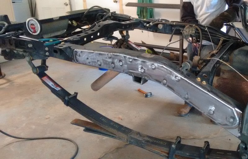

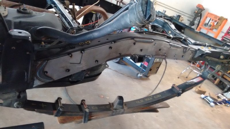

    Photo dump of Day 2 of @allenfab's upgrades to the OGT: :sawzall::welder::drool:
    The total list of things accomplished is as follows:
    -CBI frame reinforcements
    -Ruff Stuff Anti-wrap spring perches/u-bolts/top plates/shock mounts
    -New rear crossmember for upper shock mounts (fabbed by Todd)
    -Shock relocation
    -Adjustable bumpstop pads (fabbed by Todd and myself)
    -Extreme duty front crossmember/skid plate front mount (fabbed by Todd)
    -Axle located ~1" aft of previous setup thanks to the adjustable center pin holes on the perches and top plates
    It was a load of work and I'm still not done yet. I have to paint all the new steel, drill and tap the front crossmember for the skid plate bolts, and determine what length shock I need. Gonna pull the axle back out now that I have it home so I can clean it up and get a fresh coat of paint on it so that'll be a good time to take the spring pack apart so I can get a measurement between the shock mounts with it sitting on the bumps (which I figure will end up being about 1' less up-travel than the factory setup--.375" steel plate welded to the factory stop with a .375" aluminum pad bolted to that with the lower bumper sitting about .25" higher than it was due to the new top plate on the top of the spring).
    It's gonna be awesome. Like I said in the Tampa thread, I can't thank Todd enough for all the work he did for me. It's freakin' gorgeous. :fistbump::bowdown:
