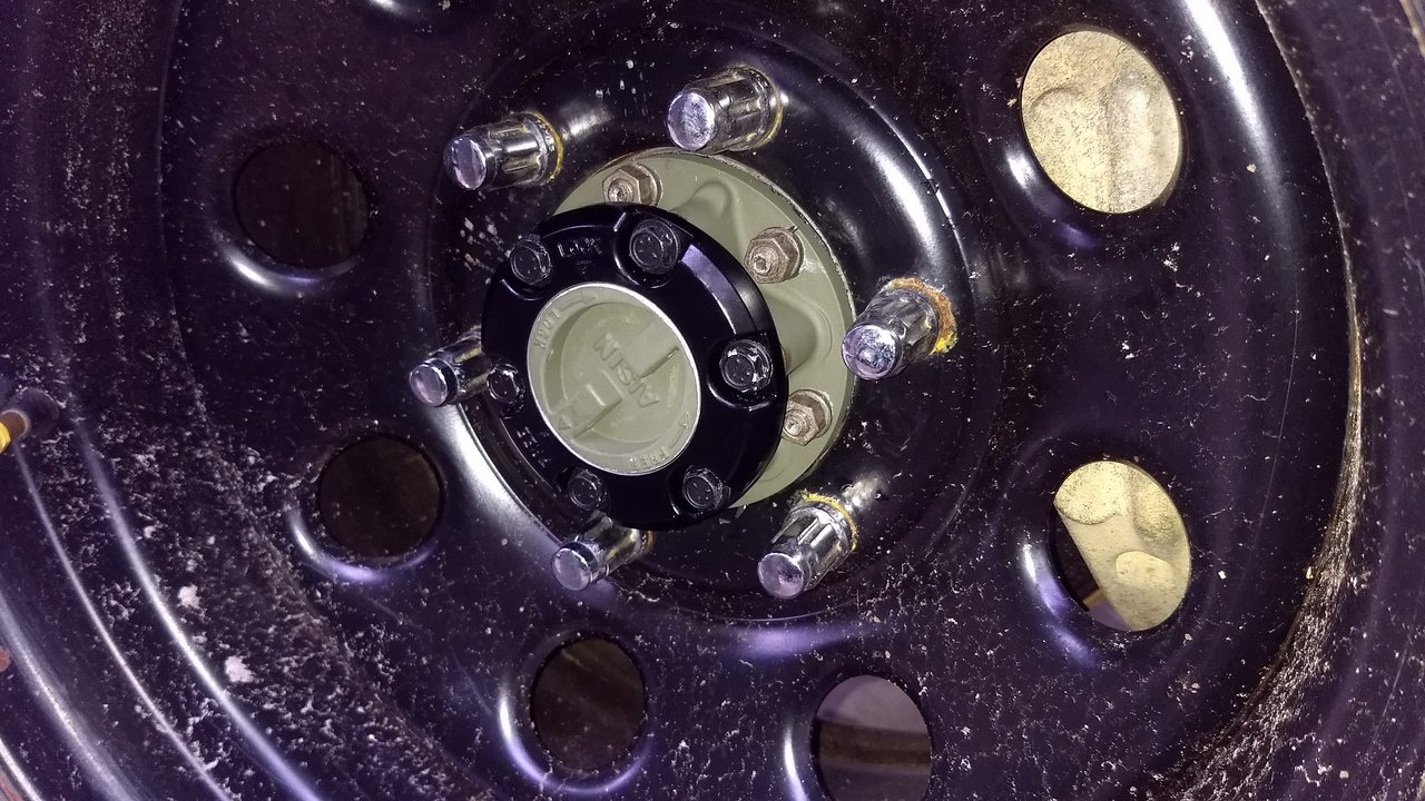

    Now I just have to hope the inner bushing isn't too tore up and then I'll just need a lockout. :fingerscrossed:

    :thumbsup: Me too. Got someone coming over to look at the t-case Sunday. Coming from 3 hours away so hopefully that means he's all but positive he's gonna buy it. Didn't ask about money either, so either he's planning to rob me or he's prepared to pay full asking, haha. o_O

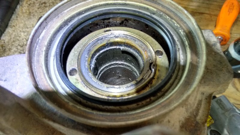

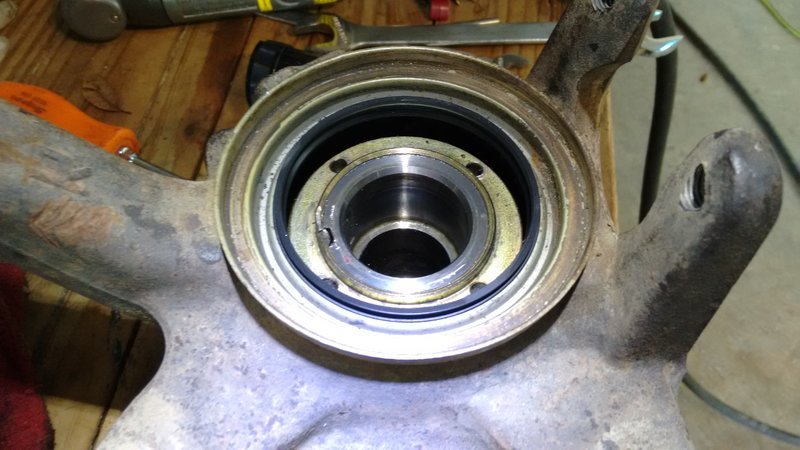

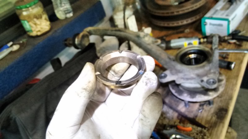

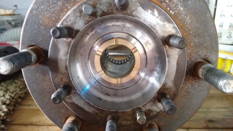

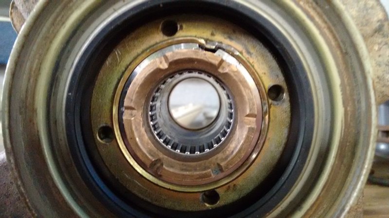

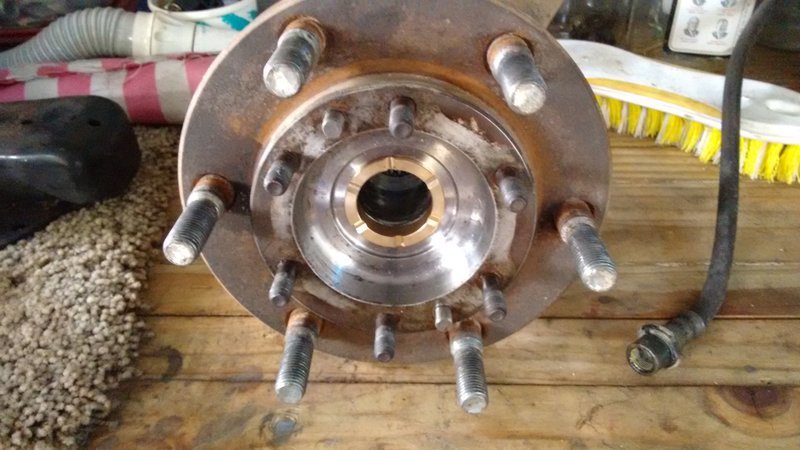

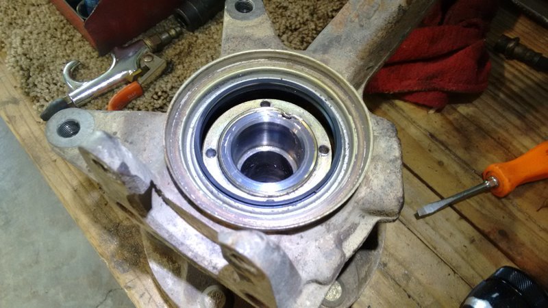

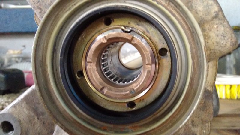

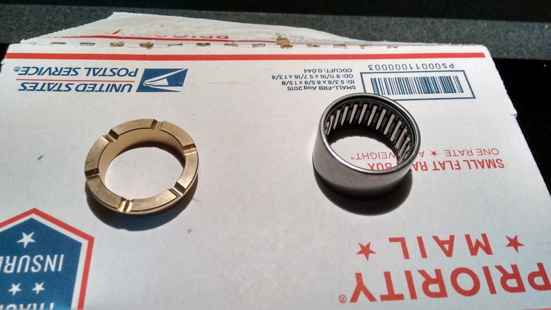

    Paid a visit to @allenfab today and picked up a few random spare parts for the OGT. We also pressed my new axle bearing and bushings in. Thanks a ton for the help, Todd! :hattip:
    This first part, getting the old bearing out, I did at the Baka shop. I was able to save the inner bushing which was good because it was out of stock...
    IMG_20170601_095542184_HDR.jpg IMG_20170601_100426740.jpg IMG_20170601_100439028.jpg IMG_20170601_100651641.jpg
    New bearing and outer bushing...
    After we got the new parts pressed back in...
    IMG_20170604_141252091.jpg IMG_20170604_141308429.jpg IMG_20170604_141333678.jpg IMG_20170604_141402180.jpg
    Thank gawd! This saved $250 for a new wheel hub + ~$70 for a new wheel bearing + ~$20 for new wheel seals + ~$60 for the machine shop to install the bearing and seals. Cost me about $50 with shipping for the new bearing and bushing. I'll take that any day (especially since this wheel bearing has less than 2K miles on it and it would have hurt my feelings badly to destroy it to put in a new wheel hub).
    Now I just need to find a new lockout. Worst case, I can get a brand new one from Low Range Off-Road for $128 + shipping, but I'm hoping someone has a used one they'll part with.
    Edit: Also, in the process, I discovered my UBJs were toast...again (I'm assuming if the passenger side is, then the driver's side probably is too). So I'll be putting the third set of those in in 4 years. At least they are free and not terrible to replace. :rolleyes:

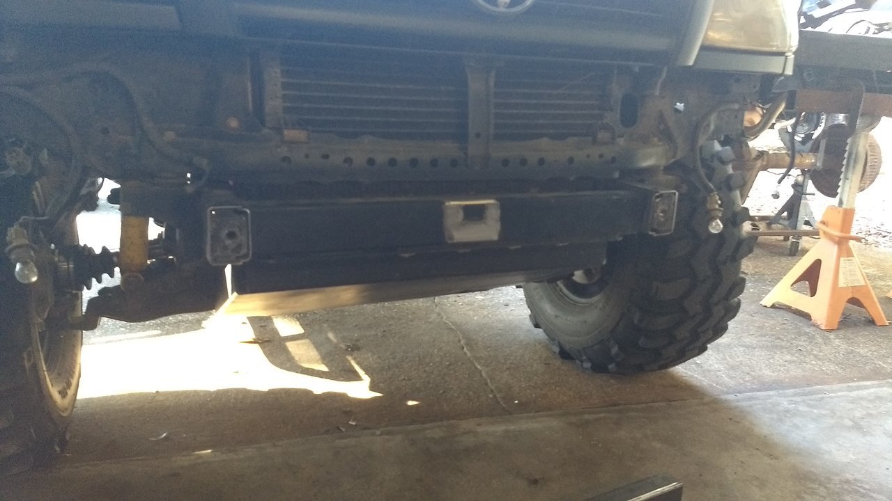

    So, after 5 and a half months, I went from this...
    To this...
    And the OGT is finally back in fighting trim just in time for the Fall Camp & Ride. :cool:

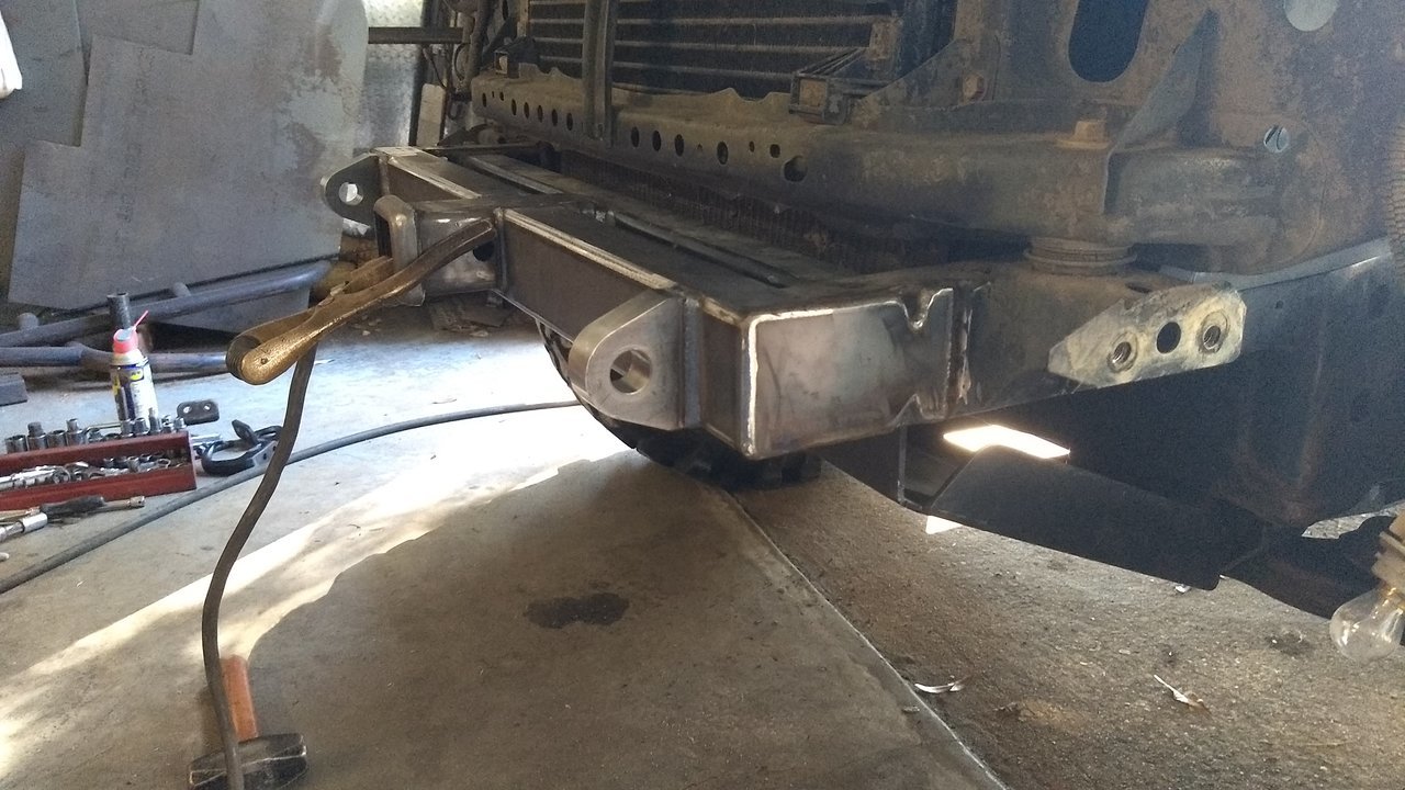

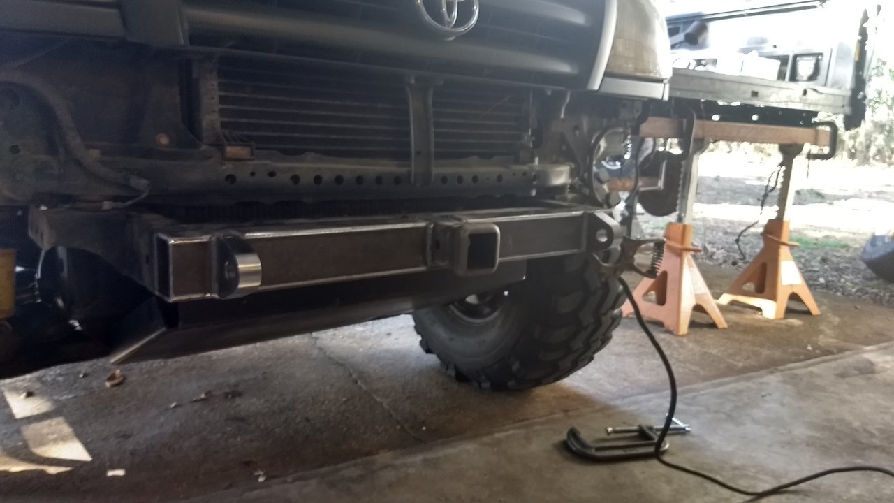

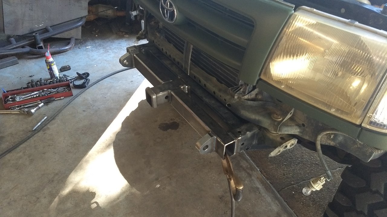

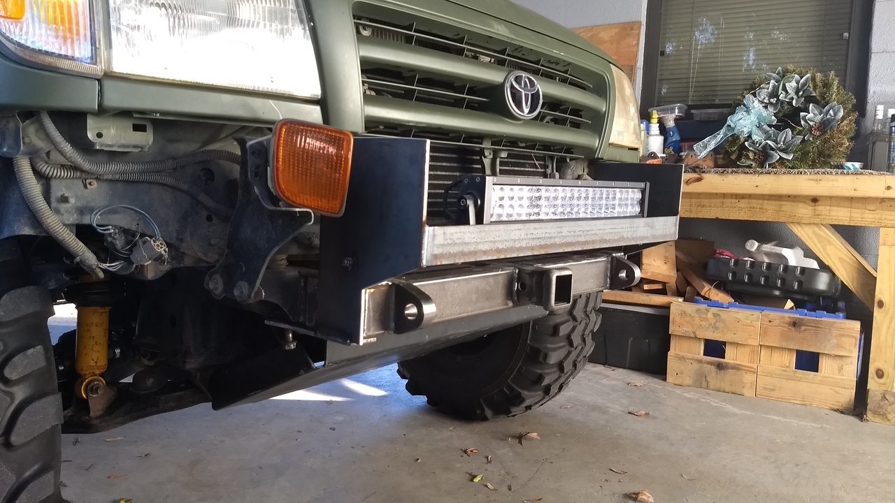

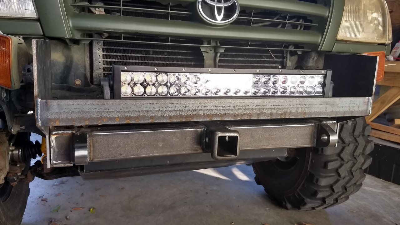

    Got phase one of the new front bumper knocked out today. @allenfab got the recovery points/receiver/front crossmember welded in and we got the base plates for the actual bumper made up with the lightbar mount. the rest of the bumper won't be done until after the Annual Meet unfortunately, but it's finally happening! :goingcrazy::woot:
    IMG_20180114_101247138.jpg IMG_20180114_111729904_HDR.jpg IMG_20180114_111752663.jpg IMG_20180114_114115745.jpg IMG_20180114_164737378.jpg IMG_20180114_164755929_HDR.jpg
    Oh, and Todd, as of this afternoon, the light bar is fully functional. It's probably going to wait until Citrus to begin communicating with aliens like John's ( @TacoTRD78 ) did, haha.

    That looks great Lee! Where'd you get those recovery mounts?

    Thanks! I got the shackle eyes and the receiver from Ruff Stuff Specialties. They have some fantastic fab parts. That's also where I got my super beefy leaf spring top plates, ubolts, shock mounts, and anti-wrap spring perches when we did the rear end.
