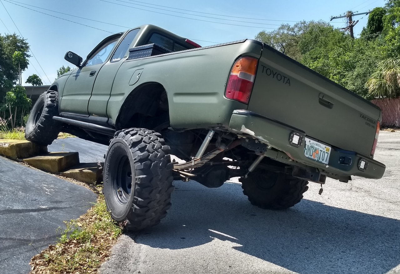

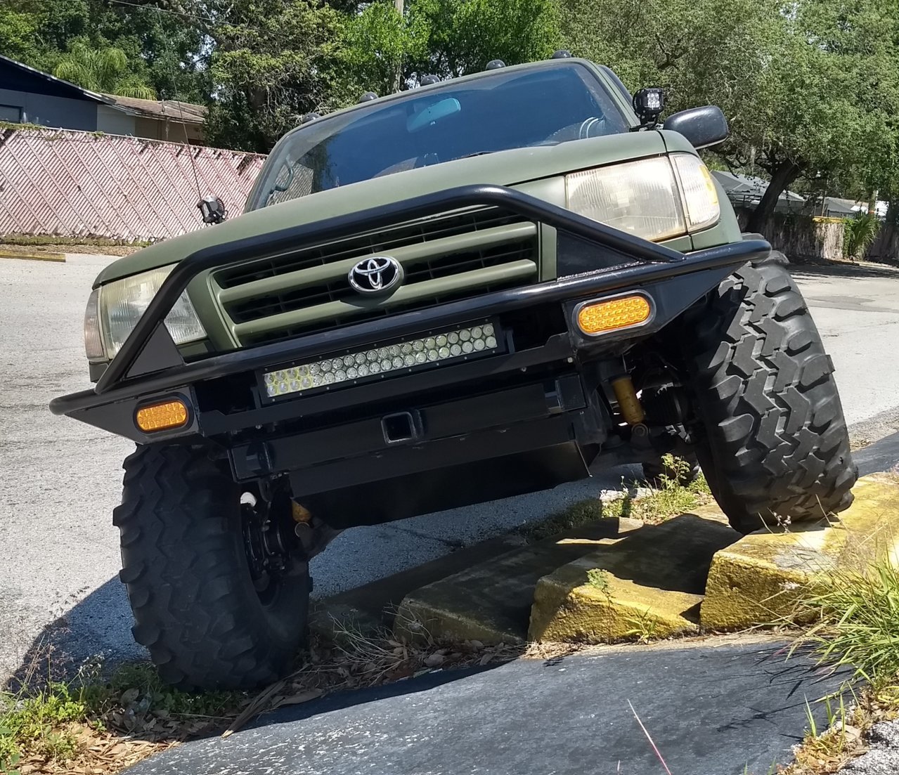

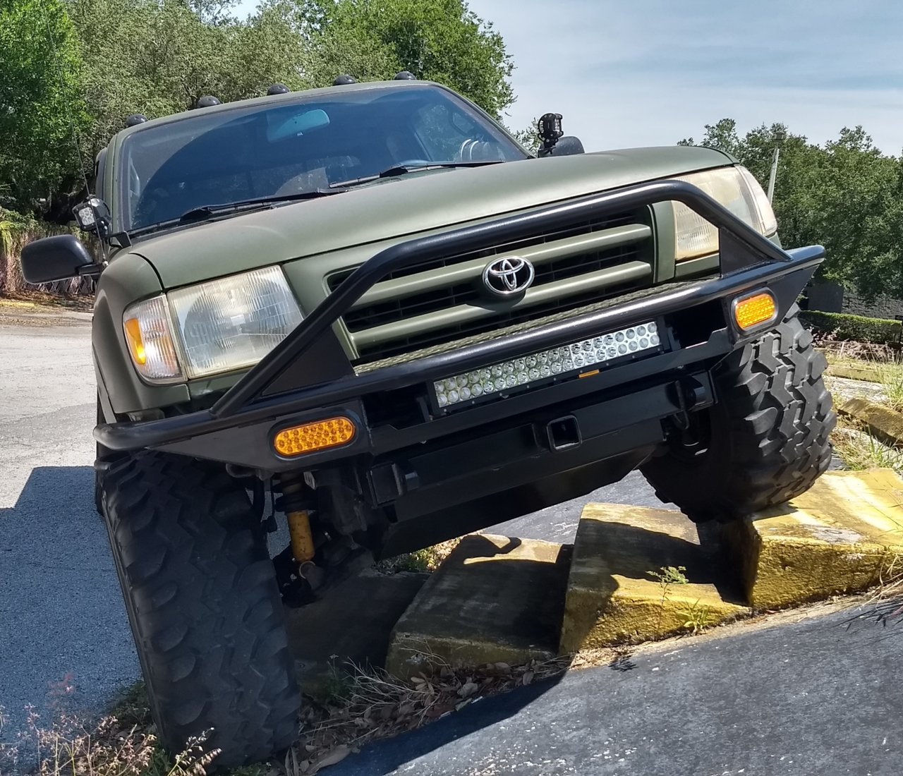

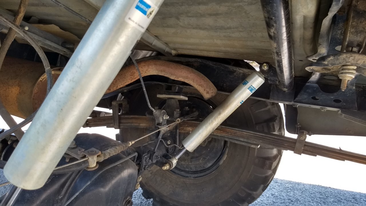

    Bumper pics, plus a little mall crawling. I managed to fully flex out the rear suspension. Looks like I might be able to go to 11" shocks if I wanted to.

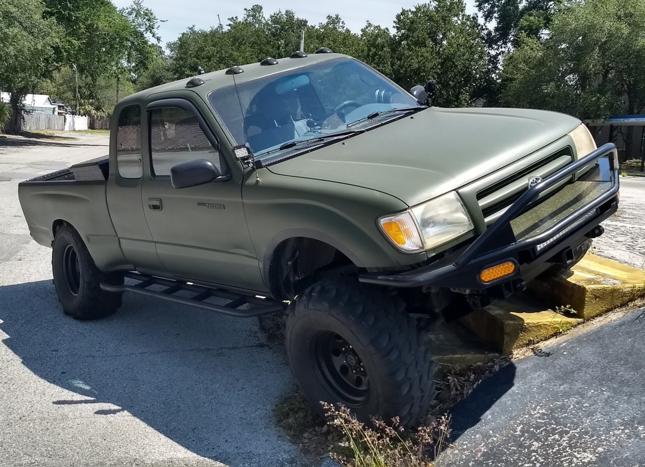

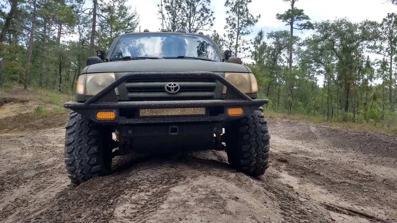

    The new bumper off road...
    The above images courtesy of @LMarshall73
    Anyway, she suffered some damage that trip. In addition to the busted CV, she also developed a radiator leak due to the fan contacting the radiator while I was in the water hole.
    After giving it a lot of thought, I think I'm going to go a new direction with the OGT. I still want to regear her to 4.88s, but I think when I do that, I'm going to lose the front Lincoln locker and have a Truetrac LSD unit put in. I'll lose a lot of capability, but, I also want to go up to 35s. I'm hoping the CVs with an LSD will hold up well with 35s and the 35s will give me a lot of the lost capability back I lost from having the front diff locked.
    Since I'm a cheap bastard and @allenfab politely declined to weld sheetmetal for me to tub my firewall to clear the 35s, I plan to make the clearance with a BFH, a 12 lb sledge to be exact. I've heard of some 3rd Gen T4R guys doing that, so I figure it's worth a shot. After all, I only have to move the sheet metal an inch and if I go with 35x12.50-15 LTBs, it should make it easier, especially if I get wheels with 4.25" BS. Dunno if I can do that though. I like the wide stance it has now and I don't want to give up too much side hill stability.

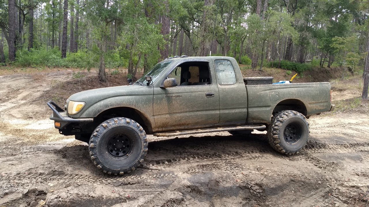

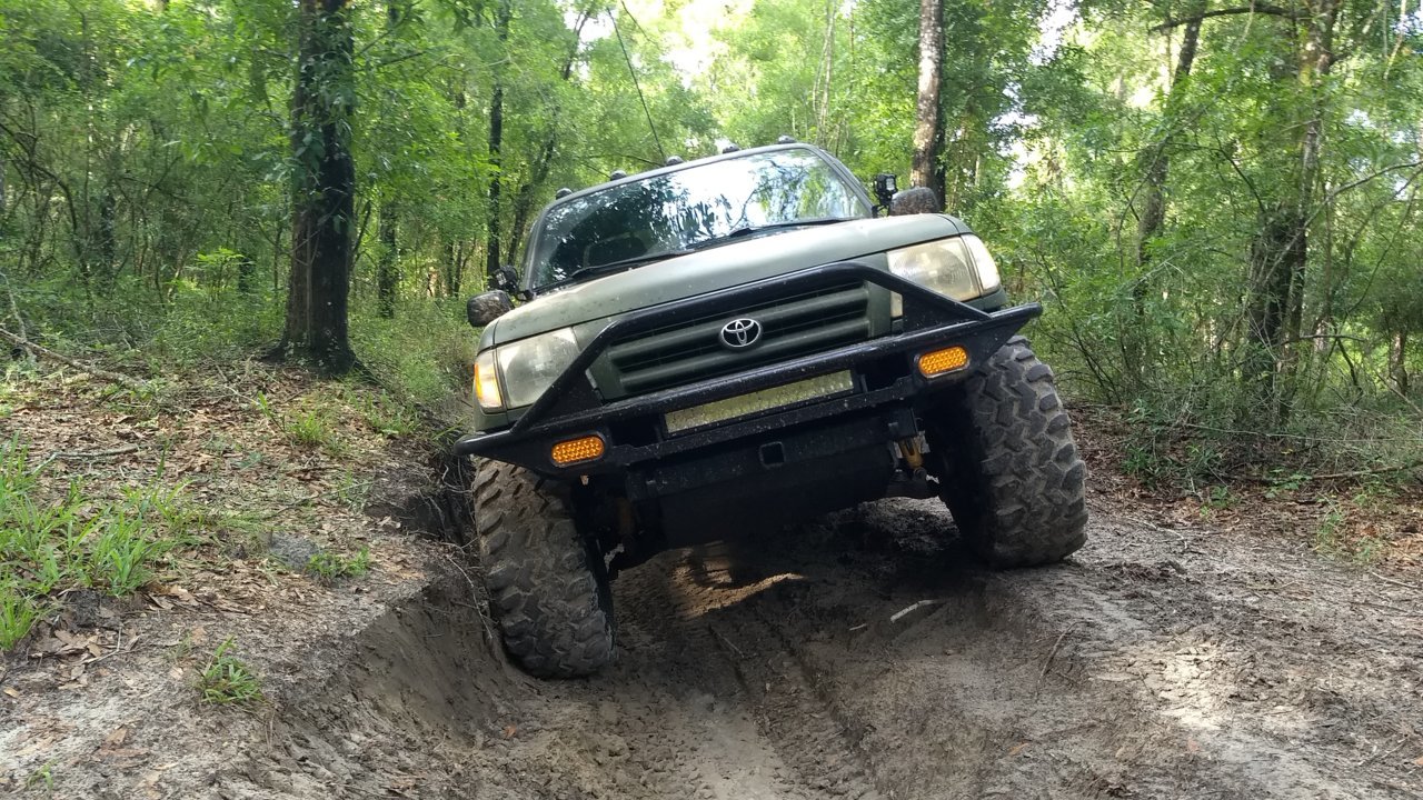

    Whenever I get aggressive with a recovery like in the above videos, I always end up tweaking my bumper so my tailgate won't open properly. I usually end up running a strap under the truck to the big oak tree in my front yard and after loosening the bolts, I yank it back down. Kinda tired of doing that honestly, but I'm not too far away from having an HC rear bumper with proper recovery points built.
    However, in the meantime, I've been thinking of alternatives. The problem is that whoever put my hitch on left out the aft set of frame spacers (about .50" thick) and I don't really believe that even if I put a stack of washers in there that the corner of the open "C" of the frame would be sufficient to keep the bumper from moving. So...I think I'm going to maybe try my hand at a little welding. I'm thinking of trying to find a piece of 3" x .25 angle iron, fitting it to the frame and vise versa and welding it in. Seems fairly simple and I can stick weld, though I'm very rusty at it, but I have access to a mig as well, though I've never used one.
    Anyway, I feel like this would solve the problem and stiffen the rear of the frame for when I eventually do get my HC bumper built.

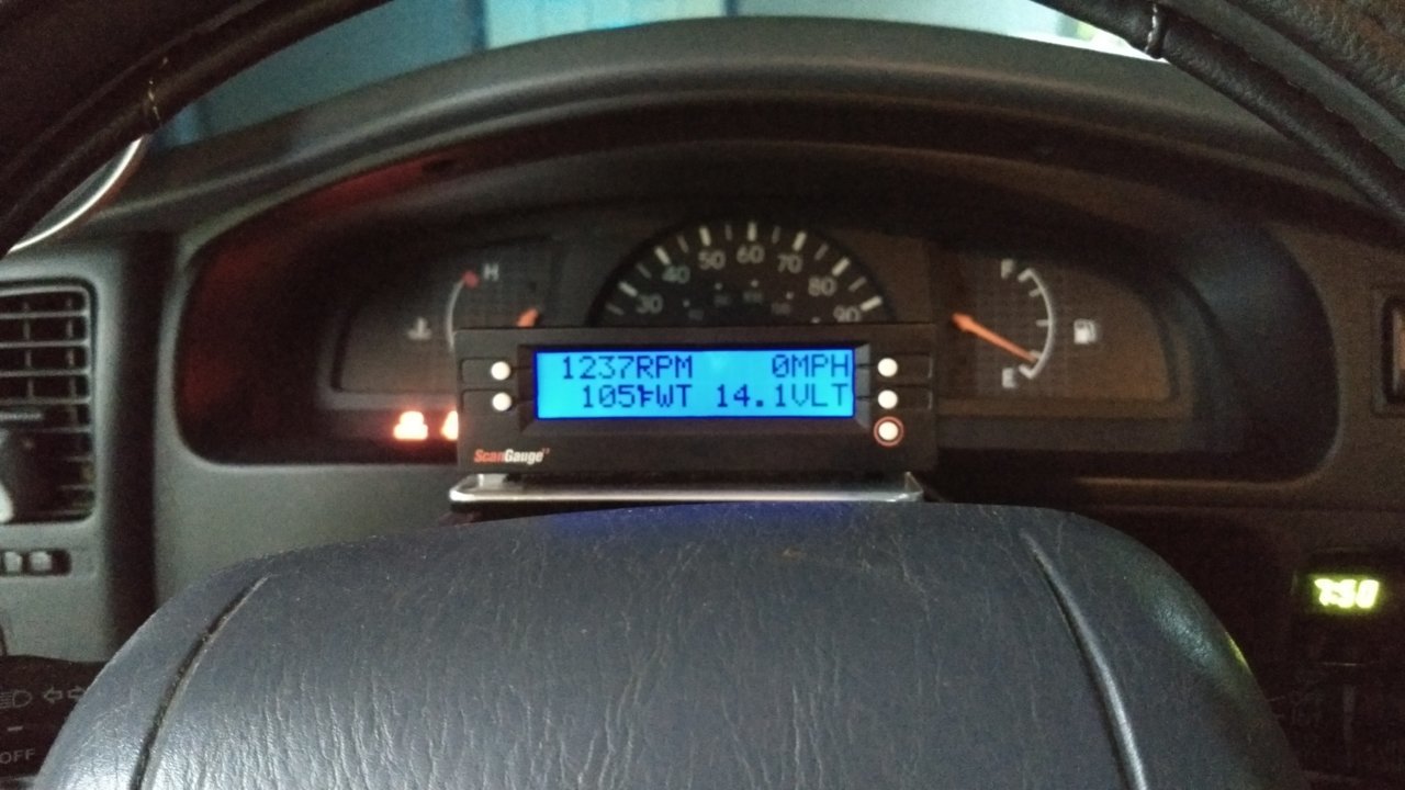

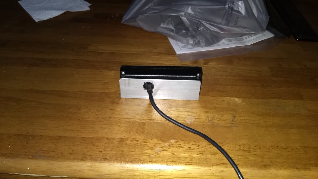

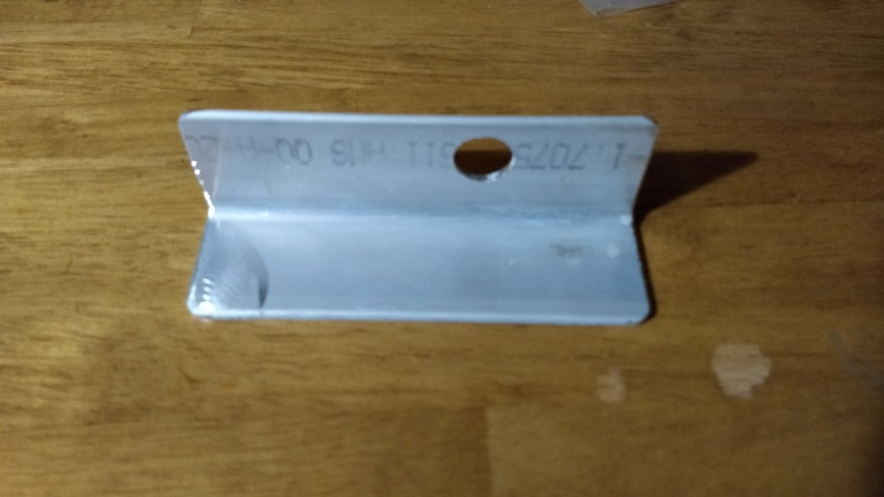

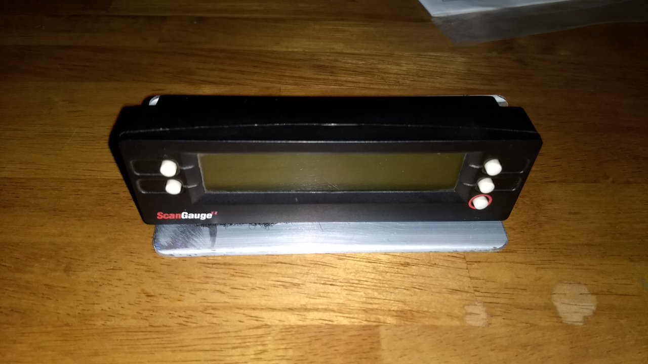

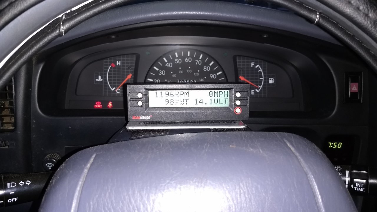

    Well, after poking another hole in my radiator at Richloam a couple weekends ago and discovering my factory temp gauge is unreliable, I finally got around to putting in the Scan Gauge II Todd gave me. Didn't like their mounting system...seemed like it would be too wobbly to me, so I fabbed a holder for it.
    IMG_20180625_192249964_LL.jpg IMG_20180625_192314313.jpg IMG_20180625_192509091.jpg
    Figured I'd stick with the velcro methode they used just with a wider base to make it more stable. I'm still not happy with its stability so I'm probably going to end up screwing it down. And it really doesn't block the instrument cluster as much as it appears to in the pictures. The camera angle was a lot lower than my eye height.
    Also it confirmed my suspicion that my Autometer Tach reads about 100 RPMs high, but no big deal, so i may move the RPMs off the screen and put MPGs or something there. Too bad it doesn't read oil pressure.

    Ya know, I might take the instrument cluster out and see if I can remove the factory temp gauge and then cut a hole in it and install my mechanical Autometer Oil Pressure gauge in the cluster. I think that would look pretty slick. Only thing would be the factory idiot light would be on all the time and I'd have to take the bulb out of it...or come up with some weird conglomeration of fittings that let me run both the idiot light sensor and the oil pressure line to the gauge.
