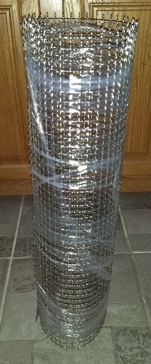

    Well, my radiator armor came in today...the day after I just put the radiator back in...:frusty:

    o_O Chicken wire?

    .063" Stainless steel wire mesh. But yeah, it does look like chicken wire, lol.

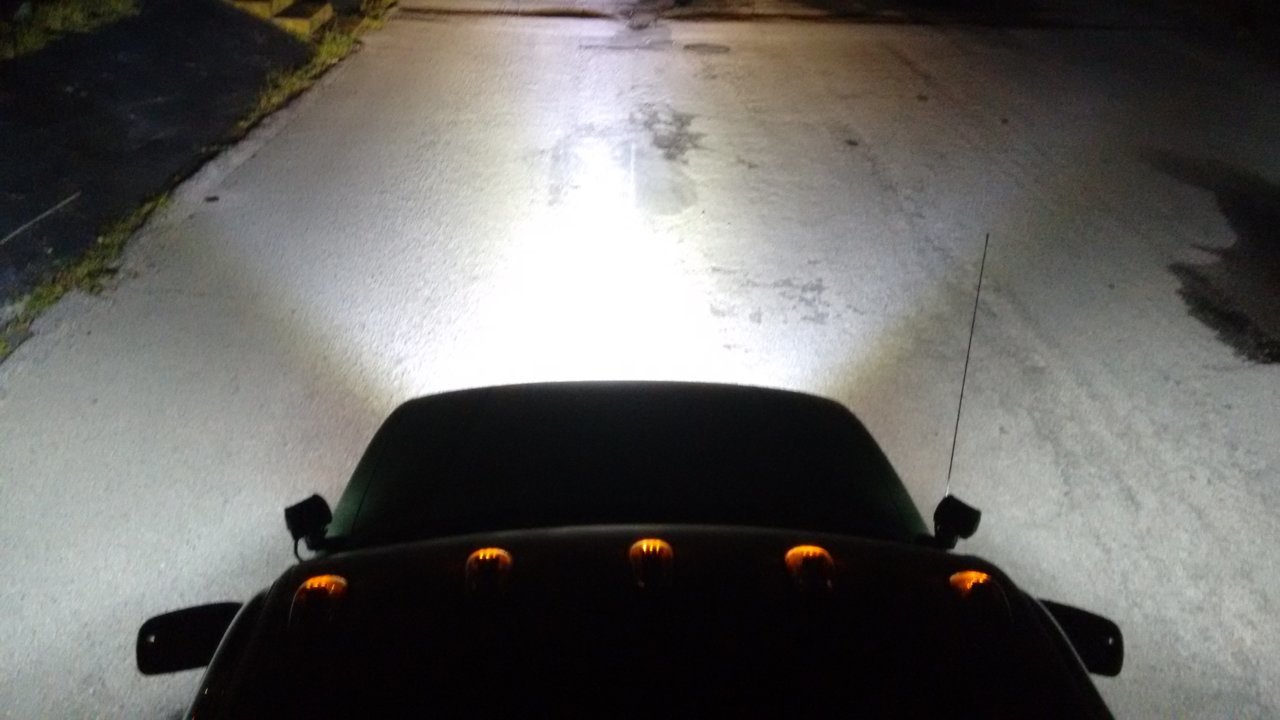

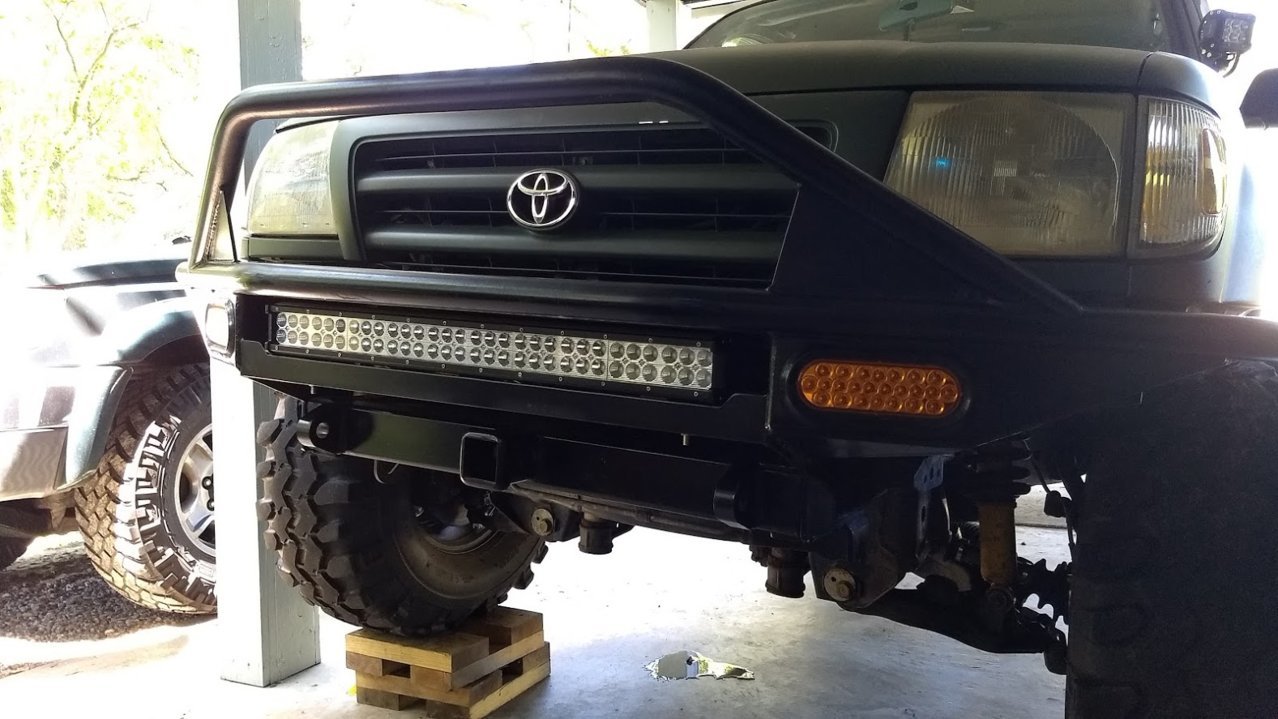

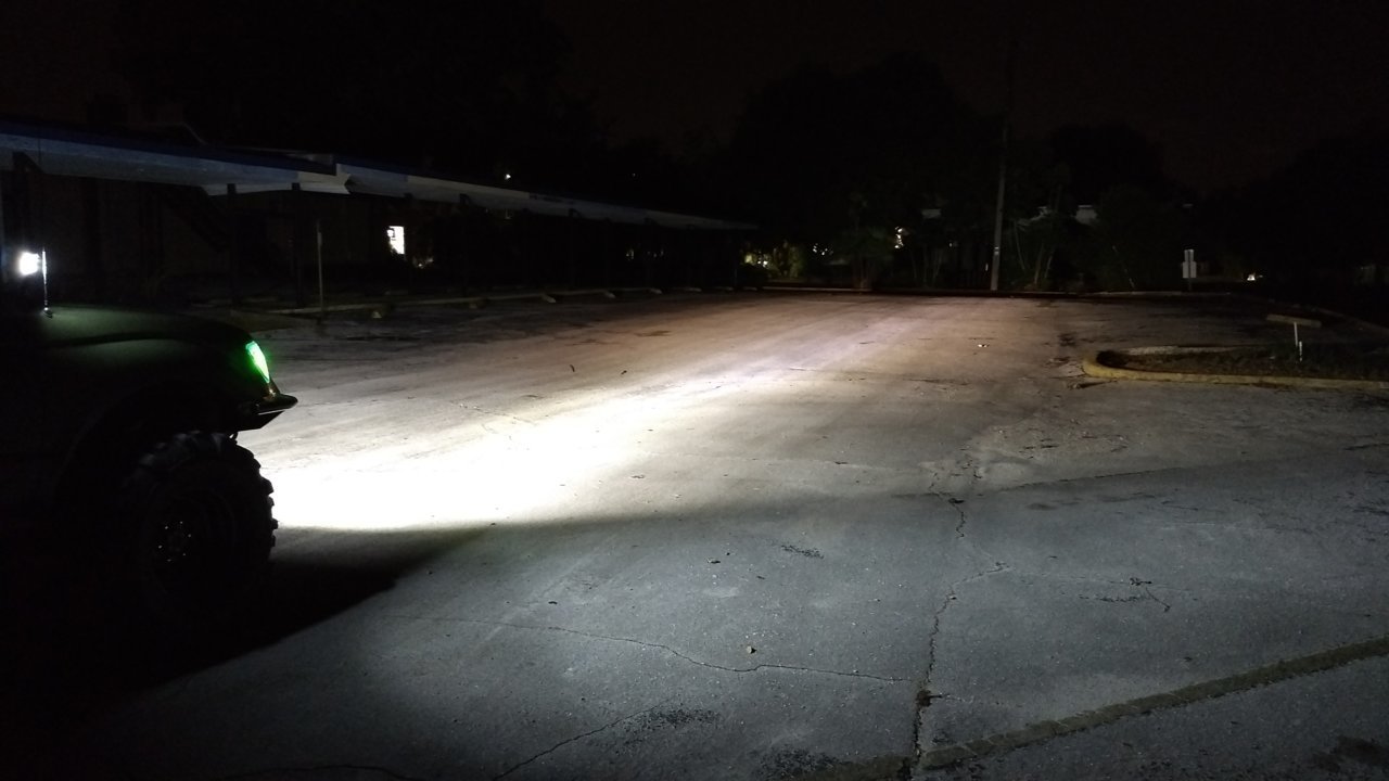

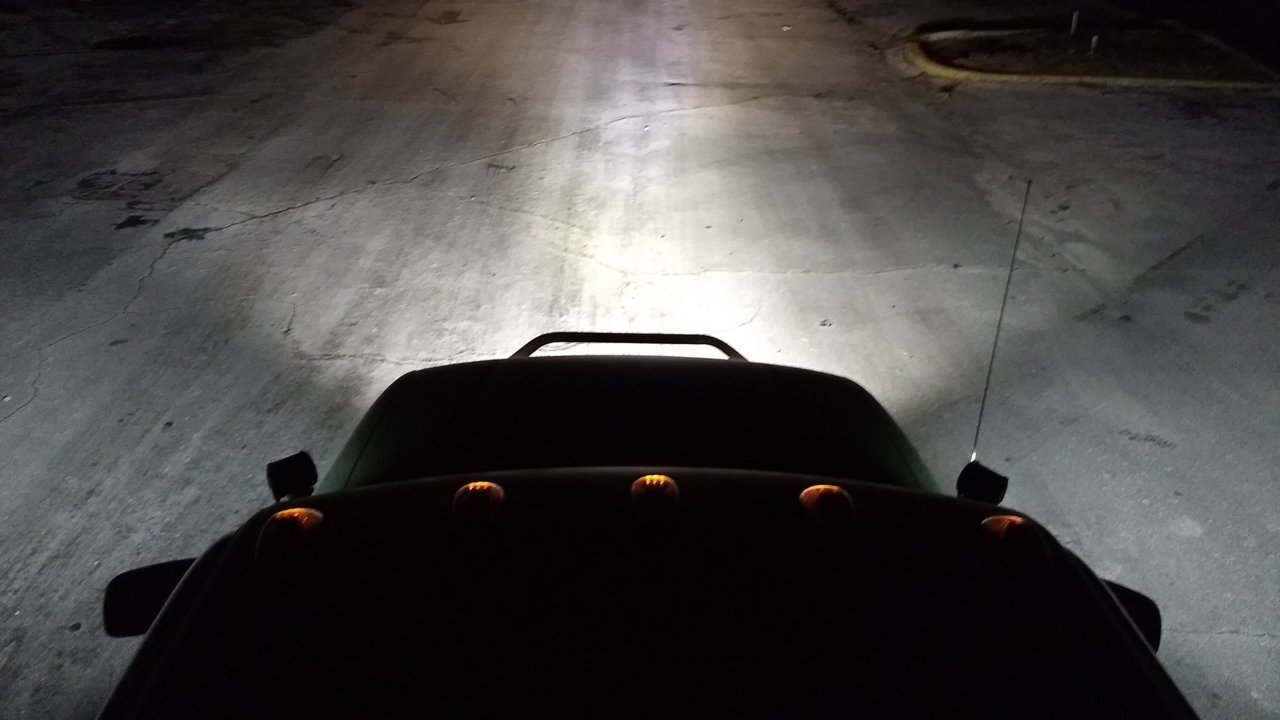

    Got my new lightbar installed today. I think it's almost perfect. I need to shim the mounting brackets up a little though because I think the lightbar ends are touching the bumper on the bottom. It also sticks out a tiny bit past the bottom angle which means it's not quite as well protected, but I don't think it'll be a huge issue.
    mjHWsUzdXpXGsP9H_4Z2xJfC7OY_lOEU7QtapxYI_df37680cc3aaf94f71513f50371ce4ccaa1a9744.jpg
    PQYj5Sj1IIblsdgzAFdALrjhNq8S5HNBythlPb6T_c96466e0c1e74709e50109341f7943f4bad06808.jpg
    Z87JvjG6drtBb21Et3KSYSgRWq7jX7t9_E4mv1S-_ee3083be68f29926d6d5cdab6b4a3c2d3b19f3fd.jpg
    I'm going to put my old 20" on Natty. It's a perfect fit for her bumper opening.
    Trd sport tacoma likes this.

    Thanks, John. :fistbump: I was just thrilled that it had adjustable width mounts and I was able to mount it to the same holes the old one went into without modifying anything. I need to get some lock nuts for the mounting bolts and trim them down so I'll just slid one or two 5/16ths large area flat washers in under the mounting brackets when I do that and raise it up hopefully just enough so it's not touching. I love that it actually sits lower than the other one. I feel that less light will be blocked by the main tube that way. Hopefully I'll get some decent service life out of it and it doesn't go all Close Encounters on me like LeeMar's bar did.
    Edit: I remembered I had some 3/8" fender washers. I slipped one under each mount and it's no longer touching. Yay, me! Now all I need is those lock nuts.
    I also need to get some stainless steel mounting bolts for my ditch lights before the bolts supplied with them start leaving rust streaks down my fenders. :p

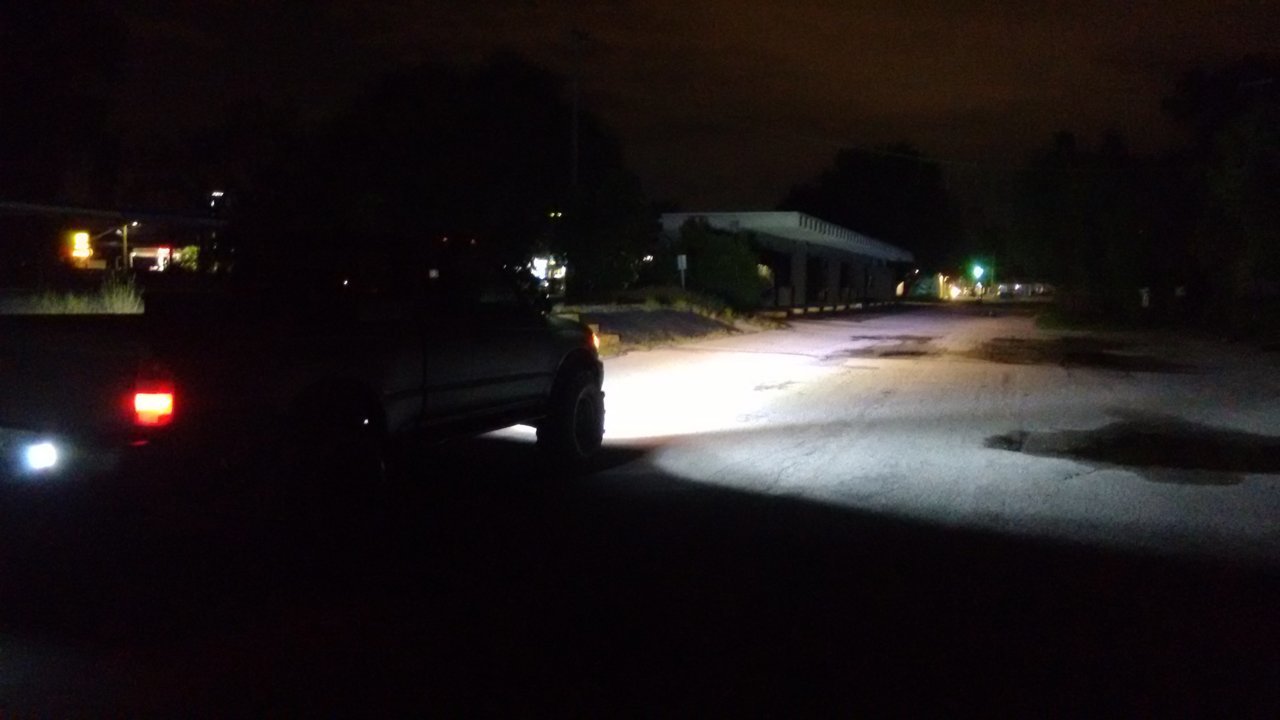

    What can I say...I put lock washers on the lightbar bolts--still need to trim them though--and I put stainless bolts on the ditch light mounts, so that operation is pretty much all done. I'm not terribly impressed with the light bar though. My old one seemed brighter. I don't know if that's because there's a cuple inches of bumper over-hanging the light bar now of if that's actually the case. I guess I won't really find out until I put the old 20" bar on the T4R, but here's some comparison shots (keep in mind the older shots were taken with my old phone and the camera wasn't as good)...
    20" w/Ditch lights
    28" w/Ditch lights...
    I just don't know. It's definitely not a huge noticable improvement, but it will be interesting to see a side-by-side comparison with the 20" on the T4R.

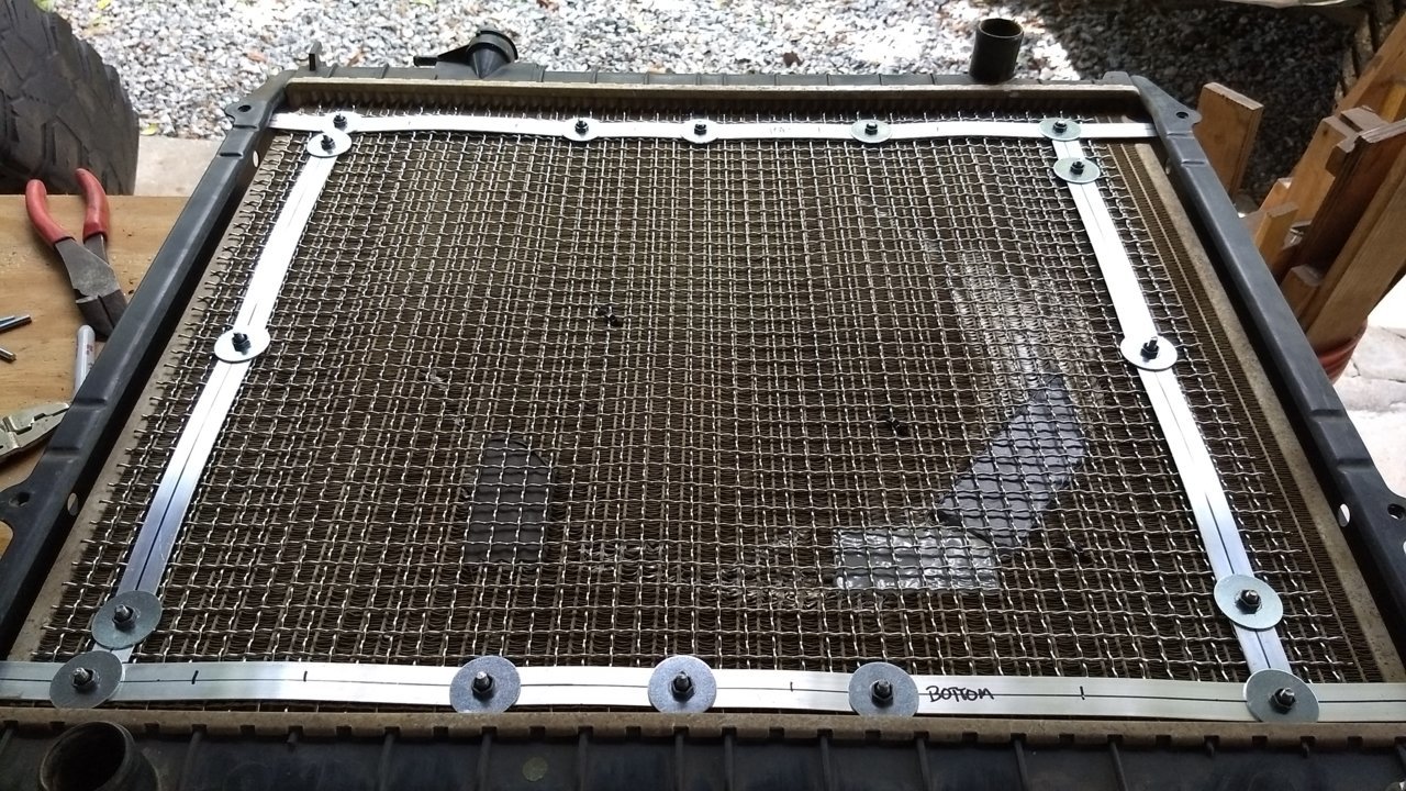

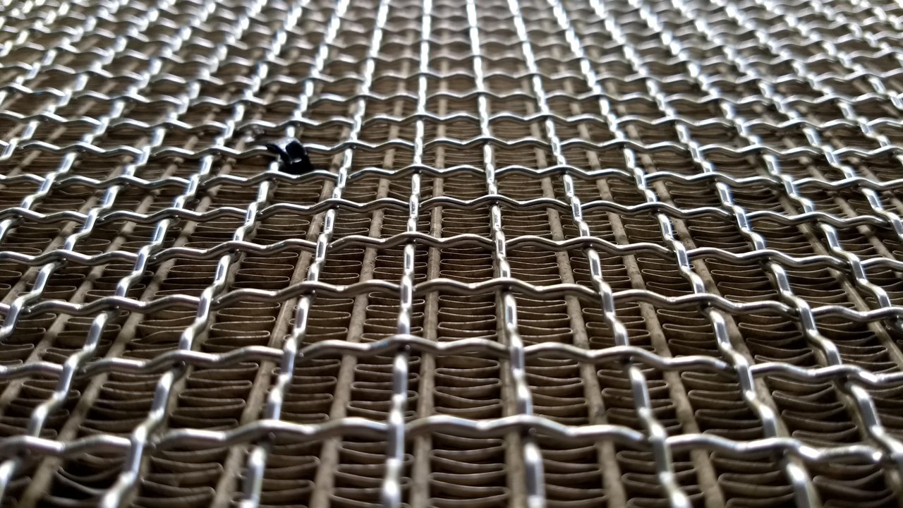

    Armored radiator...Take that you POS fan! Of course, now the fan will probably get destroyed and take the water pump with it if it hasn't already. o_O
    I know it ain't my prettiest work, but as long as it does work, I really don't care. The fastener spacing was dictated by the radiator tube and the wire, so it looks kinda ugly.

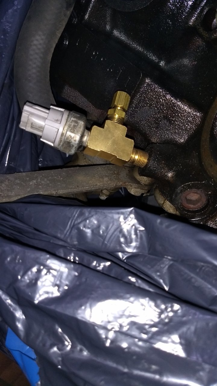

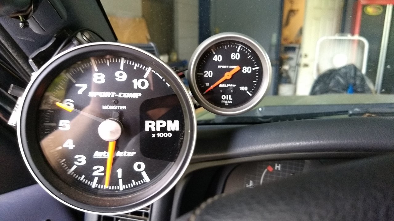

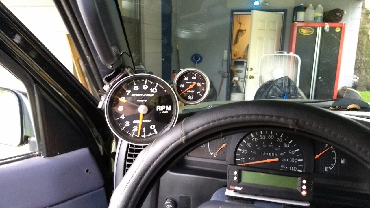

    Finally, a long awaited mod has begun thanks to having a spare engine to use to figure out the needed fittings. :yay: :woot:
    It's starting to look like the cockpit of an aircraft with all the crap I've added over time, haha.
