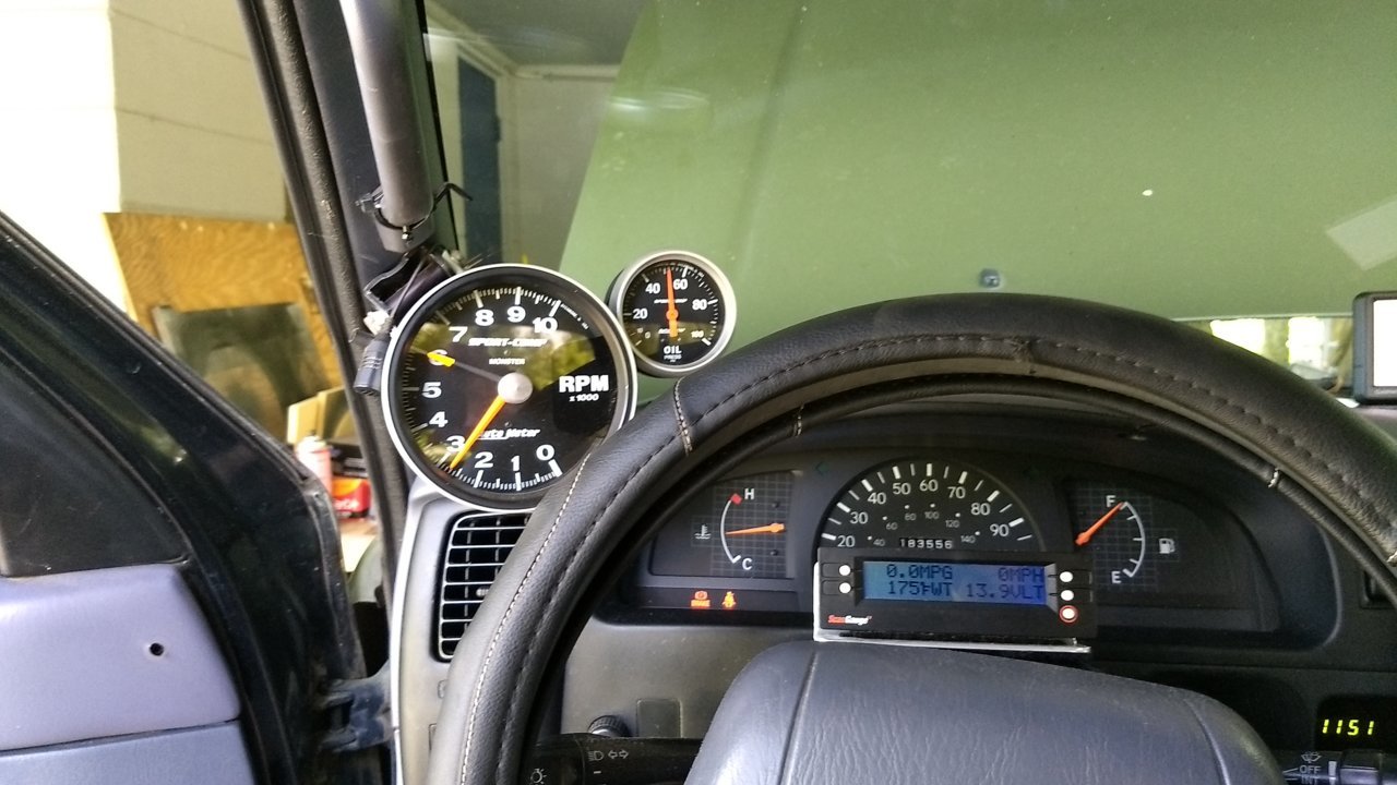

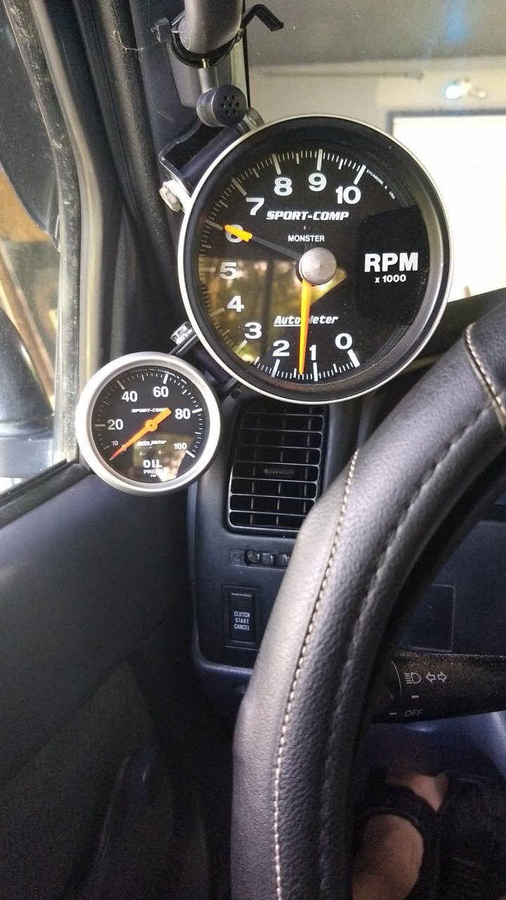

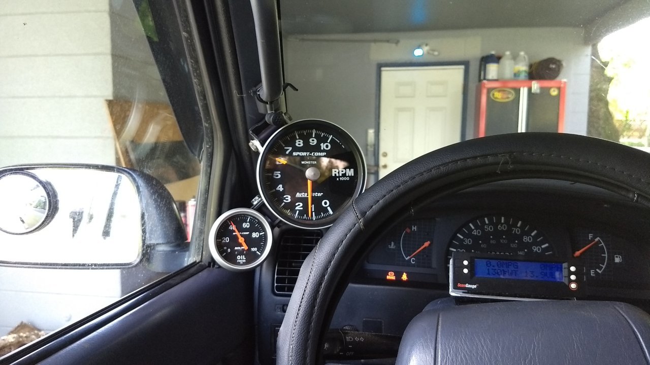

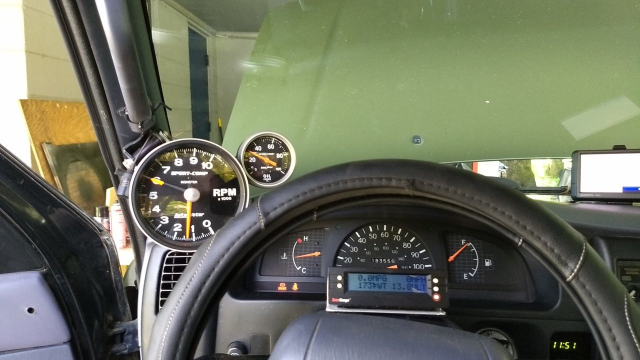

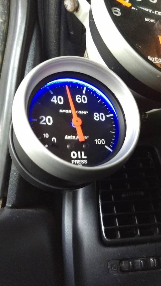

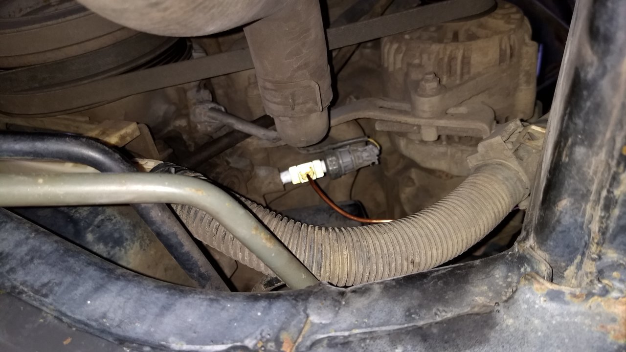

    Holy shit, Batman. I got that oil Pressure gauge hooked up today and boy was that not what I expected! I nervously started the truck up for the first time and expected to see some sort of dismally inadequate oil pressure. But as she fired up and the needle started to climb, passed 10 psi, passed 20 psi, passed 30 psi...my eyes started to get big as it passed 40 then 50 then 60 and it finally settled at 68 psi @ about 1500 RPMs. I was stunned. So I took it up to about 4K and watched the needle climb passed 80 psi! Wow. :eek:
    However, as the truck warmed up, the pressure came down. It's probably going to be between 20 psi and 30 psi at 800-900 RPMs.
    [​IMG] [​IMG] [​IMG]
    The plumbing wasn't my prettiest work ever but I barely ended up with enough tubing to run between the engine and the gauge. :censored:

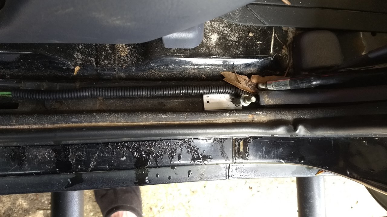

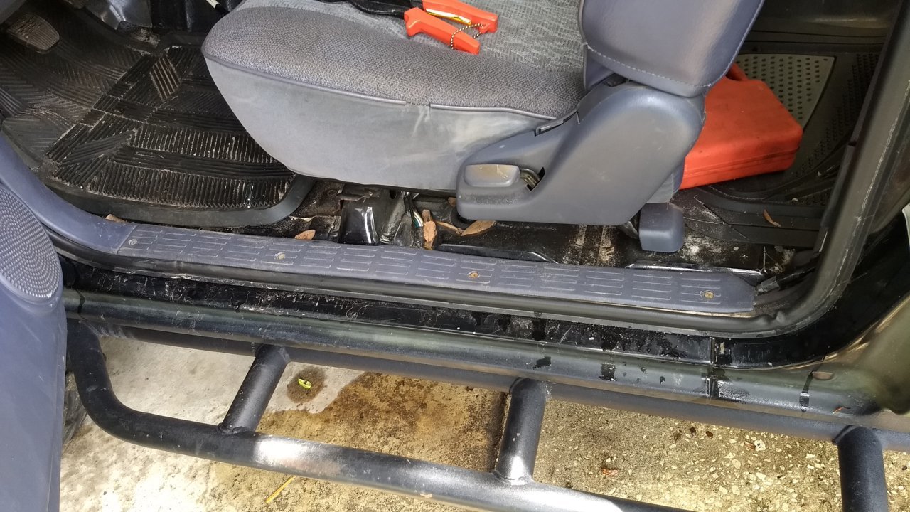

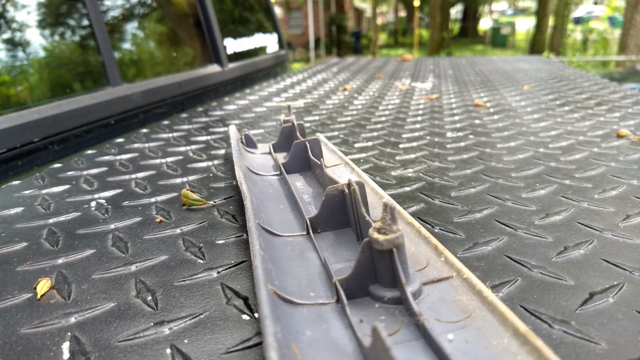

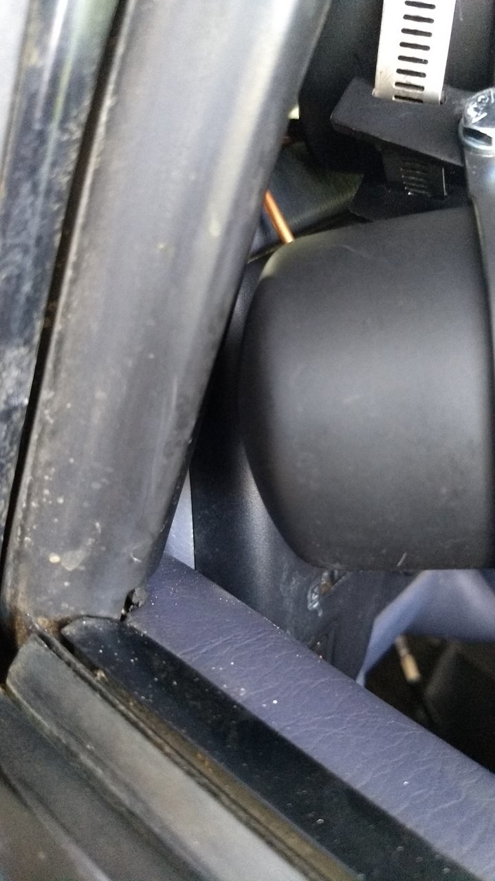

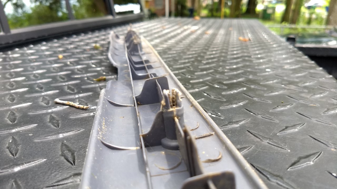

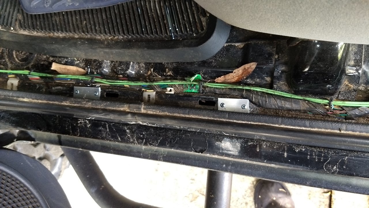

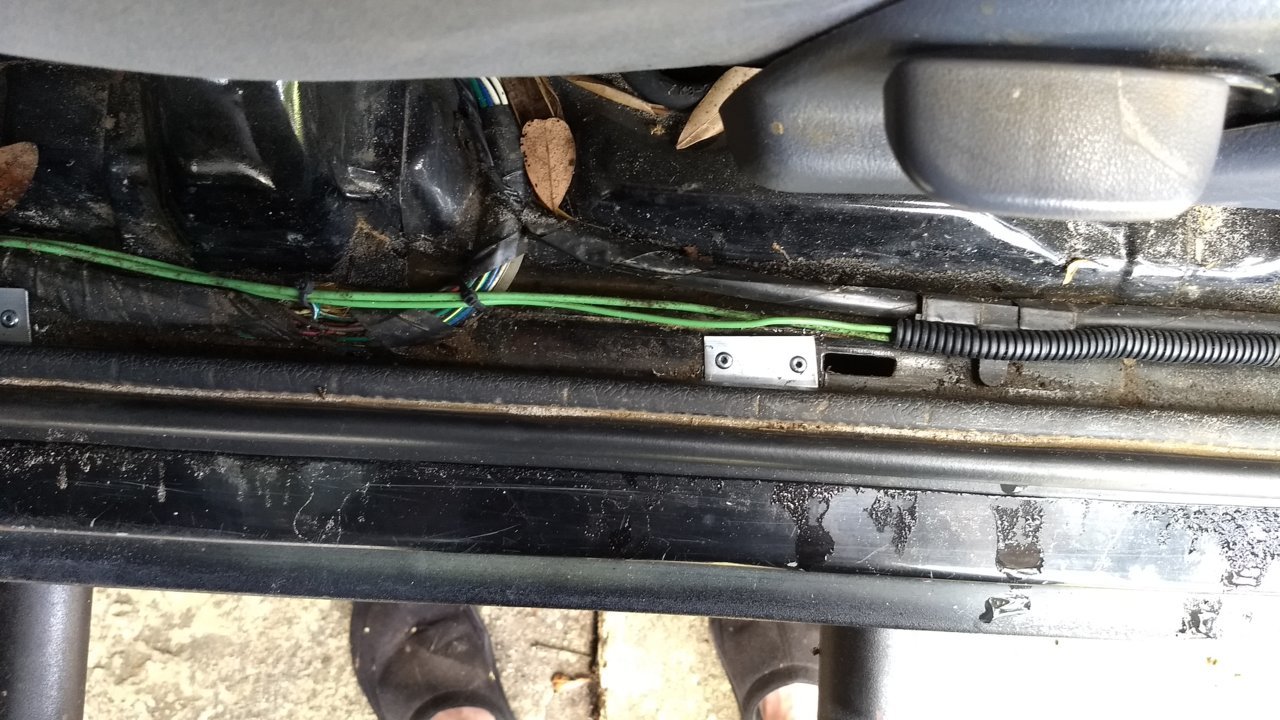

    Are you tired of your door sills being sloppy and loose from being screwed too many times? :D Is your tab broken off leading to insufficient penetration?
    IMG_20180730_144456969_HDR.jpg IMG_20180730_144517732.jpg IMG_20180730_144506096.jpg
    Well, here's how to fix that.
    Required materials:
    Strips of aluminum (can be sourced from Lowe's)
    1/8" Pop Rivets or sheetmetal screws
    Tools required:
    Drill with number 30 bit
    tin snips
    screw driver
    Cut your strips of aluminum into sufficient sizes. I just eyeballed it. No need to get OCD about it. Drill pilot hole for your screws or rivets. Lay the strips over where the broken tabs go in and drill through the aluminum into the sheet metal. Screw or pop rivet the piece of aluminum down one hole at a time.
    IMG_20180730_144545482.jpg IMG_20180730_144538804.jpg IMG_20180730_144530931.jpg
    Next, cut the remaining tabs off your door sill using your preferred method and place the door sill in place. Drill a pilot hole through the screw holes in the door sill into the aluminum. Then simply screw it down with the original trim screws. It should now be like German Virgin...Gutentight!
    Cheers. :fistbump:

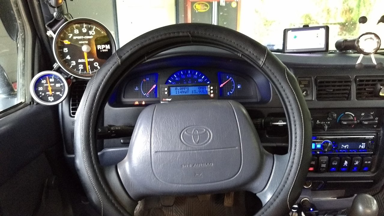

    I should be getting my blue LEDS Thursday so hopefully that will get my primed for the fall camp and ride. I think I'm just going to cheese ball my hitch and put a stack of washers in it unless I can find a long enough piece of angle. Regardless I'm going much less elaborate than I had planned. So the only outstanding item is the water deflector to correct my design flaw in my front bumper.
    Might end up moving my oil pressure gage because it seems to induce more vibration in my tach mount than I'm comfortable with, but we'll see.

    I might have to do that oil pressure gauge as well. Post up the fittings you used to plumb it to the motor if you don't mind
    Taco No Baka[OP] and TacoTRD78 like this.
  9. Aug 1, 2018 at 6:28 PM
    #389
    Taco No Baka
    Taco No Baka [OP] Interco Tire Snob
    May 9, 2013
    #103866
    8,434
    Lee
    Tampa, FL
    1998 SR5 Xtra Cab 4WD V6 Spartan Package
    OME 3" lift with Dakar rear leaves and 883 front coils. 36x12.50 Super Swamper TSL/SXs on Pro Comp Series 97 15x8 Steelies, Bud Built Front Skid, 4xI rock sliders, 4.88s and an Eaton True Trac LSD up front, 4.88s and a Detroit Locker in the rear, LED cab clearance lights, Sway Bar Delete, Rear Diff Breather Mod, Autometer Monster Tach, Cobra 25LTD Classic, Roof-mounted 3' Firestik Firefly, Garmin GPS, HiLift Jack, Flush-mount LED pod lights in rear bumper, 28" light bar in the front bumper, rear shock relocation (Ruff Stuff brackets), u-bolt flip with Ruff Stuff Anti-wrap perches, CBI rear frame reinforcements, 10" travel Bilstein 5125 rear shocks, heavy duty front crossmember made by Allenfab, Rear shock mounts/crossmember (for upper mounts), spring perches, frame plates, and front crossmember welded in by Allenfab, CBI Ditch Light Brackets, Ditch Light Pods. AllenFab Custom Hybrid front bumper and recovery points. Drivetrain lifted 2" in conjunction with a 2" BL. Modified Trail Gear transmission crossmember/skid. Warn Xeon 10K winch. Large left side body mod.
    Thanks Rick!
    The fittings were a bit tricky. The OEM oil pressure sensor threads into an 1/8" NPT brass fitting just fine. The reverse...not so much, the hole is too small to get a lot of thread engagement. So it you really wanted to do it right I'd suggest getting an 1/8" NPT tap to tap out the port on your block. The rest is pretty simple. I used an 1/8" NPT male/male brass nipple, an 1/8" NPT all female brass tee, and an Autometer 1/8" copper tubing/compression fitting kit sourced from Pep Boys for $17.99 (they keep it in the razor aisle, haha, almost like they don't want to sell it to ya). And, of course, teflon tape.
    Only thing I would have done differently, I think is I think I would have reversed where I put the OEM sensor and the compression fitting for the tube, simply because I think it would have put less mechanical stress on the assembly. Also, if you get the gauge, don't go with the nylon tube it might come with. It's crap, especially for the bouncing and vibrations we deal with off-road. Go with the copper tubing. That said, I think I'm going to get a couple of 1/8" unions and start carrying my tubing cutter just in case I need to repair the line.

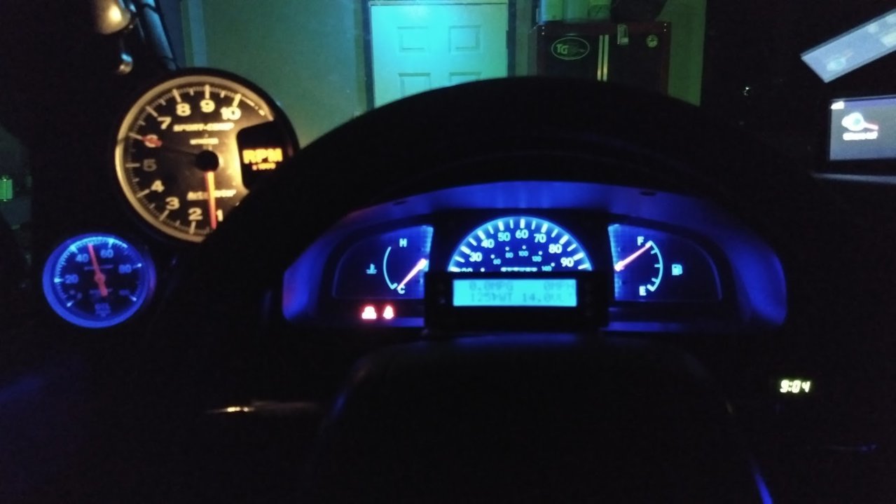

    Another two mods completed and scratched off the list in the OP...
    DRmdBG7BnMvlKhcgQqJ0FpD4Y4kWkBr4Mj-oXKXl_d5e2e12fffeb19a3ce016ebc1bd0515a65dacff8.jpg
    70HLRU2qfqEAKOon6xBtBBYodrkdICNmzEpsiUwk_30c6789eebc042f101e463377940ae3a7e41f597.jpg

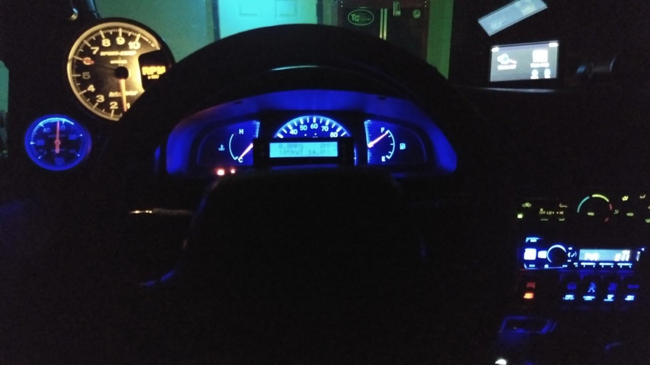

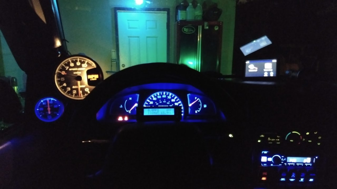

    Full night shots...
    fnSFVxYwiqX26dyydi9r5Id4111ZznmskFPFD4qO_bfe3fa0f03be9fe1fed3876990e8082acf9044ae.jpg RXVE3weaVBxHjlp81AH_In2dyY0UN41YH_KxAfkp_a77bc349f1ce709ef5c97b3fd41835a11cc2ddf6.jpg ulHwj6WevElyVpJfAUnHmEPzJkwlvJcTNsSkw_me_5e59c99b93f106699a48131a6ce18d582314952f.jpg
    The Oil Pressure gauge showed up a lot better than I was expecting it to. I thought it'd be a lot dimmer. I'm so tempted to send my tach back to Autometer now. It's about 150 RPMs high out of calibration, so they could recalibrate it and put a blue light in it. But I doubt that'll happen anytime soon. I think I'm just going to let things ride until I get my new cross member, my regear, and my 35s. Then I'll start worrying about cosmetic shit.
