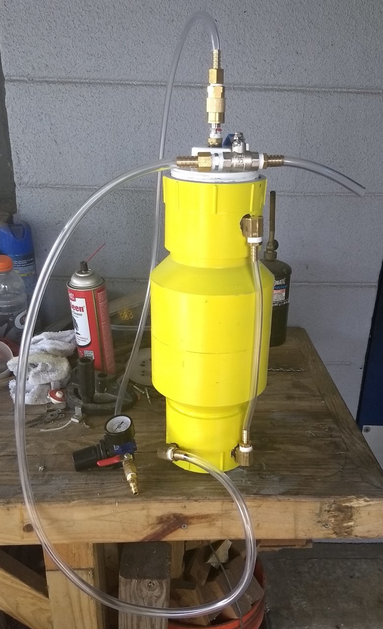

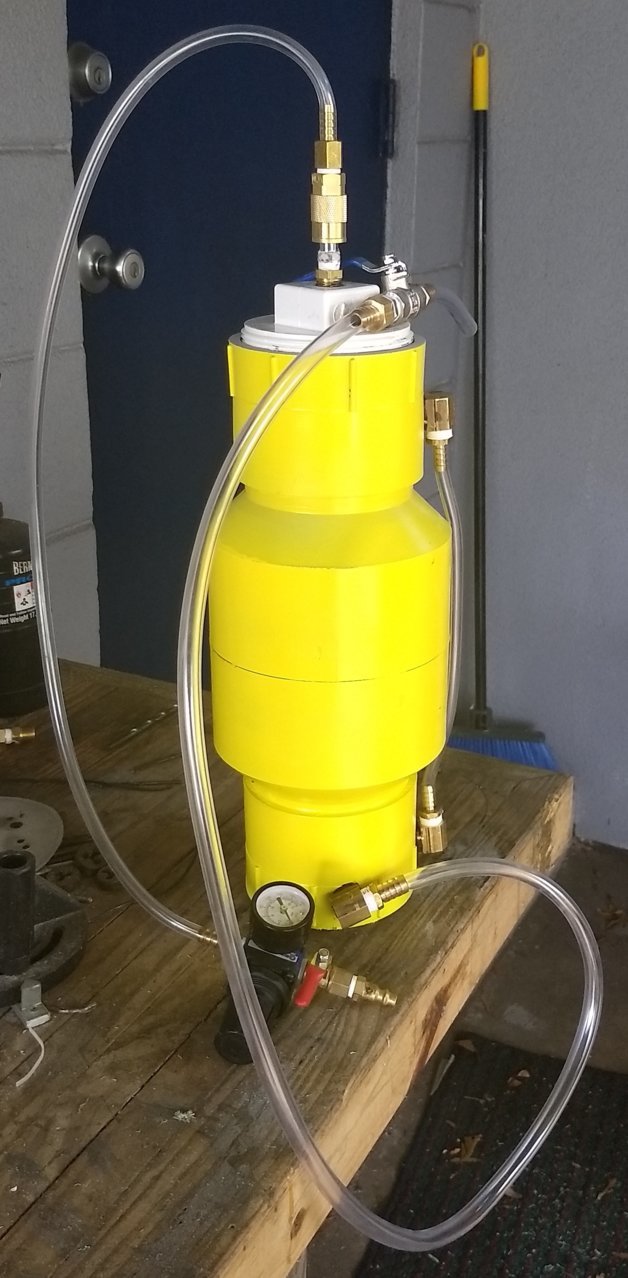

    Well, since it's kinda wet out today and I couldn't sleep last night I decided to go ahead and assemble my gear oil dispenser. Haven't tested it yet, but I'm hoping I learned enough from the prototype I gave @allenfab that there won't be too many bugs to work out of this one. ;) It should hold about 5 qts, which is about enough to do my front diff, transmission, and transfer case, since they all take the same grade of oil.
    The regulator also plugs into my pressure brake bleeding setup. I'll probably build a smaller pot to hold about a qt of brake fluid so I don't have to keep taking it off to refill the reservoir, but that's down the road a bit.

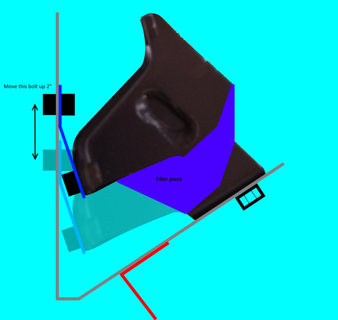

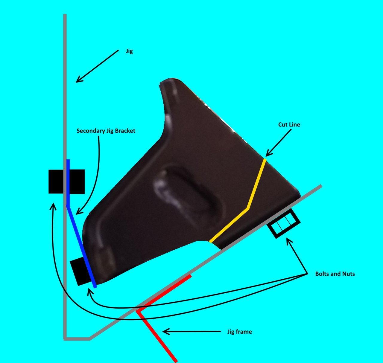

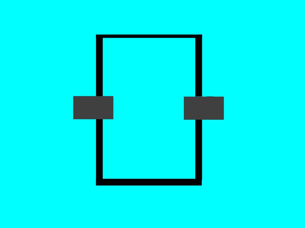

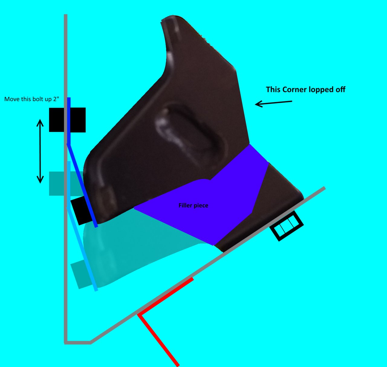

    Pulled the trigger today on a Performance Accessories 2" BL. This is the first acquisition of parts being collected in preparation for 35s.
    Next I need to start building a jig to extend my motor mounts 2":
    Jig.jpg Motor Mount Jig 00.jpg Motor Mount Jig 01.jpg Motor Mount Jig V2.jpg
