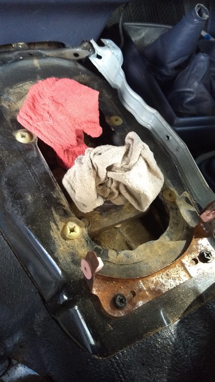

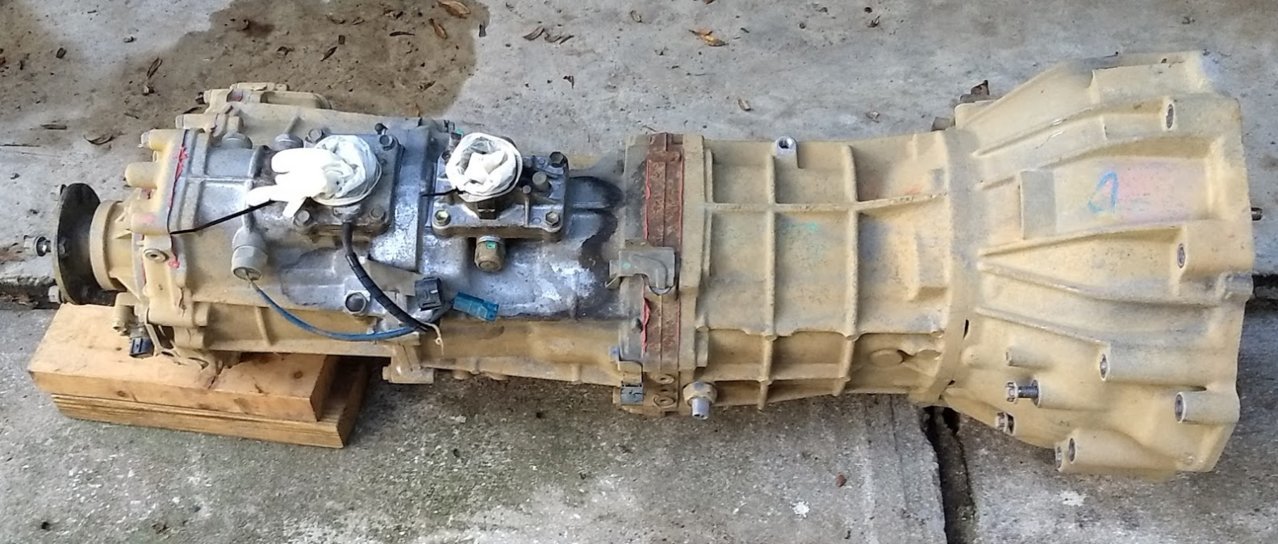

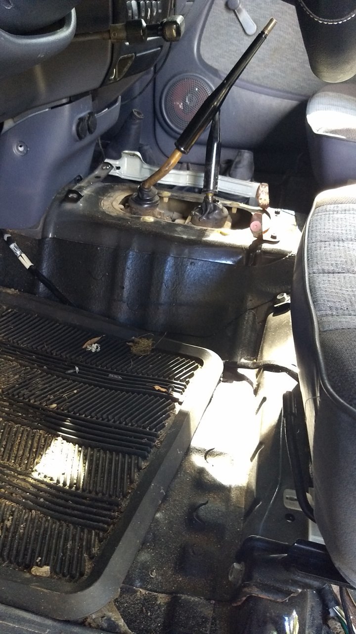

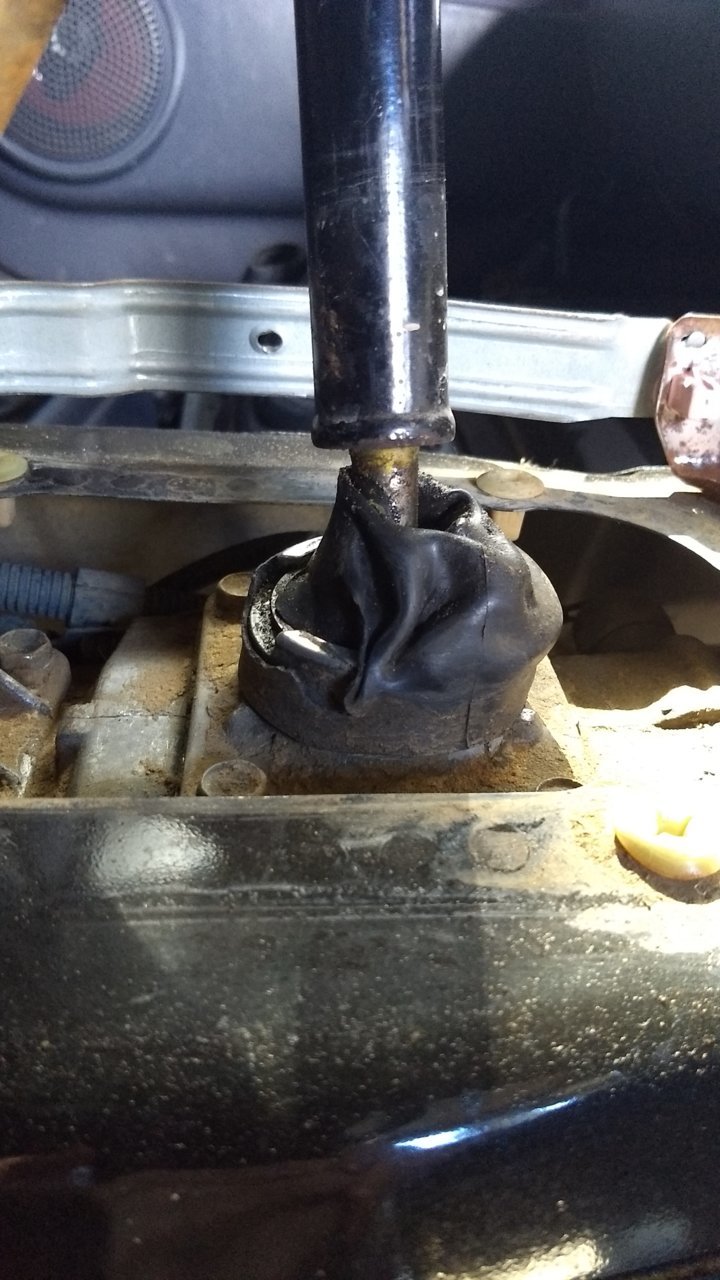

    Well, it fought me tooth and nail, but it's out. It'll be a miracle if everything works when I get it back together. If there was a wiring harness that could get snagged on something and stretched tight, it did so. I don't know what it is about this transmission/engine, but I've never had as much trouble seperating one from t'other. Both times I've removed the tranny on this truck it's required a ratchet strap to pull back on it and a lot of wiggling before it finally lets go.
    HqtHM908Tz6-x4oLTQz9qhg9__Y6VvIZlSLo4m77_31c591f25ce8454c3cf8103b80fc7ba68beecf64.jpg
    KGCvvEhVq4oDrebSLyey1gBZX6eA_51RIbqyv1ob_17664b9a90fafaa7996d03753bbce6e73fe4bbbe.jpg
    Luckily, for a change, the old throw-out bearing was just shot, not seized, so my pressure plate should still be good.
    The fight to put it back in begins tomorrow. :frusty: Then Monday, I guess I'll have to see if I can get that boot.

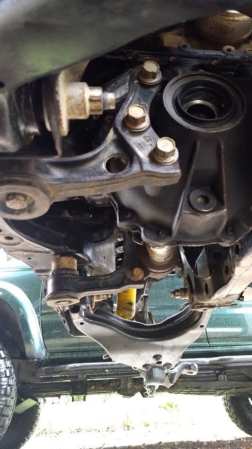

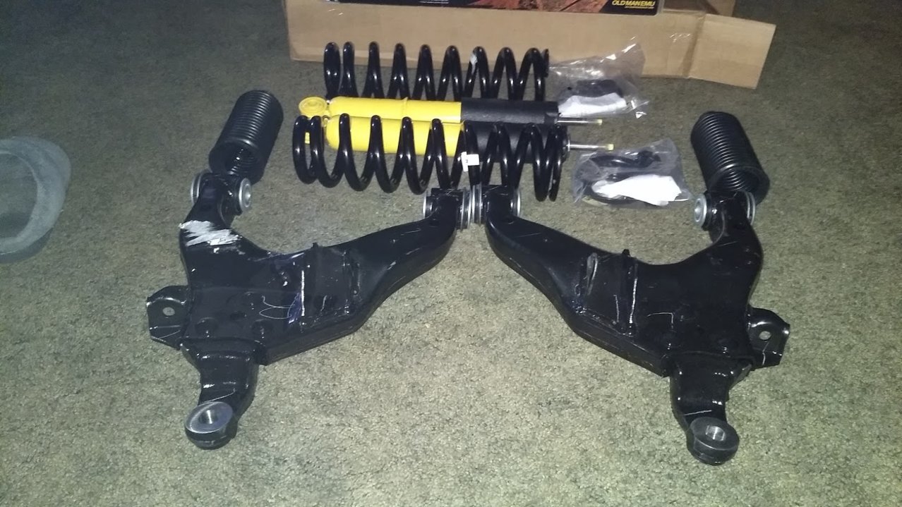

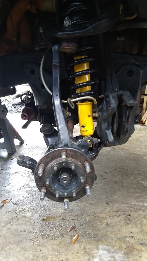

    I am amassing so many dang parts and I'm getting nothing done. :annoyed:I've got my new trans crossmember/skid, 2" BL, 2" lift motor mounts, 10k Warn Xeon winch and this stuff...

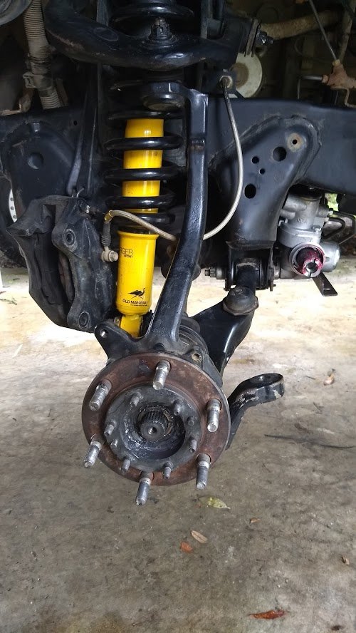

    VAyXCpn92KcWcx6r53xD73OFea3Elf50CnpReIBC_27ef9e0bb5f3fb498ec0c8d344973a255b60bc4b.jpg
    Brand new set of Genuine Toyota LCAs, and a brand new set of OME coilovers with 883 springs. Also some brand new steering rack boots. The T4R has a seized jamb nut on the outer tie rod and the greasable Moog tie rods I have on the OGT are a bit to close to the brake disc for my comfort. I ordered all new ball joints, with inner and outer tie rod ends. Figure I'm going to put the outer tie rod ends on the OGT and the greasable ones on the T4R which still has the backing plates over the discs so I don't have to worry about getting grease on the disc.
    If this doesn't fix my vibration, I may do something rash. :bananadead:
    Of course, I have to dredge up the motivation to get out there and install this stuff.:frusty:

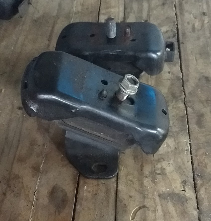

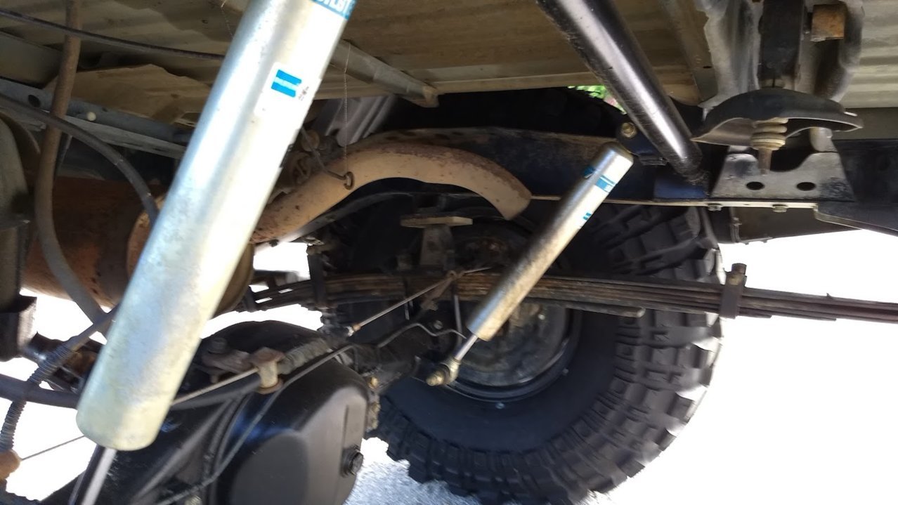

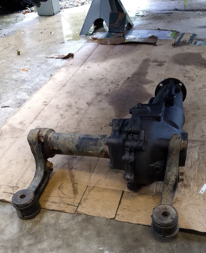

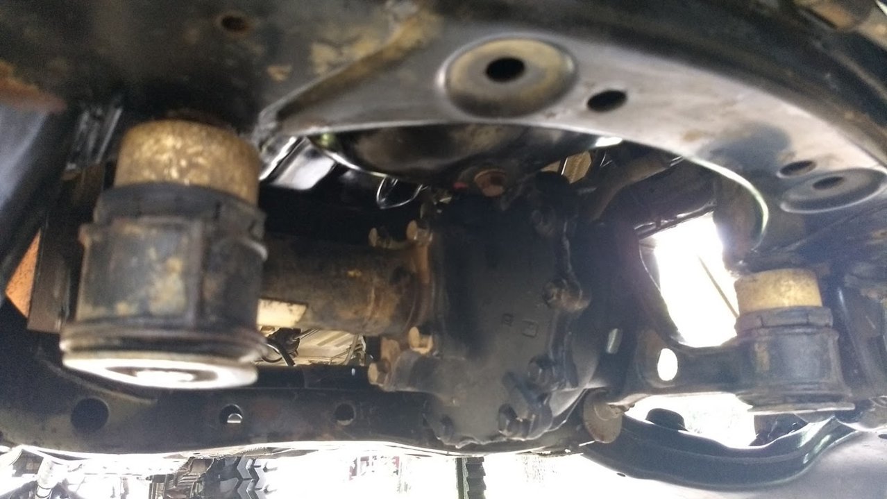

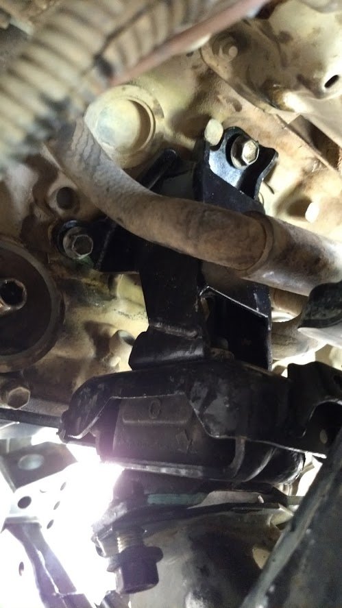

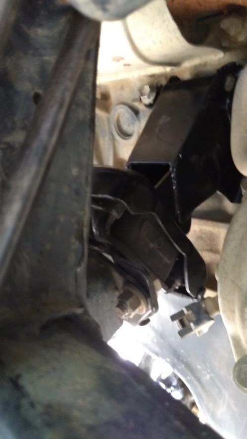

    Update on the state of the OGT: I replaced the leaf spring bushings this morning and just got back from test driving it on the interstate. There was a small but definite improvement in the vibration, but it's not gone. It's light enough that I can easily chalk it up to the tires not being perfectly balanced, but I honestly don't think that's what it is. When I put bias plies back on it the vibration will probably be lost in the bias ply ride so i'm prepared to live with it. I still have to wonder though...I have no more suspension parts or driveline parts to replace, so I'm wondering if maybe it's the the engine, maybe the harmonic balancer or just the loose rods or something. If it's a motor mount, that will be come apparent soon enough since I'll be swapping them out for the taller ones Todd made me with the T4R style mounts. Hopefully that's not going to be as big an hassle as I think it's going to be to get them in.
    VmBpIXWSDFgKywAmybN6egT6iOLSbiJCgU4B-t8K_95776e71112bf709a1c02989ee8aafce57f7ec7f.jpg
    JZ8hL3CpvZhTsbkP5sZYlNSl5whFR3yZSZshrEdy_4435e3d4375d3923eda15221e6199f2b4594319a.jpg
    Tacoma style mount on top, '01 T4R style on bottom.

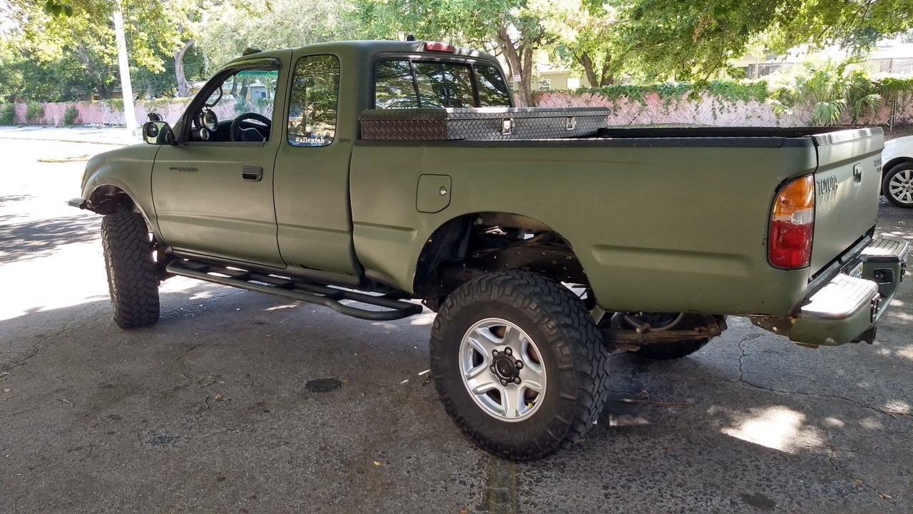

    Tampa, FL
    1998 SR5 Xtra Cab 4WD V6 Spartan Package
    OME 3" lift with Dakar rear leaves and 883 front coils. 36x12.50 Super Swamper TSL/SXs on Pro Comp Series 97 15x8 Steelies, Bud Built Front Skid, 4xI rock sliders, 4.88s and an Eaton True Trac LSD up front, 4.88s and a Detroit Locker in the rear, LED cab clearance lights, Sway Bar Delete, Rear Diff Breather Mod, Autometer Monster Tach, Cobra 25LTD Classic, Roof-mounted 3' Firestik Firefly, Garmin GPS, HiLift Jack, Flush-mount LED pod lights in rear bumper, 28" light bar in the front bumper, rear shock relocation (Ruff Stuff brackets), u-bolt flip with Ruff Stuff Anti-wrap perches, CBI rear frame reinforcements, 10" travel Bilstein 5125 rear shocks, heavy duty front crossmember made by Allenfab, Rear shock mounts/crossmember (for upper mounts), spring perches, frame plates, and front crossmember welded in by Allenfab, CBI Ditch Light Brackets, Ditch Light Pods. AllenFab Custom Hybrid front bumper and recovery points. Drivetrain lifted 2" in conjunction with a 2" BL. Modified Trail Gear transmission crossmember/skid. Warn Xeon 10K winch. Large left side body mod.

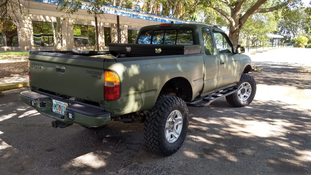

    Mah Hooptie rollin', muffler dragging,
    rear half lifted, the front half saggin'...:rasta:
    Still looking lame AF and nerfed to the point of not being trail worthy, but at least I'm finally moving in the right direction...more instead of less.
    IMG_20190524_170658920_HDR.jpg IMG_20190524_170742134_HDR.jpg IMG_20190524_170754634_HDR.jpg
    Can't wait to start on the front half...not. I'm buying Tars on the 4th of July whether Interco has those SX2s I want released or not. That gives me a little more than a month to get the drivetrain lifted, a new set of rod bearings in it and get the 4.88s in there.

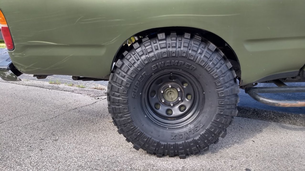

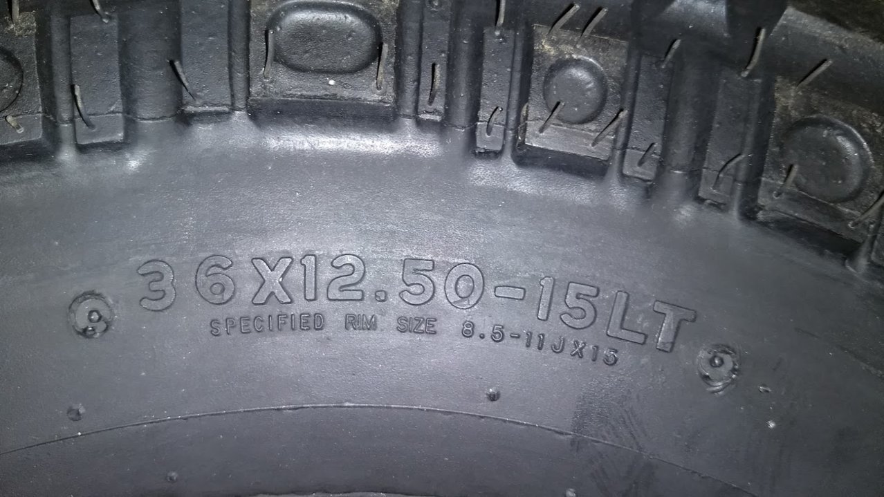

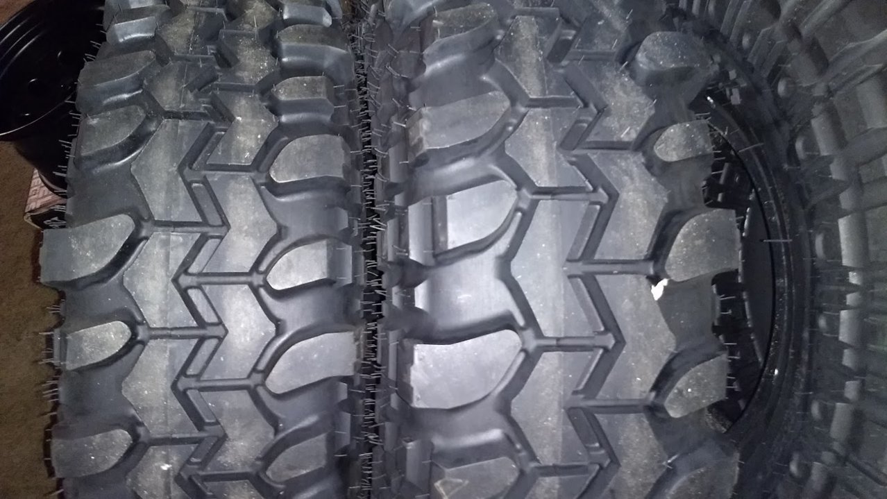

    Lookie lookie what I picked up today...
    EWUIiV8hOC4ujobopDDlqcykca8gQfSFpcQt-j78_ba82fb997dab19b8ba90be570b97f88907cf5a93.jpg
    nUiiLnH0vKndu-TyJVWTTPbZiqPByfwq34u3wUtp_3a3e98a759298d9cbe35bec4f22a8c3997285432.jpg
    Kinda skinny though...
    FLSpTSgtq8jwMisFnJqxI_4b9Y4leDw7e8XoOO7M_3239e62255632a07add602cc1ec0d4252b2bacb4.jpg
    _vzEE7EsL5naTb55KVxD_OfYyrxcclGvjawU8bb2_ecb2edaad6d88fc0bbc6673ea1a6032735d04124.jpg
    Doesn't look like they are going to fit horribly though. Shit, If I don't have to too much clearancing I might try stepping up to 15x10 wheels.
    3yFhQFpHcZGbRuJ9KUHqwIUTnCRTe9LmGh-au71n_45df30e170eb9d9a24e0fdc99290a4f35dcc6a6b.jpg

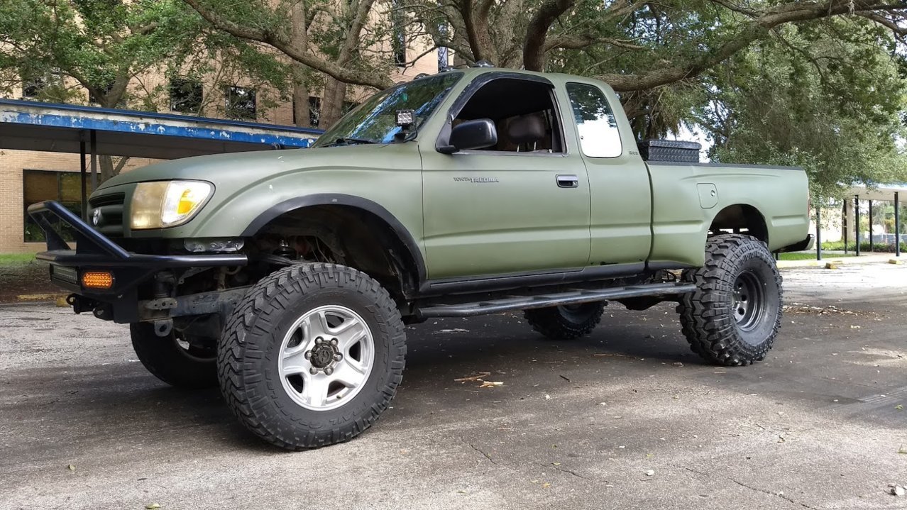

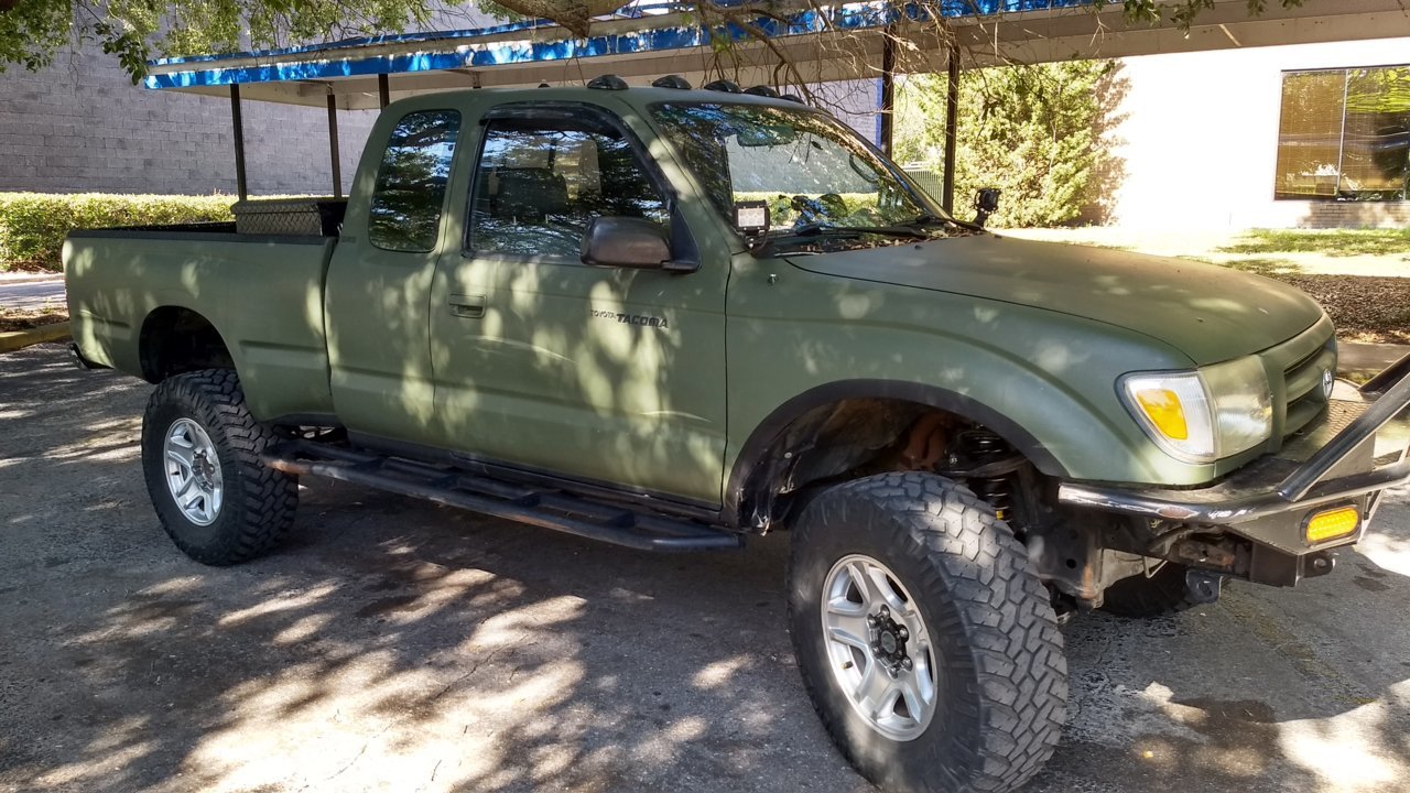

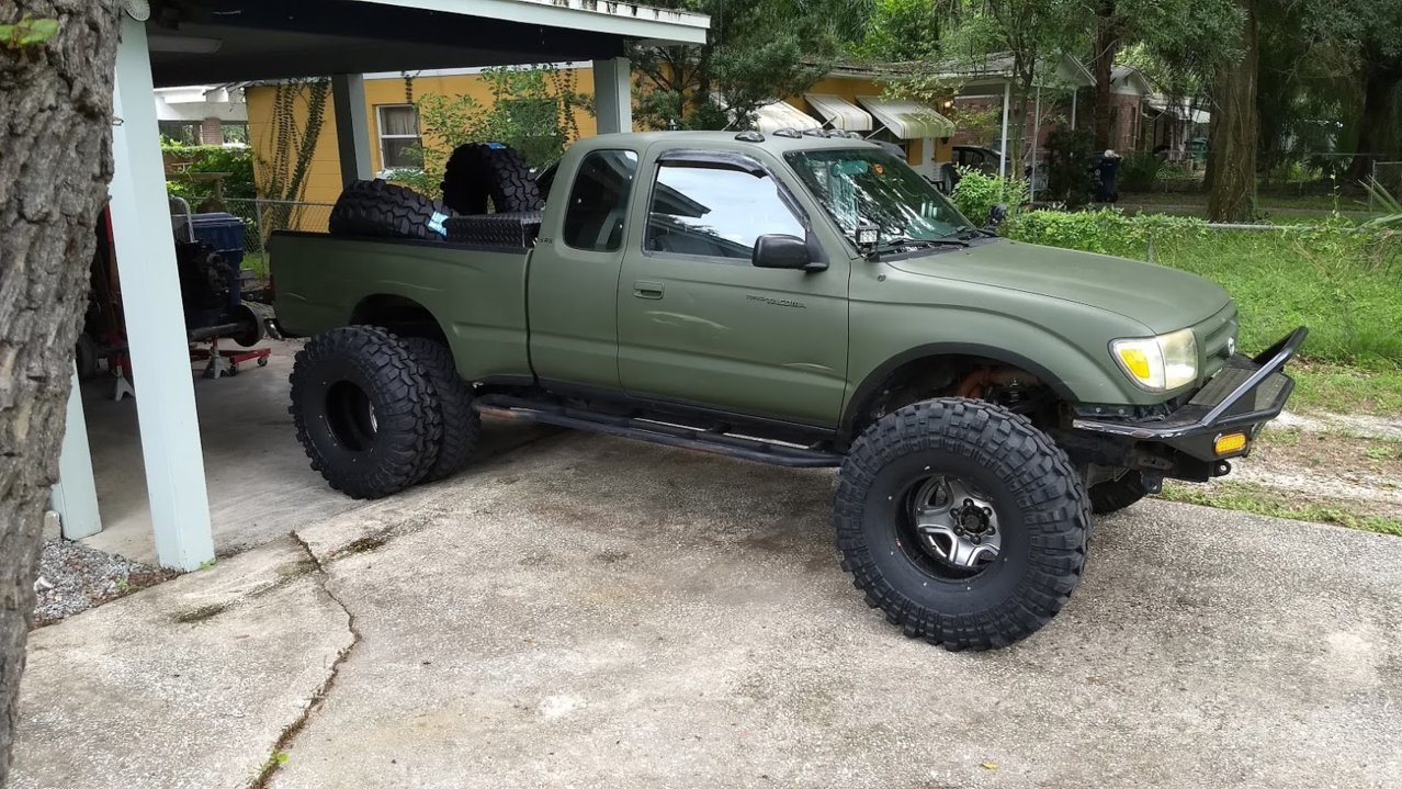

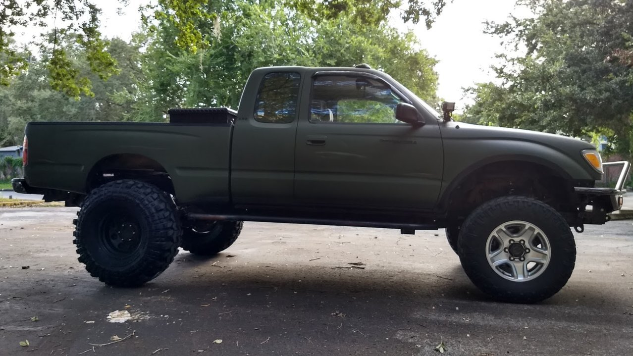

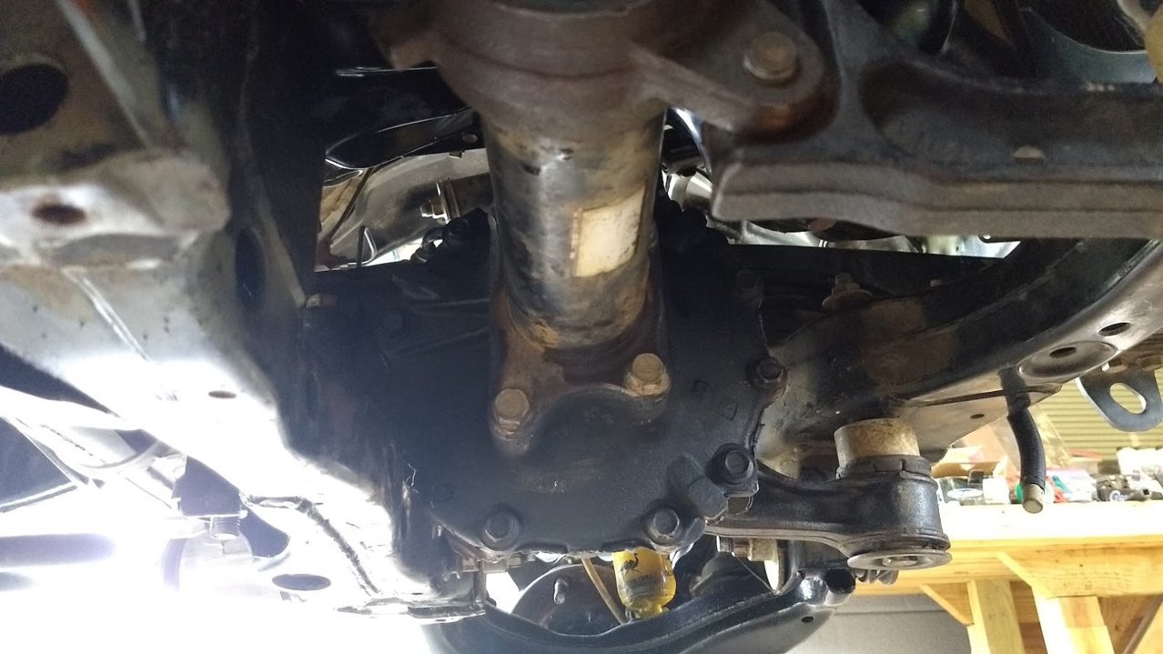

    It begins...
    Meant to post the above this morning, but I guess I forgot to hit the post button. However after a long day of slaving away getting my old ass kicked by the heat, this is the result:
    YUA9nx4Ix4ZS9GowpEMaqPolH0NVocS2Mb2zGGs4_8d0ab4f1774a56841faae90ef8ecdb2d442a48bb.jpg
    8YXQX26wLdOBrBuoHpIiPmE2WBvfWtZNUABUxdV1_818a777e2afde43eac0a8bece0e954a7fa3b0d7d.jpg
    AbT8_NZkPkV6Tv6BIFuyYoUxRx0qs-ejW_JrXAFV_7ae2547e8fcb599f7488f32b52ad8bba37ef6cdf.jpg
    ERZVS51JxMWzIppxn5WkEqMtIMWXawInAB_dMJlt_6a130b16dd019c47fe53bf4f7b3eccd44b8eea50.jpg
    YX8D9WM9EO1xOqieLW-I-ZM8B5KDuyfW320MZefI_7a566da30254f643437a686b178c873e9258b649.jpg
    To be honest, I was really expecting a bigger difference between these 36s and my LTBs. I'm barely going to have to trim the rear aft fender if at all. As for the 4.88 gears, I wasn't really impressed with those and was thinking that maybe I should have got 5.29s, but on the way home from the flexy picture shoot when I turned the corner on to my street in 2nd gear I pinned it to the floor. :eek: It shot off like a bat outa hell and I wound 2nd out so fast I hit third before I remembered there are kids in the neighborhood and I don't need to be hauling ass. That was freaking shocking.

    Critical Outstanding Items I need to get done before the Fall Wheeling Season:
    • Install new rod bearings
    • Install New Front Diff and Possibly a new steering rack
    • Install Tires and Preform any required clearancing for new front tires
    • Install Armor on new radiator and install new radiator
    1. Day 1: Jack up truck and remove tires and wheels. Remove steering rack.
    2. Day 2: Drain engine and front diff oil. Remove diff and oil pan.
    3. Day 3: Install Taller motor mounts
    4. Day 4: change rod bearings. Reinstall oil pan. Fill engine with oil.
    5. Day 5: Reinstall New front diff
    6. Day 6: Install Steering rack and flush system with new fluid. Address all outstanding parts and bits, fill diff with oil, top off all fluids.
    7. Test drive to see where I'm going to have clearance issues
    Items I'd like to have done before the Fall Wheeling Season:
    • Install the new taller motor mounts (DONE!)
    • Install the new Off-road Trans-crossmember/skid
    • Address any other issues that crop up from raising the driveline 2"
    • Get new exhaust installed
    • Weld in my new traction bar
    Non-critical outstanding items:
    • Install winch
    • Reengineer front bumper to fit around winch and sit 2" higher overall
    • Buildrear bumper
    • build spare tire fold up/down carrier
    • Build a water tank tilt down feature
    • Build a vise tilt down feature
    • build a tag holder
    Might need to consider a 60" high lift jack.
    I have to say I'm not at all disappointed with the width of the new tires. Somehow they look just as wide as the LTBs in spite of being 12.50. Now I just have to relearn its limits now that the CG is higher so I can keep it rubber side down. :thumbsup:

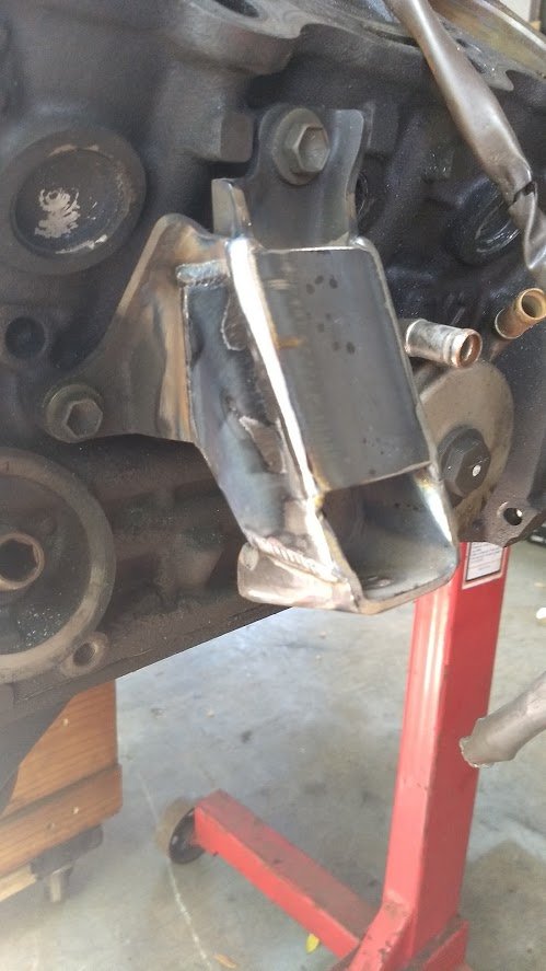

    New motor mounts are in place. Need to but shorter bolts in the engine-to-mount bracket though. The thinner brackets cause the bolts to bottom out before they tightened the bracket down. It's fine though, I'd be shut down until Tuesday anyway, waiting on an oil pick-up tube gasket. :frusty:
    5-BkxGX2IKjBUYcSI7kVmQ8A1Q6Fxituh7lST7ys_bbb3b9d363565a972bb856be11fe9c2301018faf.jpg
    xAWo-xAC5r8jXkC3s-KpcvC8Wzx9sVpd3B_Juw0Q_4c782e407563f86370e5a6344690612bc05e4f22.jpg
    Special thanks to @allenfab again for great work and hooking a brother up! :thumbsup:

    Almost there! I'm on the home stretch!
    JpvbHUV42fXeCZ4xGRuhifpqM1gdRCK_YPxs94k9_ea833ba1cc1746c79e355950a5df0a8b64668980.jpg
    ZaXQ00um_YOmlCjo8d4_kaZFRE1oJEBe54vuIoVB_3ca012321a8b93e49559352c236af4f22bf89406.jpg An5H-HfByC0gaaVG2K-SNQ2r5ugYaaiFMUN7QkkJ_06931b87e920cd57711e3d098852025b539b3547.jpg
    rpXMM6y5w9fdmEfkk2spkZLU7o-cHvkEIlvi45nZ_06bce40ffe61a921398f9aed8ede383563ce5c13.jpg
    9cqfAZQX_fTkcLU8AwZyZazNtIKV7mR7LhrRPm79_5a7dc148411750d3a6f849f75a1441796105e411.jpg FdWv4etaQCvERD99S0qMIqFIPio8z_a44rvIrPQd_8e605c15a56186f33c9f518b0d7b3731e64b19d0.jpg
    :goingcrazy: :yay:
    Broke Okie Ty likes this.
