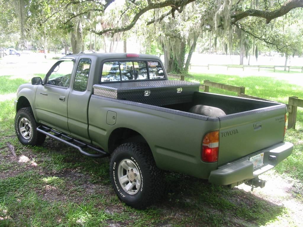

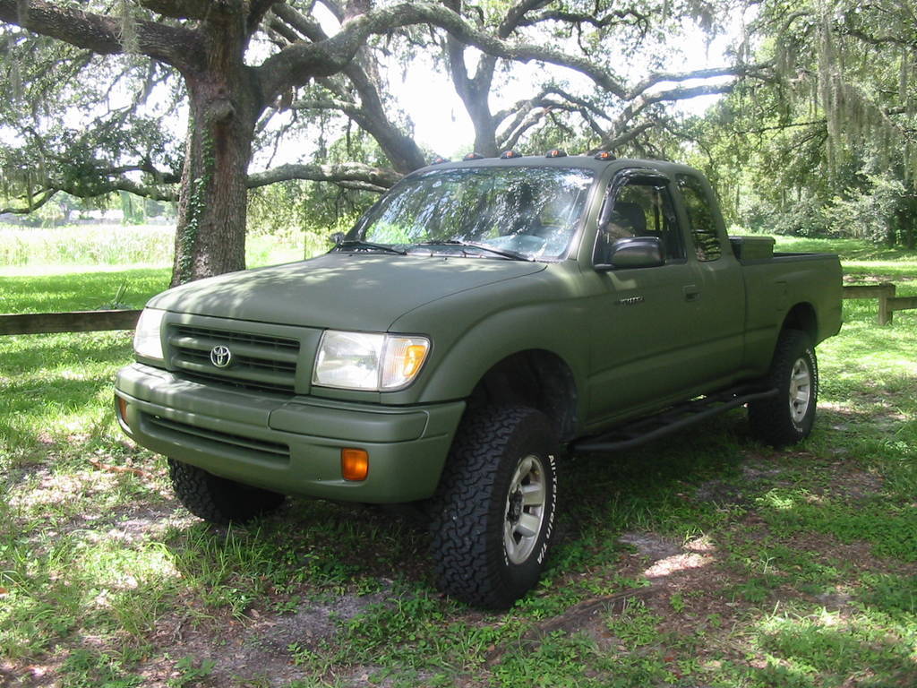

    K, got my sliders on. Not sure I'm happy with them. They stick out too far and make the truck look like a bumper car or something. Still, I'm reserving judgement until I get the lift and new wheels and tires on.
    Anyway, here's some pics of her in her new paint and armor...
    Hey! Progress! How about that! Now I just have to get the lift installed, the new ball joints and axles in, and the front diff Lincoln Locked and she'll almost be done.

    The lift and tires , and eventually bumpers, will fill it out nicely , I thought the same about my sliders, until I gotwider Tires and rear bumper
