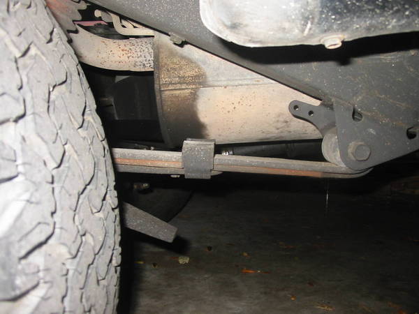

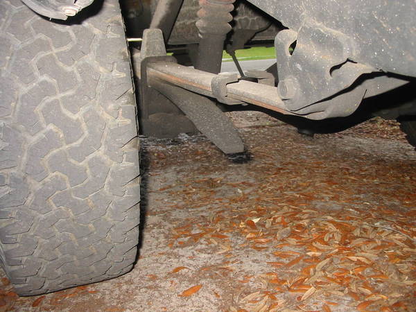

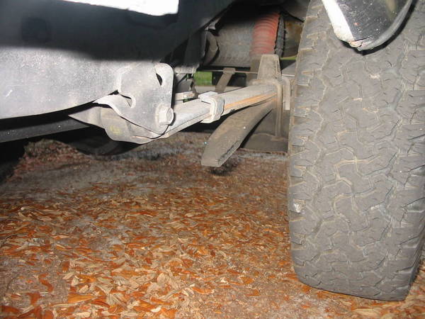

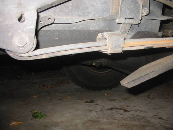

    Well, the rear lift is done...well, except I'm gonna get a longer brake line. That's the good news.
    The bad news is I'm not sure those Dakars are all that great. When I put the weight of the truck on them, they immediately flattened out into a nearly straight line with maybe a tiny bit of positive arch if at all. I also got a big fat zero height increase over my old bent springs with AALs. All it did was level the truck out from side to side by a quarter of an inch. And that's before I've driven it for them to settle.
    On the plus side, the bolts all came right out and the rear shackle to frame bushings came out fairly easy. Didn't have to burn them out or anything.
    I dearly hope I get better results when I do the front or I'm not going to be a happy camper.

    I've read that the dakar's run flat. Mine are. I thought that mine was wore out so I did a little research and that's what I've found. I think some people run a slightly longer shackles to give them a little extra lift. But my truck is level, front to back, with toytec coilovers and dakar's.

    Rgr. I'm going to be running the OME coilovers with a small spacer to net the full three inches. Before today, the truck had a Procomp 2-2.5 inch lift (the PO wasn't sure how much it was) with an above the coilover spacer and rear AALs.
    Anyway, my old springs looked like this...
    So you can understand my dismay that I didn't gain any ride height with the new springs. Of course those old springs did have a positive arch in the back. They looked like ~.
    BTW, what did you torque your U-bolts to? I'm going to end up replacing the U-bolts on the left side because I'm positive I over-torqued them trying to get to the number listed in that crappy Haynes manual (90 Ft-lbs). I torqued the other side to 70 Ft-lbs and that felt a lot better.
