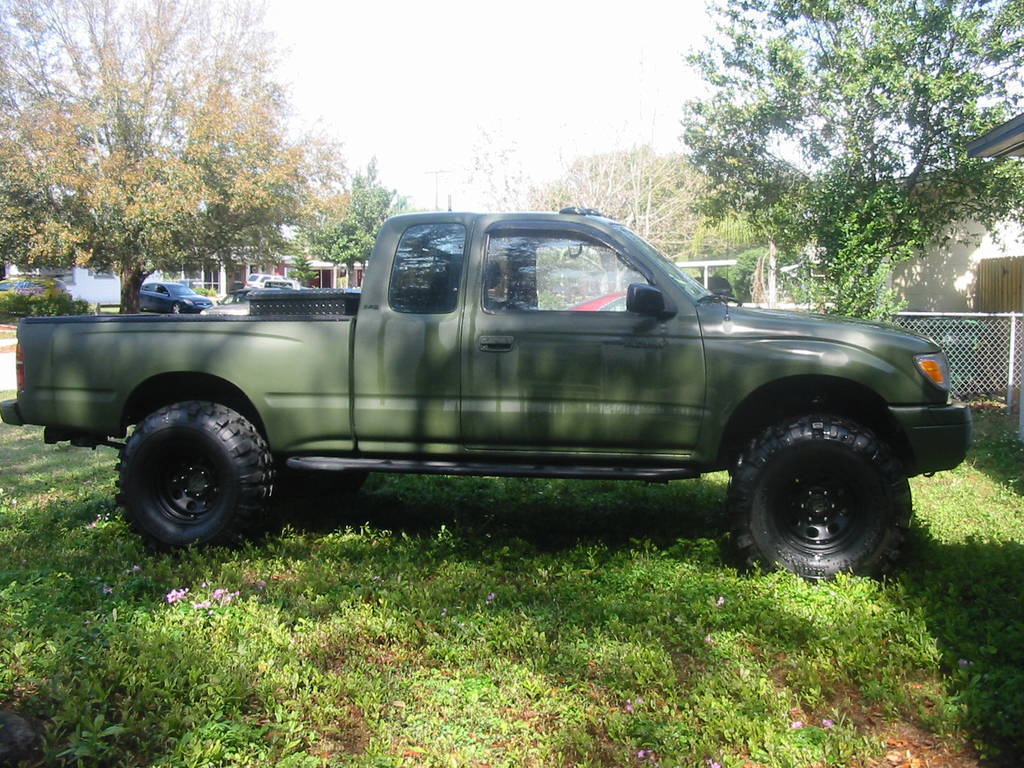

    If you don't mind me asking how much for painting the whole truck?
  3. Jan 13, 2014 at 3:10 PM
    #143
    Taco No Baka
    Taco No Baka [OP] Interco Tire Snob
    May 9, 2013
    #103866
    8,434
    Lee
    Tampa, FL
    1998 SR5 Xtra Cab 4WD V6 Spartan Package
    OME 3" lift with Dakar rear leaves and 883 front coils. 36x12.50 Super Swamper TSL/SXs on Pro Comp Series 97 15x8 Steelies, Bud Built Front Skid, 4xI rock sliders, 4.88s and an Eaton True Trac LSD up front, 4.88s and a Detroit Locker in the rear, LED cab clearance lights, Sway Bar Delete, Rear Diff Breather Mod, Autometer Monster Tach, Cobra 25LTD Classic, Roof-mounted 3' Firestik Firefly, Garmin GPS, HiLift Jack, Flush-mount LED pod lights in rear bumper, 28" light bar in the front bumper, rear shock relocation (Ruff Stuff brackets), u-bolt flip with Ruff Stuff Anti-wrap perches, CBI rear frame reinforcements, 10" travel Bilstein 5125 rear shocks, heavy duty front crossmember made by Allenfab, Rear shock mounts/crossmember (for upper mounts), spring perches, frame plates, and front crossmember welded in by Allenfab, CBI Ditch Light Brackets, Ditch Light Pods. AllenFab Custom Hybrid front bumper and recovery points. Drivetrain lifted 2" in conjunction with a 2" BL. Modified Trail Gear transmission crossmember/skid. Warn Xeon 10K winch. Large left side body mod.
    Not at all. I paid the guy $800 to prep and shoot it. That included smoothing out some areas where the clear coat was peeling off and straightening out the dents in the tops of the bedrails. I provided the paint which cost me about $200 after they nailed me with a hefty hazmat fee for shipping. So I have about a grand in the OD green. I wasn't paying attention to how much the black bedrail caps, toolbox, and sliders cost, but I did go through quite a few cans of the Rustoleum Truck Bed Coating before they were done. :p

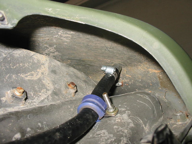

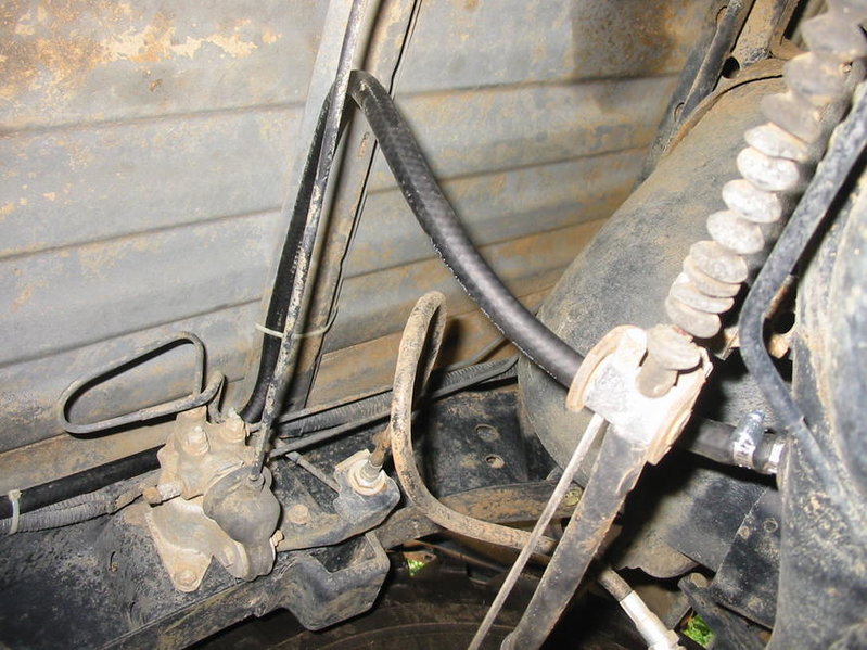

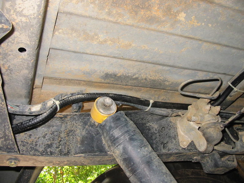

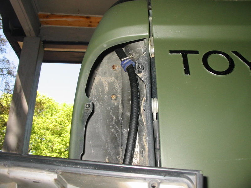

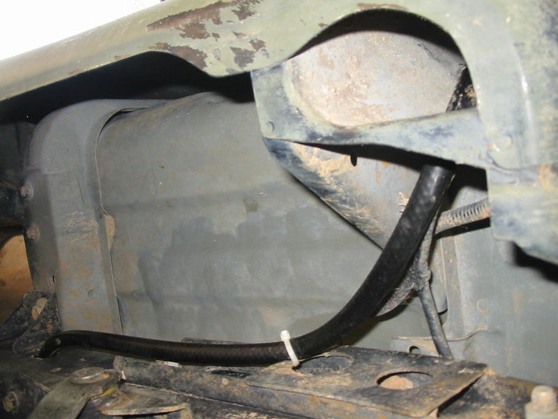

    Did my Rear diff breather mod today...

    I just saw this. Did you have a particular reason for running it all the way to the taillight? I just zip tied mine to the fuel inlet tube. I didn't even run it to the inside of the fuel door.

    As you might have noticed, I can get in pretty deep. :cool: I figured behind the tail light would be the highest spot I could put it short of running the hose between the bed and cab and clamping the breather to the back of the tool box (which I still might do). I was also kind of hoping that if the water did get to the top of the tail light like it appeared to in one of the Richloam trip vids, the trapped air would keep it from submerging the breather. Plus, it just seemed easier than running it to the fuel door with the fuel tank and filler all in the way.

    Oh ok. That makes sense. I don't ever plan on going into anything deeper than the bottom of my door, so I wasn't worried about getting it too high. Also, don't forget to do the trans. and t-case breather if you plan on getting into real deep water. I haven't done mine but eventually will, just for the hell of it.

    Rgr. I was thinking those were already pretty high, extending up behind the bellhousing, but I'll take a look and maybe lengthen them when I drop the tranny to replace the clutch.
    My rule is if the water gets up to the tops of my front tires, I back out. Clearly, the rear appears to go deeper somehow, possibly because it tilts down when the truck is climbing up on the far side, or maybe it was just taking a deeper track do to the flowing water and lack of weight causing it to crab sideways. Dunno, but it looked a hell of a lot deeper in the vid than it did when I was driving through it watching the left front tire.

    Oh ok. I gotcha. You might be alright then. I think they both come out right on top of each. I know for a fact that when you take the shift boots off, you can see one of them through the hole in the cab. That's the only reason I haven't extended mine yet, because I don't ever plan on getting that deep. But you never know, which is why I'll do it sooner or later, just hopefully it isn't after I've drained water out of one or the other lol.

    Haha, No doubt! At least since the T-case HAS a breather, we can be fairly confident that it isn't a pressurized unit like the NP231 (?) I had in my YJ. Found that out the hard way when I ripped a driveshaft in half about an hour away from home and just decided to remove the remaining parts of the shaft and limp home on the front end. In the process, I blew all the fluid out of the T-case through the tail shaft hole and stretched the chain. Had never seen a pressurized t-case until that one. It was about a $1000 dollar lesson. :rolleyes:

    glad to see someone else puting it there. mine is just thrown in there and i have never had water in my diff. I should mount it to the very top like yours

    Yup, the other option was the front side of the tool box. Might still do that someday.
