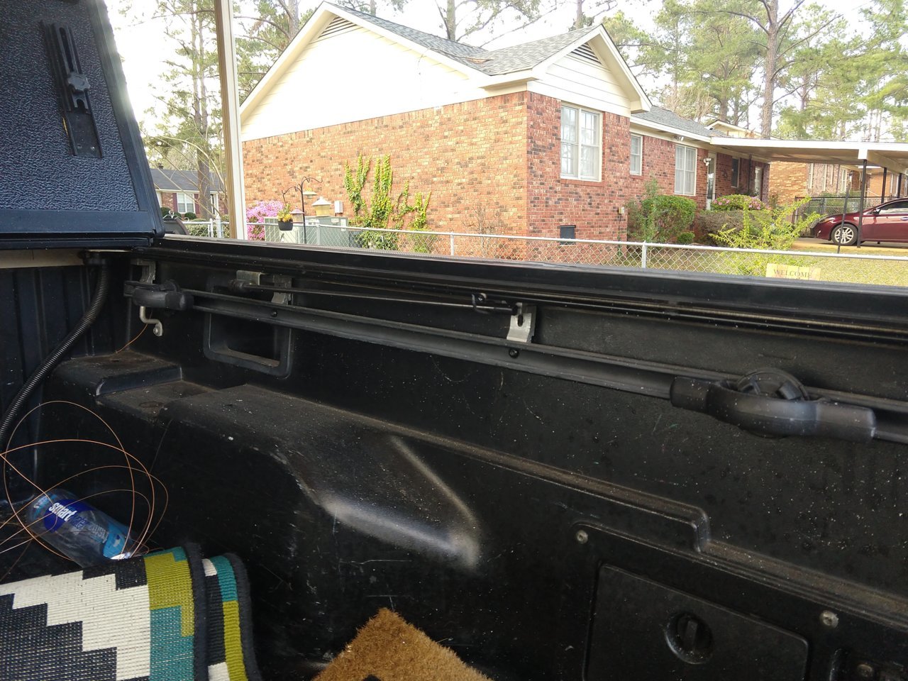

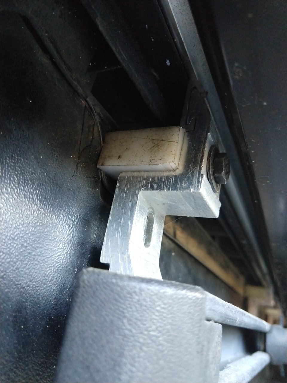

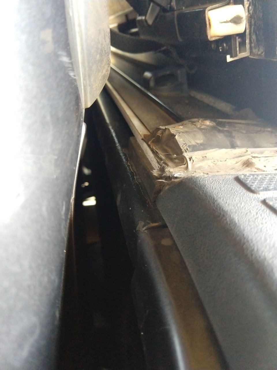

    IMG_20190222_165847728.jpg IMG_20190222_165949311.jpg IMG_20190222_165936954.jpgThe first pic is the Teflon block I made for bringing the mount out to help the top clamp better.the last is the aluminum angle I just drilled holes to align with the back mounting bar holes. The back bar just barely won't fit because of the hold down knobs for the top but I haven't missed that bar as much as I would the side bars. I know it doesn't look like much of a gap but it's pretty big without the angle.
