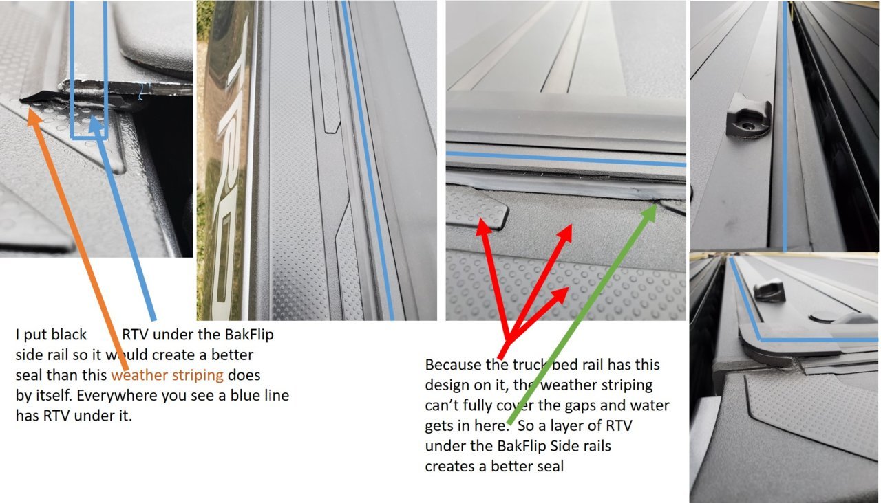

    1 - When you are putting the side rails on, check the gap between the front edge of the top bed rail and the side rail edges. If there is a gap you should add some weather stripping or rubber to ensure there is no gap. This will help to minimize any water getting in from that area.
    2 - Side Rail Brackets - The brackets used to attach the side rails are aluminum, but everything in the bed is black, so I spray painted the brackets with bumper coat black paint.
    3 - Side Rails - Many people say that water leaks in from the sides and to put a small bead of silicone along the length of the rails. I forgot to do this, but it can't hurt. If mine leak, I'll take them off and apply the silicone.
    4 - Drain Hose - Most videos skip how they ran the drain hose. Here is what I did. I bought two rubber grommets (1-1/8OD x 23/32ID) from Lowes and used a 7/8" spade drill bit to drill the holes in the front of the bed. I cut the hose to length and then put the smooth finished end through the grommet and the edge I cut I connected to the bed cover fitting.

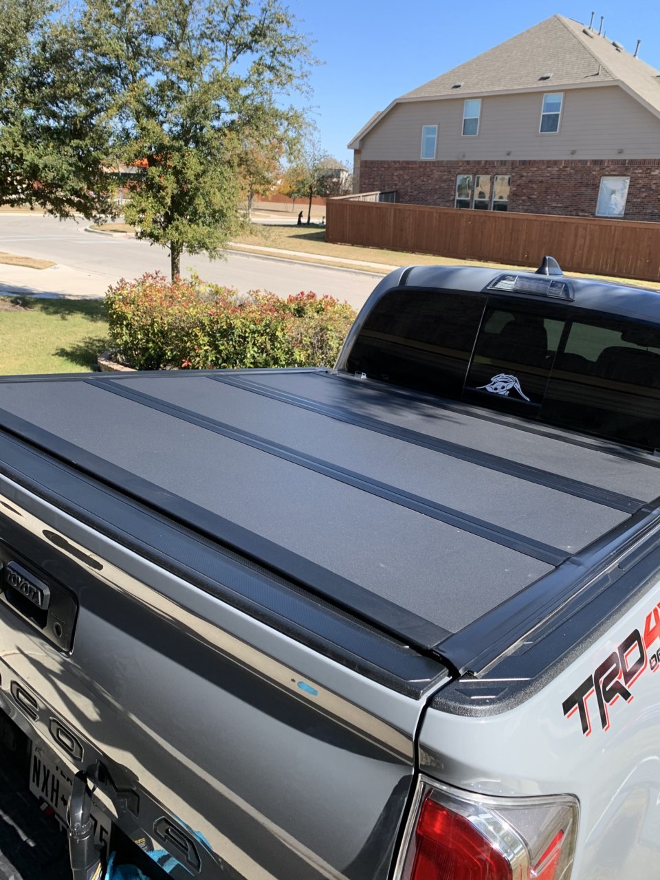

    Got mine installed today. F63F1555-F435-42E6-AAC1-08CE5C44A33C.jpg 2F9DD176-299E-472C-BD6C-9C4573D40E3B.jpg

    After the first rain, I found that the side rails allowed water in on both sides. This is because the bed rails are not smooth and the rubber seal from the BakFlip can only keep so much water out. I took the rails off and put a bead of Black RTV along the rails. Put everything back on and a few days later I went through an automatic car wash. Not even a drip of water came in from the front or sides. The only water came from the gap in the tail gate corners which is expected. Time will tell if the RTV keeps the seal or breaks loose do to vibration. Overall, extremely happy with the MX4.

    Two Yutes:
    I just got my cover delivered today and will install it this weekend. I cannot visualize why you would have to take the bed rail off to apply the RTV. Can you send a picture of what you did?

    Jack-Didley, you don't have to take the bed rail off. I put on the BakFlip hoping it wouldn't leak. It did so I took the BakFlip off and applied a bead of RTV on the underside of the BakFlip rails and then put the BakFlip rails back on the truck and put the cover back on. The picture below shows that I put RTV on the BakFlip both side rails as well as under the top header. It just helps the weather-striping do its job better.
    Now, understand that without the RTV the BakFlip leaked, but it wasn't terrible and if you don't mind some water getting in then you don't have to apply RTV or your adhesive/caulking/gasket material of choice. For me, I had a BakFlip on a previous truck and the only place water got in was near at the tailgate on both sides where there is a gap. This is expected, it isn't waterproof and there is nothing you can do about that. I wanted my bed to stay 99% dry, so I applied the RTV. Now that I applied the RTV the only place water gets in is again at the tailgate on both sides because of the gap.
