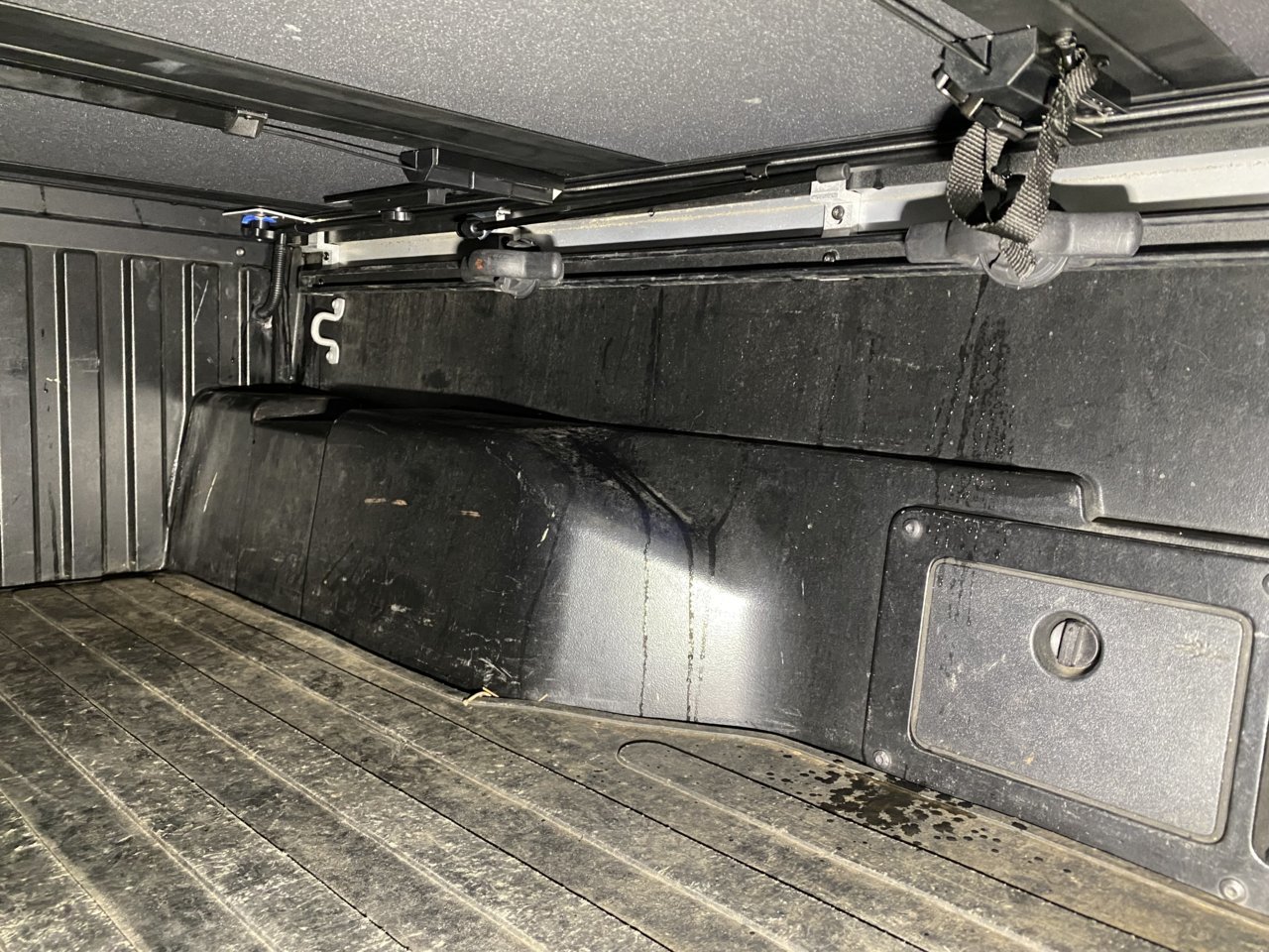

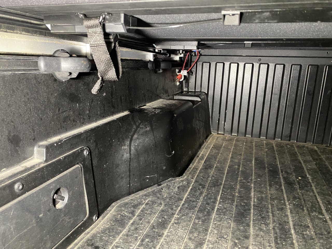

    Now, I did do what the OP did with adding a bead of RTV on the bed caps and around the openings in the front corners of the bed. Mine hasn’t been tested in the rain completely though. Only once when it rained lightly for a bit, and I noticed water in those corners pretty bad.

    Here’s how mine held up after adding a bead of RTV to the sides under the Bakflip rails. I guess I may need to add some more, as well as add some to the front too.

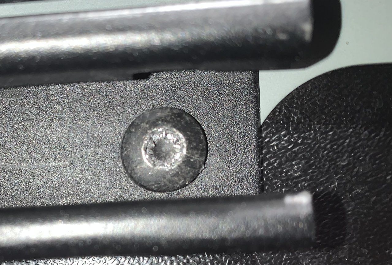

    All 5 bulk head bolts and 6 of 10 side rail bolts were so tight I had to strain with a hand socket to loosen them first. Unfortunately on the very last one the T30 bit stripped it. Not sure what to do now.

    Drill the head off.

    Extractor? If you don’t have that, tap along the inside with a screwdriver then use pliers to extract I suppose. I think some people have varied success with a rubber band on the driver to get it out. I think another technique is like JB weld something to it and then turn and see if it breaks free and will extract
    That whole process of removing the screws I did by hand

    Should have been able to do by hand, as mentioned 4 were that way. But 10 were so tight a drill didn’t work, had to use every ounce of arm strength to start them with a socket. The factory way over tightened them. Last one stripped. Tried to drimmel out some slots for a standard bit. Slipped and put a nice scar in the bulkhead bar. Now I’m just p!$$ed.
    Since it’s inside that thin rail getting leverage with a screwdriver and hammer or a wrench is not working. Ugh. Football break!

    Bought an extractor kit ad used my big Milwaukee drill. Still won’t budge! I just found another thread specific to this issue, so it’s apparently common. I’ll put a link here if it works.

    I had this EXACT same thing happen less than a month ago. Got a left handed drill bit and drilled it out, and then got a replacement bolt for like $.82 from a local dealer. Part #: is 90148-A0006, part name: Screw Hexalobular
