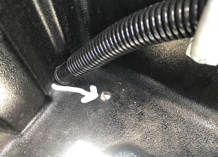

    So I'm impressed with the BakFlip MX4 washed the truck a few times
    sprayed down the cover and water in the bed was minimal, real minimal.
    However it would be swell if the raid-tube would fit into that little and
    I mean little hole. Really don't want to take a drill bit and open that up
    although I guess it wouldn't really hurt that much ( or would it )...
    Otherwise some kind of reducer would be cool -
    Any of you folks do anything along these lines?

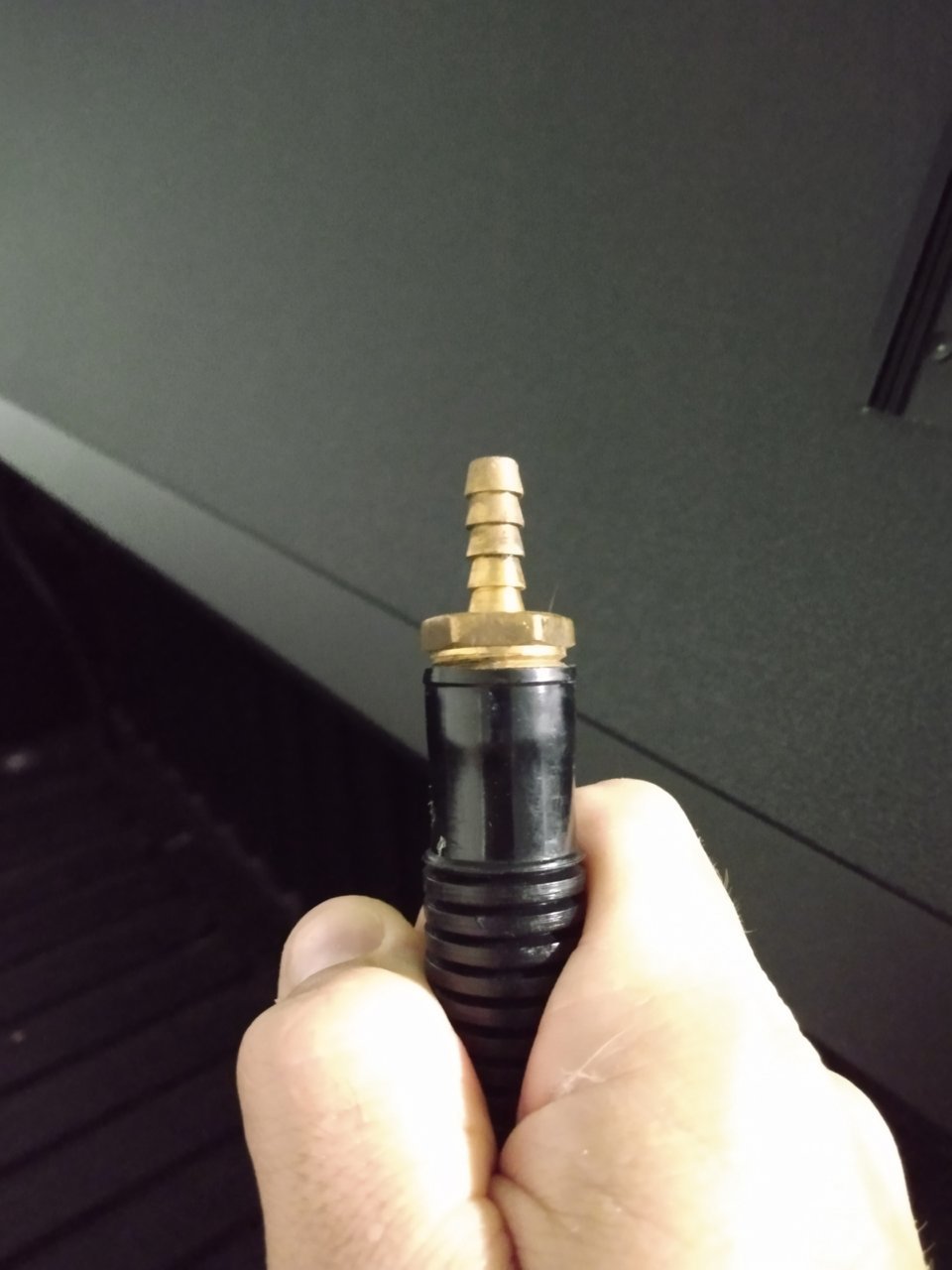

    I used a brass fitting that fit the existing hole in the bed. There is a thread around here somewhere that I got the idea from.

    IMG_20210520_175024489.jpgdon't ask me what size because I can't remember.

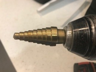

    I used a step bit, I would recommend using one of those.

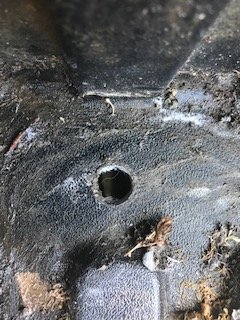

    I used a step drill bit to enlarge the three drain holes. They were so small in original form that the smallest leaf, stick etc would clog them up and not drain. End result was a lot of wet organic material that would take forever to dry out.
