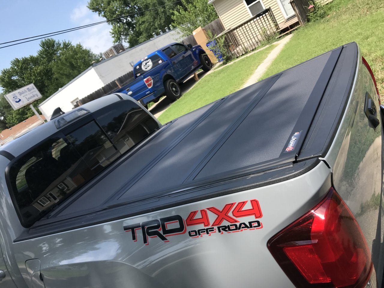

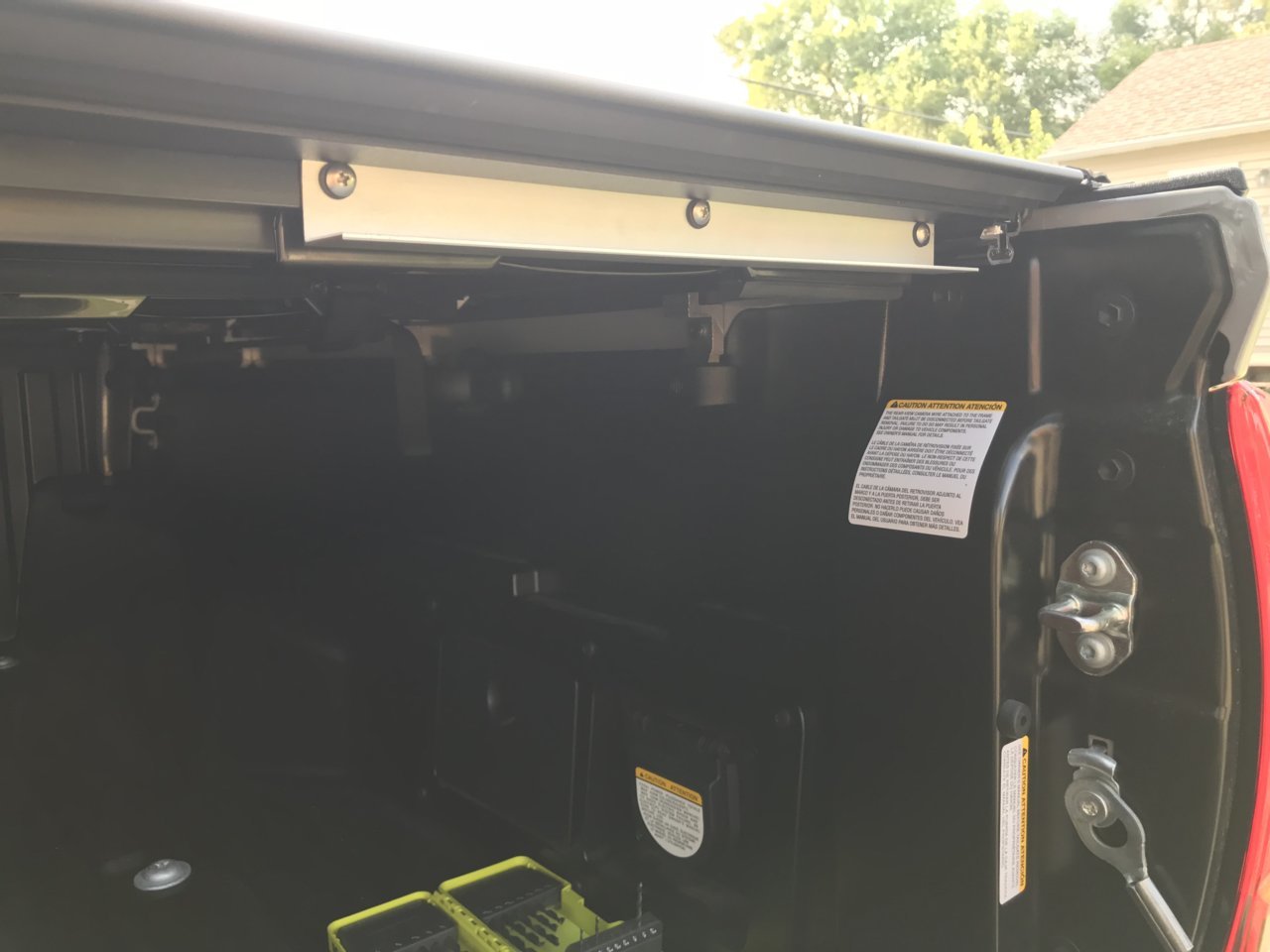

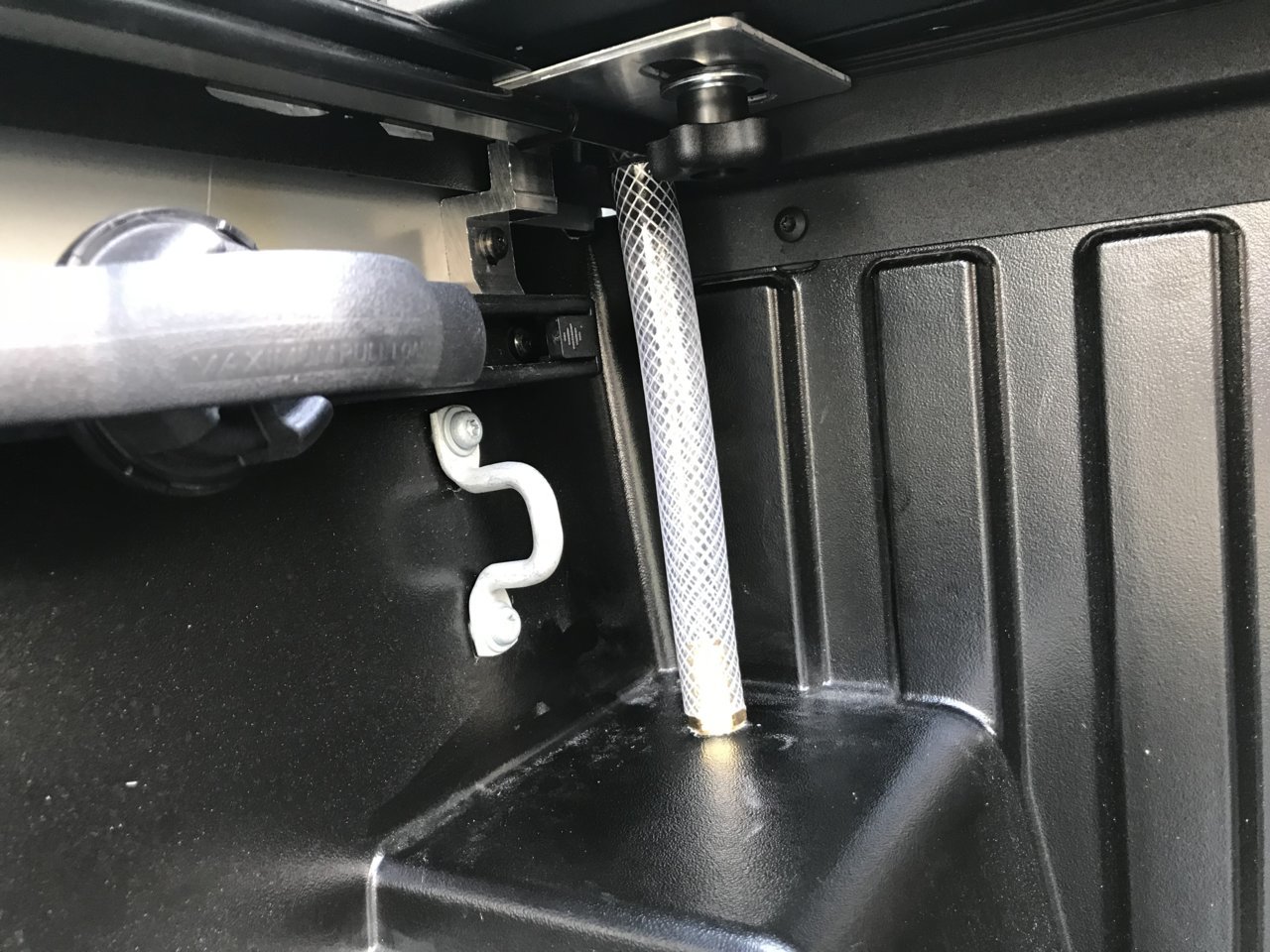

    Installed mine today with a few modifications. Seems to be pretty nice so far. No rain to really tell how waterproof it is. I siliconed some of the gaps, installed my own drain tubes in a much more convenient spot and fabricated some simple anti coat hanger doo dads to add a lot more security to the system. So far so good. Rock solid.

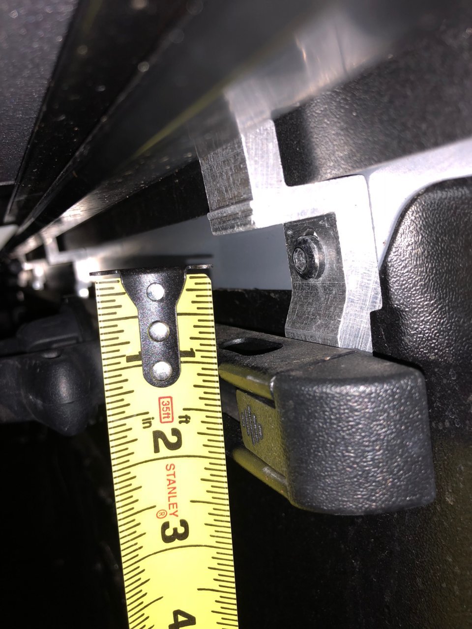

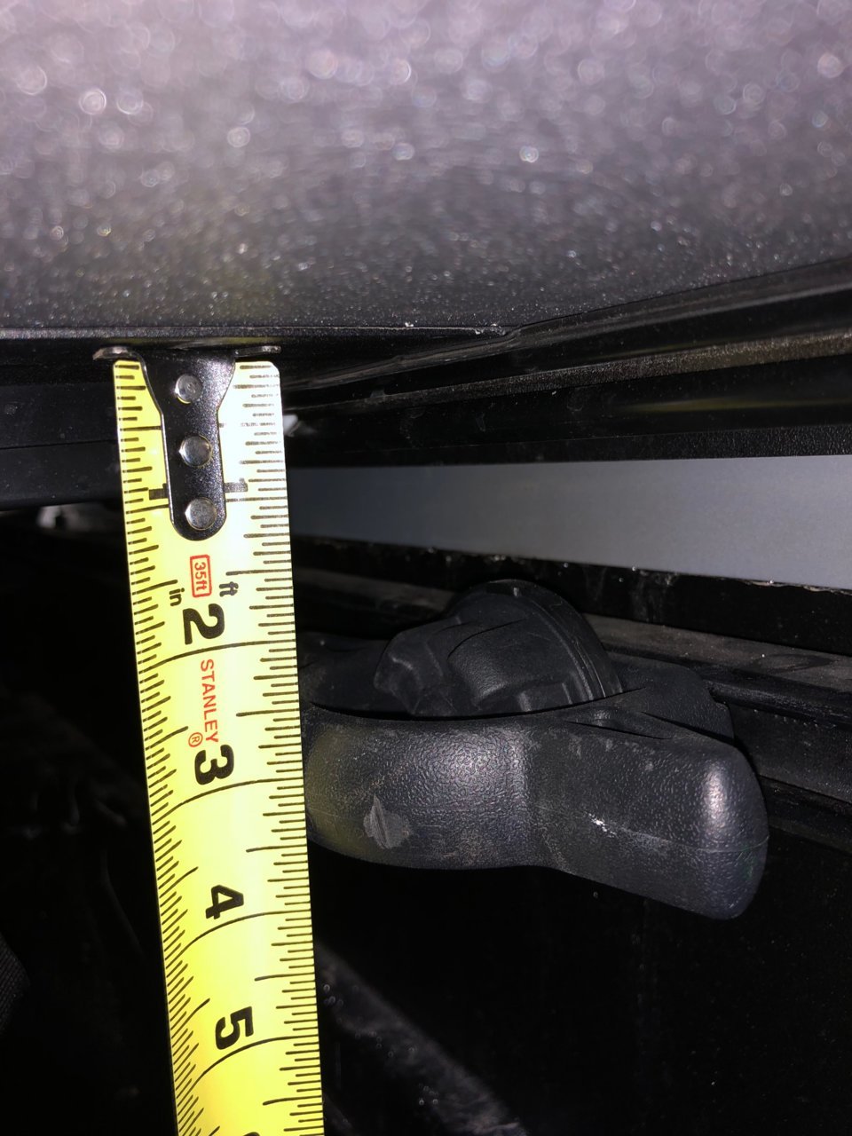

    Do the bed cleats hit the cover when it’s down or there is plenty of clearance to move them along the rail?

    There is a 2.5" gap between the bottom of the tonneau cover and the top of the cleat. The attachment brackets supplied with the MX4 lower the OEM rail about 1.5".

    I'm curious where you got that aluminum from for the anti-hangar shield?

    Local Hardware store. Home Depot should have the same.

    I used 1/16" x 1"
    Anodized Aluminum angled stock.
    SKU 608034
    Cost 8.99
    6 SS Screws and washers about 3 bucks.
    Came in a 3 foot section. Cut two pieces at 12 7/16. Lined everything up, measured some. Measured again. Penciled drill marks. Center punched them. Drilled pilot holes, then aligned the bracket up with the existing latch bracket assembly, made marks, center punched and drilled some holes.
    For both I gradually drilled using the next size up. I used Stainless Steel sheet metal screws with rubber washers to mount them. The bracket when installed, meets up with the tailgate with a very small gap in between. It was perfect, as you can see in the picture. Once closed more the gap closes. I just had it out a little more so you can see better. Overall a great and easy mod that increases the security of the BakFlip tremendously.

    I wondering, do your drains tubes drain into the wheel well or do you have them routed out somewhere? I don't like the long tube routes to the existing holes. I was thinking of going down like yours but maybe make a hole to drain out into the gap between the cab and bed
