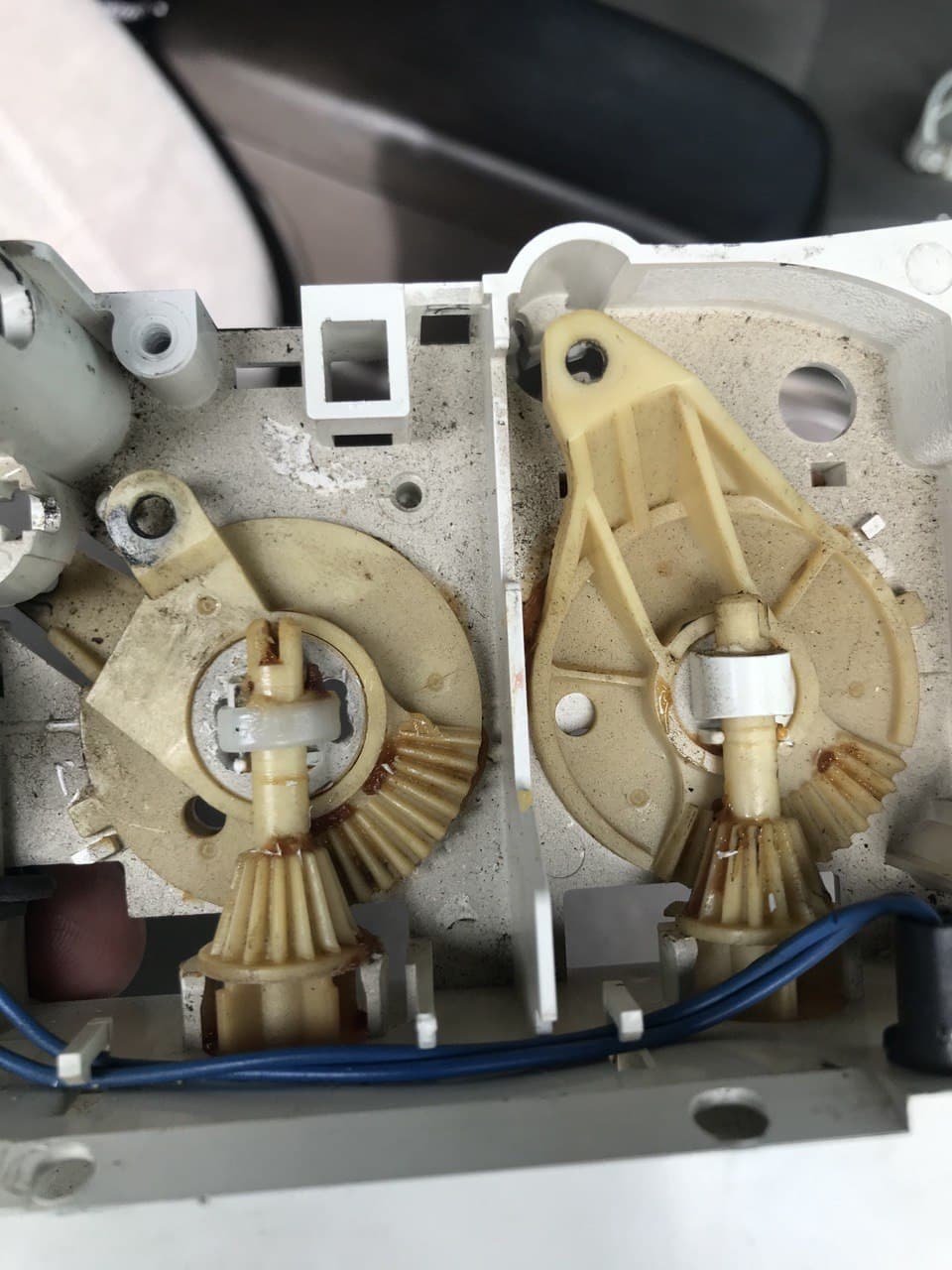

    So, my heater control knob has been clicking (cable slipping?) when I get about 75% of the way to full heat. I could wiggle it and get full heat with a little effort. Now it quits at about 30% to full heat. I had to pop the hood and move the valve manually at the end of winter. Bad cable, bad valve, or bad knob? Or a combo or those options? Anyone dealt with this? I have yet to rip into the dash for anything yet. Figure I'd work on it now instead of in December.

    So I finally got around to the diagnosing stage today. First I unclipped the cable at the valve and took the cable off the valve. No tools required. And the clip is captive so it doesn't fall into the engine compartment! The valve moved very easily by hand. Went into the cab and tried the hot cold knob. Still got about 30% towards hot and then click, click, click. Pulled the knob off and looked in and everything in there is just stops and detents. Nothing you can see is making the clicking sound. So it is internal plastic gears that are clicking I'm assuming. I can push the knob in hard and turn it and it works the cable without clicking. So I go attach the cable again and try the push the knob hard trick and NO DICE. It starts clicking/slipping at the same point. So my analysis is that the cable started to bind up and over a few years I forced the gears too hard and then they started to fail. I'm inclined to buy the cable AND the control unit/assembly since I'll be deep enough in there that I'll probably kick myself if I have to do it twice. Am I missing something? Parts with shipping are $145.00 or so.

    Glad to help- I had similar symptoms with the clicking at the end of travel on my hot/cold knob. I believe this is the gears skipping, but they aren't necessarily ruined. The whole assembly is weak enough that given enough resistance, when you are turning the knobs, other parts start flexing and this allows the gear teeth to slip past each other. It sounds horrible, but it doesn't mean anything is permanently broken. In my case all of the drag causing this was due to dirt/wear inside the cable sheath. You can rule that out if you want-
    Before you drop money on an entirely new control unit (and if you go to the trouble of that, you are looking at a lot of work to get all 4 cables disconnected. I would buy all 4 cables and replace them given the hassle involved!)- Try disconnecting the cable (at the control unit) for the hot water valve and see how things feel at that point. You will probably have to disconnect one cable above it to get access (I believe this is the fresh/recirc cable). While you are in there, clean and lube both sets of gears and all other moving parts with a high quality grease. Also clean/grease all the moving parts going into the air box under the dash (I use
    Super Lube 21030). See if that makes things better before you replace the entire control unit. At that point, if you have the hot/cold cable on hand, it's 5 extra minutes to replace it by sliding it out from the engine compartment towards the interior, and sliding a new one back in and reconnecting and re-adjusting (at the valve) for proper operation.

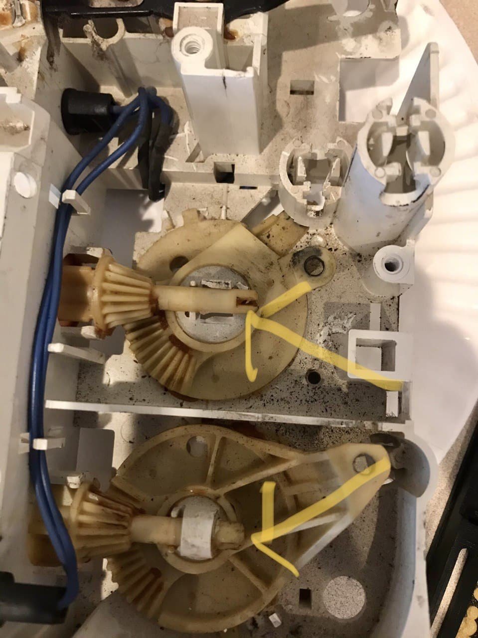

    I have the same problem w the clicking of the heater control. Mine was caused by a worn out Heater valve control cable that caused the plastic to break off the controller, which led it to click
    see picture. [​IMG]

    Thanks for this! I still haven’t fixed it as I had a tough time getting the cable clips off the control unit. Seems like I need a new cable (which I have) AND a new control unit.
