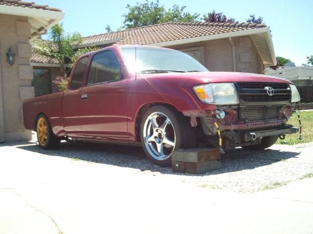

    So that is really kinda weird. Now I am very curious. I wonder when they discovered the defect, and how they traced it back. Perhaps they had multiple vendors supplying ball joint over the years, and it was only one vendor who was screwing the pooch.

    <reluctantly> my truck supports your hypothisis. Built Sept.2002. Was part of the recall.

    bummer for you, that just happened to me as well. Your lucky(2wd) cause in my case the shock was bent along with rack in pinion cv axle. I got both sides done due too fear of it happening again. mega bucks dude. I'm still in shock. get OEM ball joints for sure. Best of luck with getting her back on the road.

    Yup. The visuals are a profound motivator to make that call ot the dealer...this is the third time I have seen this on TW on a first gen. Not a photo gallery you want to be in.

    mine is a 1996 and i've had this happen TWICE first time was 2010 summer and they replaced both sides. the second time was this past sunday. the ball joints werent even a year old!

    Actually that scares me because I thought the 5 lugs weren't affected by the recall. Better hit up the stealer :eek:

    • ehicle Make / Model:
      Model Year(s):
    • Vehicle Make / Model:
      Model Year(s):
    • TOYOTA / 4RUNNER
      2001-2002
    • TOYOTA / SEQUOIA
      2002-2004
    • TOYOTA / TACOMA
      2001-2004
    • TOYOTA / TUNDRA
      2002-2004
    • NHTSA Campaign ID Number:
      05V225000
    • Summary:
      ON CERTAIN SPORT UTILITY VEHICLES, DUE TO A MANUFACTURING ISSUE IN THE FRONT SUSPENSION LOWER BALL JOINT, THERE IS A POSSIBILITY THAT THE SURFACE OF THE BALL OF THE JOINT MAY HAVE BEEN SCRATCHED. THE BALL JOINT MAY EVENTUALLY EXPERIENCE EXCESSIVE WEAR AND LOOSENESS, RESULTING IN INCREASED STEERING EFFORT.
    • Consequence:
      THE LOWER BALL JOINT MAY SEPARATE FROM THE KNUCKLE CAUSING LOSS OF STEERING CONTROL AND A CRASH COULD OCCUR.
    • Remedy:
      DEALERS WILL REPLACE THE FRONT SUSPENSION LOWER BALL JOINTS FREE OF CHARGE. THE RECALL BEGAN ON JULY 5, 2005. OWNERS MAY CONTACT TOYOTA AT 1-800-331-4331.
    • Notes:
      TOYOTA RECALL NO. 50J. CUSTOMERS MAY ALSO CONTACT THE NATIONAL HIGHWAY TRAFFIC SAFETY ADMINISTRATION'S VEHICLE SAFETY HOTLINE AT 1-888-327-4236 (TTY 1-800-424-9153), OR GO TO HTTP://WWW.SAFERCAR.GOV.
    From the NHTSA web site- I looked up my 2002 and it showed this, maybe there are older recalls too? Seems like it must have been an assembly plant defect if it lasted 2001-2004.
