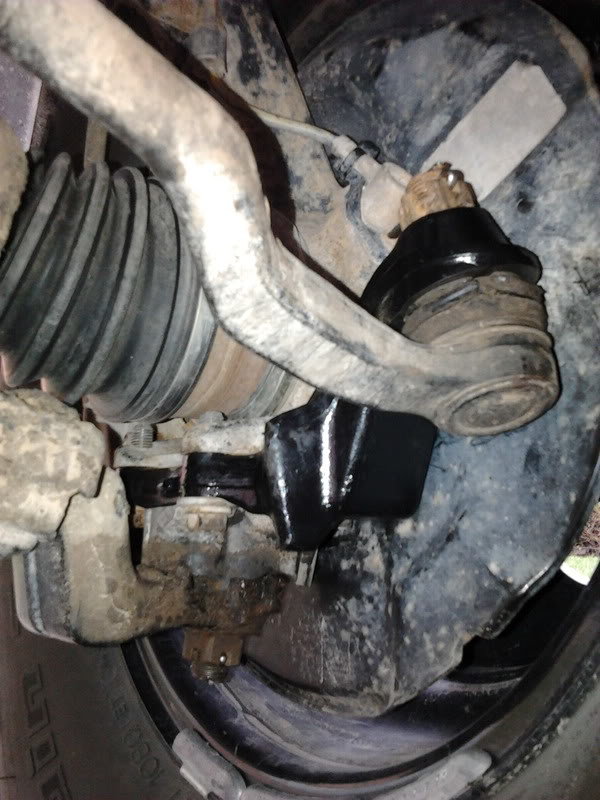

    Over a year ago I posted here about a ball joint blowout - well it happened again today.
    Fortunately my wife and I were slowing down around 10mph, when this time the left front (previously right front) blew out.
    Fortunately it wasn't as bad - but it's towed off to the mechanic and will have to wait until after the 4th for an estimate.

    did you not replace both sides when the first one blew?

    I had them all replaced, and the first time they also damaged the tie rod, and brakes - so all that had to be replaced.
    I don't know much about vehicle repair - but that is what they had to replace.

    Your a 5 lug aren't you? I'm surprised I don't see even a speck of grease anywhere. Was it totally dry?

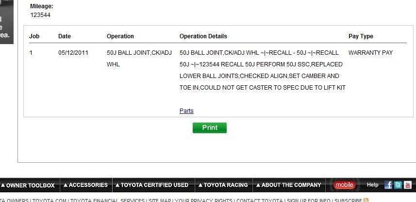

    I signed into the Toyota owners website and my ball joints were replaced in 2005 with 17K miles on my truck under the recall. It also showed warranty work that was done it. It did only list 1 qty as being replaced, which scares me a bit.
