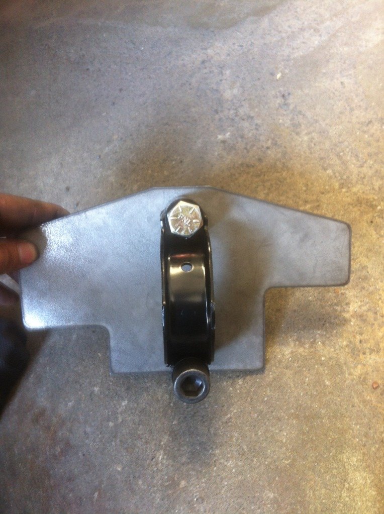

    Looking over the damage from my ball joint failure yesterday and noticed this crack. What can I do about it? Anyone have this happen?

    Yup. Cut out the old one and make a new one.

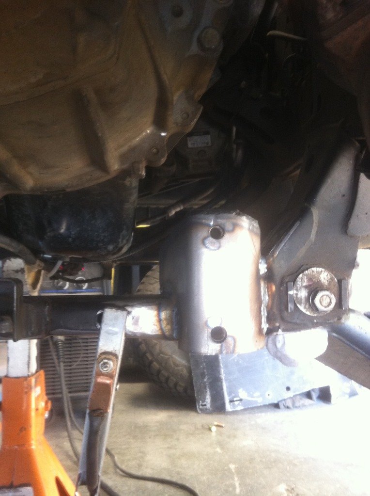

    Ripped mine completely off. Just hammered it back in place and welded back up. Not quiet perfect and if you have time do what Jason did.

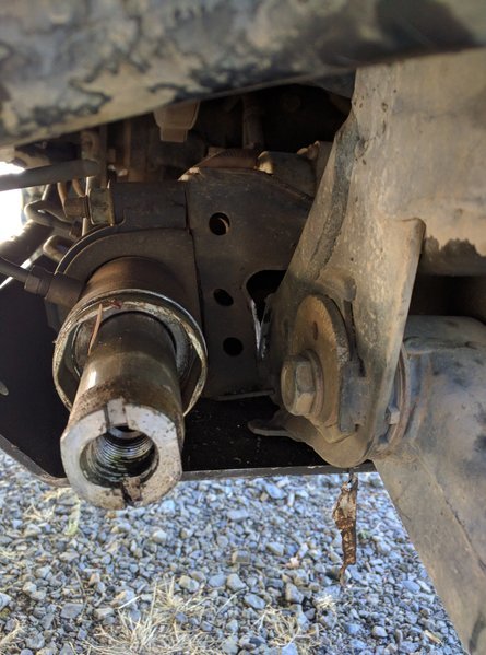

    I'm pretty sure it was an UPPER ball joint that failed here.

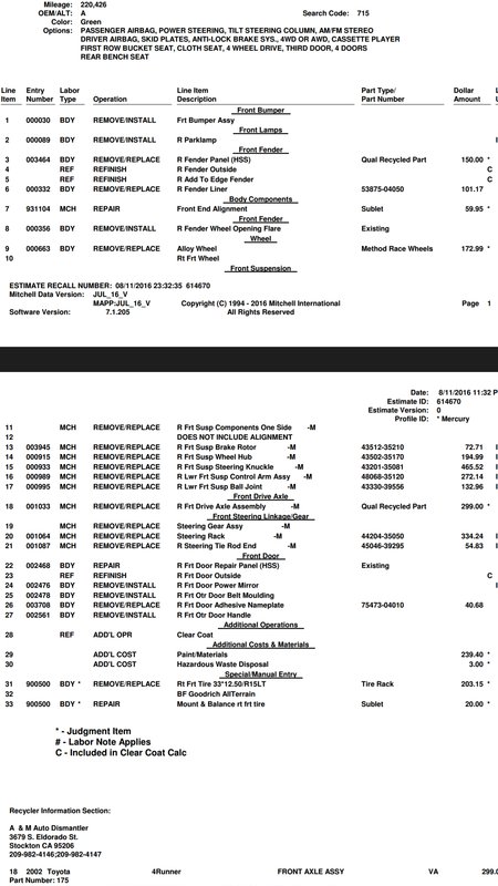

    Waiting to hear from my insurance before I start working on it. Not sure how insurance really works or if I should even go that route. Never filed a claim before.

    If it was an upper ball joint, and it looks like it could have been, just make sure to do the upper and lower. Might as well do the other side while you're at it. And use OEM parts or they'll be failing again shortly. Unless you're doing the new UCA's.

    I'm getting very impatient waiting for a reply from my insurance. I'm questioning whether it's the right route to go. My deductible is $1000 and I'm not 100% sure if they'll even cover this.
    What are your guys' opinions? Should I just start working on it myself? I'm sure I can get it all done for less than $1000.

    Finally got word from insurance. Three weeks later. Everything is covered! I'm pretty stoked. Even getting a new method wheel and km2.
