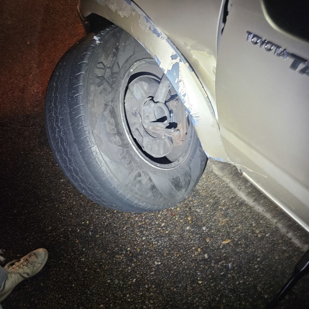

    Replced the ball joints a few months ago, after a catastrophic failure on the driver side. (The lower ball joint itself snapped) I just had another catastrophic failure on the same side. This time the bolts sheared. I need some help. I used the black flanged bolts that came with the kit and torqued them to 59 ft-lbs and i got this...20241217_174353.jpg

    By the grace of God, low speed. First time, I pulled into my parking lot, this time I was turning around because something didn't feel right. Both times I had to drive to 3 hour round trip to Oxford MS. I was going off of a Hanes manual and YouTube when I replaced the ball joints.

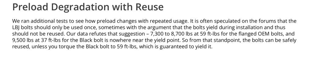

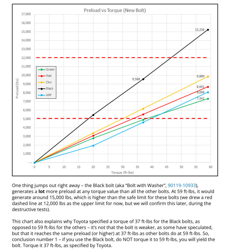

    According the link I posted above.
    You don’t want to reuse the black bolts it you tq to 59 ft/lbs.
    Read the LAST sentence below.

    I wouldn't reuse them. New oem bolts (not black) and torque to spec. Blue lock tite if anything.
