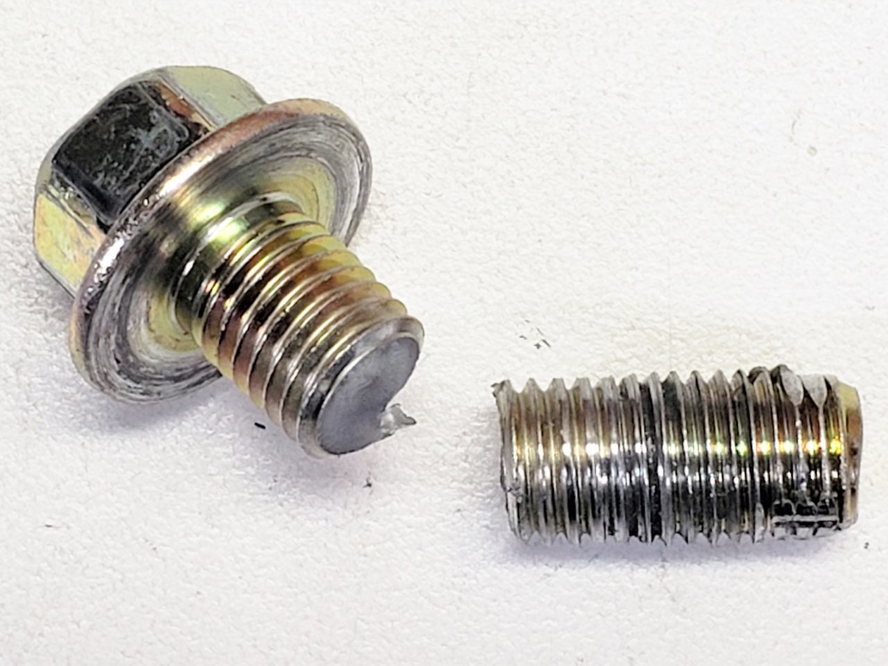

    Yes, but :). Like you said, that's true for identical materials. In reality, the bolts are higher strength than the knuckle, so its male threads are stronger than the knuckle's female threads.
    What I am seeing so far is that when torqued to failure, the bolt breaks in tension/torsion, not in thread shear. But the threads do show severe yielding and deformation:
