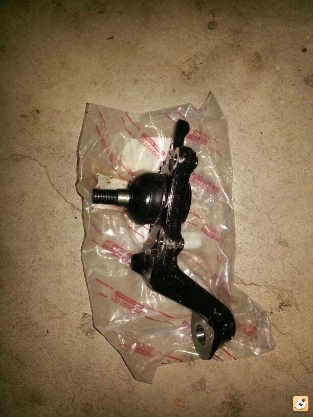

    Looks like I finally found the right forum. After reading everything looks like I am going with ome lbj. I was putting on a suspension lift and was having a heck of a time getting my ubj off when I noticed my lbj were both shot. I finally got everything apart after realizing that the lower wasn't the same as the upper as far as what comes out. Anyways do I just need to get the actual ball joints or this piece as well. Like I said I didn't realize that the housing for the ball didn't come out after beating the hell out it and caused some damage. If I do need it, what is it called? I can't seem to find it on the camelback site.
  9. Dec 22, 2013 at 9:02 PM
    #129
    Johnnie
    Johnnie Well-Known Member
    Mar 11, 2009
    #14594
    1,890
    I.E. SoCal
    Feds
    That entire piece is the LBJ. The ball joint is installed in that piece. It's sold as one unit.
  10. Dec 22, 2013 at 9:03 PM
    #130
    digitalferg
    digitalferg Well-Known Member
    Aug 10, 2012
    #84494
    434
    Southern Utah
    2006 1G Tundra DC TRD 4x4
    That's considered as part of the LBJ. Here's a pic of my OEM toy ones sitting in the garage right now waiting to go on...

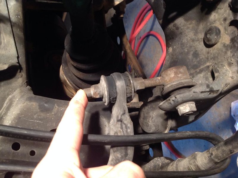

    Awesome thanks. Also looks like the bushings in this are shot as well. What is this called, I was pretty sure that 1gens don't have swaybars. Is it a stabilizer?
  12. Dec 23, 2013 at 6:02 AM
    #132
    JLee50
    JLee50 Well-Known Member
    Nov 20, 2013
    #116986
    391
    Phoenix
    Stockish 99 4x4 TRD
    ToyTec coilovers
    They do have sway bars. That's your sway bar end link.

    That arm sticking out with the hole is actually where your tie rod end goes to steer your wheel. Sway bar and end links dont have anything to do with ball joints.
