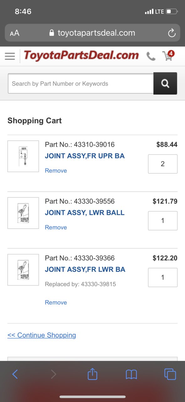

    Looking at replacing both upper and lower and each side. Does this look like all the parts I’ll need or is there more?

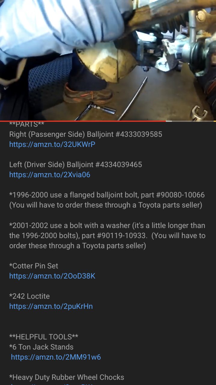

    Before you buy the bolts for the lower ball joint go and double check to see if you have washers on you bolts or if you don’t have the washers here’s a picture of the corresponding part numbers
    And buy some 242 loctite, I believe they come from the factory with some, but I just like the peace of mind, and that was the whole reason for my replacing my ball joints

    Thanks the info guys. I upgraded to OME suspension. Just need to know if I got the right part numbers

    In my sig line (you can see if you turn phone sideways) I have the parts numbers for the lower ball joints that include the bolts you're supposed to replace with the joint.

    Awesome, thanks for sharing! Where did you find that info?
    Also, it shows the bolt part numbers for 96-02...what about 03-04? I have a 2004 4WD and have seen conflicting info in terms of part numbers for my LBJs and want to make sure I get the right part and bolts...

    Hmm...that's good info, but Toyota parts inventory says that does not fit my 04. For the OP's sake and (and mine) and others, can you confirm those are year-specific?

    Yeah, the ball joints are the same across all years of first gen Tacoma, only difference is between 5 lug and 6 lug. And these are the bolts you want to use as well because you don't want that rubber boot cover thing. You want to lose that cover thing when you replace your ball joints. So these are the flanged bolts that come as a kit with ball joint and no rubber boot cover thing. Keeps it simple and it's the best scenario of OEM parts across all years of first gen 6 lug Tacoma

    The post above says the newer 1st gens use a bolt with a washer (NOT the flanged bolts). Is that wrong? I have a 2004 4WD and for some reason the Toyota OEM parts system says those parts numbers (LBJ with bolts as a kit) do not fit. Also, someone else told me to get the "Lower Ball Protectors"...you are saying don't bother with them?

    It's all interchangeable between all of the years of first gen. (besides a couple of those long ass bolts that were made for those LBJs with the spacer and cover, those would be too long to use in 2 of the holes of you tried to use them without the cover/spacer piece)
    The best combo for the joint and the hardware is the one in my sig, this does include removing and not reinstalling that cover thing if you currently have it.
