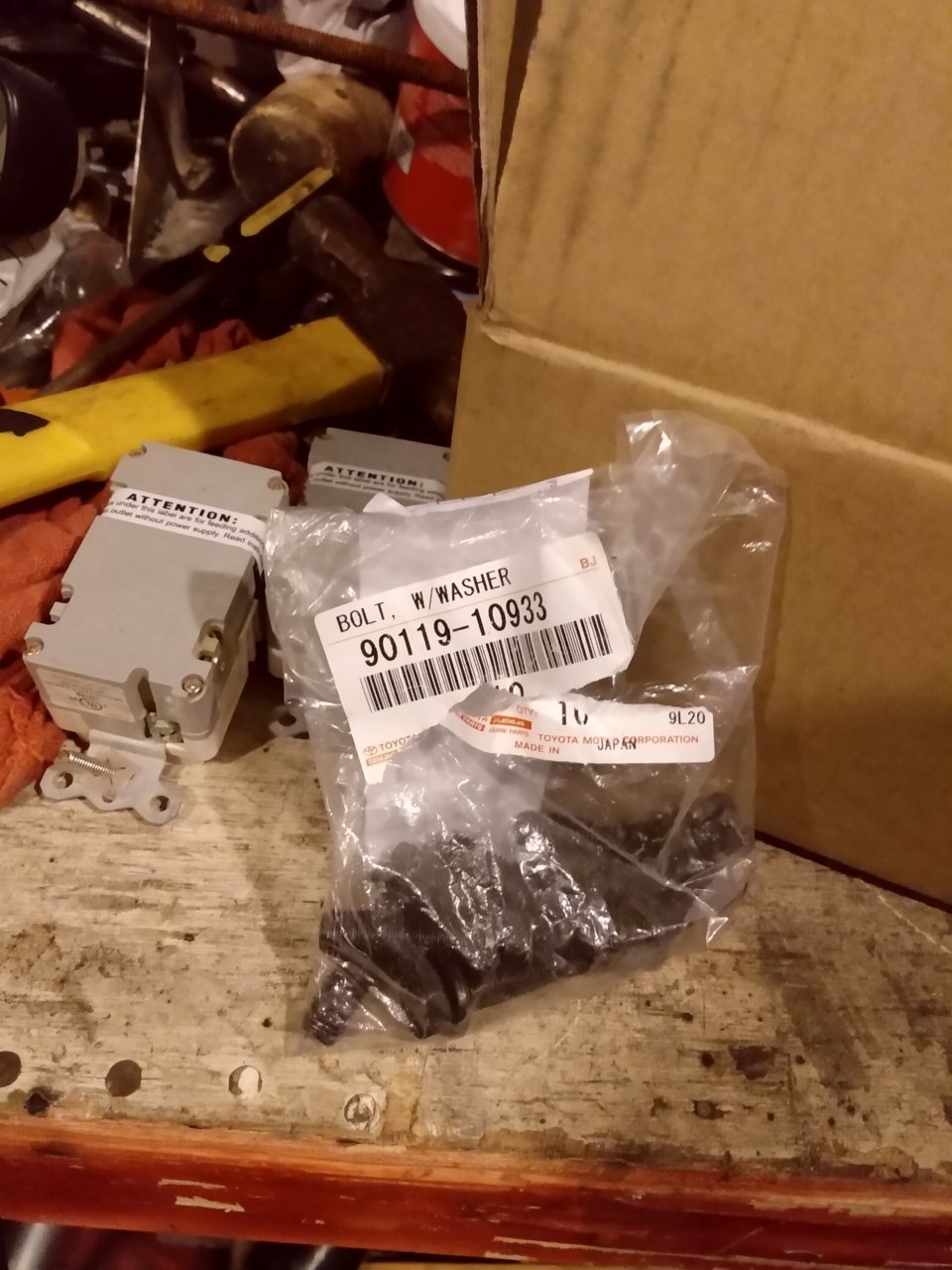

    I've heard this a couple times about the bolts being different lengths, but no one says anything about different part numbers. I ordered the bolts with a washer because I have the protector and all the bolts are the same length.

    Yea the 2 different part numbers are for either a flanged head bolt or a bolt with washer. But when you order one or the other they all come the same length. I have not changed my joints out yet, waiting for warmer weather but I ordered mine from Toyota parts deal and they were all the same length.

    Ok now with that said I ordered the bolts for the joint with the boot. They sent bolts all the same length. The only other part number is for a flanged bolt. What's the shorter bolt ?

    So if I ordered the flange bolts I'd get 4 short and 4 longer. With the washer there it was a pack of 10 the same length. Sorry for all the questions.

    Lol I know what you mean by the explaining it's hard being not face to face. But so far I know there is 2 different part numbers for the bolts. Ones flanged and one has a washer. If you have the protector you need the ones with washers. If you don't have the protector then you need a flanged. I've read that each joint needs two different lengths bolts, because two of the holes are blind and the other two go all the way thru. But so far I've yet to find 2 different lengths bolts with the washers, or 2 different length flanged bolts. I know everyone says to ditch the protector and just use the flanged bolts, but if I do that I have the feeling I'd still get a pack of flanged bolts all the same length.

    My bolts are all the same length, double checked last time I did the install. The ones that came out were all the same length (those were installed by Toyota) and the new ones I got were the same length

    Oh I sheered one of my new ones too lol. Talk about a stomach drop. Was the last one of the 4 bolts, just about hit 59 ft/lbs and the fucker snapped in half. It was one of the ones that doesn't go all the way through the spindle, too.
    Luckily the broken half came out easily with a thin pair of needle nose pliers, but still. No idea why it happened, the rest of the new bolts all went on just fine. I figured it must have been a bad bolt I guess. I ended up reusing the best looking one of my old bolts and it's been fine since, was probably 10k miles ago.
