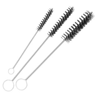

    What was your process for cleaning the threads in the bolt holes?

    70,120
    Azusa, CA
    I would probably just spray some brake cleaner up there and stick one of those bristle brushes up inside it and turn it around a few times

    #272074
    2,236
