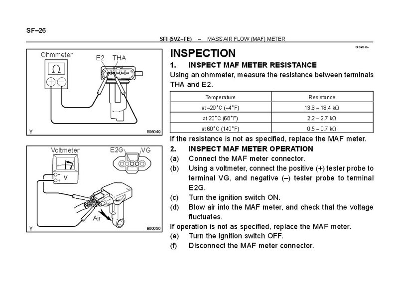

    Just for shits and giggles, today I checked the resistance of my MAF according to the FSM and between the E3 and THA terminals at about 70°F I was getting about 28kΩ! Could a bad MAF be causing all of these issues?

    A bad MAF sensor could cause erratic information and fueling commands. Those commands could cause some abnormal idle and performance issues. Can you post the FSM that you followed to do the test? I would like to read the details.

    False alarm. I was reading the page for the 2RZ & 3RZ engines. According to the correct inspection page of the FSM for the 5VZ, the resistance I'm getting from the indicated terminals is 2.1kΩ. Still out of spec but much closer to what's expected.

    Did you blow into the MAF sensor as directed to see if there was a fluctuation? Also, what was the ambient temperature when you measure the resistance? That is what you need to know to complete this test correctly.

    I got voltage fluctuation when blowing into it and my reading of 2.1kΩ was with an ambient air temp of about 66°F so the resistance is just a wee bit out of spec. While giving my engine another once over this morning, I saw that the intake tube and the airbox had a fair amount of grime in it so my project for this afternoon is to clean that out. Air filter still looks good as it was changed out a couple thousand miles ago when I last changed my oil.

    Honestly I would say that a 2.1kΩ reading at 66ºF would be spot-on. The average for 68 degrees would be 2.4kΩ. I would say the MAF sensor has the correct temperature. Take a look at all of the vacuum lines and make sure none of them have any cracks. This will make the MAF signal for airflow be inaccurate, since any leak in the vacuum system would be unmetered air.
