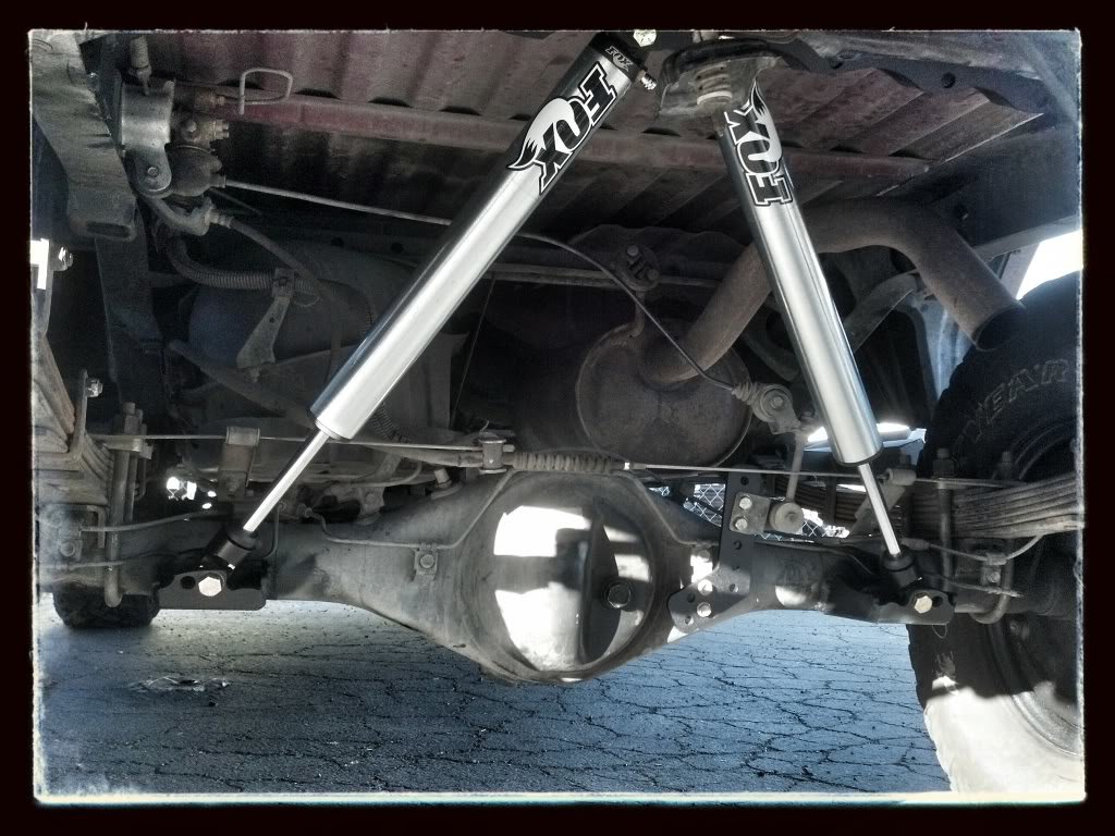

    Hi guys :D
    Has anybody put this on a 2003? My brake cable is set lower than what Jerry shows on the first gen install and it looks like it might conflict with the shock on my setup.
    What do?
    Compare my install to the standard install...Sry no Von Dutch ;)
    As you can see the brake cable in the pic below is above the leafs whereas mine is below.
    TIA

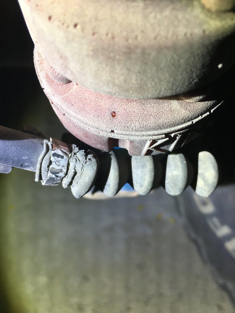

    The cable with the bamf lower shock tabs were rubbing and I had to push out the brake cable with a little longer tab.
    Then i just tossed the bamf lower mounts cause they are weird and got something much better from a local offroad shop.

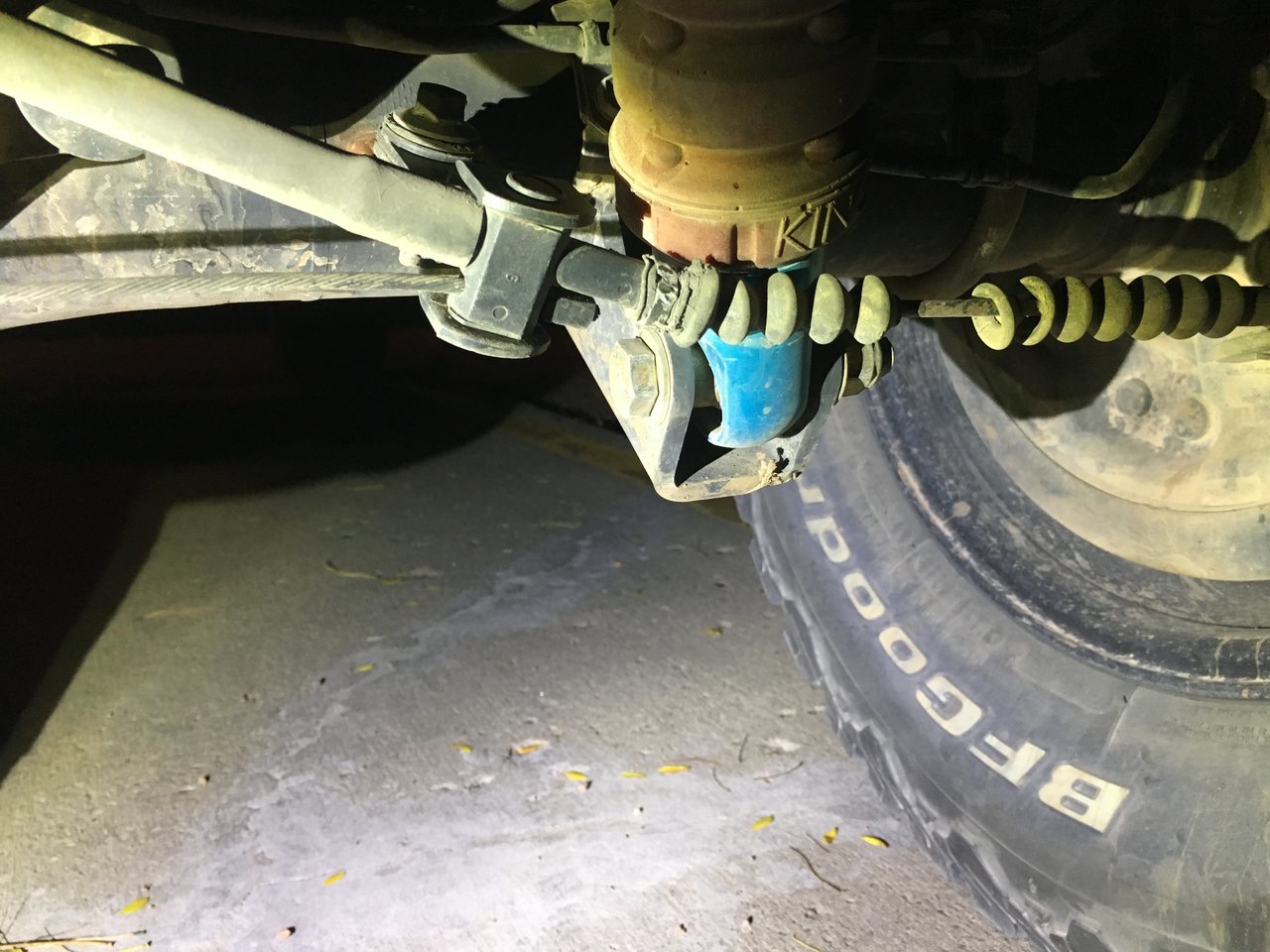

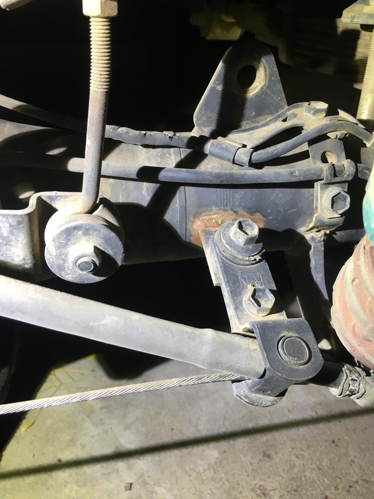

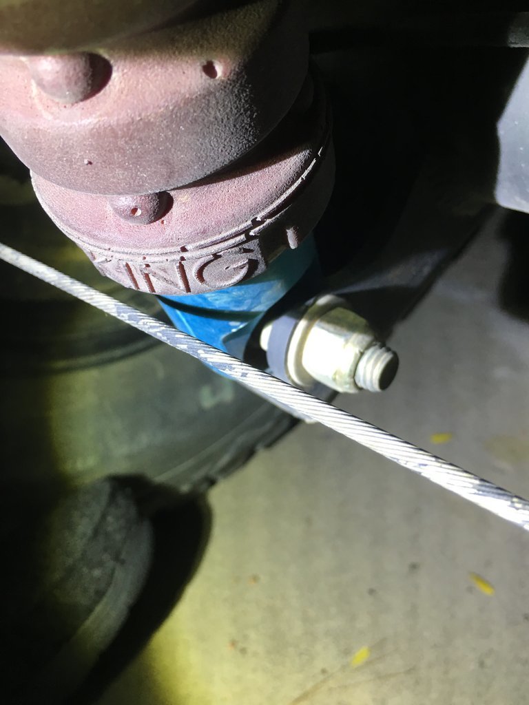

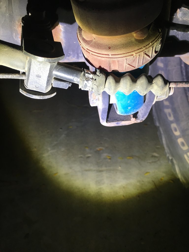

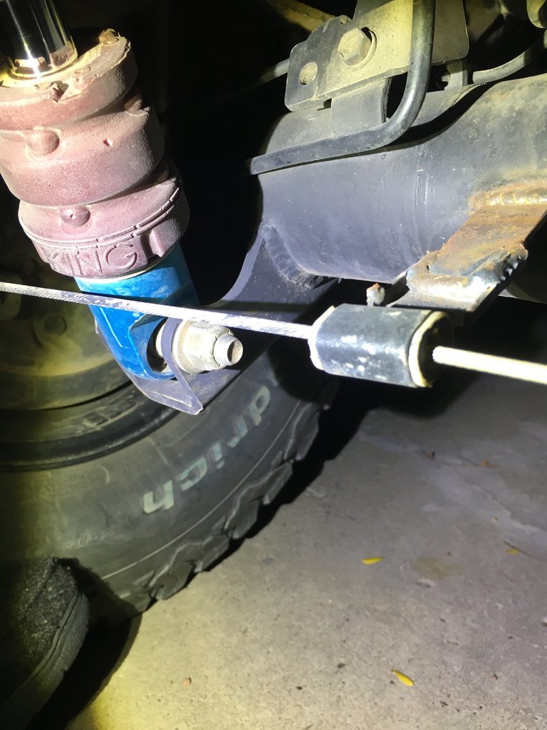

    Here's pics to the solution. The the bamf mounts it rubs worse. Better off getting mounts below the rear axle. Plus it'll be easier to fit the shocks more straight up/down and cycle.
    Sorry in advance for the dusty underside. Didn't get around to washing it this week.
    IMG_8144.jpg IMG_8146.jpg IMG_8147.jpg IMG_8148.jpg IMG_8149.jpg IMG_8150.jpg

    Having that E brake cable there is a real PITA and always in the way when going over rocks etc
    The different tabs were a no brainer to me seeing as the ones provided will bind at the angle I wanted to be running. Plus wouldn't allow the up travel I needed for bump with my deavers
