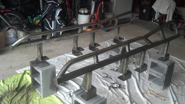

    So today I did all the prep work for installing my new BAMF bolt-on kickout sliders! I received the sliders on Monday after a pretty long wait from when I ordered them in a GB a few months back; but after seeing the quality of the work and handling these beastly things it was well worth the wait!!

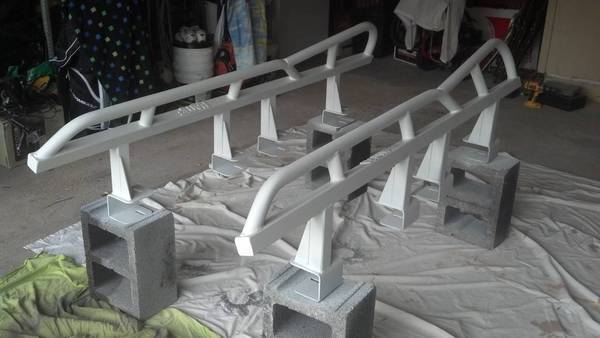

    I figured since I plan on actually using them as sliders it would be best to paint them myself so that it would be easier to touch them up once they get banged around.
    Here's the products I picked up at Wally world/Lowes - ~$50 total
    Because it was pouring rain on Monday when I received them; they had already started to develop some minor surface rust.
    First step was to take a wire wheel to them to remove the rust as well as scuff up the metal to promote better adhesion of the paint. I also rubbed them down with steel wool and a scotch brite pad (heavy duty green one, couldn't find the red one @ Lowe's)
    After they were sufficiently 'sanded' I wiped them down thoroughly w/ paint thinner and a white cloth. Then wiped them down again w/ a clean rag
    I applied the Rustoleum Clean Metal Primer in two stages; first a light coat then went back over them with a heavier coat making sure I covered every inch. I made sure that I liberally applied the primer at all the welds. (which looked great btw)
    Next, I went over the dry, primered sliders with a 320 grit sand paper really lightly and wiped away the dust w/ a slightly damp rag. After allowing them to fully dry I began spraying on the Rustoleum Fine Textured Paint (Black) again in two stages, light at first then a heavier thorough layer w/ a focus on the welds.
    I used up all three cans of black and allowed it to dry as I ran back to Walmart for another can (luckily only 5 min away) I used the final can for touch-ups and set them aside to dry. It's supposed to rain for the next couple days here so I'm gonna let them sit in my dad's garage until the weekend when I hope to get the mounted.
    I am really pleased w/ the finished look of the Rustoleum Textured Black paint and hope that my prep work pays off and the paint holds up well over time and abuse,

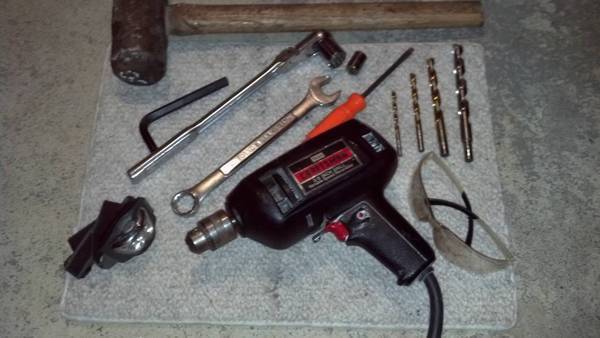

    Here are the tools that I used
    Corded drill 3/8" drive
    HSS drill bits in 3/16", 1/4", 3/8", and 1/2"
    3/4" combo wrench
    3/4" socket and 12mm socket
    3/8" allan key
    flat head screw driver
    BFH
    needle nose vise grips (not pictured)
    head lamp
    and of course safety glasses

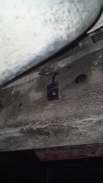

    note: on the PS, the clip holding the wire for the rear o2 sensor needs to be relocated to the hole above it, easy peezy w/ a flat head screwdriver.

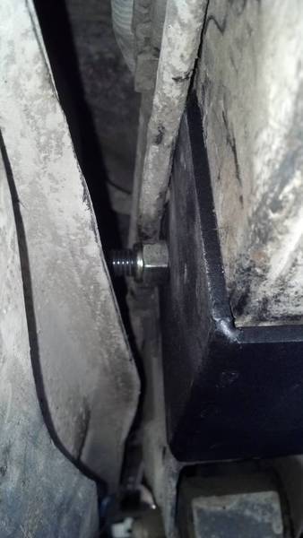

    Jerrys design utilizes factory holes on my '01 DC to bolt on the rear and second from front legs. They aligned very well on both the DS and PS. After mocking the sliders into place I marked where the holes for both sides of the remaining legs needed to be drill and removed the sliders. If I had a 90* drill I might have been able to drill the holes w/ the sliders in place, but alas I was forced to do it the hard way.
    Drilling/ Bolting:
    PS - the cat/exhaust is in the way on the inside of the frame so I had to drill from the outside all the way through the other side. I used HSS bits in stages 3/16", 1/4", 3/8", and 1/2". They did a pretty nice job, but it was a little difficult to get the holes lined up perfectly level and the bolts were a tiny bit crooked. I sprayed the newly drilled hole w/ a quick shot of Rustoleum black and positioned the sliders into place. Using the 3/8" Allan on the outside and the 3/4" wrenches on the inside I tightly secured the legs to the frame.
    Bolted PS slider w/ relocated o2 wire
    DS - I actually found the DS to be a little more difficult. First I would recommend removing the bracket (12mm) that holds the ebrake to the frame to give you a little play in the cable. (replace when done)
    I mocked up the sliders same as the PS, marked my holes, and removed them. The front hole has to be drilled from the outside like the PS but the other can be drilled from either side. I positioned the slider into place and bolted them down. Tight squeeze w/ some hard lines too but it clears.
    The rear bolt is a real PITA because of how close the gas tank comes to the inside of the frame. It is right where the rear leg bolt hole is. The ebrake cable also hampers your ability to get the nut in place. I pushed the ebrake cable out of the way w/ a screw driver and used needle nose vise grips to hold the nut in place as I turned the bolt to get it to grab. After some finagling I got it threaded and left the vise grips on there until it was good-n-tight. I bailed on the supplied washer for that one cause it was just that tight a squeeze.

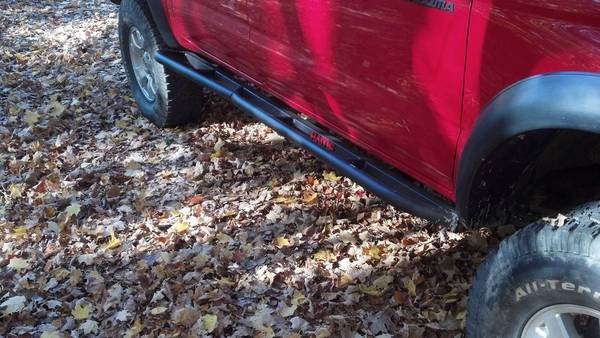

    BOOM!! they're installed :) I touched up some paint where the BFH had scratched them and painted all the bolts and nuts too. Very glad I didn't go for the powdercoat.
    They fit perfectly between the wheels and the clearance to the body is comfortable and consistent all the way around. The angle upward is ideal IMO and they don't stick too far out either (something I was afraid of) but still can easily serve as a step.

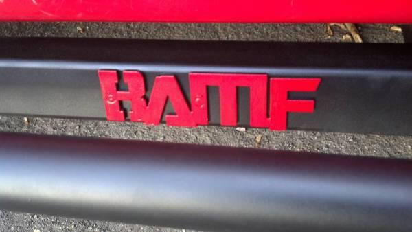

    added a little touch of "Rad" too

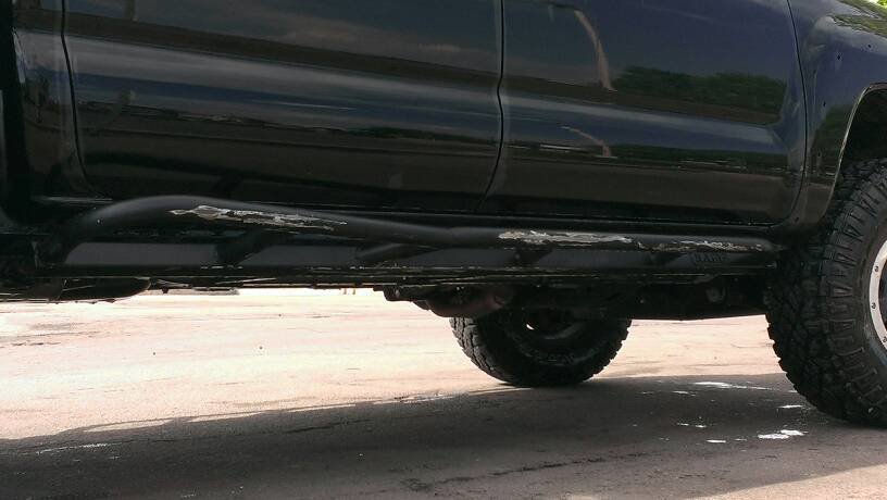

    Those look great and I like the texture look and practicality (if they provide enough traction on wet sliders).
    But they won't hold up with abuse. Your first hit on a rock or dragging them across a rock and it'll go right down to bare metal.
    It's like scars... chicks dig them.

    I have banged my BAMF sliders on countless rocks, they never cease to amaze me. You will have to repaint them if you offroad though. I have to paint mine every time I come back from wheeling.

    I used cheap rattle can Rustoleum enamel and took some carnage to the sliders the last wheeling trip. I still haven't gotten around to touching them up and they've held up fine. Just some surface rust on the bare metal.
    I definitely need to touch them up before too long though.
