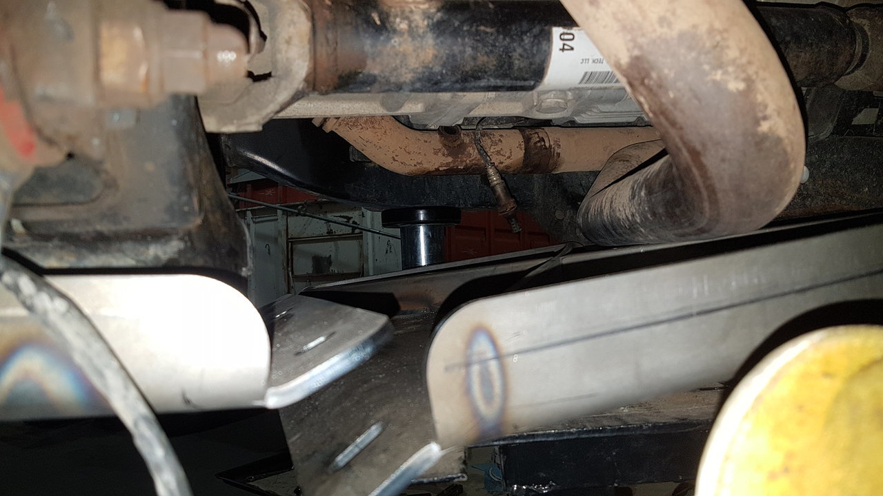

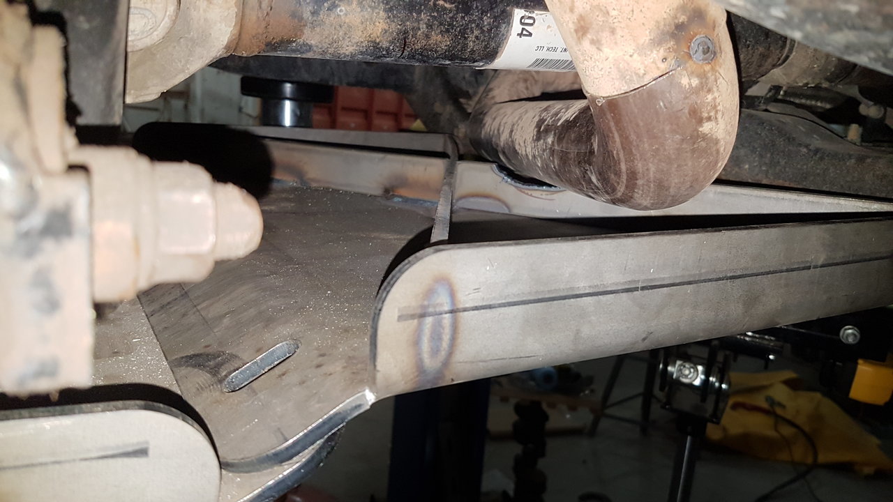

    URD Y pipe does not fit
    The_Black_Pearl likes this.
  19. Mar 5, 2018 at 7:25 PM
    #219
    FreidTaco
    FreidTaco boost
    Sep 21, 2011
    #63918
    2,829
    jeff
    Panhandle of Wyoming
    06 Tacoma TRD OffRoad SR5
    URD Stage 3 SC. 35" duratracs LT

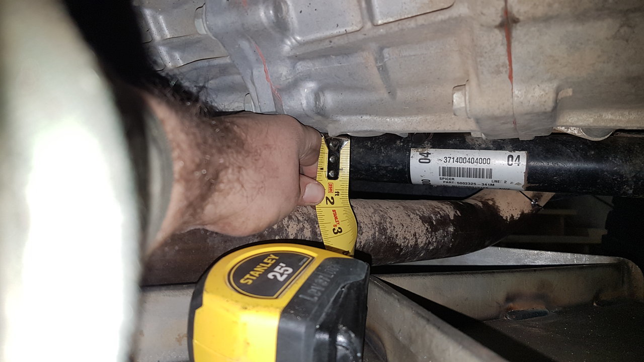

    Advise *** Make exhaust adjustments at your discretion. This may not be the correct way to route but this is how I managed to do it at home with URD Y pipe.
    I cut 1.25" from the verticle section on driver side below the o2 bung. Score pipe before cutting and keep orientation the same. Undo passenger side exhaust clamp to allow section to realign roll and I also had to drive those 2 sections in tighter to keep her in same place. Only had to cut 0.5" from X brace to achieve adequate clearances.
    I now have 0.5" clearance to driveshaft and 1.5" from trans.
