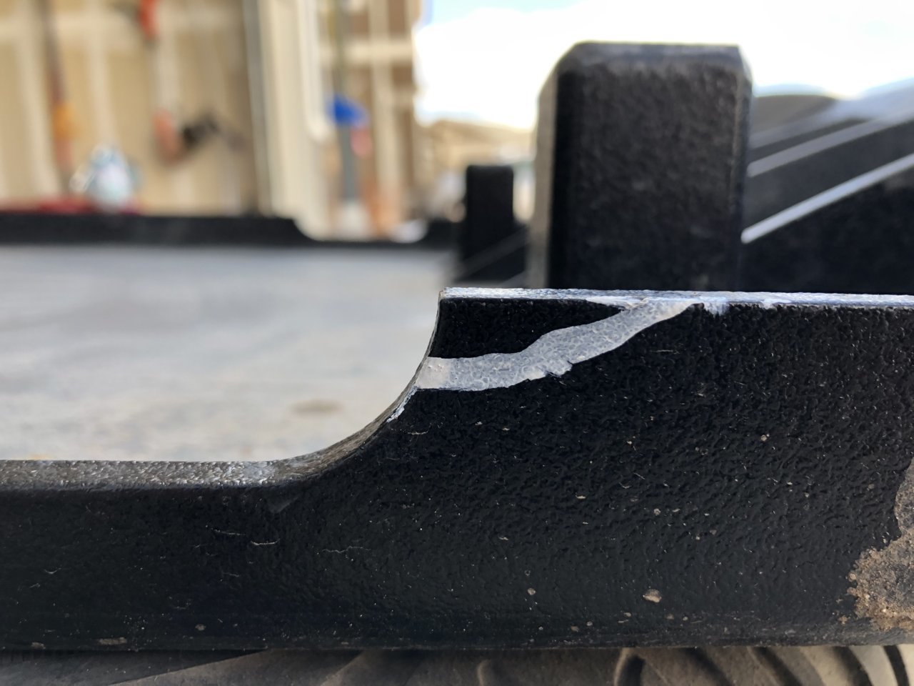

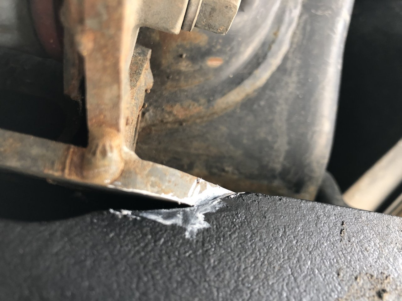

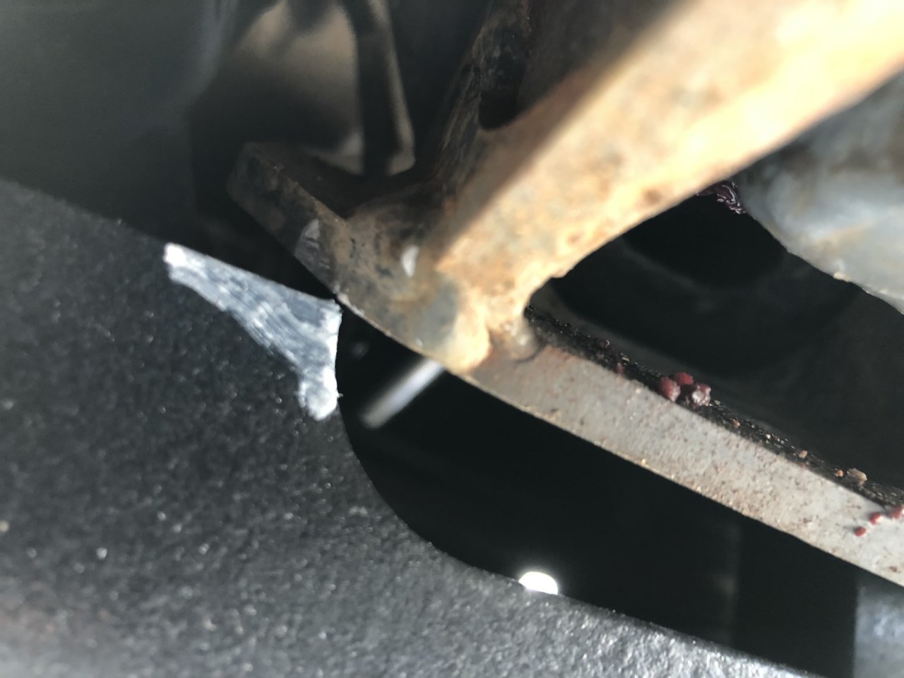

    To add on to this here is how much I’m having to cut. Very minimal.
    driver side:
    passenger side:
    had to cut a little more :sawzall::sawzall:

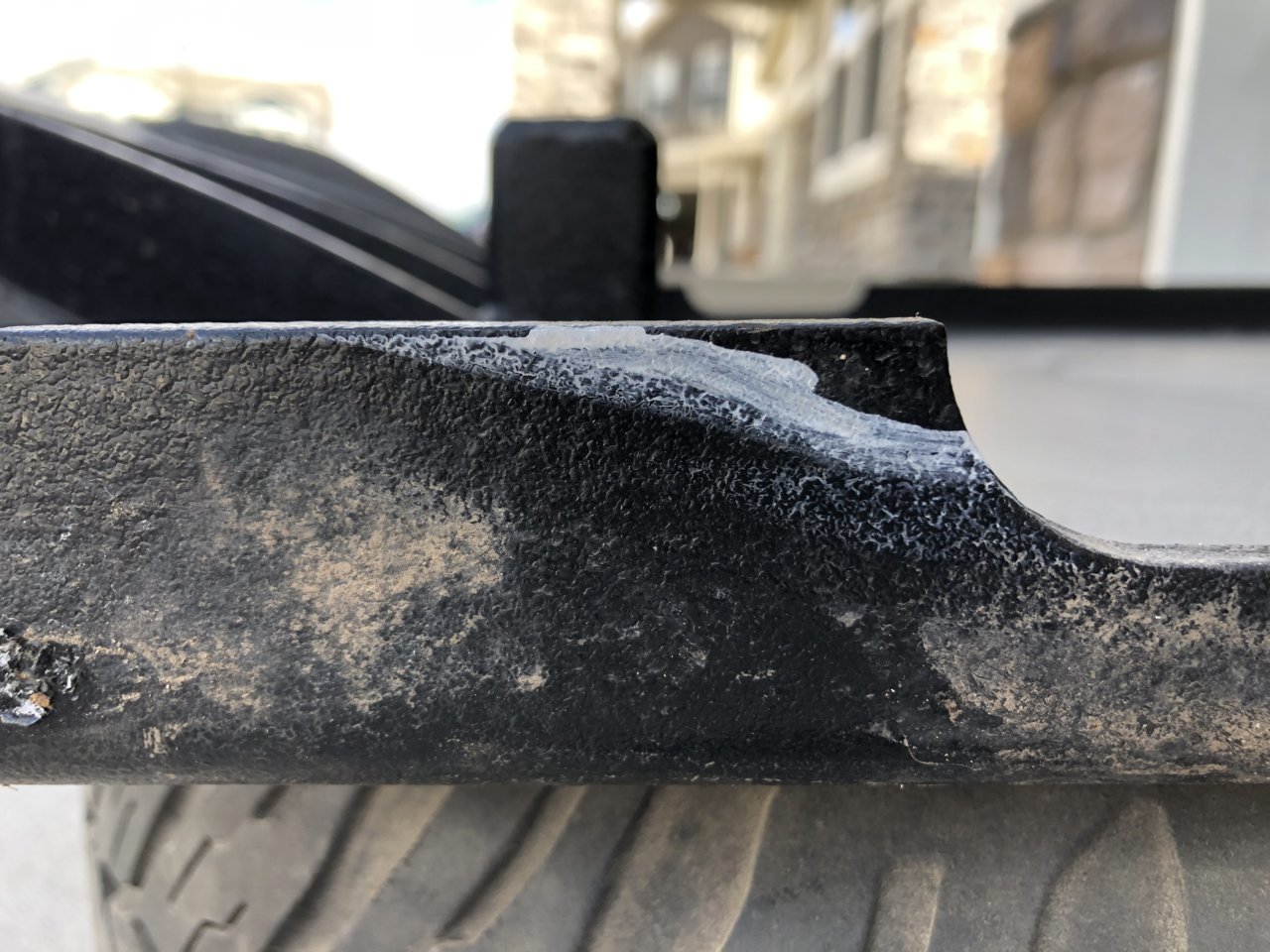

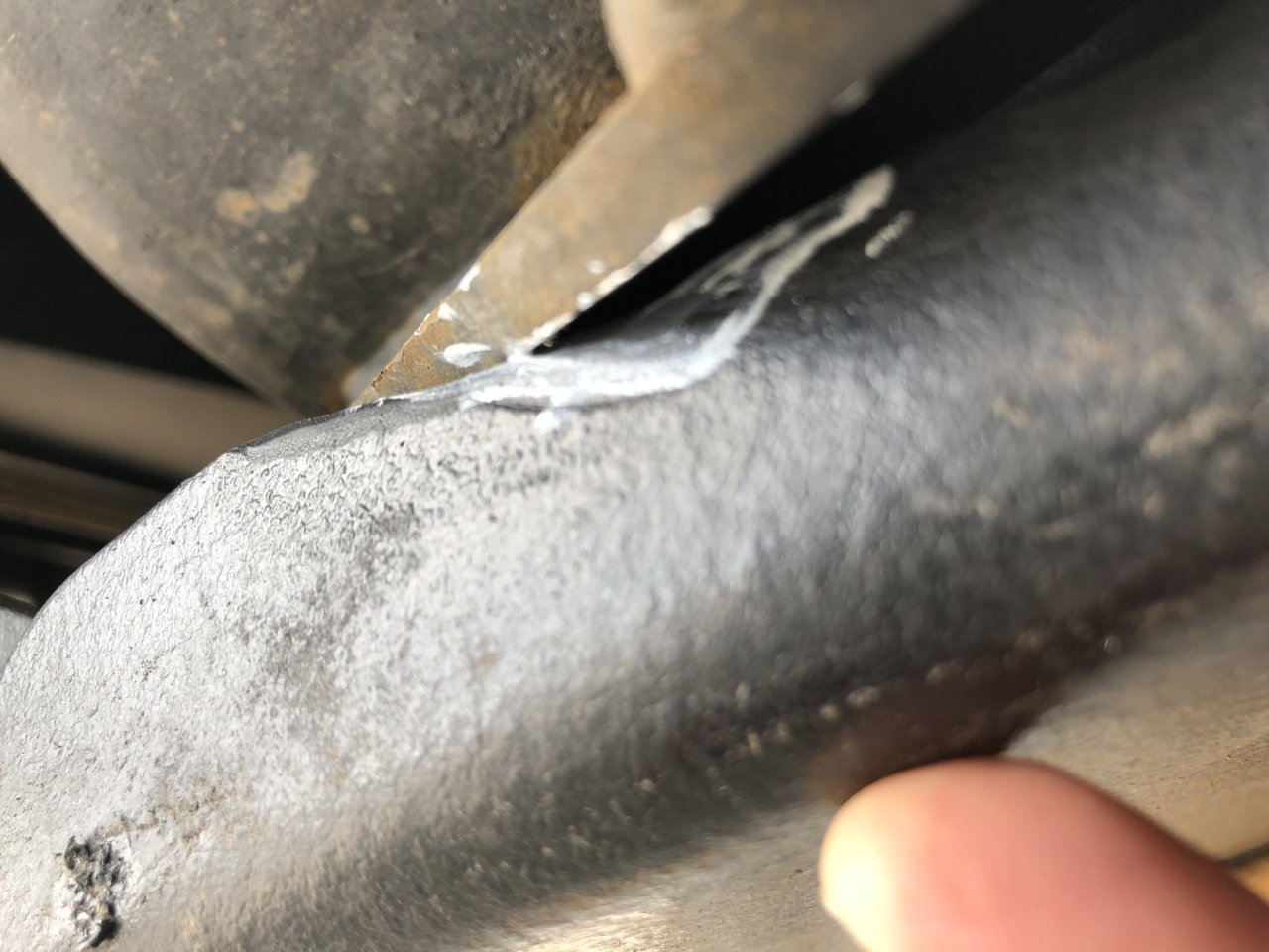

    Driver Side:
    Passenger side front:
    Passenger side Rear:

    That's nothing at all :thumbsup: make sure to post installed pics I'd like to see how it all lines up with those gussets.

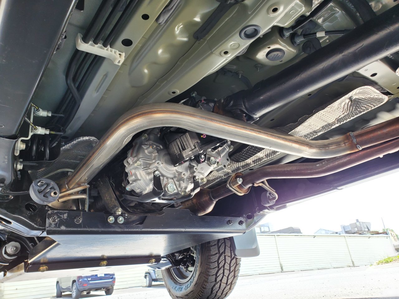

    Finally did the exhaust reroute to put on the rear skid

    First very nice looks good
    Second please show what you had to do to get it on drill wise I'm back and forth on the t case skid.

    two holes.

    Had to use a countersink bit to drill through for two bolts to the frame because not enough room with a long 1/2 bit to drill straight i to frame. Loosen all bolts and let everything hang. You'll need 8 washers for the four mid bolts and flip two inside around because no clearance from front skid lip. And plenty of beer.
    Forgot to add, don't take all four bolts out at once of mid transmission mount for obvious reasons.

    Awesome thanks that isn't nearly as bad as I was thinking. Looks good too go beat the brakes off of them
