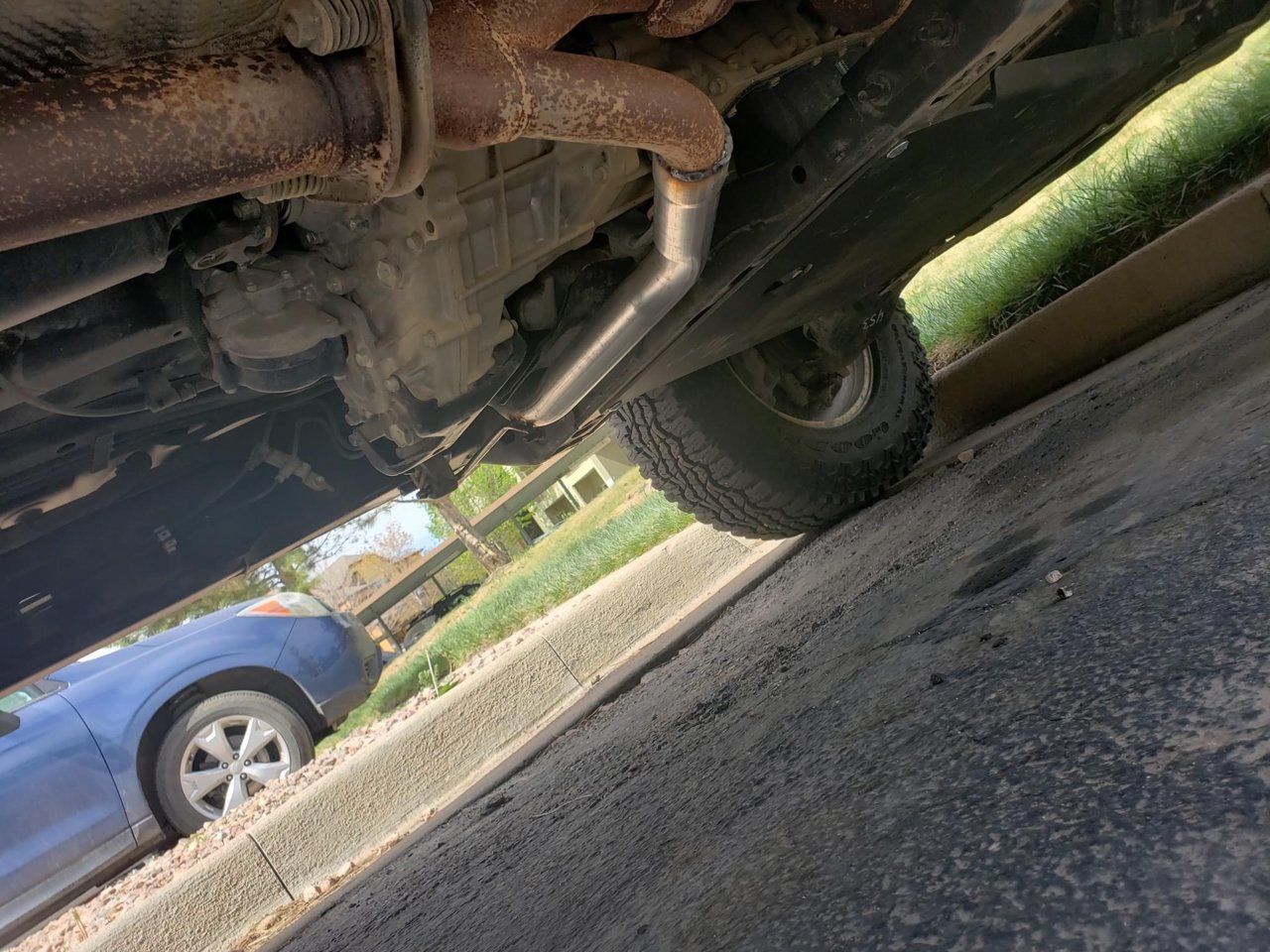

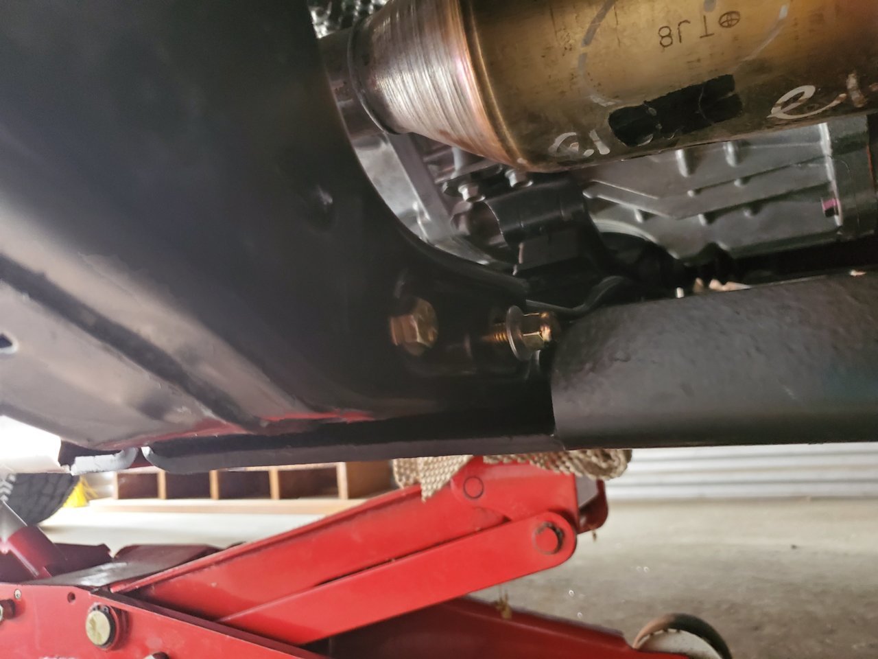

    What’s the recommended re-route path for the exhaust?
    in front of the transfer case like this:CF72ED33-458A-473D-9F39-F8571AF86EBB.jpg
    or behind the tcase

    You really can't go in front of it because the transmission is there, plus you'll get more cool airflow behind it further away from the tcase.

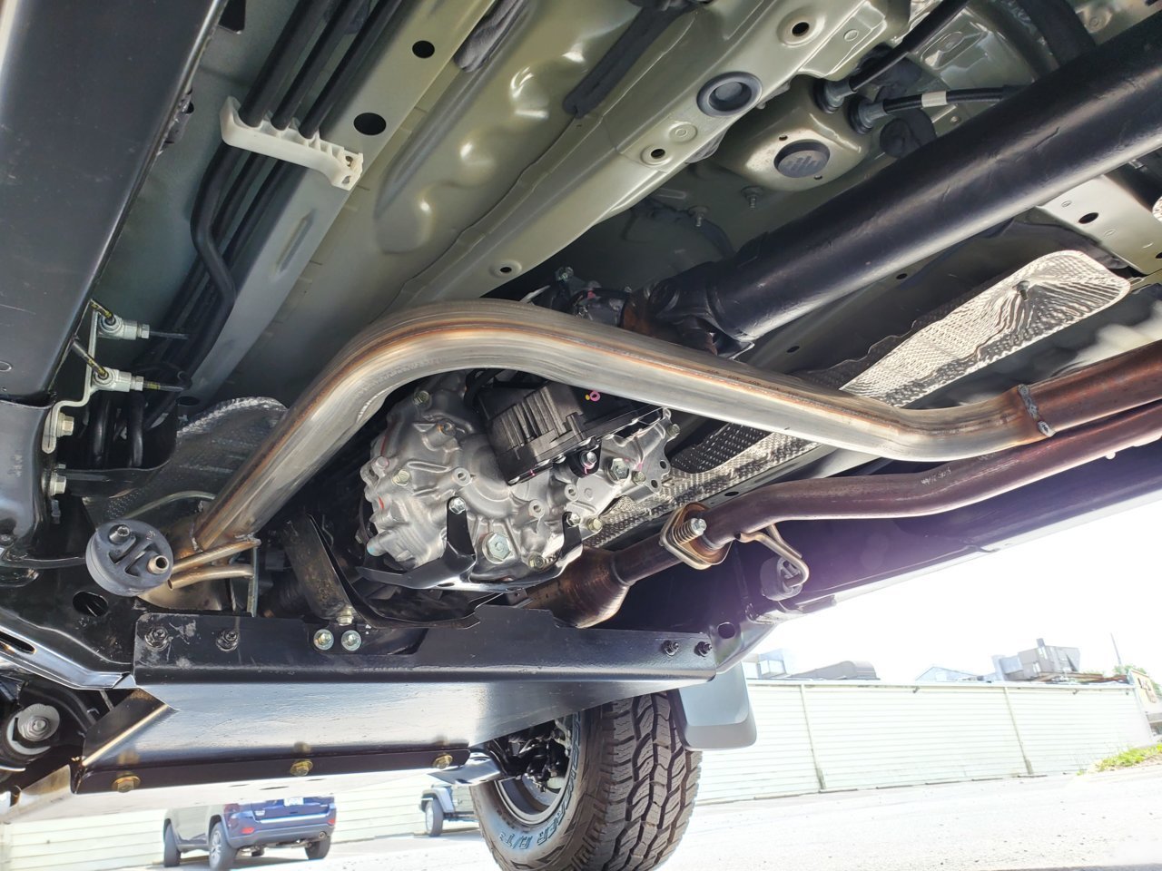

    The first photo is a photo of the exhaust rerouted in front of the transfer case and he has skids.

    It would probably be fine, just seems easier to go behind it and looks to be the more popular route.

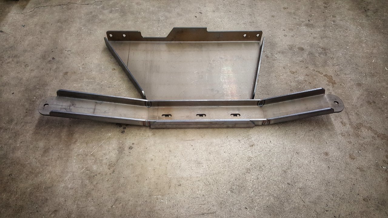

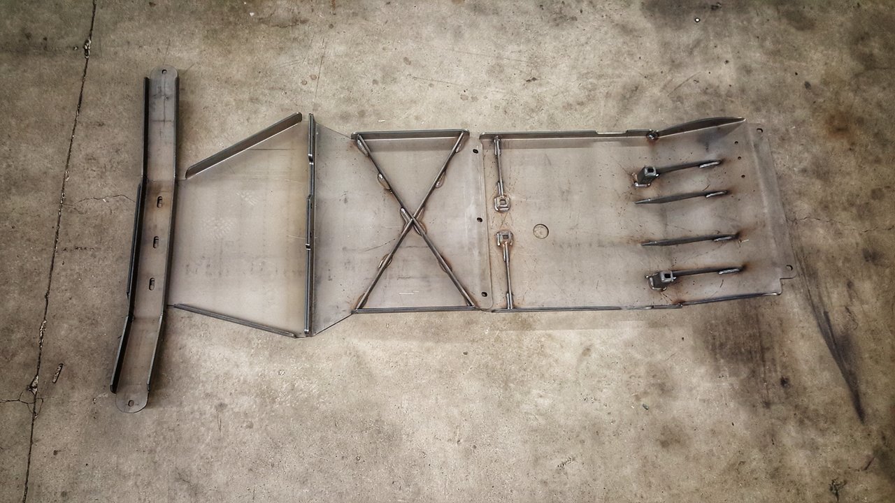

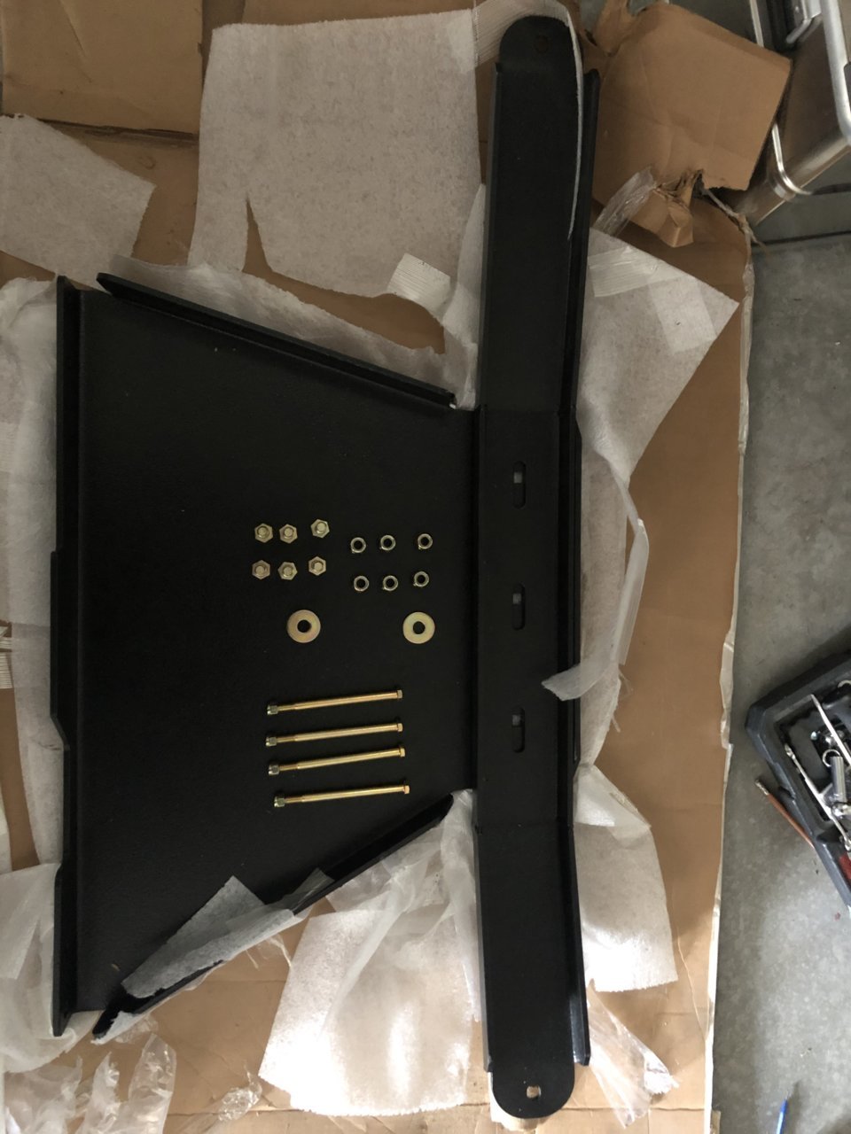

    Finally getting these installed, could someone tell me where each of these bolts goes?

    I haven't put mine on yet and it looks like I may have a couple different small bolts than you.
    The 4 long bolts go through the crossmember and the end of the skid, 2 on each side as seen in post #304 just above.
    Look at the pic labeled "behind the tcase" and you will see the 4 bolts.
    The 3 mushroom headed carriage bolts hold the skid and the skid's cross member together.
    Then you need 2 of the 1/2" bolts to hold the skid's crossmember to the frame and you need to drill holes for those.
    I got 3 of the 1/2" bolts each with 2 washers and a lock nut.

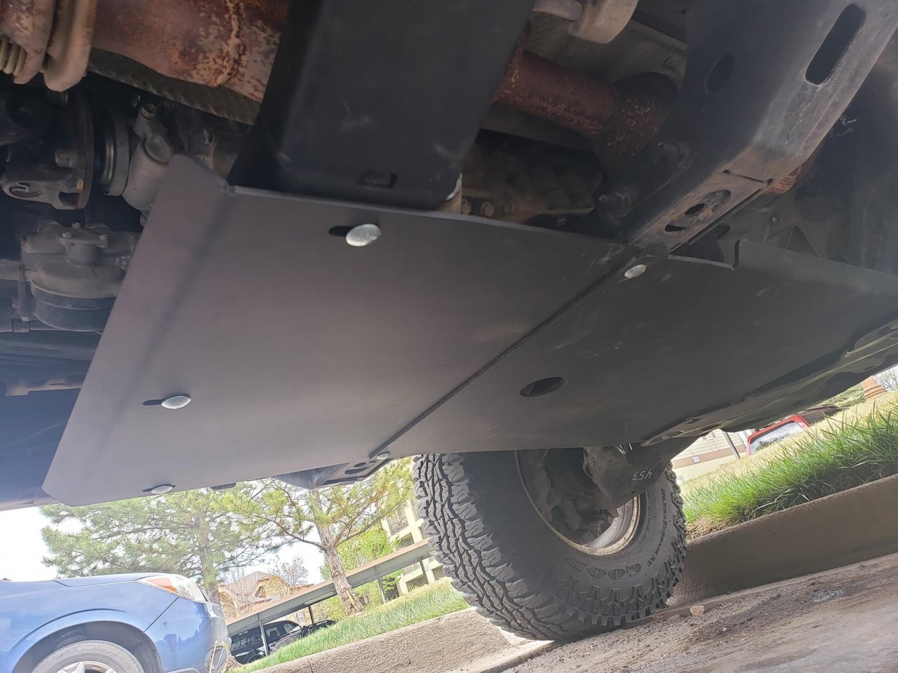

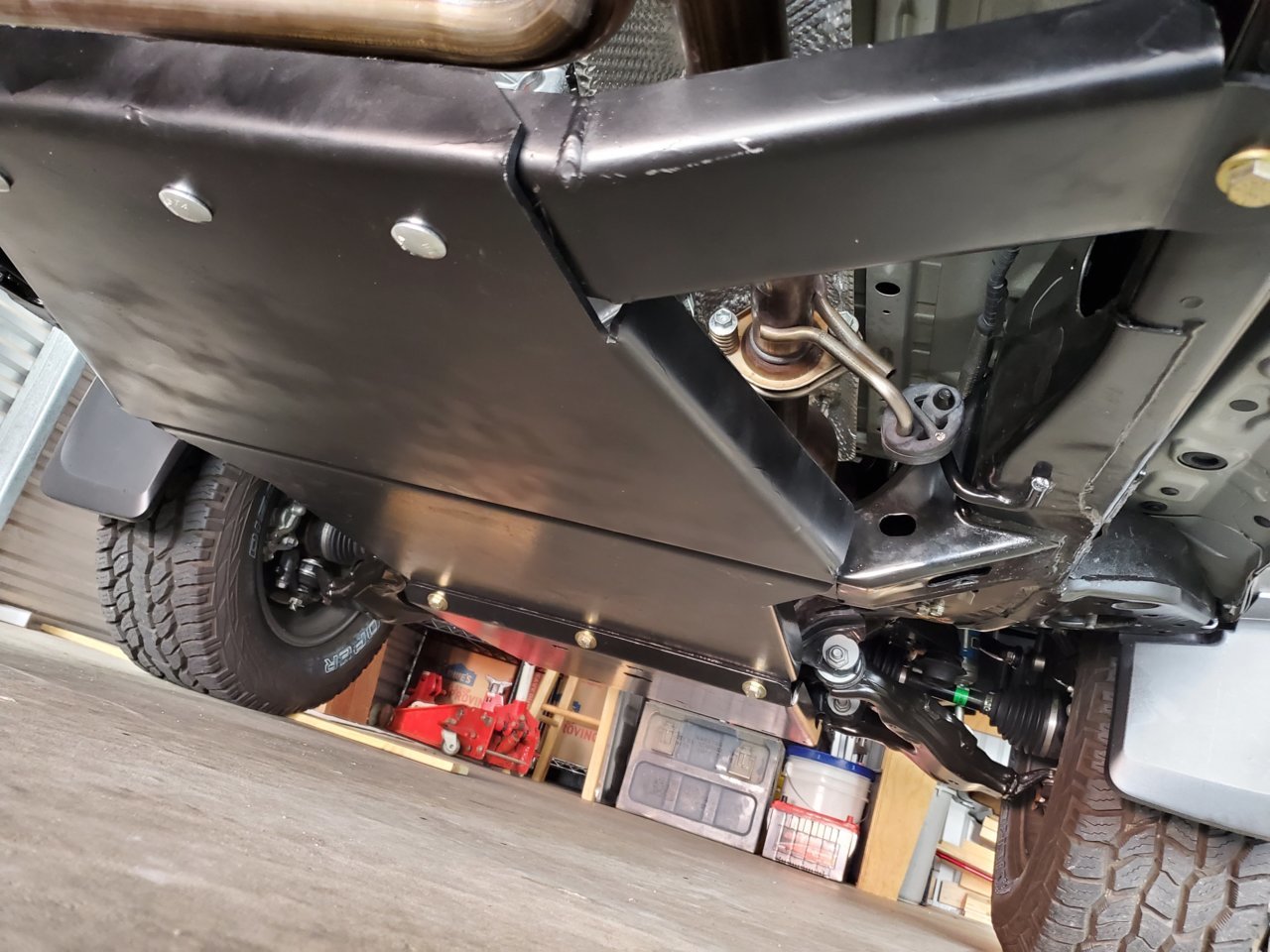

    Got my IFS skid and LCA skids installed last night and my mid and trans skid installed today. Feelin beefy. I also painted my little BAMF shield blue to match my wheels on the IFS skid. :rolleyes:

    The countersink bit you used was a 1/2 inch bit right?
