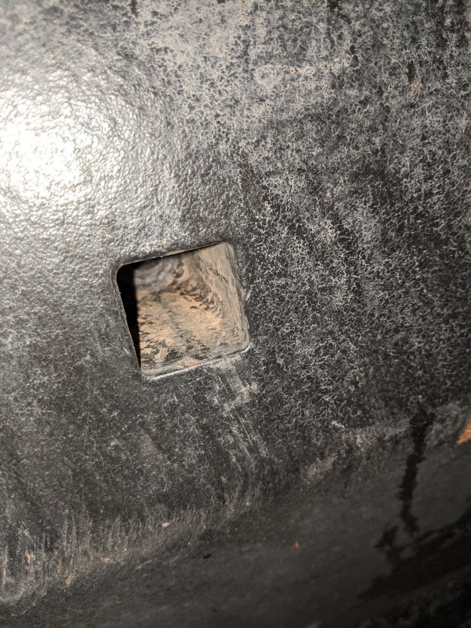

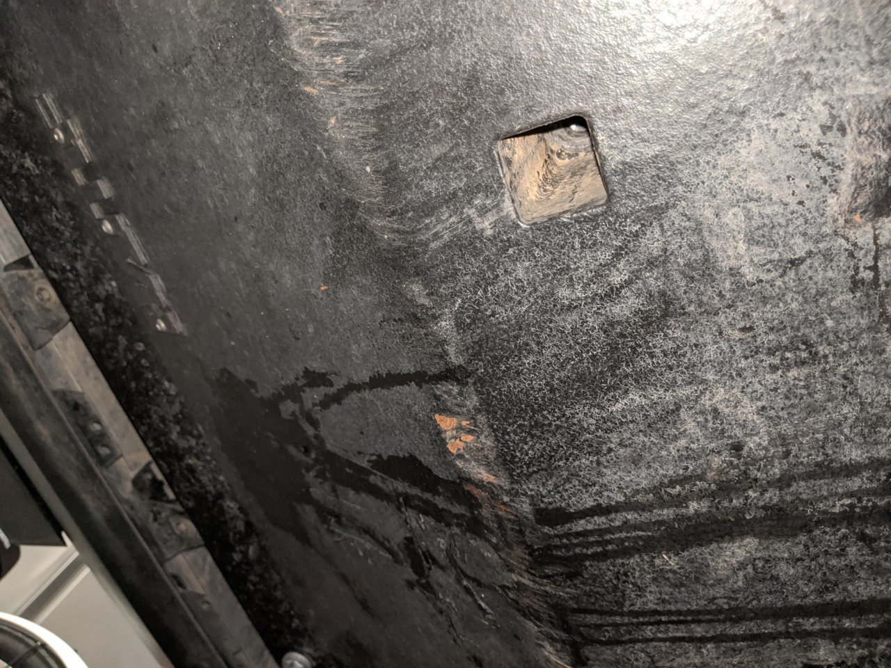

    Yeah, 1/2" the only reason is because a standard length drill bit plus the length of my drill was too long to drill straight into the frame since my truck was on the ground.

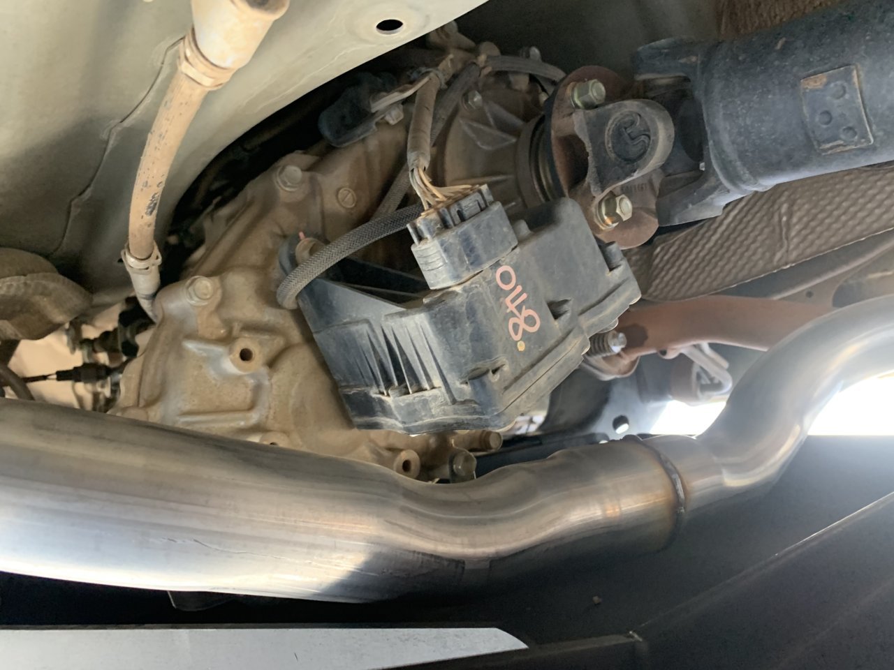

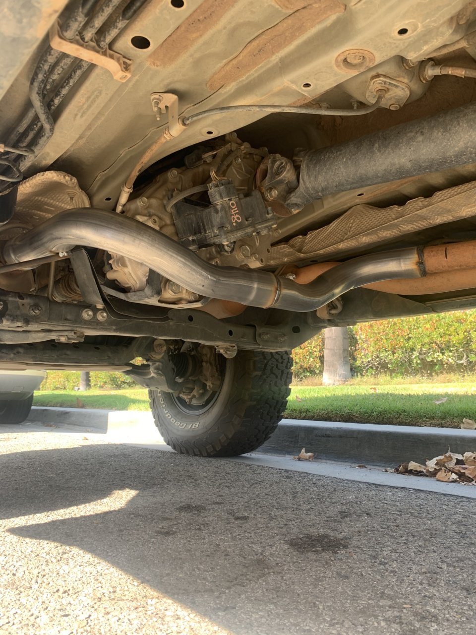

    Getting ready to paint and install the trilogy this weekend, my only fear is that the reroute I had done isn’t enough.

    Definatly update on what happens. I am close to pulling the trigger on that and have been back and forth on tucking it up higher or going around the t case

    That's high enough the skids sit at the bottom of the cross member.

    Jerry said it might interfere with the transfer case crossmember.

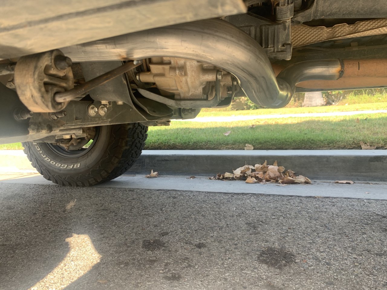

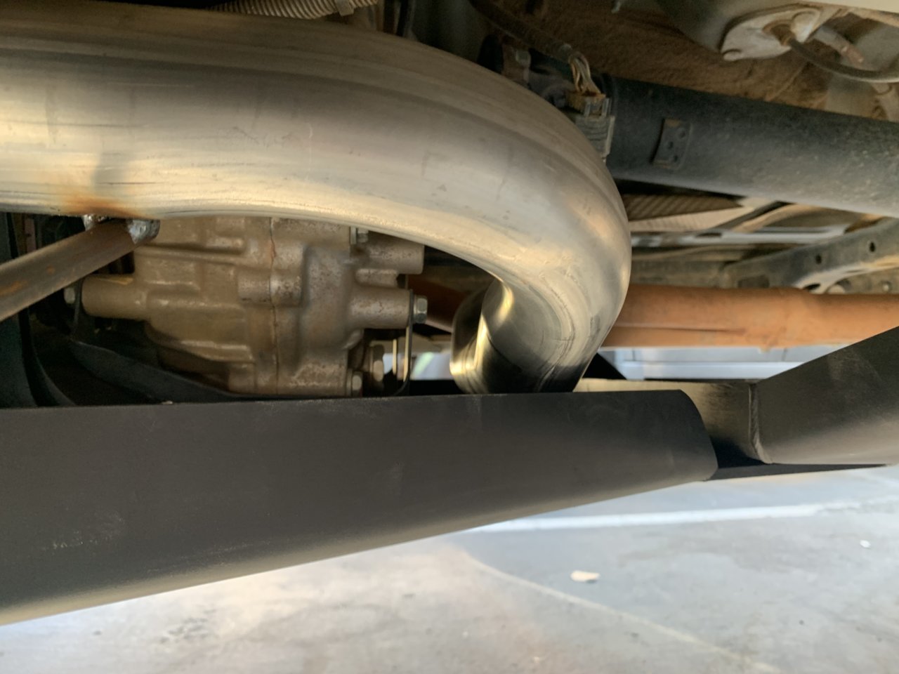

    29C8DF6C-5F47-4A37-943D-D5E2D0CE18D6.jpg 906A7C14-D31E-48B2-8EAD-547D89833563.jpg I lucked out! The reroute cleared without any issues.

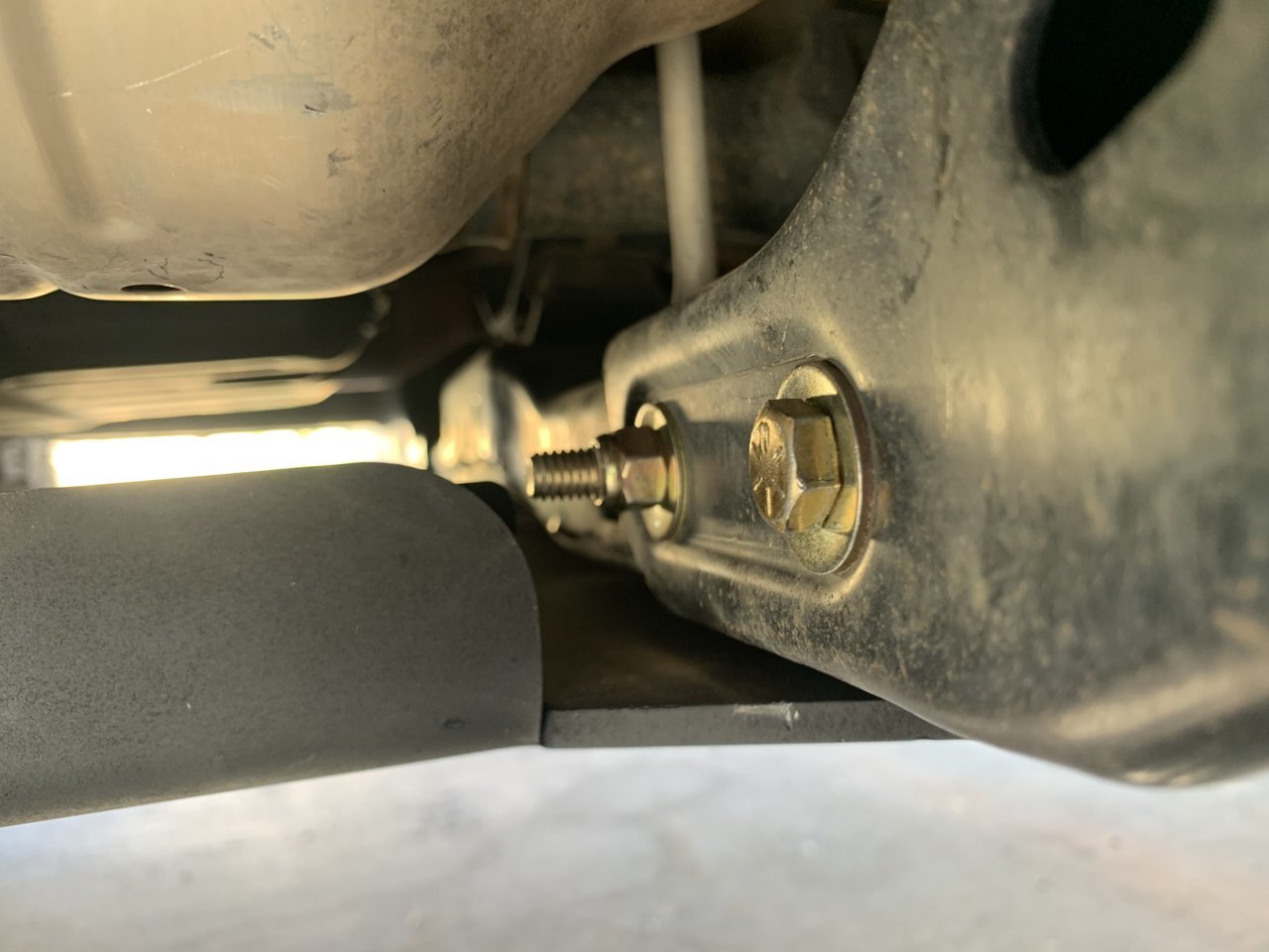

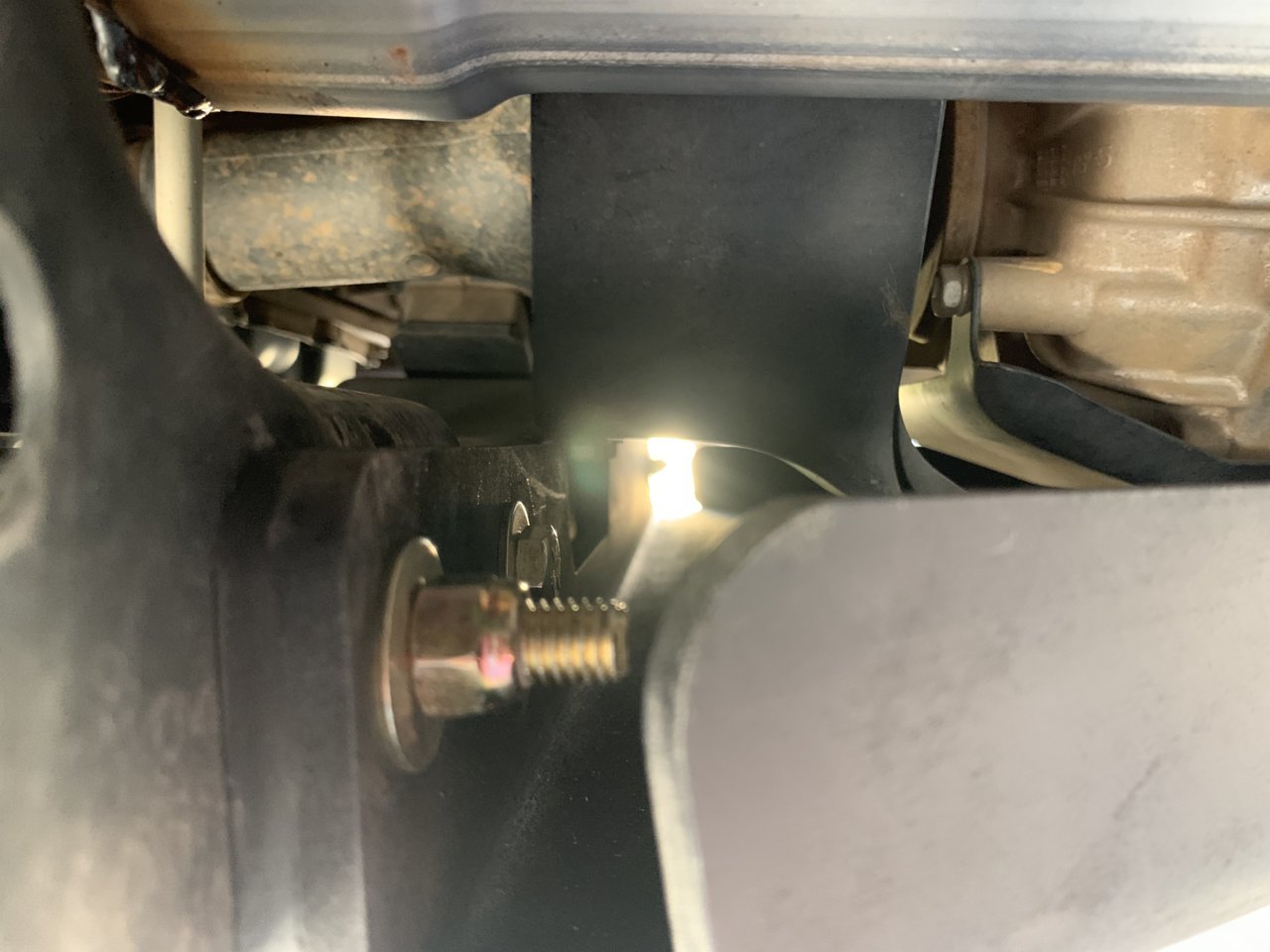

    The part we struggled with was getting bolts to go through the existing crossmember and mid/t case skid.9839003D-0509-4B4A-A310-BB1ABB8D0510.jpgE1076F38-47BD-4DB8-86DA-C01B1552FD30.jpg6EF11AE4-5572-4CFE-B7DA-BDAB8210C5BB.jpg

    You did it right you have to flip one on each side the other way. Looks great and you'll save your drive train off roading.

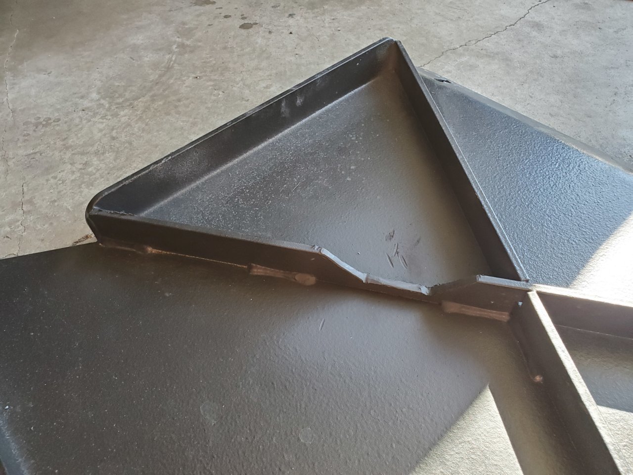

    I'll add on here that I have the URD re-route, which reroutes it in front of the crossmember that the mid skid attaches to and I had some clearance issues. Instead of bolting the skid lip over the IFS skid on the front, I had to bolt the lip under the IFS skid. It still rested on the exhaust, but I was tired and just wanted to get it on. There was a lot of noise transfer into the cab from the contact it made.
    I went back and modified the mid skid for my exhaust and I clear now mounted the correct way. Just a heads up for those running the URD re-route.
    Here is the cut I had to make:

    That is a good way of adding the T case skid without dropping the Mid skid :thumbsup: Normally you would want to swap those bolts with no mid skid with a jack under the corssmember. That if you are OCD and want them to face the same direction.
