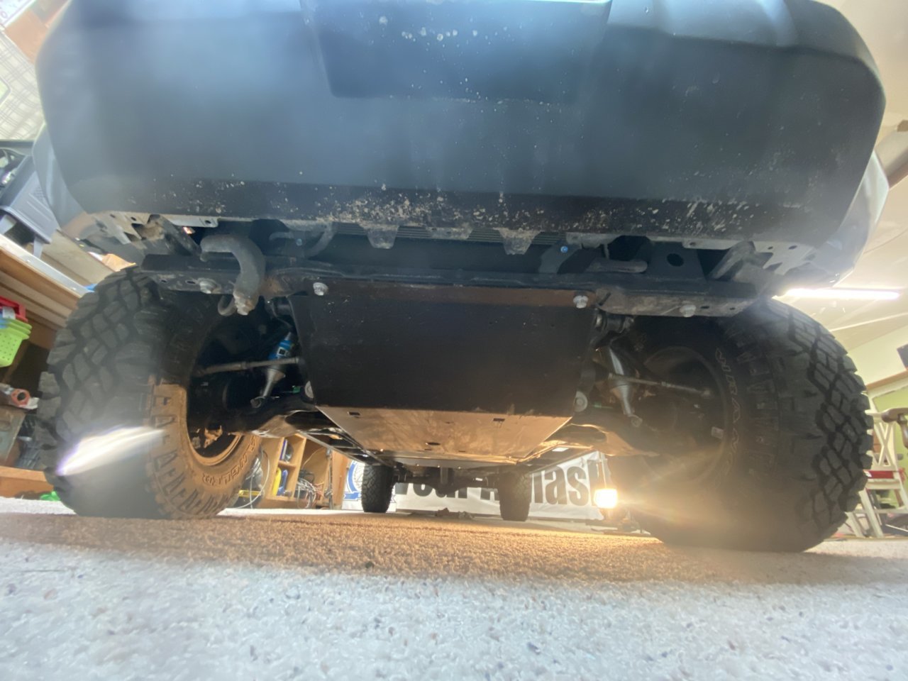

    The other 2/3rds of the Skid Trilogy finally mounted up after sitting in my garage waiting for a exhaust reroute.

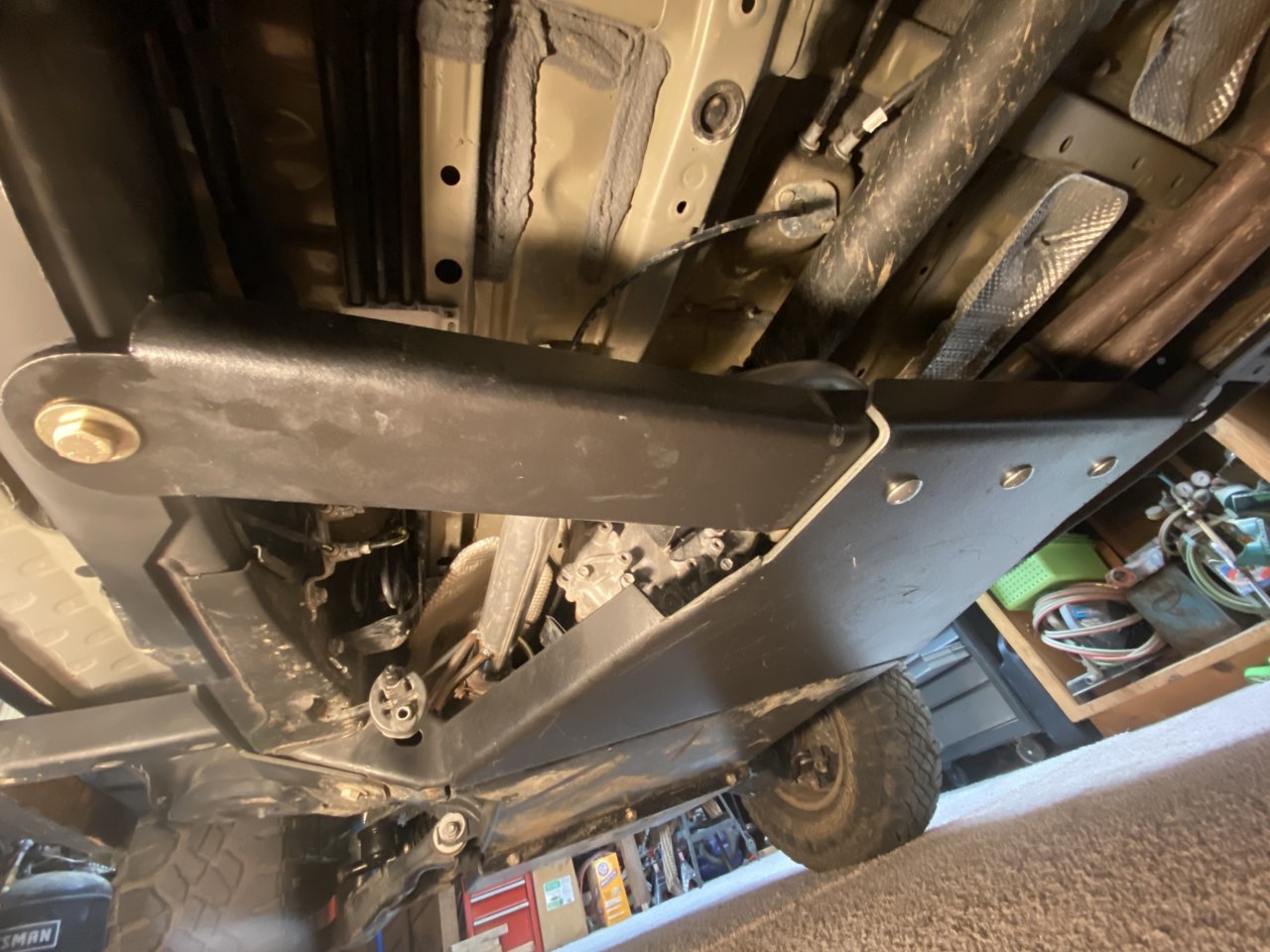

    Finally had the exhaust re-route done, and added the last piece of the skid trilogy:
    I picked these up used, and the previous owner had notched the transfer case skid to accommodate a poorly done exhaust re-route. I think there is still enough BEEF left that it shouldn't be a problem.
    Ready to go full turtle!
