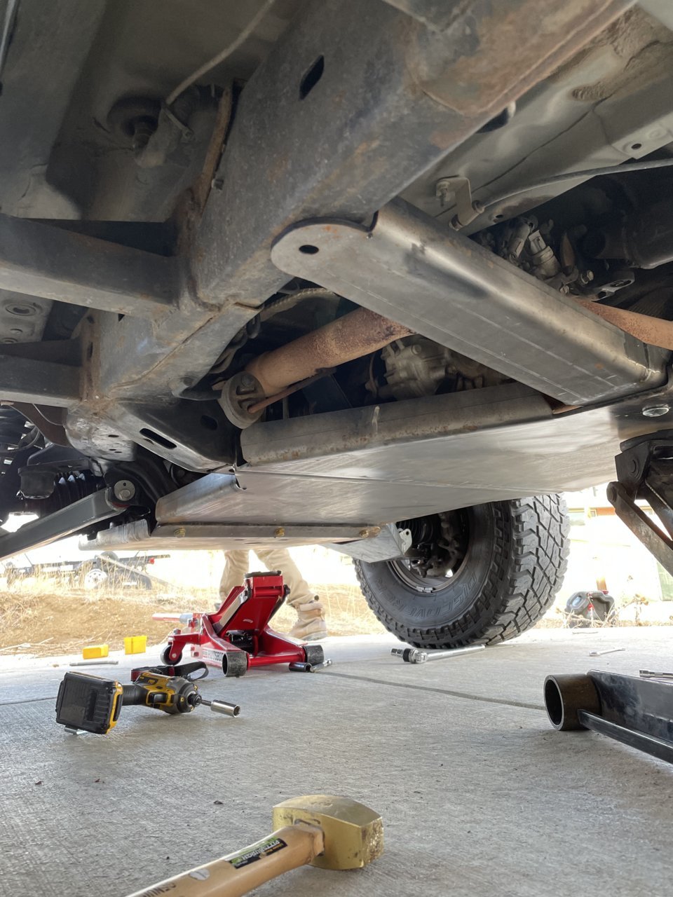

    Got mine installed finally. Been about 2 years
    Notes:
    1. Was very intuitive, simple install even no instructions. This thread was very helpful however.
    2. They are BEEFY AS F***. Thanks Jerry.
    3. Would highly recommend having a friend help, and have some beer on hand too.

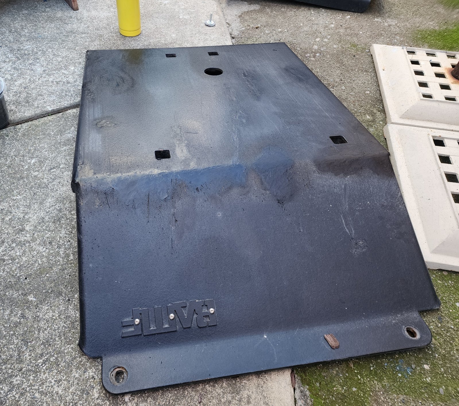

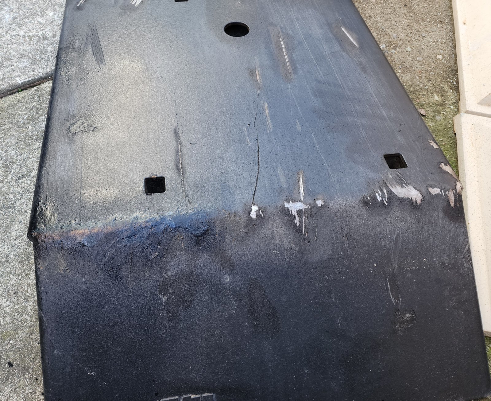

    Got the skid plates back in 2016 and finally decided to clean them up with the thermoplastic powder coating. Only because I'm doing the 60k service and these plates need to come off.

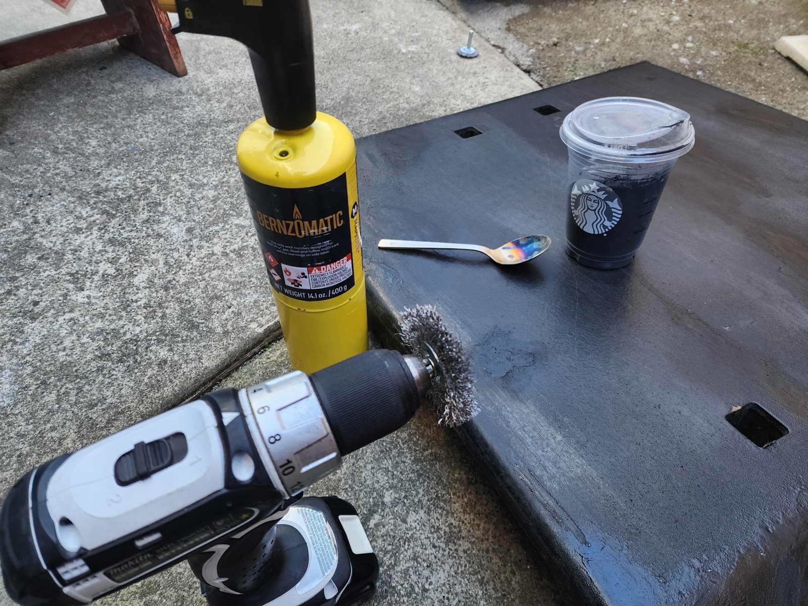

    I repaired both IFS and mid-skids but only snapped terrible pics of the IFS. Painting would be quicker and easier, but not as durable. With thermoplastic, you get to play with fire. The key is to get the spoon hot enough.
    Repaired half before I remembered to snap pics
    After
    The tools involved. The starbucks cup contain the powder.

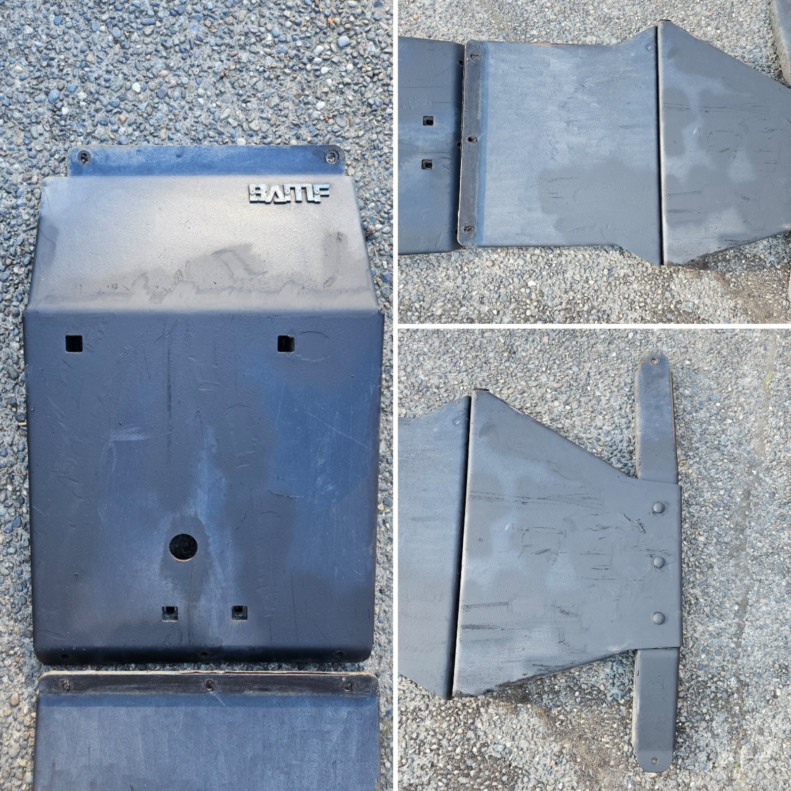

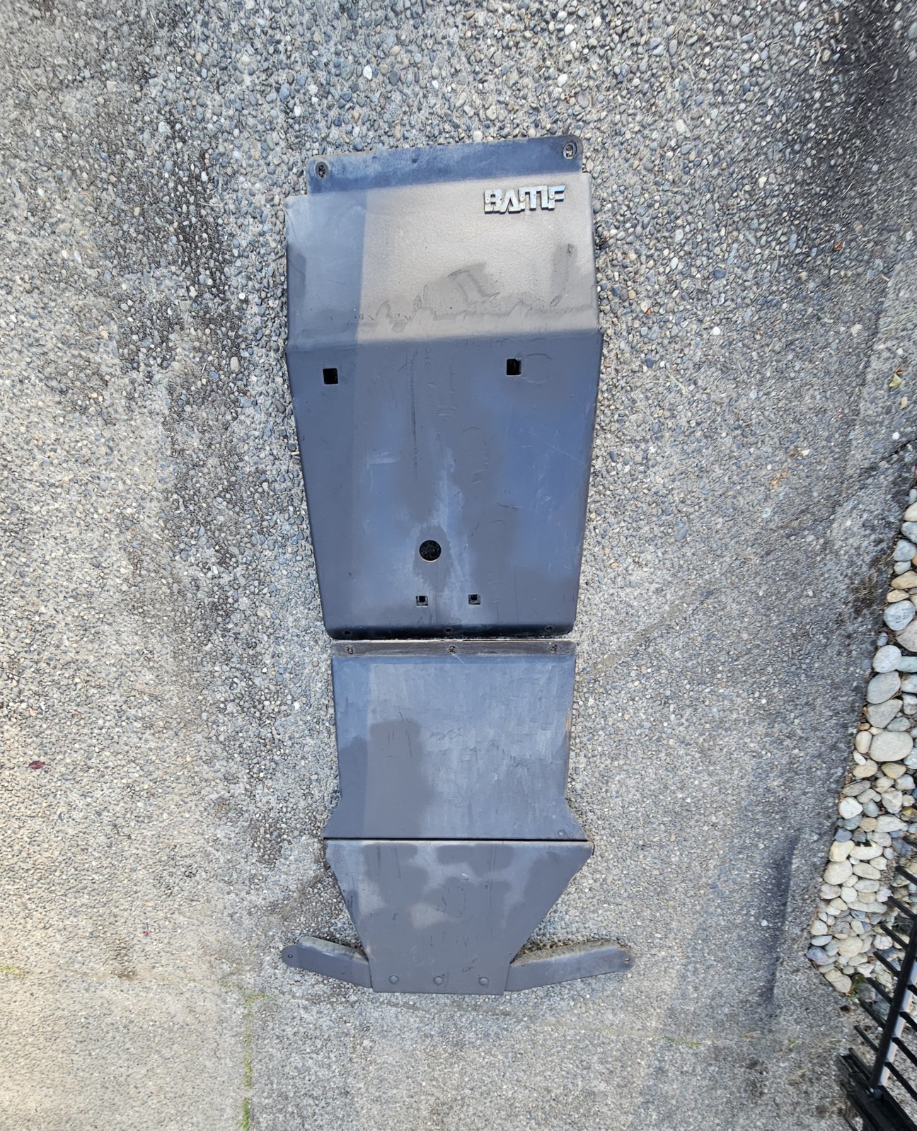

    Got a set of 4 year old trlogy skids up for grabs in Seattle area.
    Hit em with a flap disc to knock the rust off and a can of flat black today. Asking $800. Comes with complete hardware set, albeit a bit rusty.

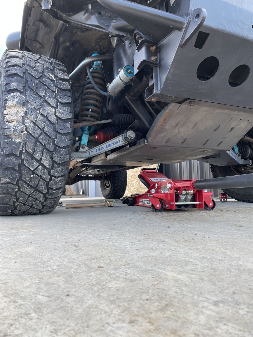

    I’m just about wrapping up my trilogy install (need to drill the holes for the cross member) after having it sit in the garage for 2.5 years. No fault of the product; just life and other priorities. I did do the Baxter oil filter relocation and fumoto valve to ease oil changes. And I changed my front differential, rear differential, transfer case and transmission fluids prior to installing the skids. Upon closer inspection, I’m quite sure I can change the transmission and transfer case fluid without dropping the skids. Obviously can’t access the front differential without dropping the IFS skid. But my question is if the front skid can be removed without removing the other skids; will the mid skid be fine dangling from the front for a couple hours? Or should I just prop it with a floor jack?

    The mid skid should be fine keeping it on. you can prop it up with something if needed but it shouldn't move much.
